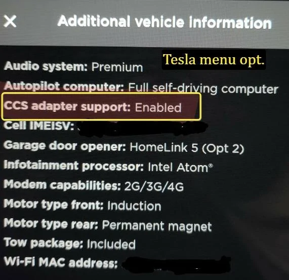

Well it can't be that different if they can manage it in a small adapter that Tesla current sells for $175 for Tesla "enabled" cars.
https://shop.tesla.com/product/ccs-combo-1-adapter
Tesla vehicles are still different on car side. The CCS adapter to Tesla can happily ignore the difference because it doesn't matter. The reverse adapter could be made no problem but to put the port on the vehicle there will need to be dramatic changes.
