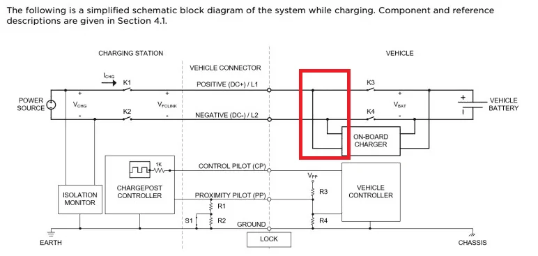

The DC pins for CCS connect directly to the battery, bypassing the charger entirely.
That would be a very poor design and dangerous.
You absolutely must have something between the charger and the battery to protect the battery.
(You may be confused since AC charging requires rectification before sending the power to the battery but there is always a circuit to regulate the power to the battery and shut it off when the battery if full.)
Tesla's design sends DC to the input side of the charger. CCS does not do this as I've already stated several times.
Notice those relays, "chargepost controller" and "isolation monitor"? That's your battery protection.
Why are you ignoring what I've been stating? In Tesla's case 400VDC is being applied to the input of the charger. Tesla does something special to accommodate this happening that CCS vehicles are not required to do because they will never see that high of voltage applied.
Tesla had some issues with their onboard chargers blowing up from CCS chargers when they first started shipping them because the CCS chargers sometimes apply too much voltage for the components Tesla is using during the isolation testing, because the chargers are still connected to the DC lines before the battery contactors are activated. CCS vehicles don't need to worry about this because they don't do it.
CCS vehicles don't connect the charger to the battery?
