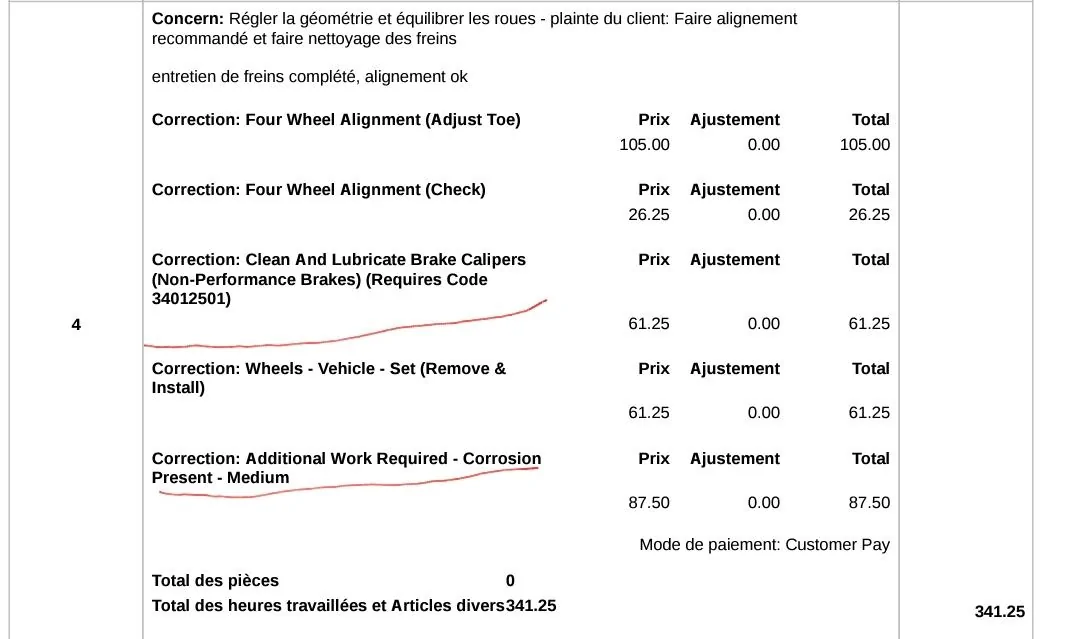

My concern comes from seized brakes twice with a nissan leaf in 6 years and recommandation from Tesla to get brake cleans every year in Québec for that specific problem with evs. I just had mine done yesterday, as they were dragging.
Seems a bit short sited for Tesla to translate everything but the descriptions for a global company.
But then again would have made it much harder for me to read... :)

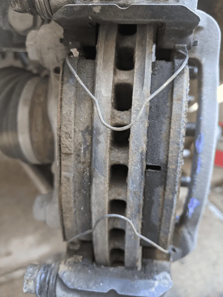

No issues with brake rust on my 53k mile 2018 Bolt in Michigan. I exclusively use L mode, and try to minimize the amount of actual braking I do.
I did decide to grease the caliper guide pins and the ears on the pads this spring for the first time. Only one single pin was in obvious need of it. The pads were a little tight but they haven't moved much since new...
