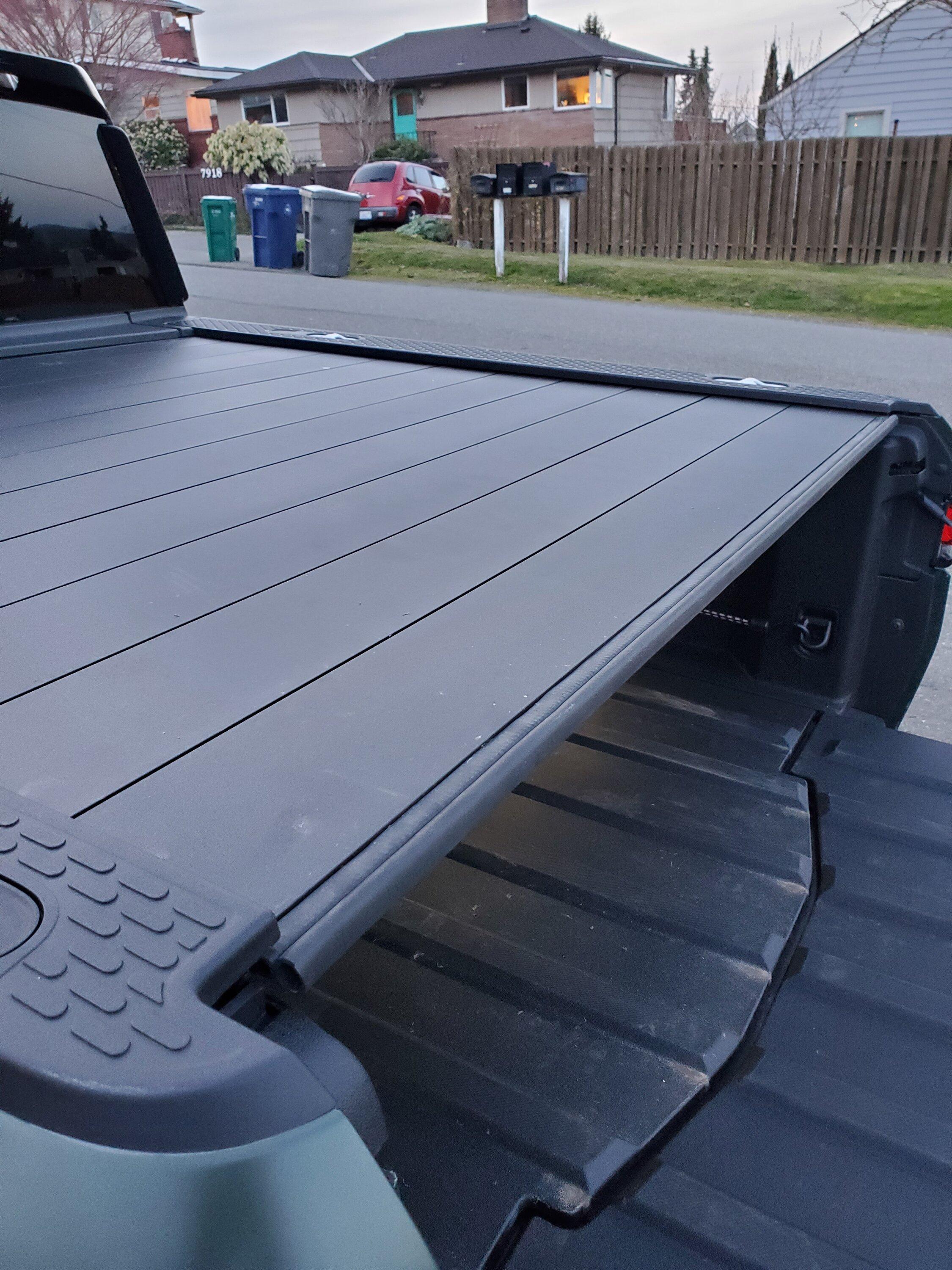

Thank you for sharing, @Bf3
Your tonneau looks great, and the strength and security of your design is very appealing. I think this is the best option for everyone who received a truck without a tonneau, and I really can't imagine how Rivian would improve upon this design when they eventually release the manual tonneau. Congrats, and thanks again!

That's awesome. Nice work! Definitely the best I've seen. I'm guessing this is as good or better than what Rivian comes up with. In the non-tonneau trucks like I have, It would be cool if that stack of panels could be stored in the empty space cubby where the factory tonneau lived. Your panels are deeper and would probably stick out into the bed some but could have a velcro strap holding them in. I've taken off the panel on the front of the bed to see the empty space. Hate to have an unused storage space.

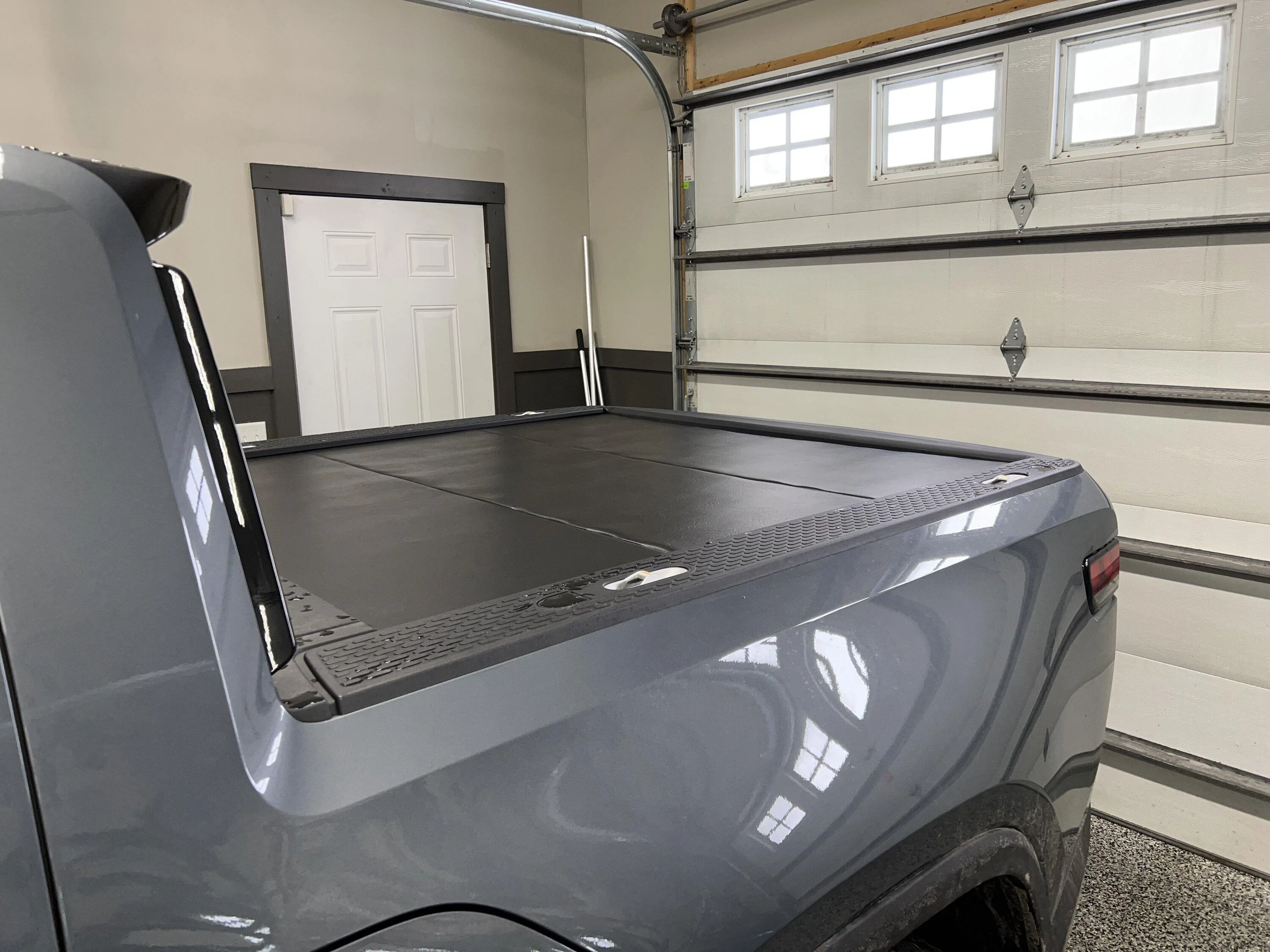

temporary DYI Tonneau
~$150 in materials
12 cedar boards
Cut to 54.5” and planed down to ~ 1/2”
Combined to 3 - 18” width sections using scraps
~$50
https://www.homedepot.com/p/Alta-Fo...ed-Cedar-Dog-Ear-Fence-Picket-63035/205757693
Arctic vinyl wrap 54” width
Joann Fabric
~$75
-misc weather stripping and hardware
~$25
fits in gear tonneau
patiently waiting for the permanent Rivian manual tonneau or hard folding aftermarket

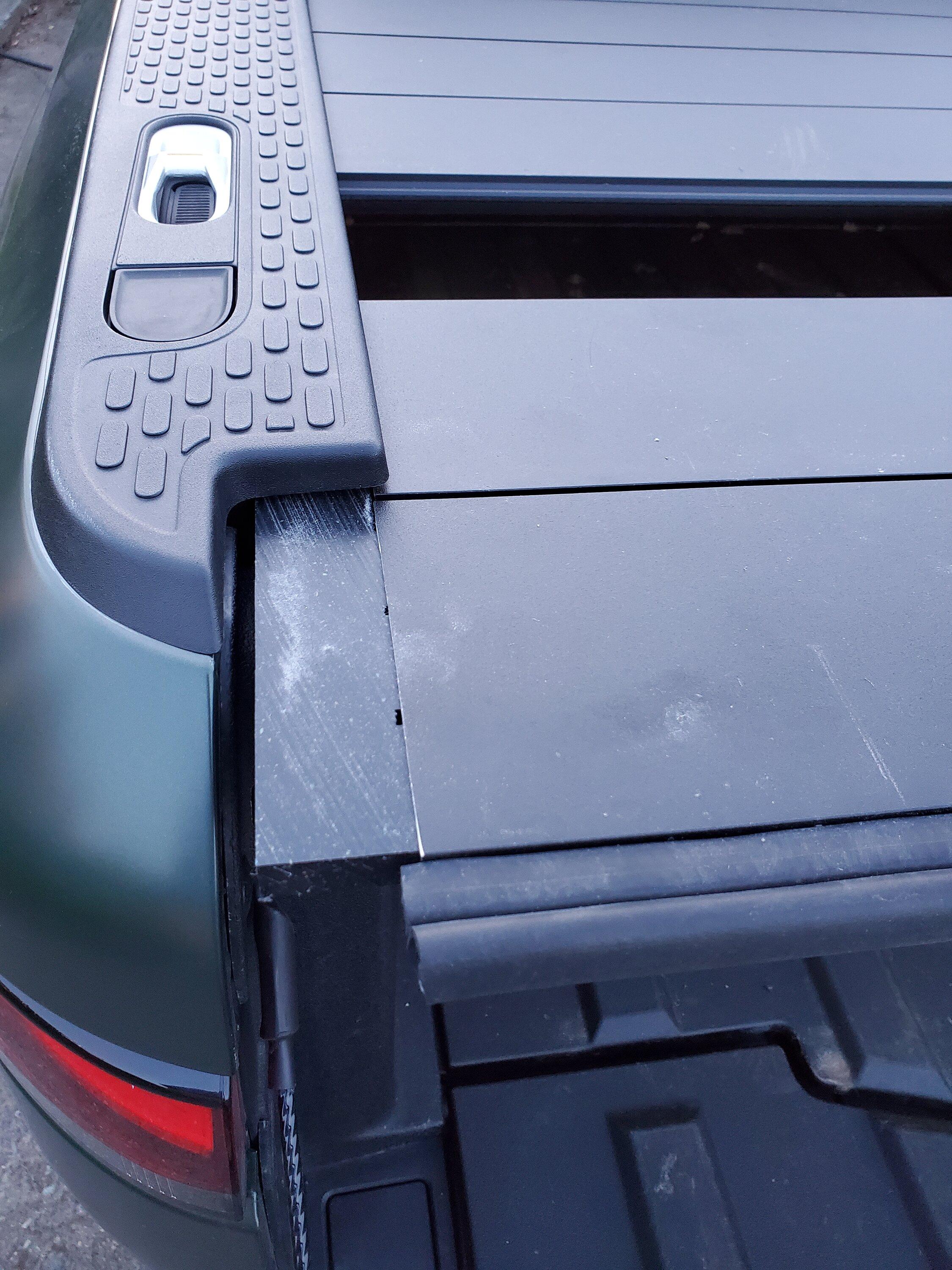

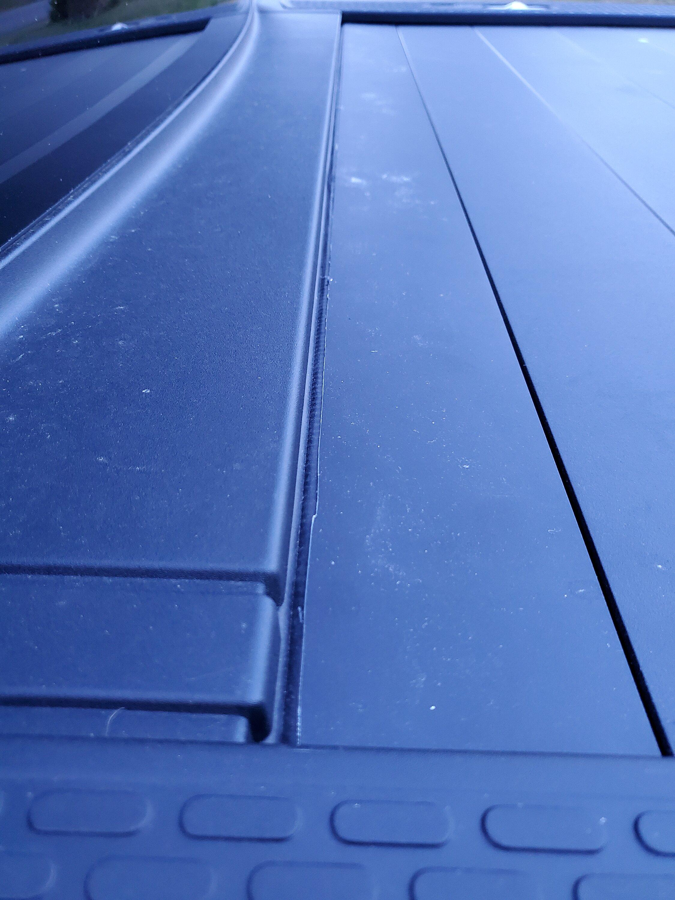

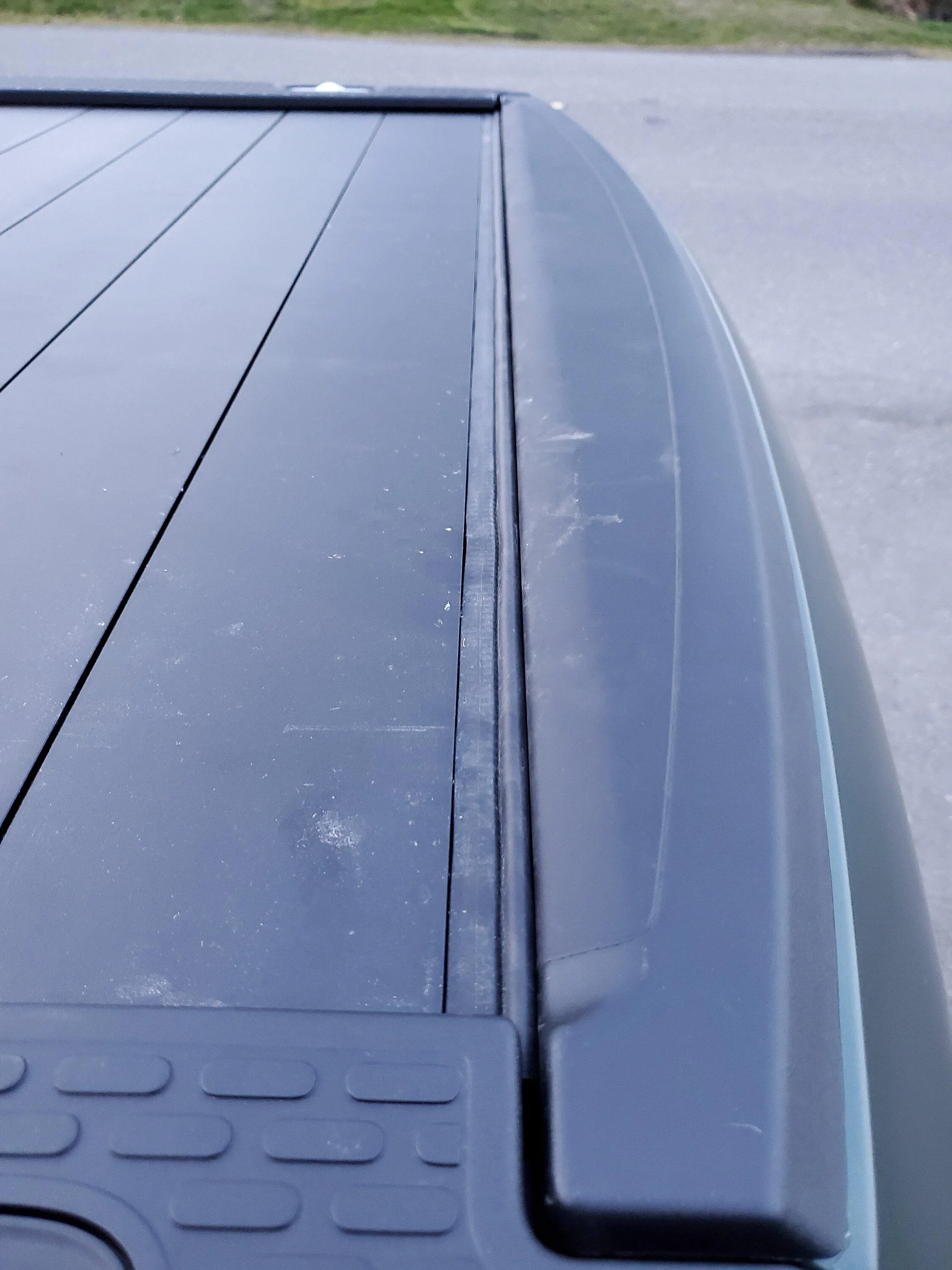

Just a huge shoutout to @Bf3 and @dga965 for the guidance and pointers. I just got the base work done on my DIY build with the fence boards and plastic sliders... It closes solidly, slides super nicely, no rattles or shakes that I can tell. It definitely needs the velcro (or a string of some form) for easy removal, because it's a big pain to climb in and pull them all out without something like that, but that's next... There's some fine-tuning that can be done on the one board that was ripped down lengthwise, I have it up at the front, cab-side, to help hide it mostly, but I think a little filing down will cover the part where my table saw skipped on the fence and made a not-so-smooth chunk. Maybe some paint to cover the raw aluminum parts on the cuts, but for the small amount of time I had, it's pretty awesome.
And my daughter likes standing on it... ?‍♂:facepalm:
Edited to say, cutting this plastic with a table saw is super messy! My garage is COVERED in that stupid plastic fluff now...

Looks awesome @Phatman113 can you link to the weather stripping that you are using at the front and rear of the bed. I am going to attempt this as well. I really need covered storage....
Phatman113
Ryan
Feb 21, 2023
371
377
Fence panels:https://www.homedepot.com/p/Veranda...Aluminum-Metal-Fence-Panel-EF-00308/205625711
Update, it looks like HD is out of stock... Lowes has a version, these should be identical, made by the same manufacturer, just Lowes brand: https://www.lowes.com/pd/Infinity-A...ack-Aluminum-Composite-Fence-Panel/1000041755
Plastic edging:BuyPlastic Repro Black UHMW Polyethylene Plastic Sheet 1/2" x 24" x 24", Ultra High Molecular Weight Polyethylene Board, Size 23.75 in x 23.75 in https://a.co/d/fdWZeeO
Weather stripping: Tintvent Car Door Rubber Seal Strip with Top Bulb(26Ft), Automotive Weather Stripping Soundproofing Edge Guard Trim for Cars, Trucks, Boats, and Home Applications https://a.co/d/eN5ard0
Velcro (arriving today, so I don't know how well it'll work, but I've got high confidence):VELCRO Brand Extreme Outdoor Mounting Tape | 20Ft x 1 In, Holds 15 lbs | Strong Heavy Duty Stick on Adhesive | Mount on Brick, Concrete for Hanging, 30702 https://a.co/d/1pKyaBZ
The weather stripping, at the rear is over the tongue section of the fence panel. At the front, since that panel was cut down to size a little, it's wedged into the interior cavity of the fence panel... Same stuff though, so that was nice
