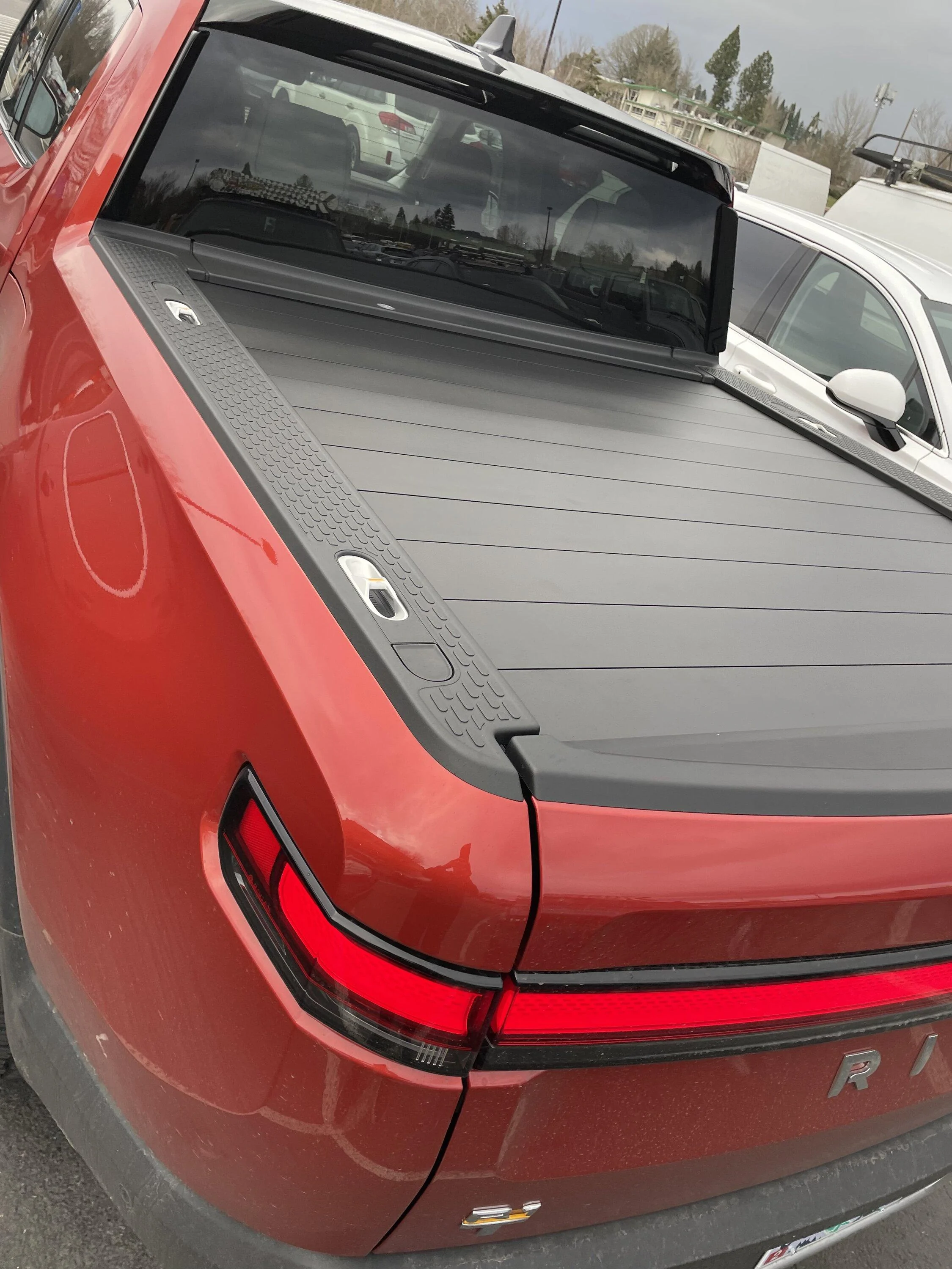

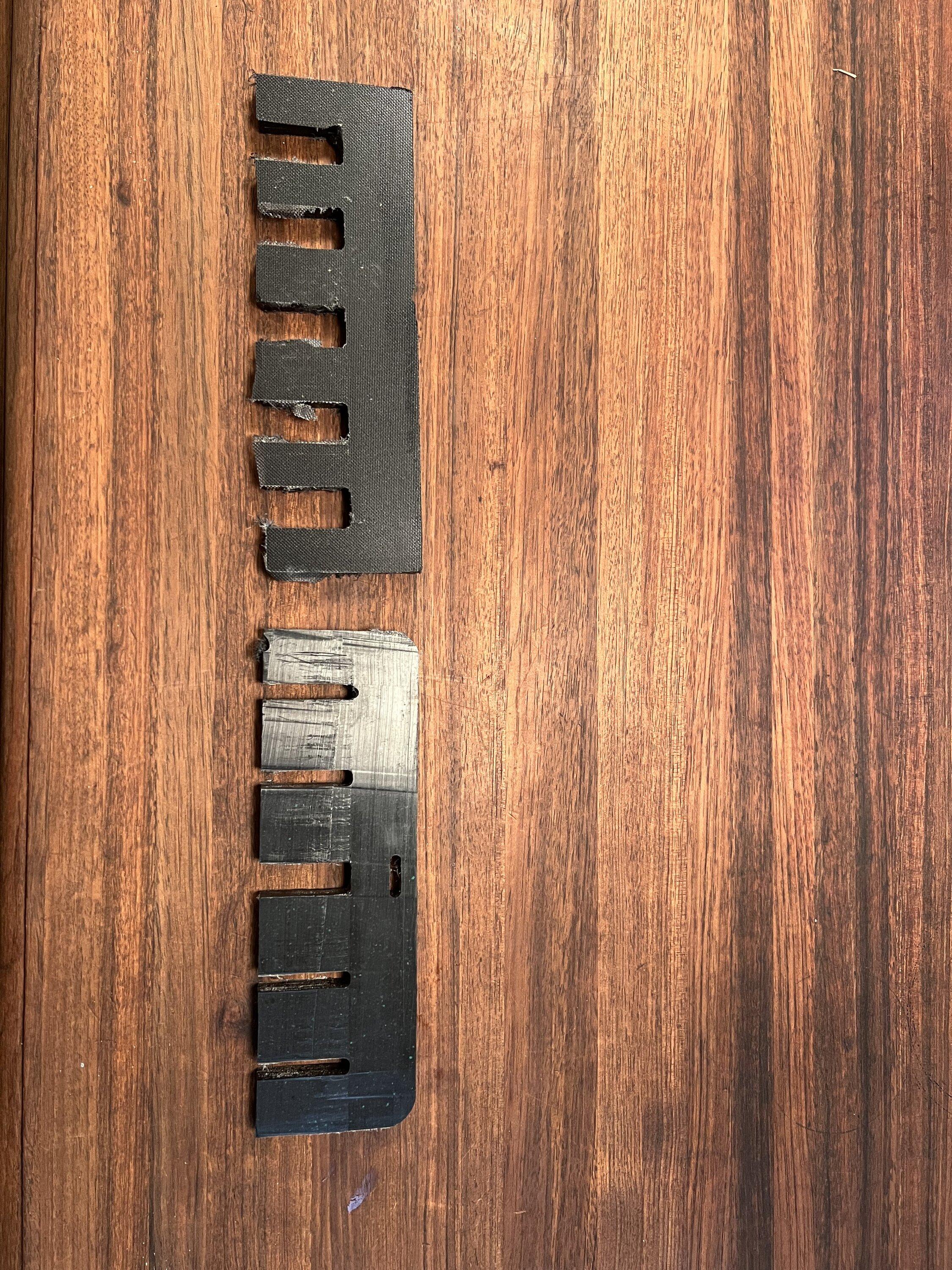

Sorry for the confusion. I am still working on the slides/end caps. For now the cover is sitting on the plastic ledge below the side slots (1st pic). The 2nd pic shows a piece of scrap HDPE that fits into the fence board and into the side slot. Hope this helps.

Here are the slides I’m using. The rougher one could easily be made on a table saw or with a router. The other is my slightly more polished attempt with the shaper.
My source for materials below. McMaster-Carr is a go to for engineers, just about everything in stock and fast shipping along with detailed specs. But be warned that shipping can be high.
