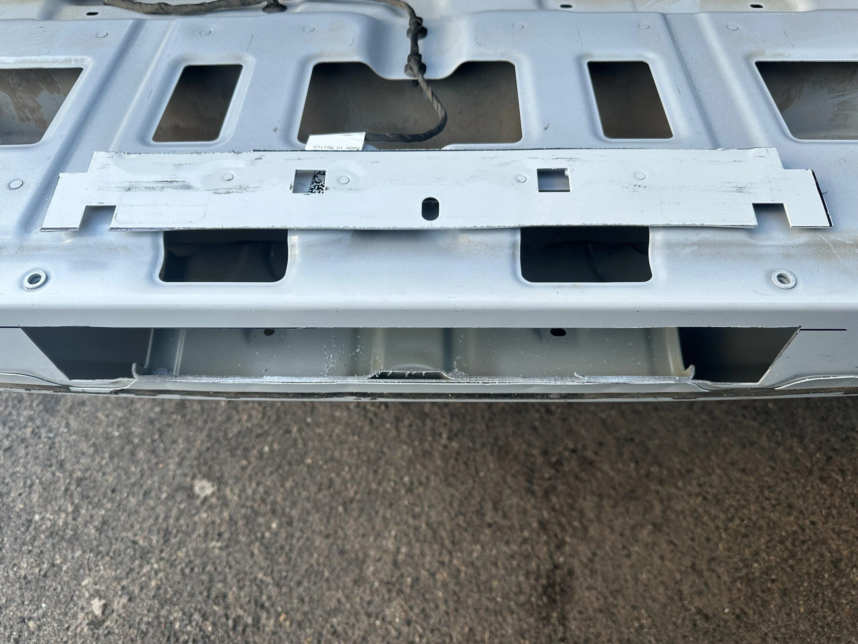

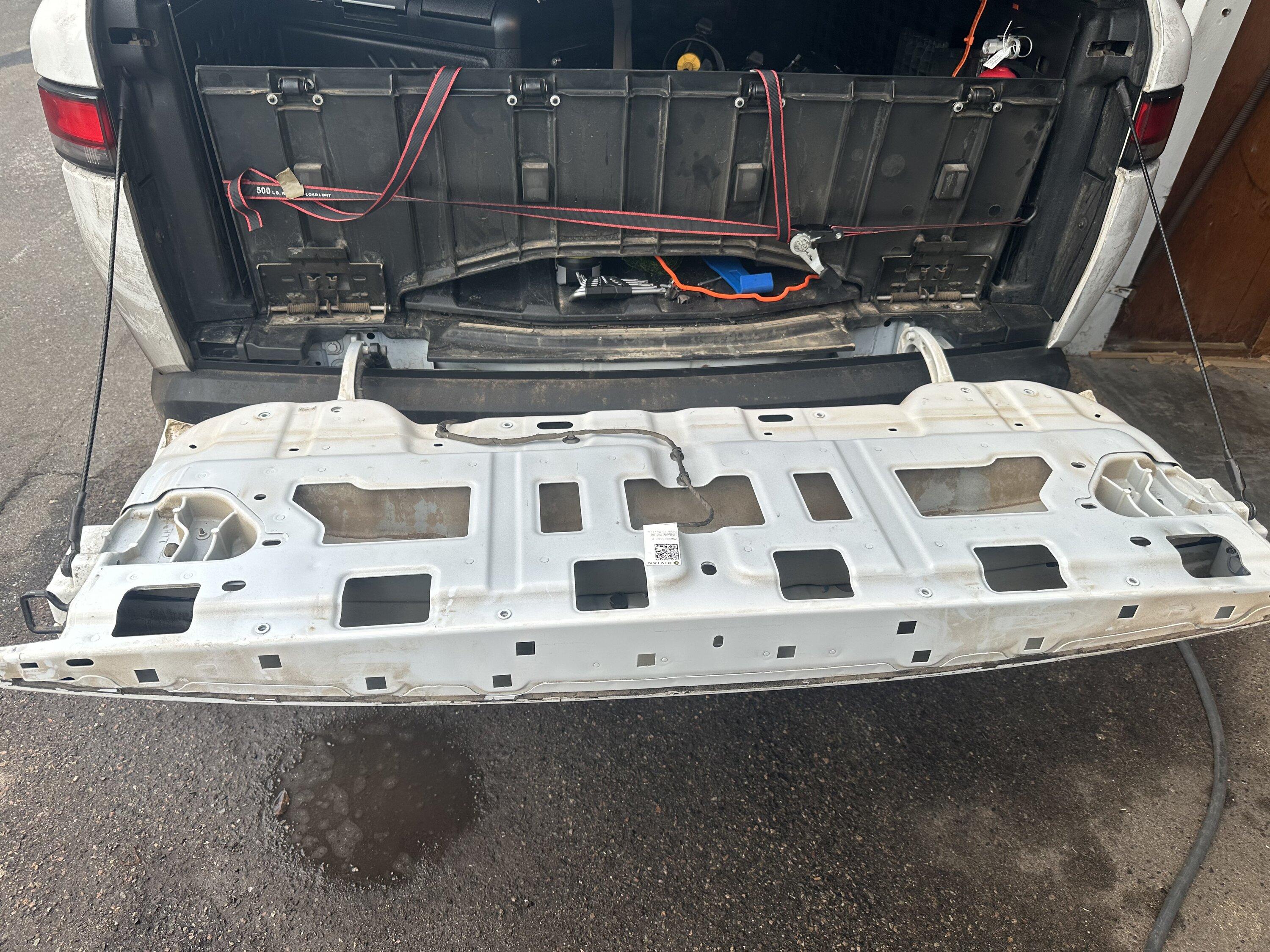

I decided to add a tailgate step/ladder to my truck bed.
I took off panels
Only a few torx bolts to remove
The top panel snapped a bunch, gonna be cut up anyway so I’m not too concerned
Rivian R1T R1S DIY mod - Adding hidden tailgate step ladder on R1T IMG_1335
I tried to keep things in line with the ribs going down the middle, that puts it about 18” wide
Rivian R1T R1S DIY mod - Adding hidden tailgate step ladder on R1T IMG_1337

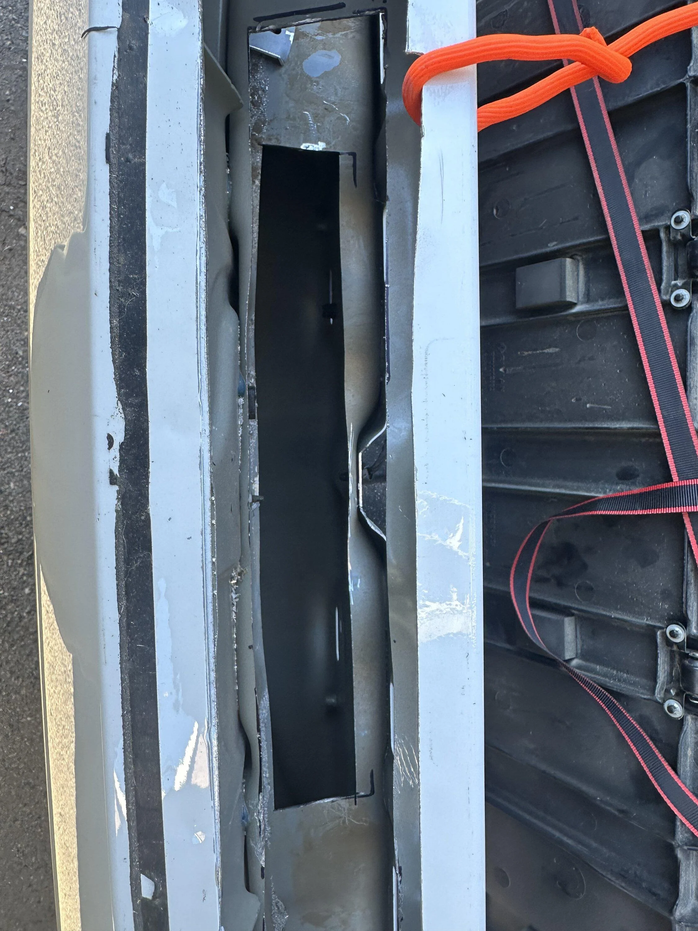

The area has internal chambers around 4-5 inches deep
I cut through two middle walls to get the full depth unlocked, looking at 17.5” deep
Rivian R1T R1S DIY mod - Adding hidden tailgate step ladder on R1T IMG_1338
Space was limited and I was working with a reciprocating saw and an oscillating tool.
It would be easier if I had a smaller form factor vibe saw and/or an air saw, since space is so tight.
I now have a chase that is roughly 2.5x18x17.5 to fit telescoping hardware in

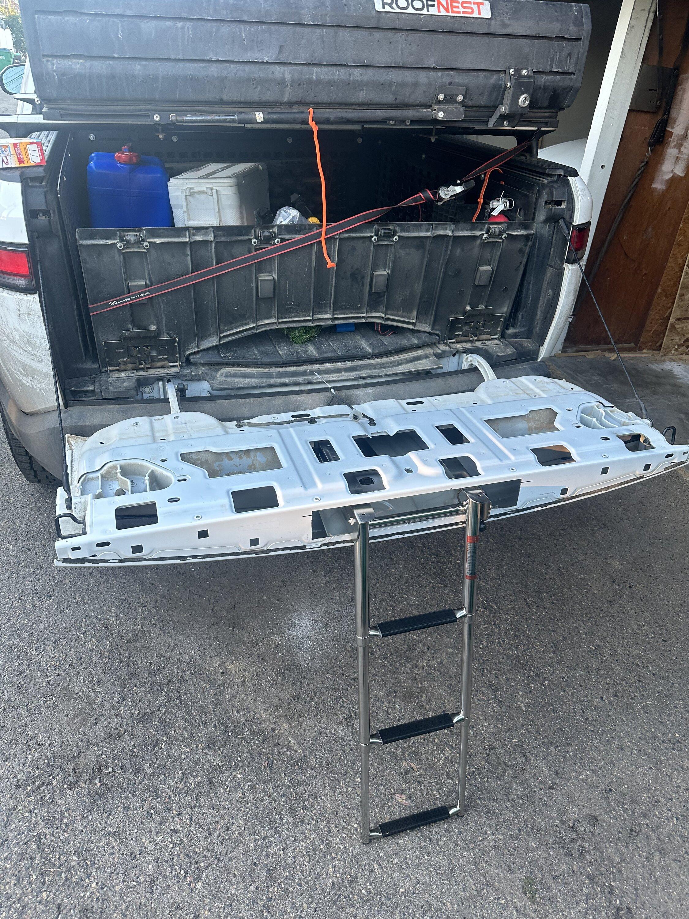

I tried this transom ladder off of amazon:
Transom Ladder
I will need to add about two inches of movement to make it so the ladder can fully tuck in but also come out enough to pivot down properly.
Rivian R1T R1S DIY mod - Adding hidden tailgate step ladder on R1T IMG_1340
This is standard mode height.
The rungs fully extend and the bottom one has very minor play.
The ladder is rated to 300lbs, may cut a rung (or two) off the bottom so it fully on the tailgate (also would help with stowed mode spacing)
Once I get this boxed in and mounted the next step will be to make the stealth cover with the trim, current idea is to make the cutout and put the "cover" on a spring hinge
Any suggestions/ ideas are welcome!

cool idea. you might want to add a reinforcement up under the corner, in the area you cut away the tailgate, so it doesn't bend when you step on it. Looking forward to more progress posts!

I suggest keeping the ladder a bit long if possible as you won't always be parking on level ground, but maybe it doesn't rely on ground contact for stability. If so then a dangling one is fine like other trucks. Some even have a grab bar but can you grab the bed?
If the track was also telescoping by a couple inches you could hide the whole thing. You'd have to build a frame. You could also just mount a rectangular foot to the end of the ladder that would cover the hole when stowed. Don't forget about rattles as best as possible or it will drive you nuts. A pull tab/handle will be better than a grab hole so nothing falls inside the tailgate.

This particular ladder is made to be weight bearing from the top (original design is hanging from a boat).
Currently building the frame, not sure if I make one for the whole space and make a wider step or use this as a v1.
For the cover I am using a push latch. so no holes and will stow snug.
The frame will have springs at the bottom and I will be making a gasket at the top to help cut down on intrusion and noise/ vibrations
