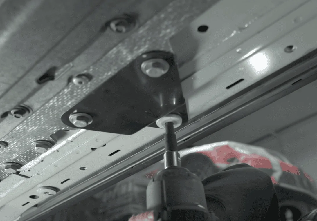

Try a breaker bar?
LOL, I wish I had a lift for this. It’s mostly fine but I’m not a skinny dude which made the panel removal pretty entertaining.
There’s a local shop in town that specializes in off-road stuff, so I’m cautiously optimistic they’ll be able to break this thing loose for me without me needing to buy a breaker bar I’ll use once. 😅

@obfuscurity, that impact wrench should be sufficient so she’s on there. Agree a torch isn’t the smartest, but maybe a heat gun would be enough? Maybe remove the other two hex bolts first and give the bracket a targeted hit or two CCW?
Also, a Torx TP55 plus bit is needed, not T55. Big difference.

I don't risk stripping the bolt or the T55 bit, so I guess my next option is to take it to a local shop and ask for their assistance. I assume that putting a torch anywhere near this is a bad idea, yes?
That little 1/2" to 3/8" adapter you have absorbs a LOT more torque than you imagine. Guessing you got it but if not you may have to break it loose by hand.

Just got back from the shop. They were successfully able to break that bolt loose. I had them go ahead and loosen (and re-tighten to 100 lb-ft) all four of those bolts mounted to the brackets, since those seemed to be the hardest to remove.

How did they do it? Asking because I'm sure others will have the same issue.
AllInev
Nov 22, 2021
1,076
1,707
Oakland, CA
Prius V, R1T
Breaker bar. I don't have specifics beyond that (did he use the DCE-supplied TP55 bit or one of their own, i.e. 1/2" vs 3/8").

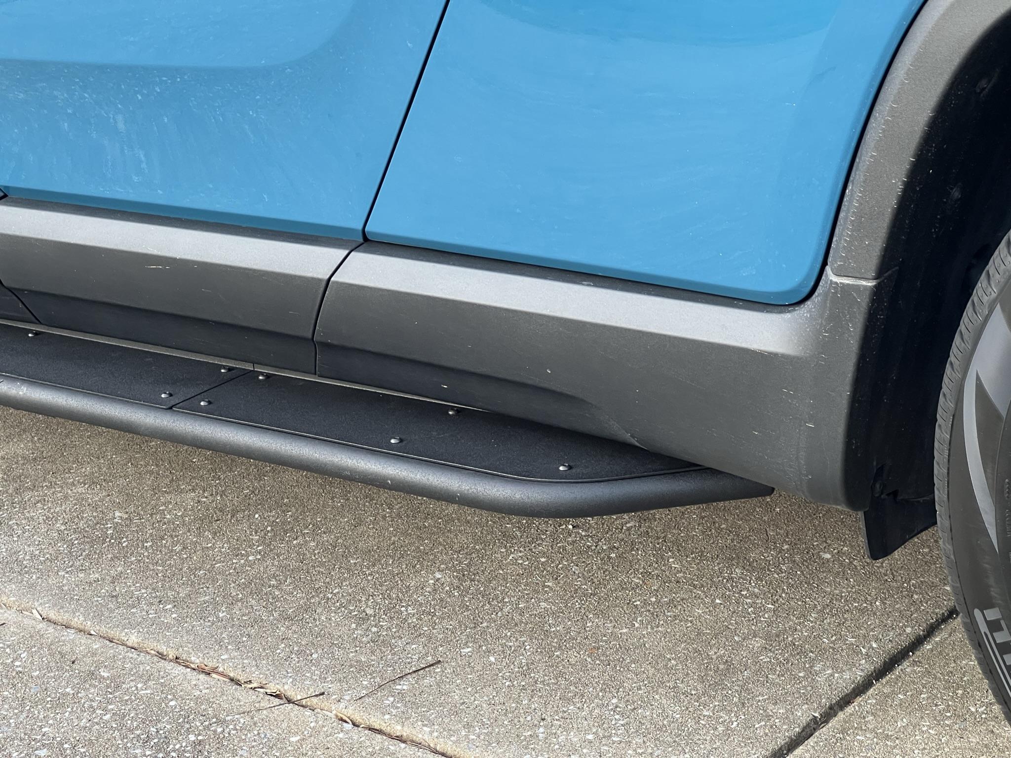

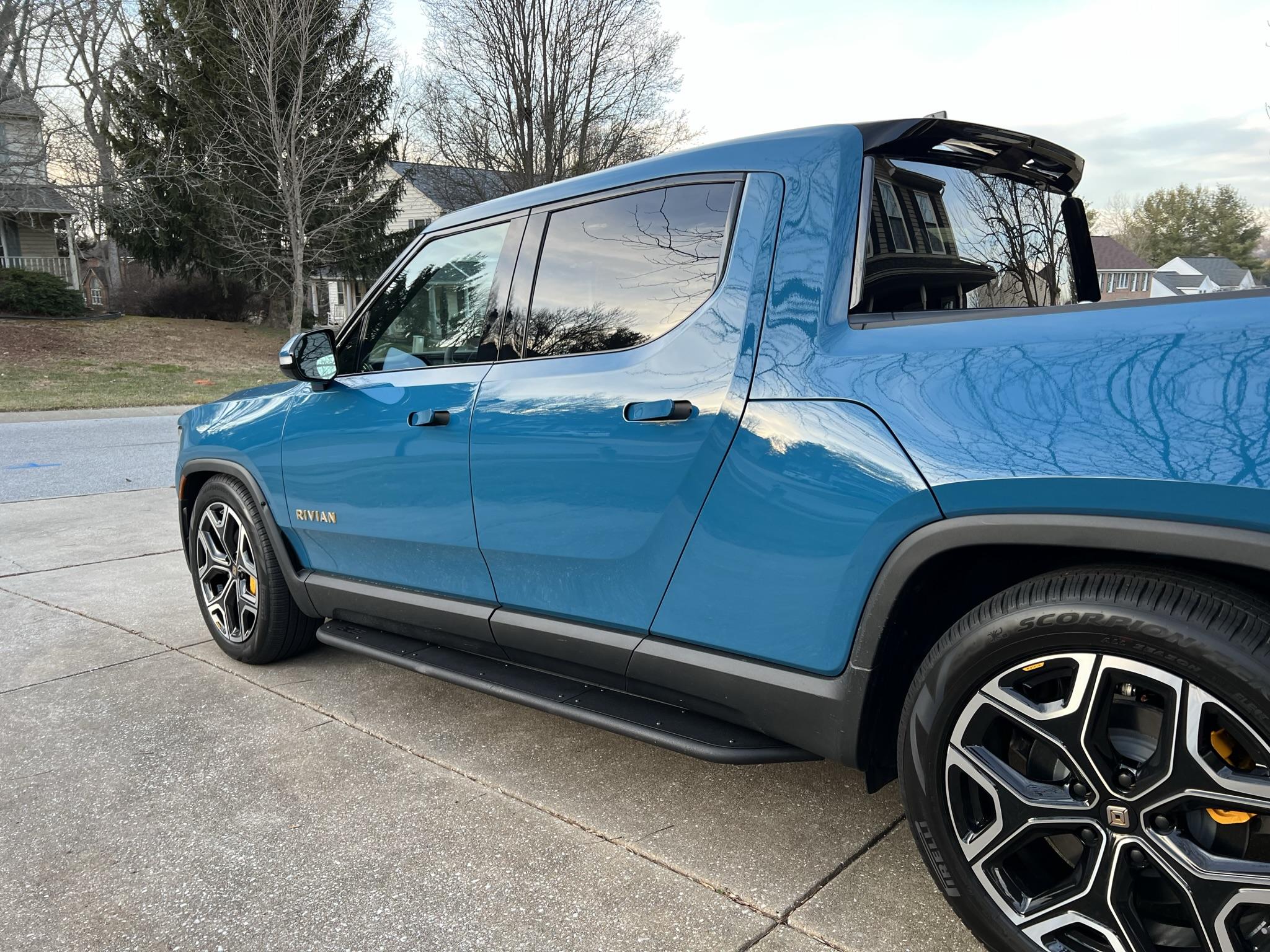

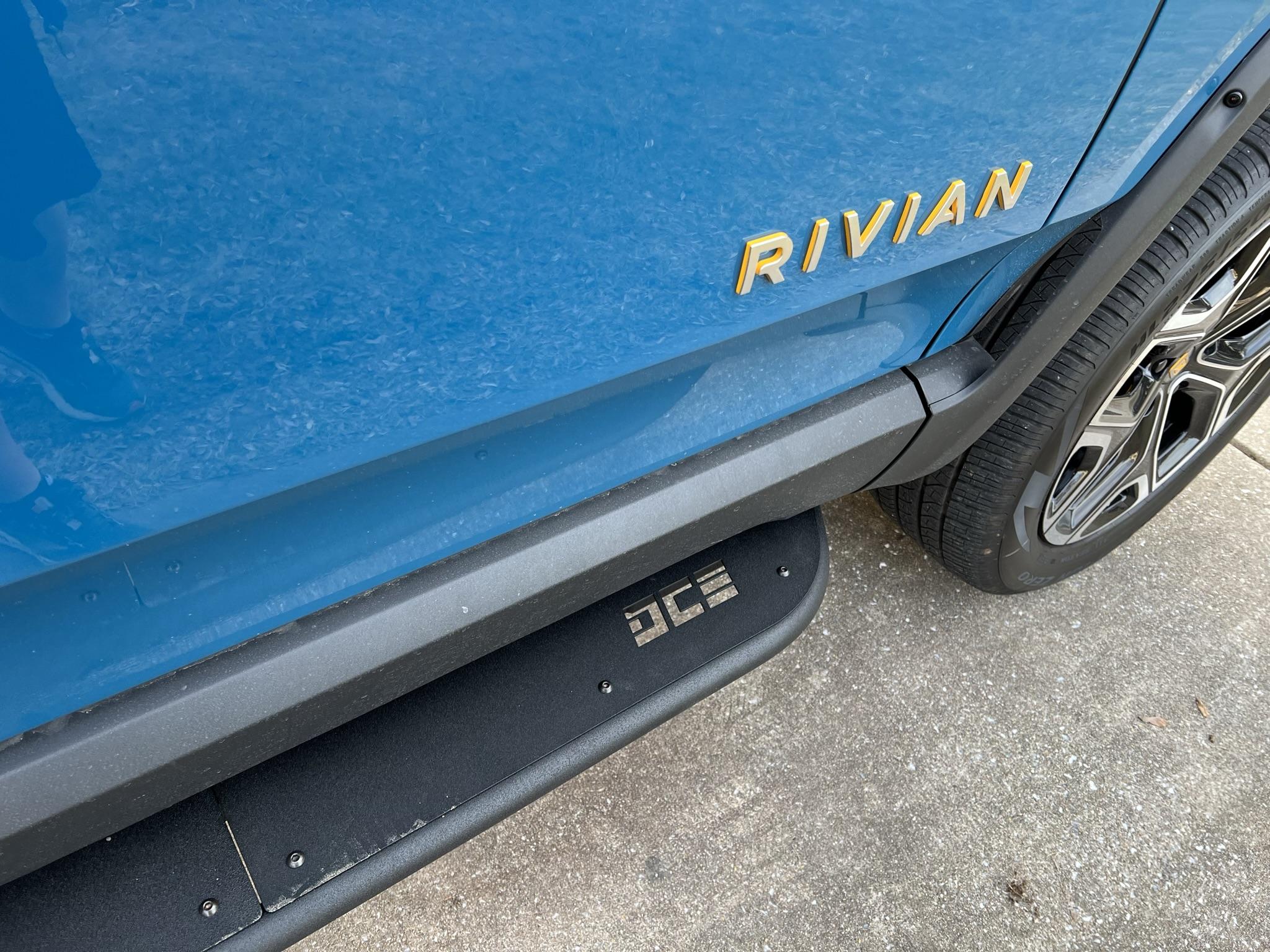

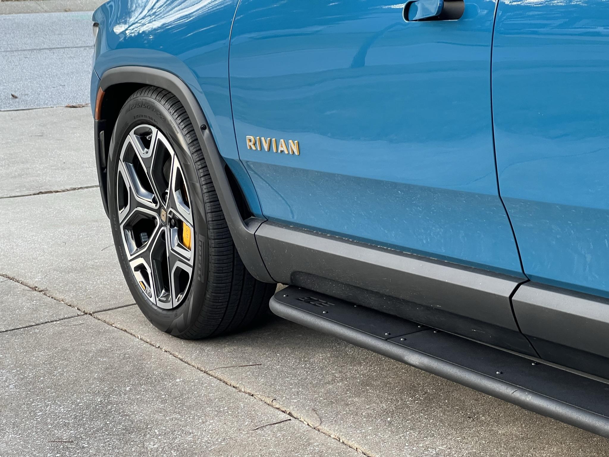

The quality is indeed excellent. Although it appears that Rivian might have made some subtle changes in the underbody hole locations (the two M10 / 15mm head bolts provided by DCE went unused in my case), the end result was exactly what I was hoping for. Grip is excellent and the wife loves them. She even hopped in with the truck still at full height without even realizing it. 😄

I've communicated with DCE regarding the hole changes and unused hardware, along with my VIN number. I stand by these sliders but I also look forward to DCE updating their install video and included parts to reflect the possible redesign(s) from Rivian.

Can't for mine to be shipped. Once I saw the how clean the underside looked, i decided to buy. Thanks for posting pics
