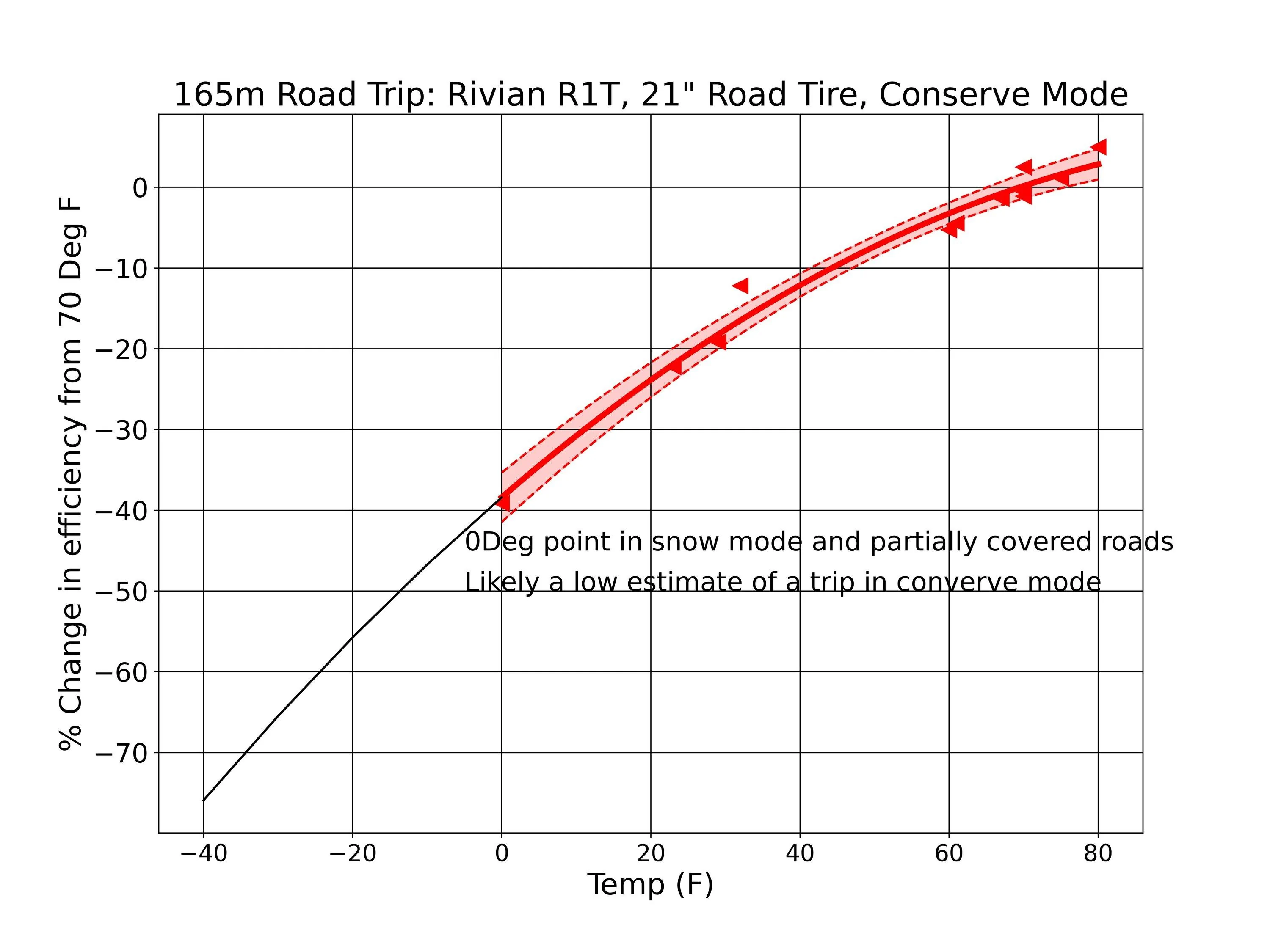

Sorry if I'm being repetitive with this data....... But I'm putting it on every thread about range loss in cold weather because I think this large data set is more helpful to people than single observations or anecdotal comments about the effect of temperature.
Cold weather significantly reduces range with EV's. More so on short trips than long trips. This dataset is representative of range/efficiency loss during a long road trip when the battery has had time to get up to operating temperature.
Bummer. Looks like my drives in -60F are out of the question.
