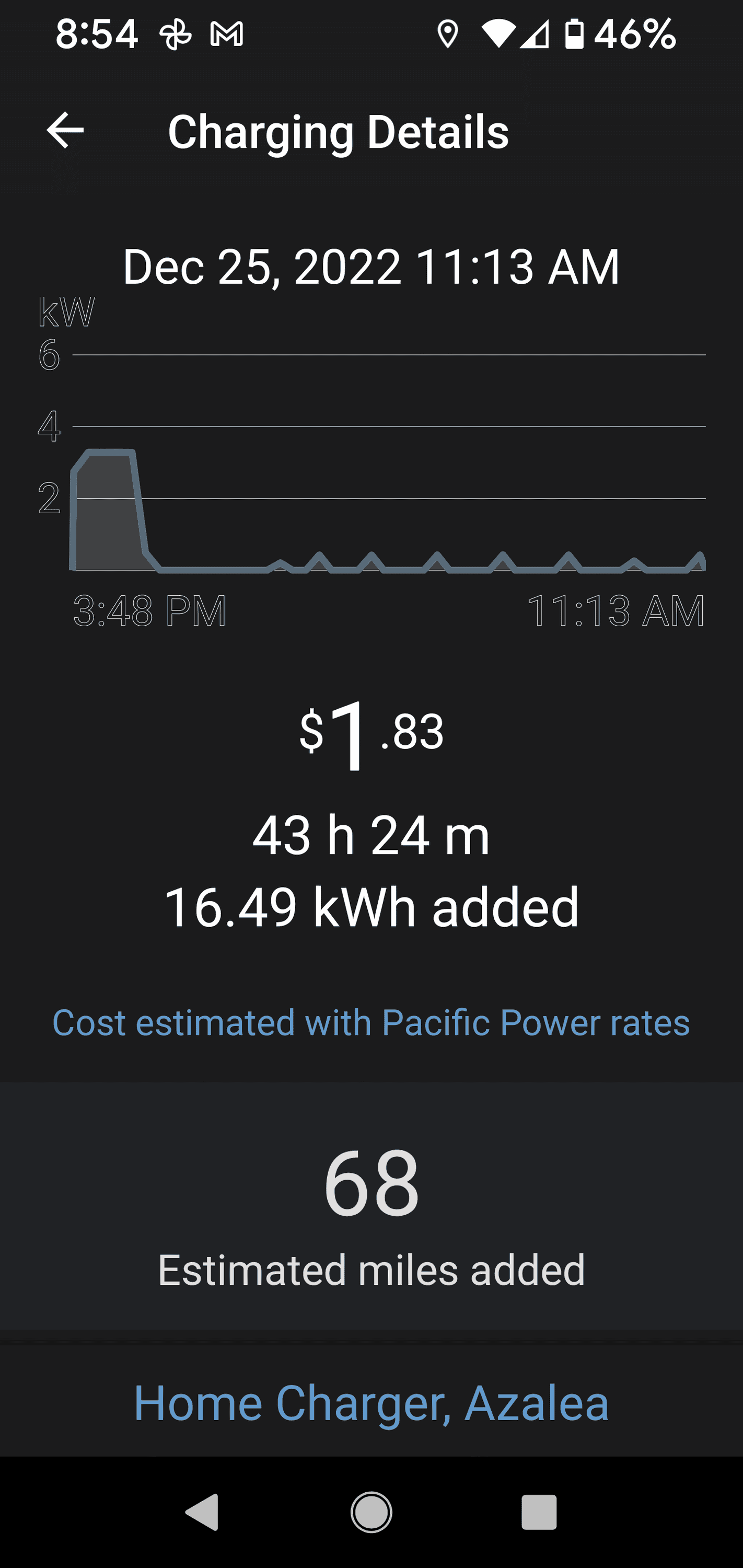

There is some less-than accurate information being tossed about here.
Q: "Will the vehicle maintain the battery pack at safe temperatures if I leave it plugged in?"
A: YES. At least it _better_.
I was not involved in the design of the Rivian BMS, but I have designed & built the BMSs in a half dozen other OEMs. Rivian is not stupid, they are going to use best practice.
Rivian R1T R1S Cold weather Kills the battery! Screenshot_20230102-085418
This is a shot of the draw behavior of a 2015 Spark EV plugged into a ChargePoint home Flex EVSE at about 32 degrees Fahrenheit. You see the power draws as it uses the battery heaters to keep its pack from freezing. Now mind you, this is a 10-year-old pack using 20-year-old tech. I would find it hard to believe that Rivian has not caught up with 20-year-old GM technology, so I would find it equally hard to believe that it is not using similar battery protection algorithms.
While it is technically true that it will not damage a pack to "freeze" as stated by one poster, it certainly _will_ damage the pack to use it at temperatures below 32F; that includes charging or discharging the pack. That being said, if you were to drive the vehicle with the pack below freezing, you would damage it. So the BMS _must_ keep the battery from freezing to allow it to be used (otherwise, you would have to wait until the battery warmed up to use the truck).
All OEM EV builders I am familiar with recommend leaving the vehicle plugged in when not in use if at all possible in very cold or hot weather. This is to allow the vehicle to use shore power to keep the battery at operational temperatures. I am new to Rivian, but I would be stunned if they did not use all of these best practices for pack longevity, and would ask for my deposit back.

If you want to charge the battery, you should never charge it if the battery is 32 F or below. From what I have read, it can severely damage the battery. That is why the battery should never be allowed to drop below freezing.
The batteries are fine to get below freezing, just have to warm up before chsrging(including via regenerative braking). Have cold soaked an tesla model S at -30 more then once...
No. It is _not_ ok for your battery to freeze. If you charge/discharge it at extreme temperatures, it _will_ damage it.
-Regenerative braking is charging the battery.-
When you cold soaked your Model S, Tesla's BMS made sure that the actual pack temperature did not go below safe (32F). That is how it is designed. If something happens that prevents the BMS from doing this (like your pack drains too low) the BMS will not allow you to start, use or charge the vehicle until the battery is back within safe temperatures. This is rare, because the car and the ap will give you a lot of warnings first.
