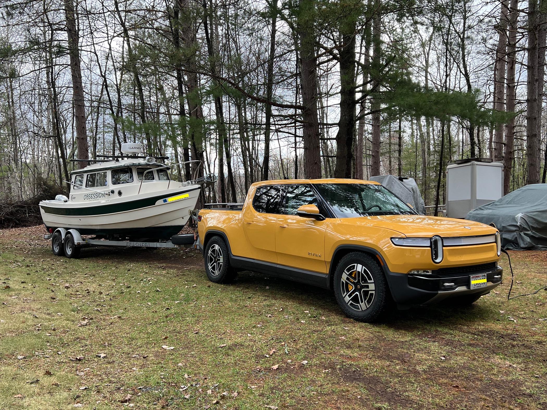

Boat towing this 5000 lb boat/trailer with my diesel truck cut mileage in half--it also cuts our R1T range in half. Our R1T with its stock 20" wheels/tires gets 1.3 mi/kWh towing this boat on our narrow, curved secondary roads at 50-55 mph. The R1T's weight, power, regeneration braking (and quiet) is a much safer/pleasant towing experience. At our steep Lake Superior ramp yesterday, the R1T retrieved the boat with no fuss. Our friends diesel truck with a similar boat really strained/slipped on their retrieve.
Rivian R1T R1S Towing the boat today IMG_1848
