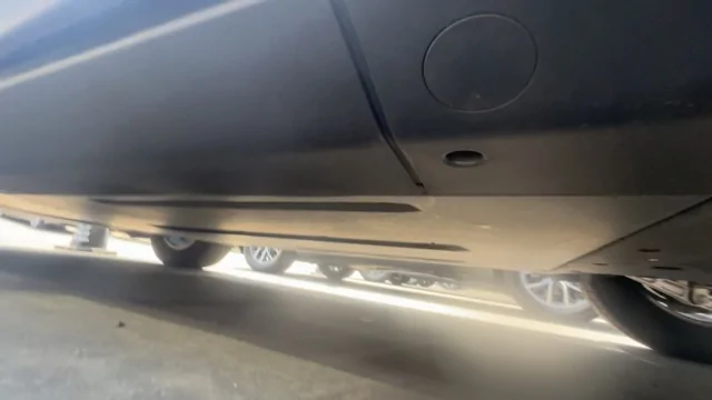

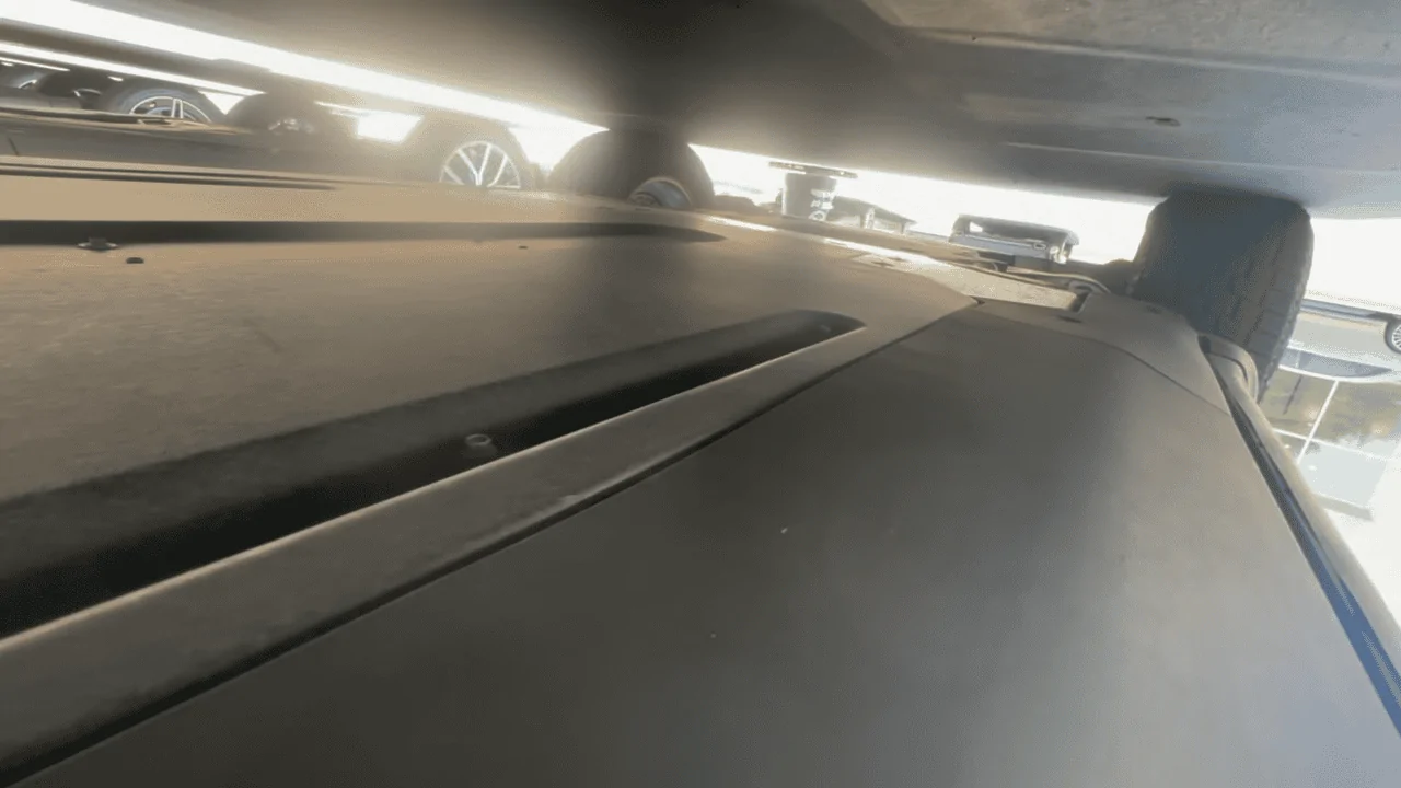

I'm buying a 2023 R1S Quad from out of state. It has the 20" all-terrain dark wheels and I'm hoping it wasn't one of the rare birds that didn't have an underbody shield. Please take a look at this video the salesman sent me and let me know if it indeed has the shield. Thanks in advance.
i
Pretty sure this does NOT have the RUS (Reinforced Underbody Shield). And I don't think it is a "rare bird" to not have the RUS. Many (most?) of the early adopters don't have the RUS.
That said, the standard battery shield is pretty darn good. Unless you're planning on some hard-core or frequent off-roading on rocky roads, the standard battery underside protection should suffice.
As for the sleazy (perhaps just uniformed?) salesman's assertion, you can let him know that this vehicle does not have Rivian's RUS.
The one you are looking at doesn't seem to have one.

Nearly impossible to tell by simply looking under the vehicle. That cover would need to come off to difinitively tell.
Very easy to tell from the pics. The long oval recessed areas are non rus. Rus has flat bottom.

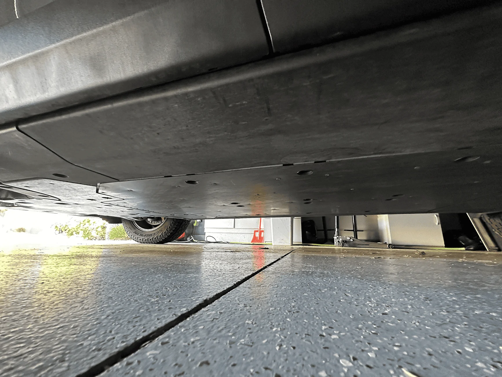

I have the RUS on my 2022 LE R1T. The RUS bottom is much smoother than the pictures in the OP. Mine looks like the picture in #5. Conclusion - the vehicle in the OP does not have a RUS.
You can also tell by the weight sticker on the driver's side door jamb. The RUS weight several hundred pounds, so the load rating will be reduced. There are threads where you can find the weights of various configurations.
nope this is not the underbody shield. the dead giveaway are those two "channels". the shield does not have that.

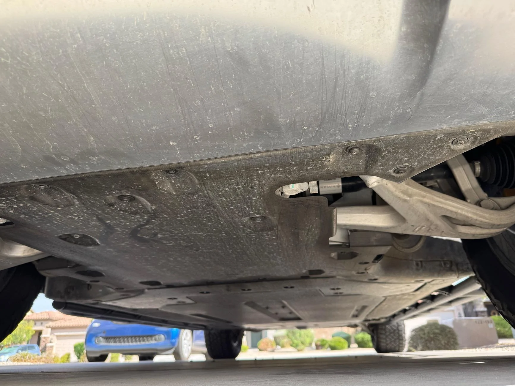

I believe mine does not have it also, and have wondered how hard it would be to add it. Anyone know? And is there a way to get build sheets like you can get for most other brands?
