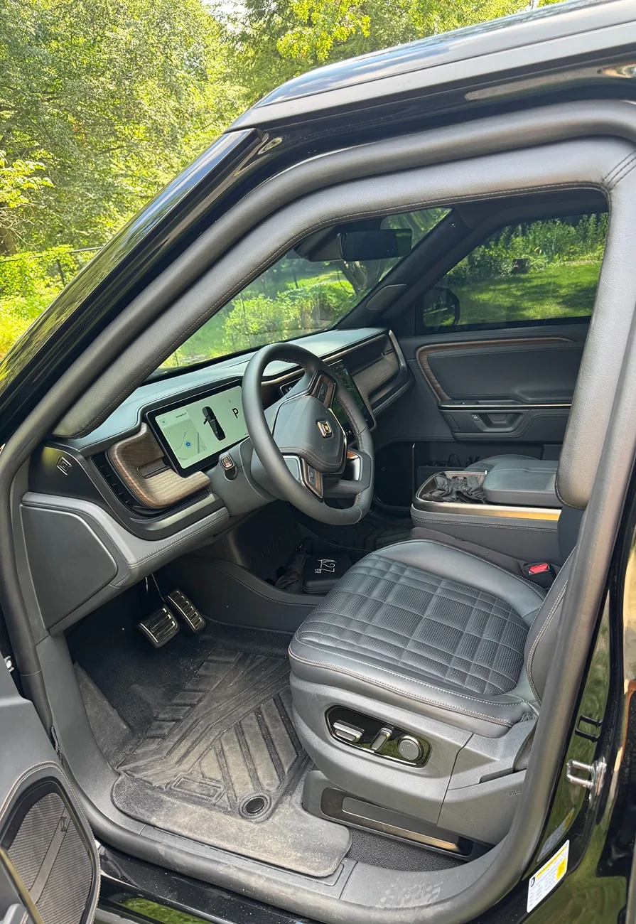

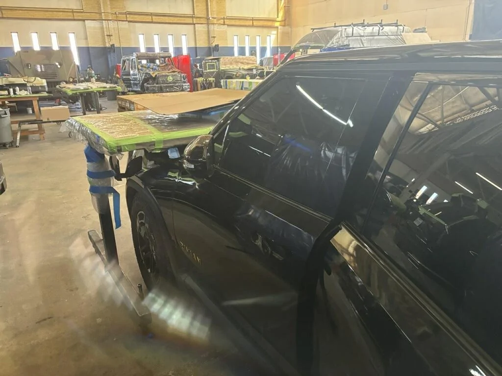

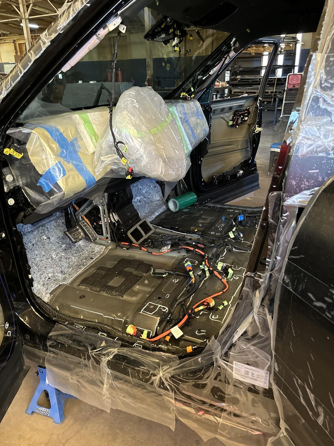

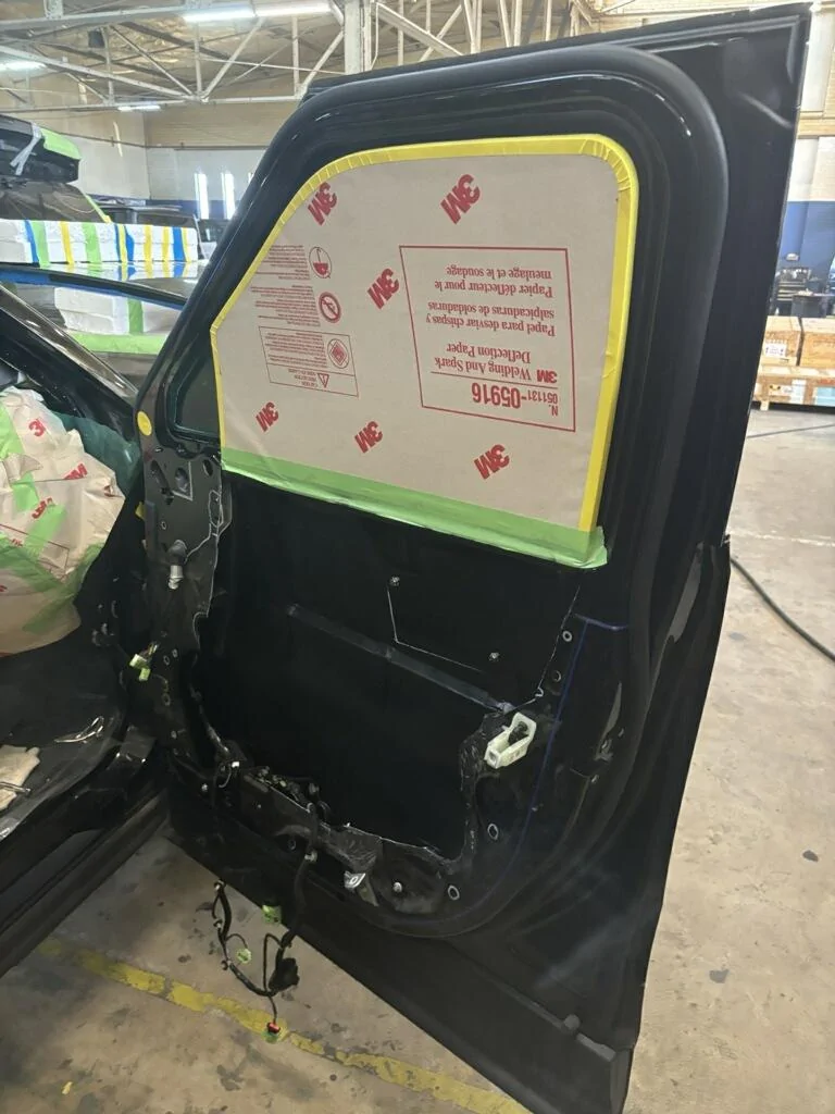

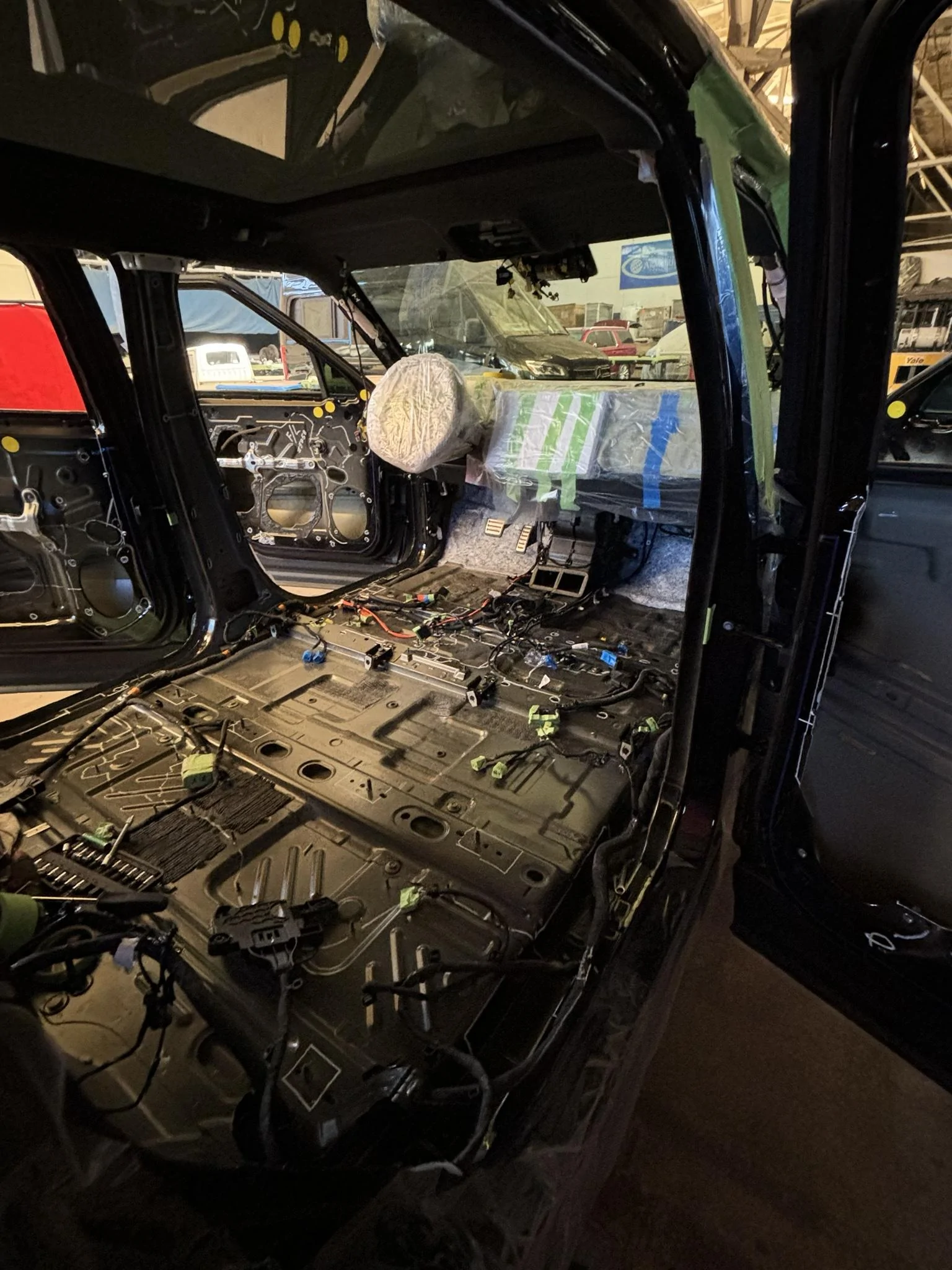

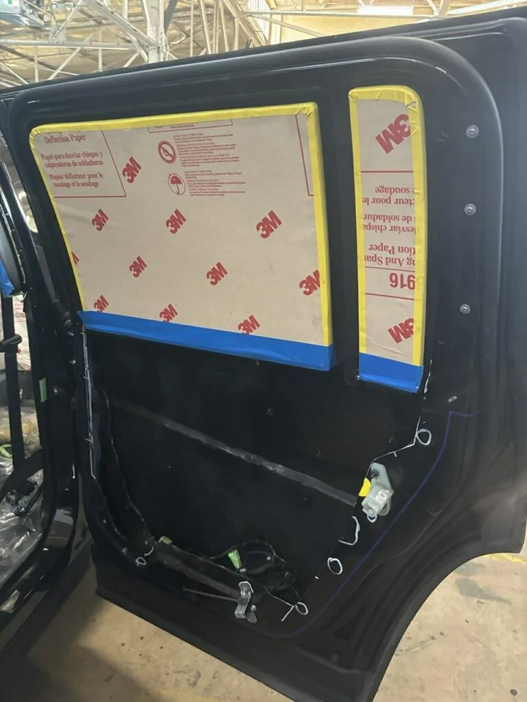

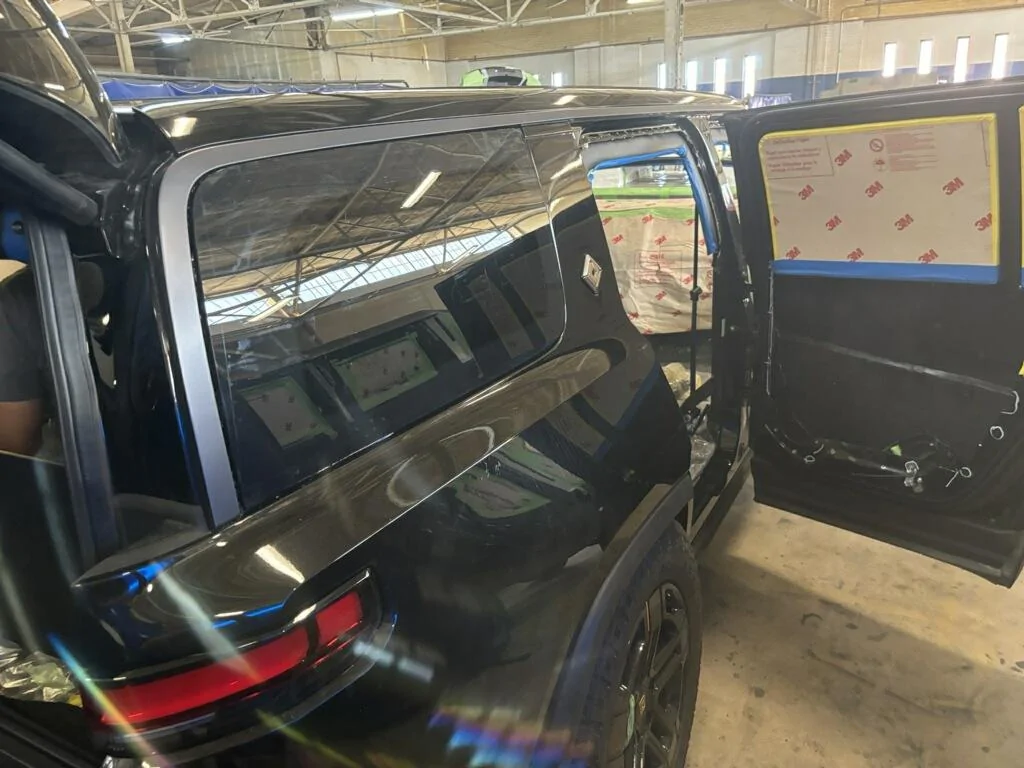

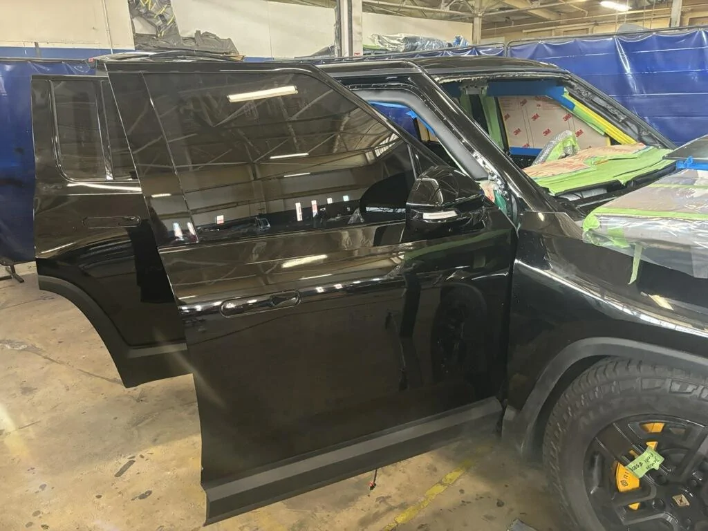

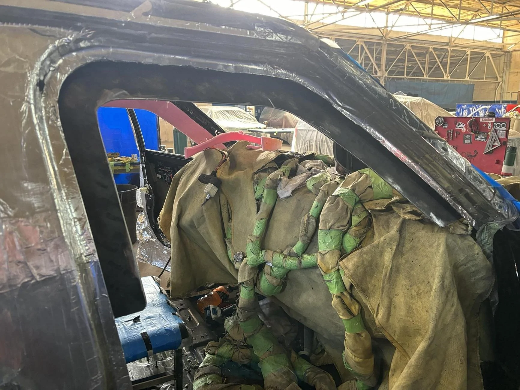

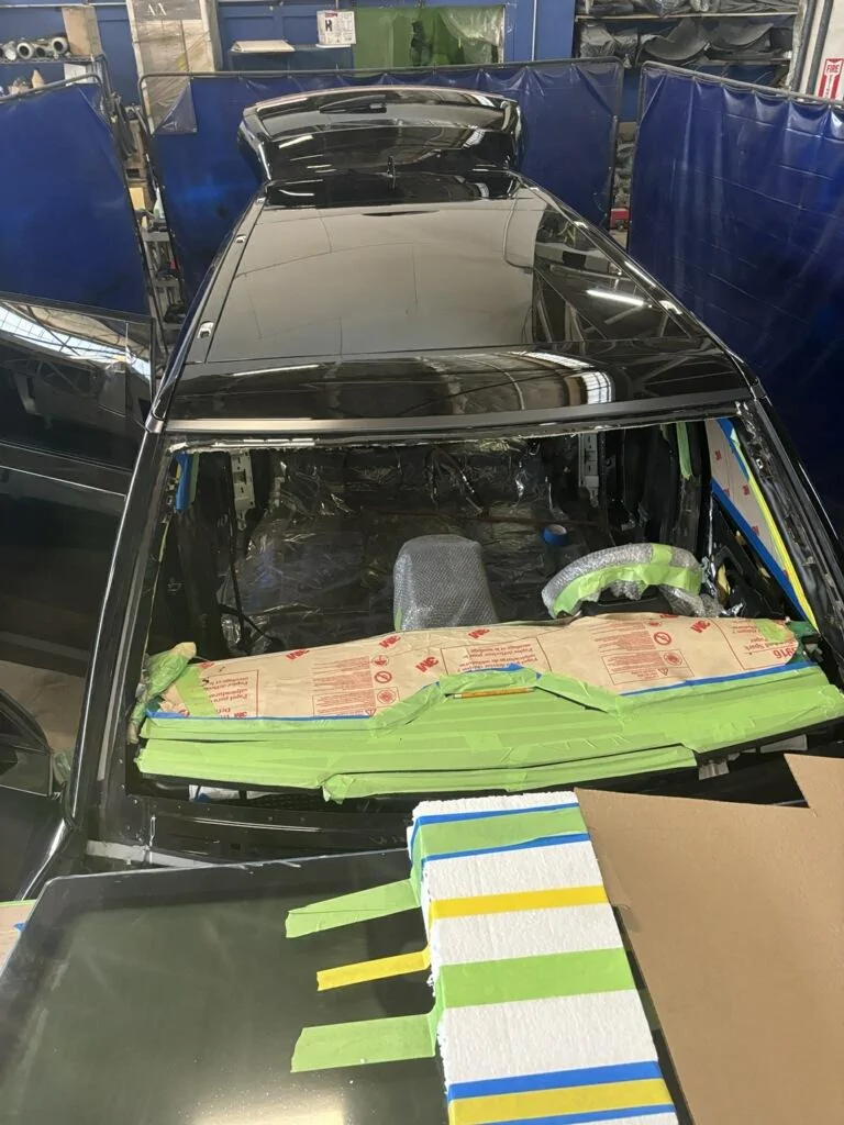

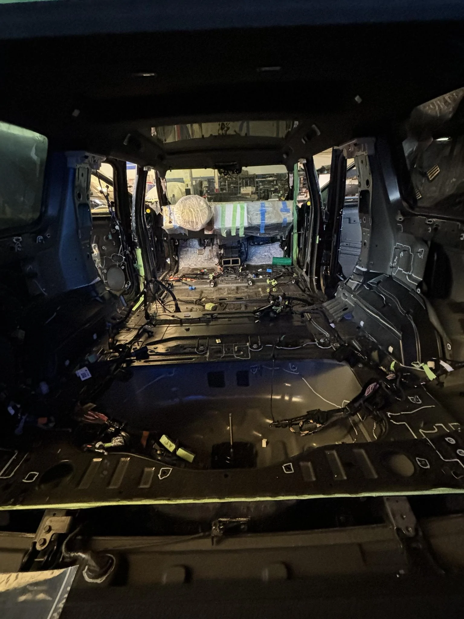

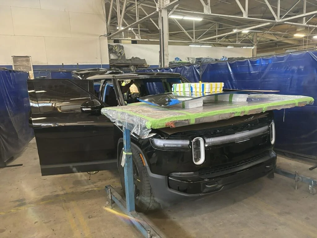

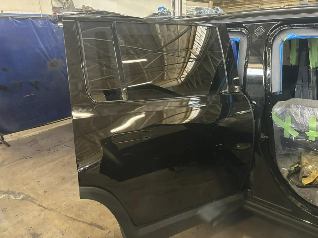

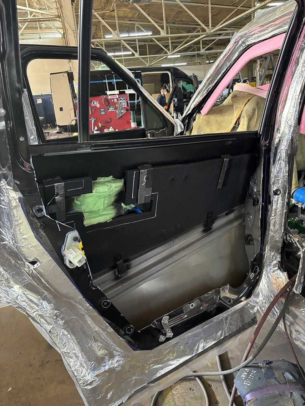

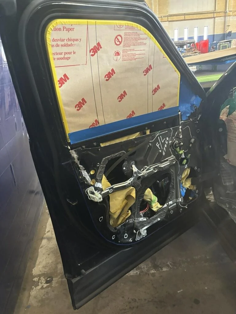

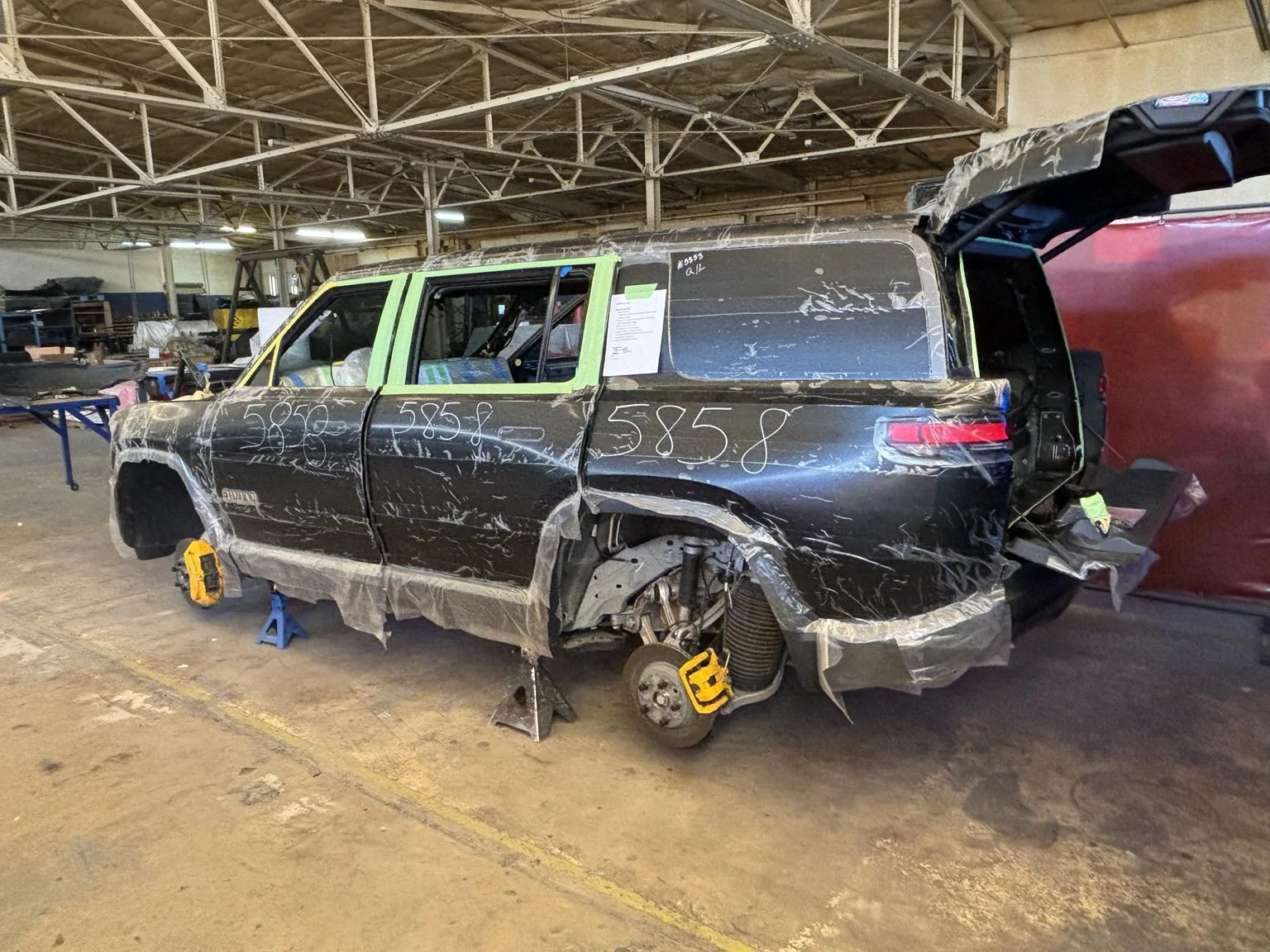

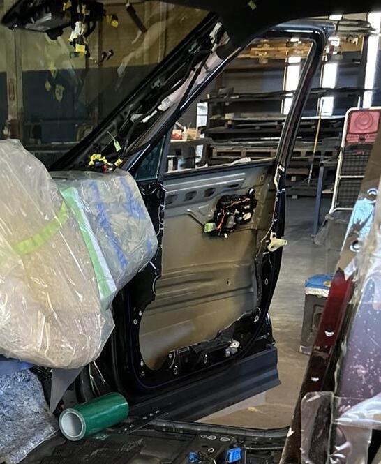

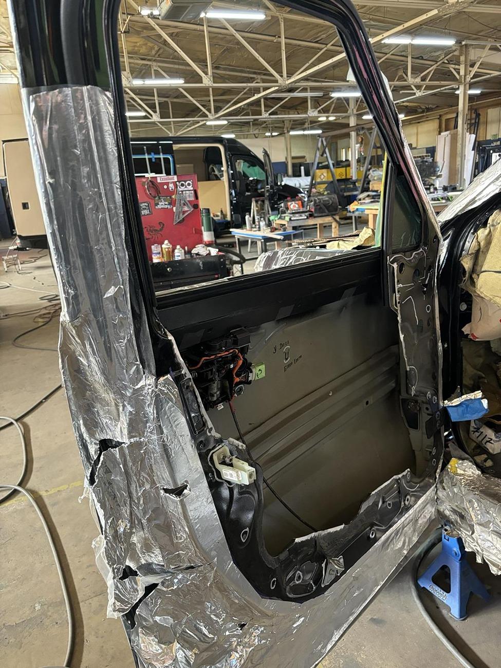

I was surprised to see a section labeled "Armor" here but I'm not seeing actually armored Rivians. We have on in the process of being outfitted with ballistic glass & armor panels to the entire thing will be rated to withstand 5.56/308/7.62x39 etc.
Will update with more photos once it's complete. Likely a one of a kind project here.
Rivian R1T R1S Did someone say Armor? Real Ballistic Armored (Bulletproof) R1S Tri Motor in production process... image_0 6.JPG
Rivian R1T R1S Did someone say Armor? Real Ballistic Armored (Bulletproof) R1S Tri Motor in production process... image_0 5.JPG
Rivian R1T R1S Did someone say Armor? Real Ballistic Armored (Bulletproof) R1S Tri Motor in production process... image_0 4.JPG
Rivian R1T R1S Did someone say Armor? Real Ballistic Armored (Bulletproof) R1S Tri Motor in production process... image_0 3.JPG
Rivian R1T R1S Did someone say Armor? Real Ballistic Armored (Bulletproof) R1S Tri Motor in production process... image_0 2.JPG
Rivian R1T R1S Did someone say Armor? Real Ballistic Armored (Bulletproof) R1S Tri Motor in production process... image_0.JPG

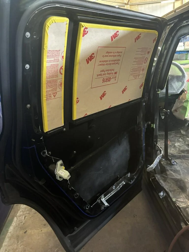

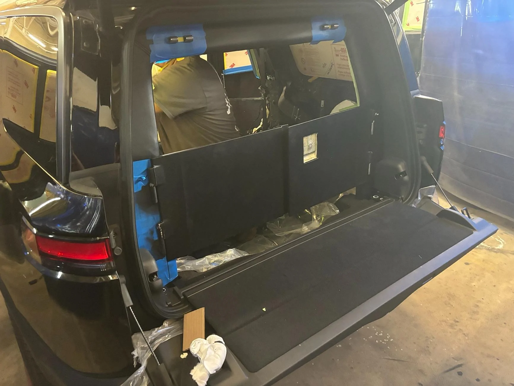

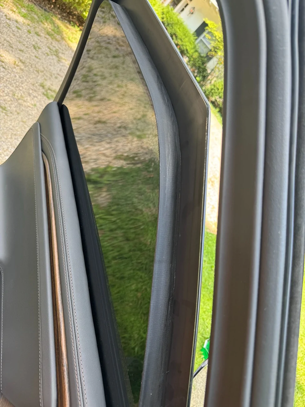

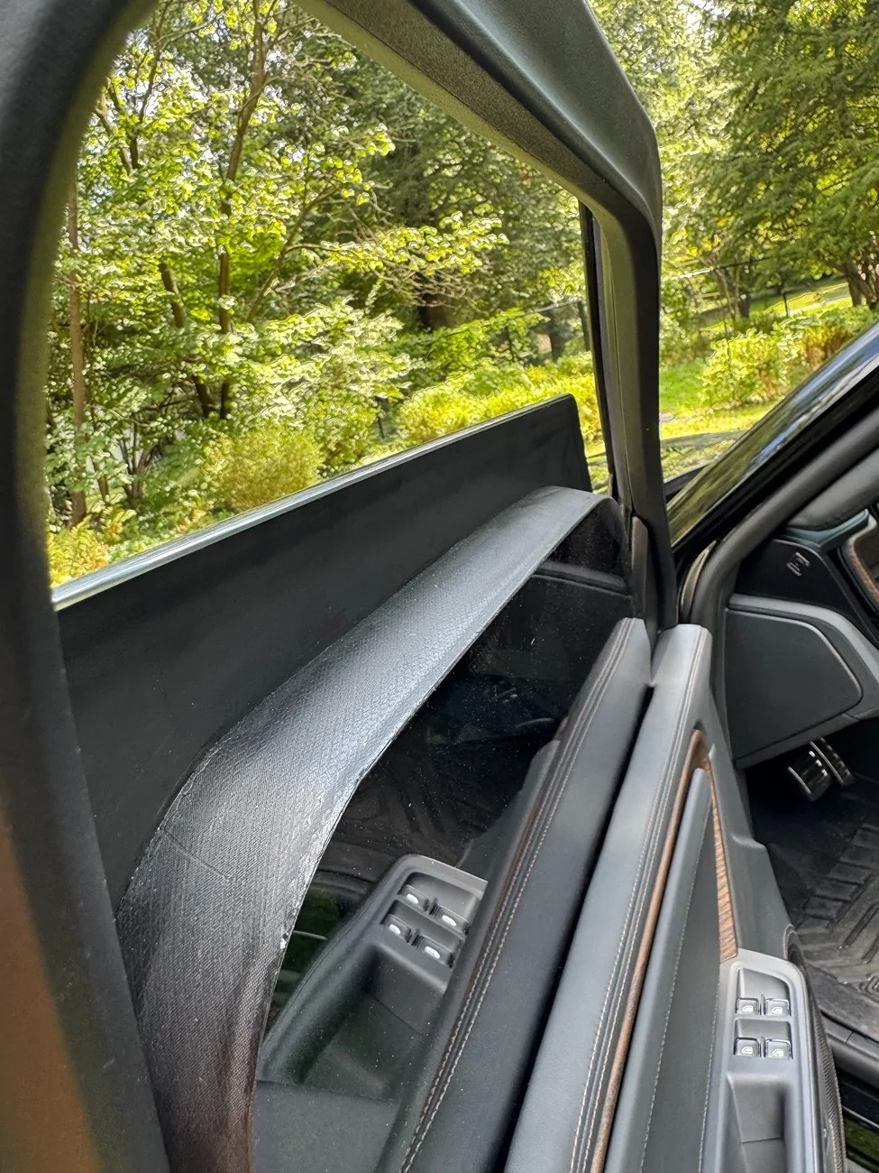

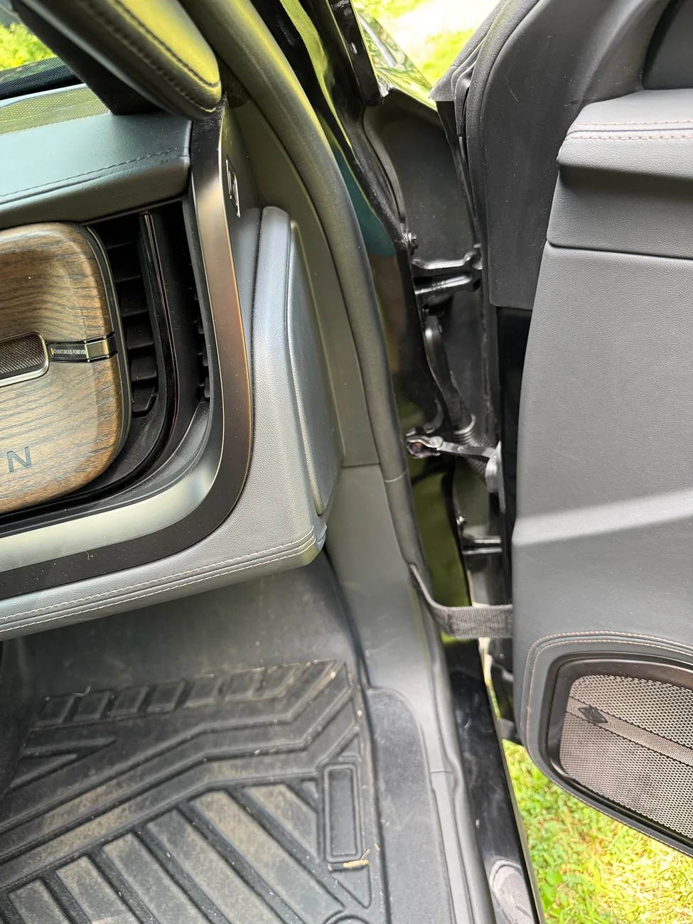

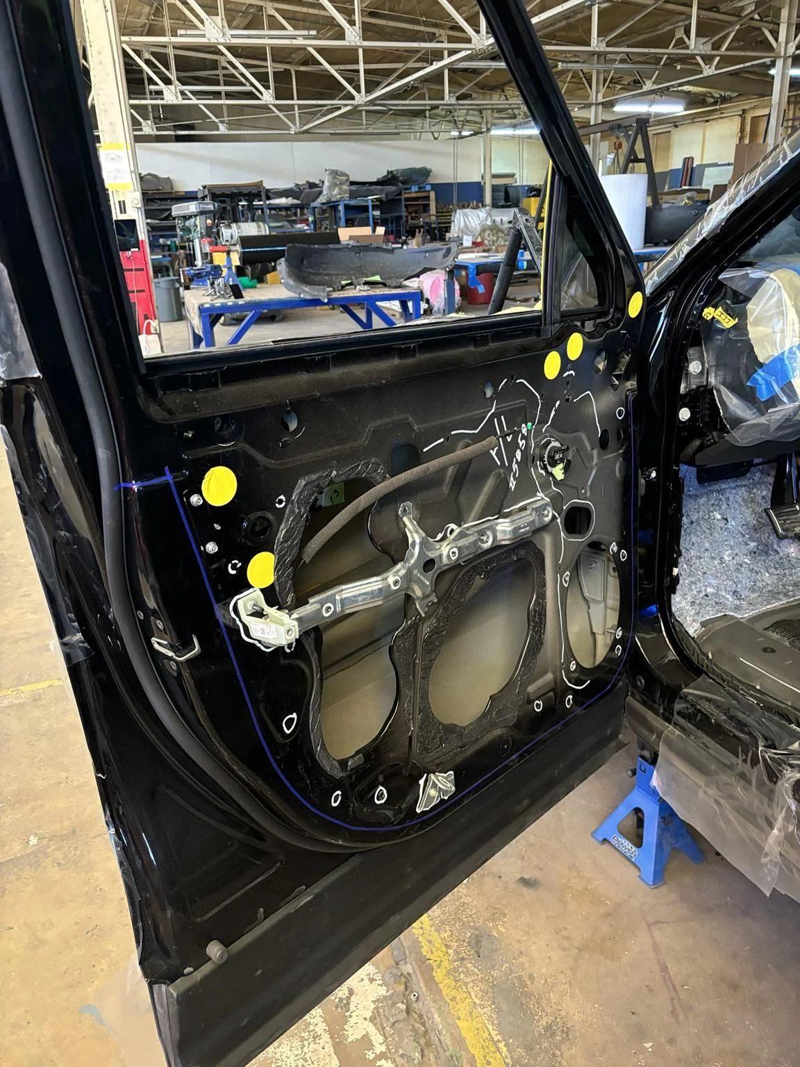

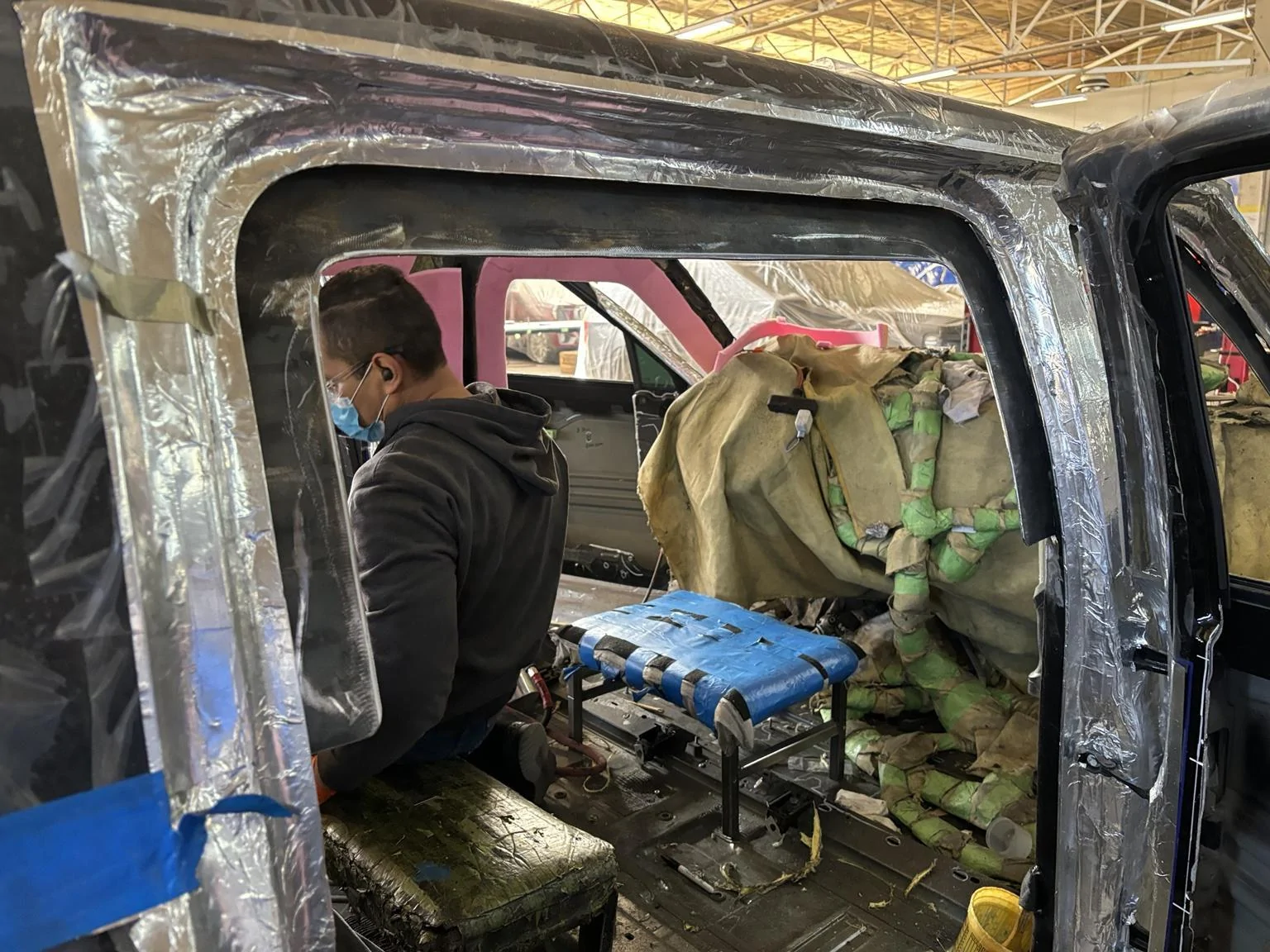

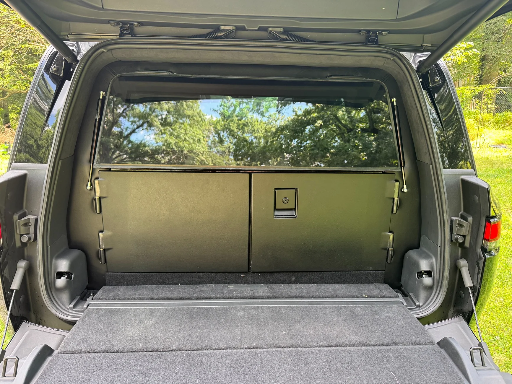

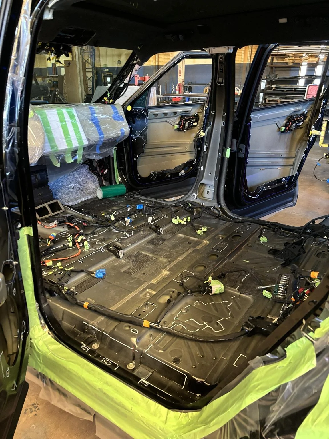

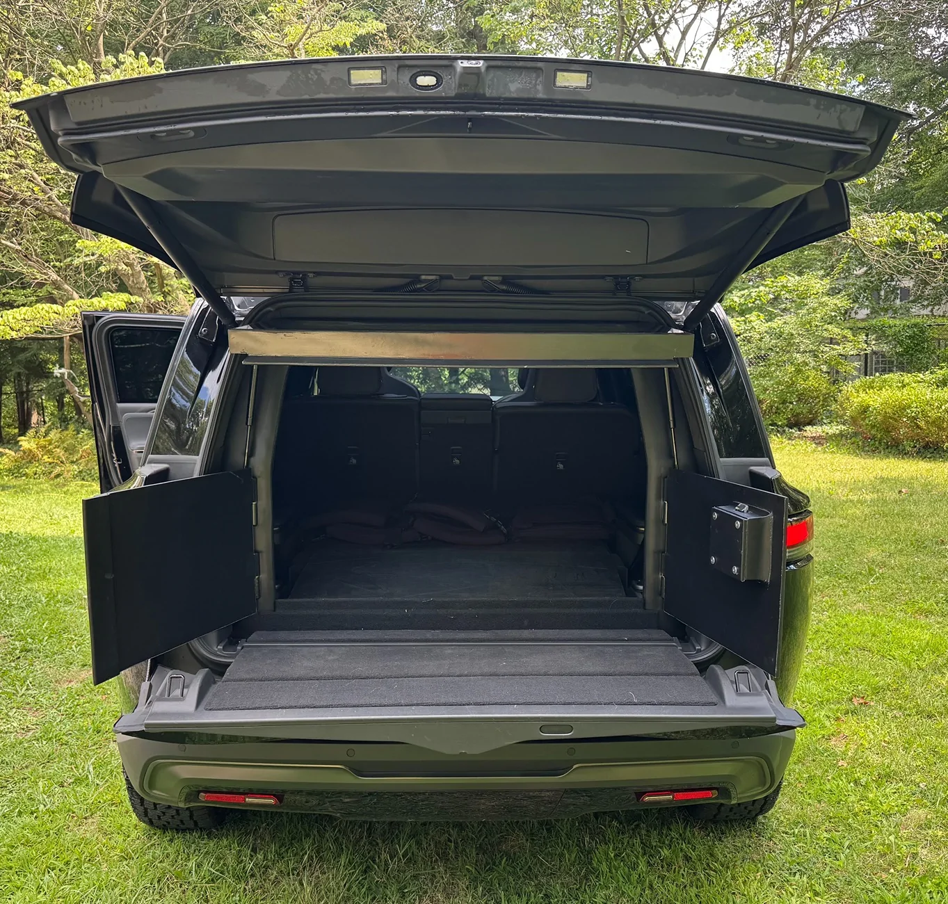

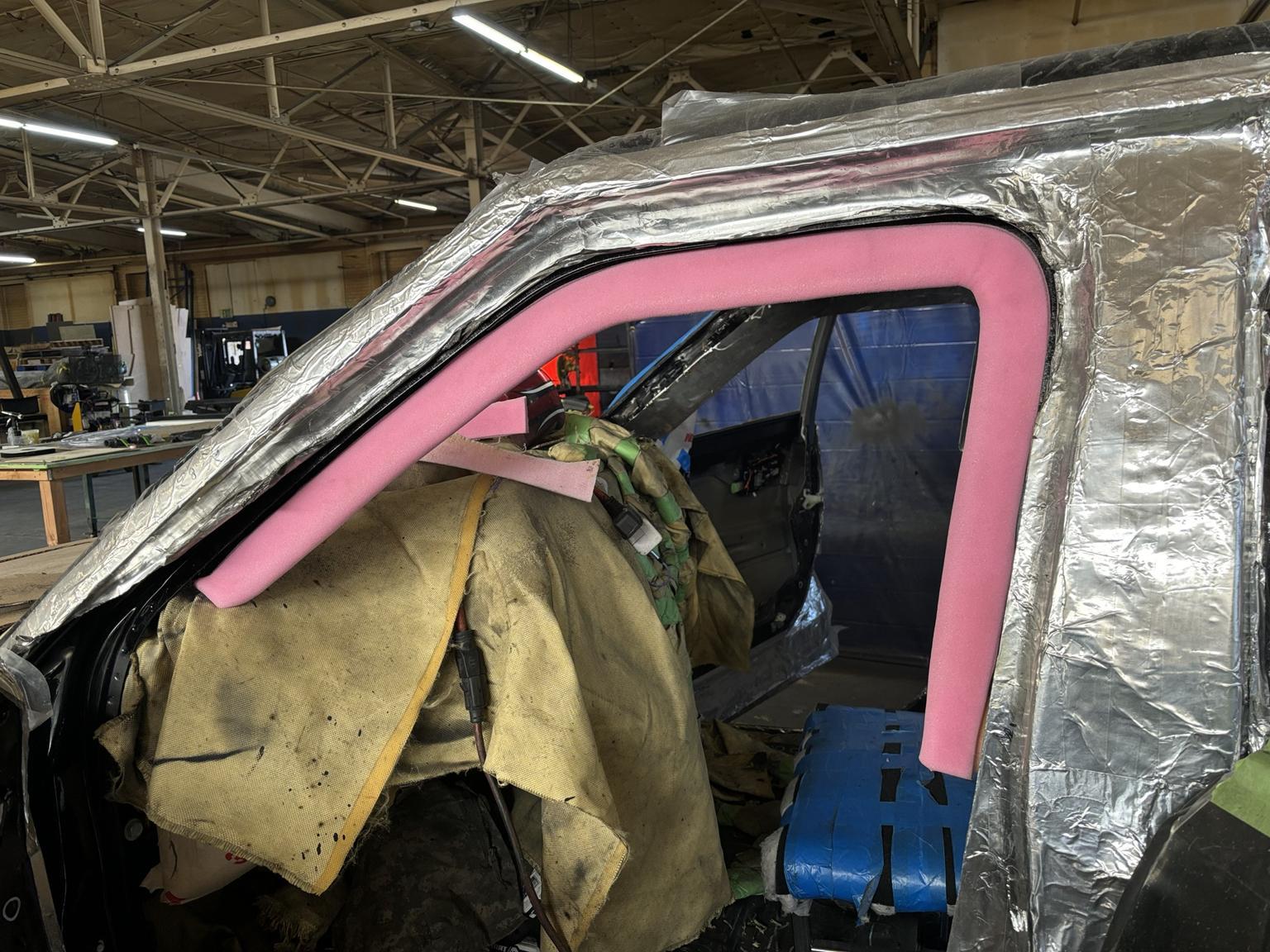

Update #2 They are putting in the door "overlaps" that will provide overlap coverage between the ballistic windows and the ballistic resistant door pillars should a round be fired in between the door and the pillar. There's a pink foam that covers the steel and then a nice interior stitched naugahyde is put in over that. Some armor has been installed in the rear doors seen in the last photo here, but the rest will not be installed until the ballistic glass has been installed/placed. More updates to come!
Rivian R1T R1S Did someone say Armor? Real Ballistic Armored (Bulletproof) R1S Tri Motor in production process... image_0 11.JPG
Rivian R1T R1S Did someone say Armor? Real Ballistic Armored (Bulletproof) R1S Tri Motor in production process... image_0 10.JPG
Rivian R1T R1S Did someone say Armor? Real Ballistic Armored (Bulletproof) R1S Tri Motor in production process... image_0 7.JPG
Rivian R1T R1S Did someone say Armor? Real Ballistic Armored (Bulletproof) R1S Tri Motor in production process... image_0 9.JPG
Rivian R1T R1S Did someone say Armor? Real Ballistic Armored (Bulletproof) R1S Tri Motor in production process... image_0 8.JPG

I'm curious about this... Do you do any consulting with Rivian (or have access to documentation) so that functionality is retained or to prevent something bad from happening in the conversion? Or are things obvious enough (what to touch/not touch) when you do the work?
So the work is being done by a company called "Armormax" I know they have done many Teslas and work with Tesla. I know they have done at least one R1T. I am not sure if they work directly with Rivian or not.
https://armormax.com/about/
Armormax has been in the business for over 30 years and they armor vehicles all over the world.
JerryRigEverything has a youtube video filmed at their facility.

What's the payload capacity that's left over after this?

Great reference photos for future interior DIY projects/repairs.
