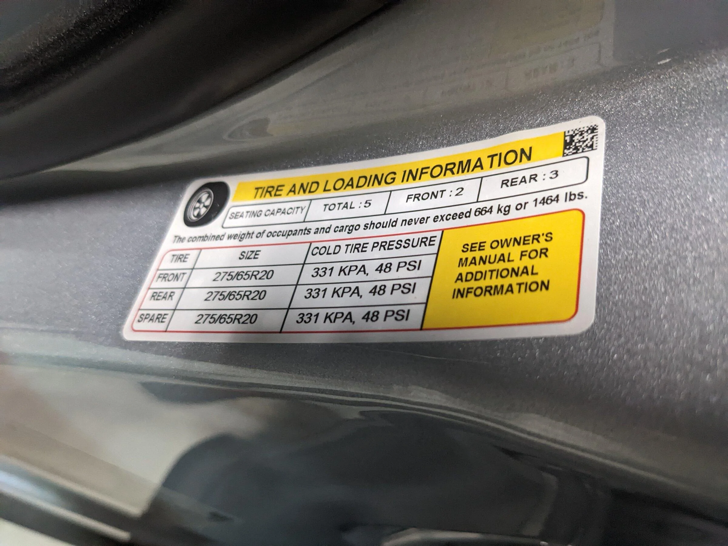

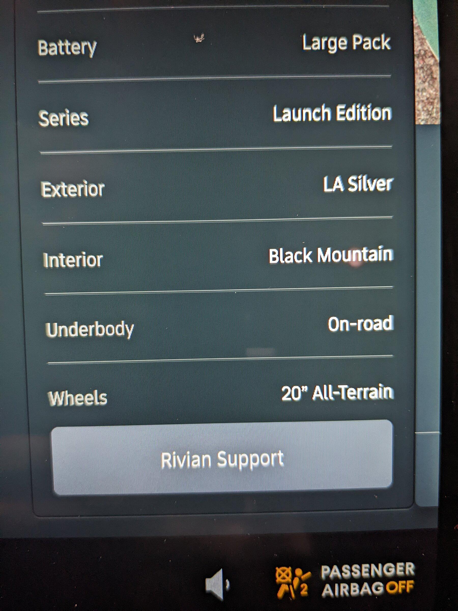

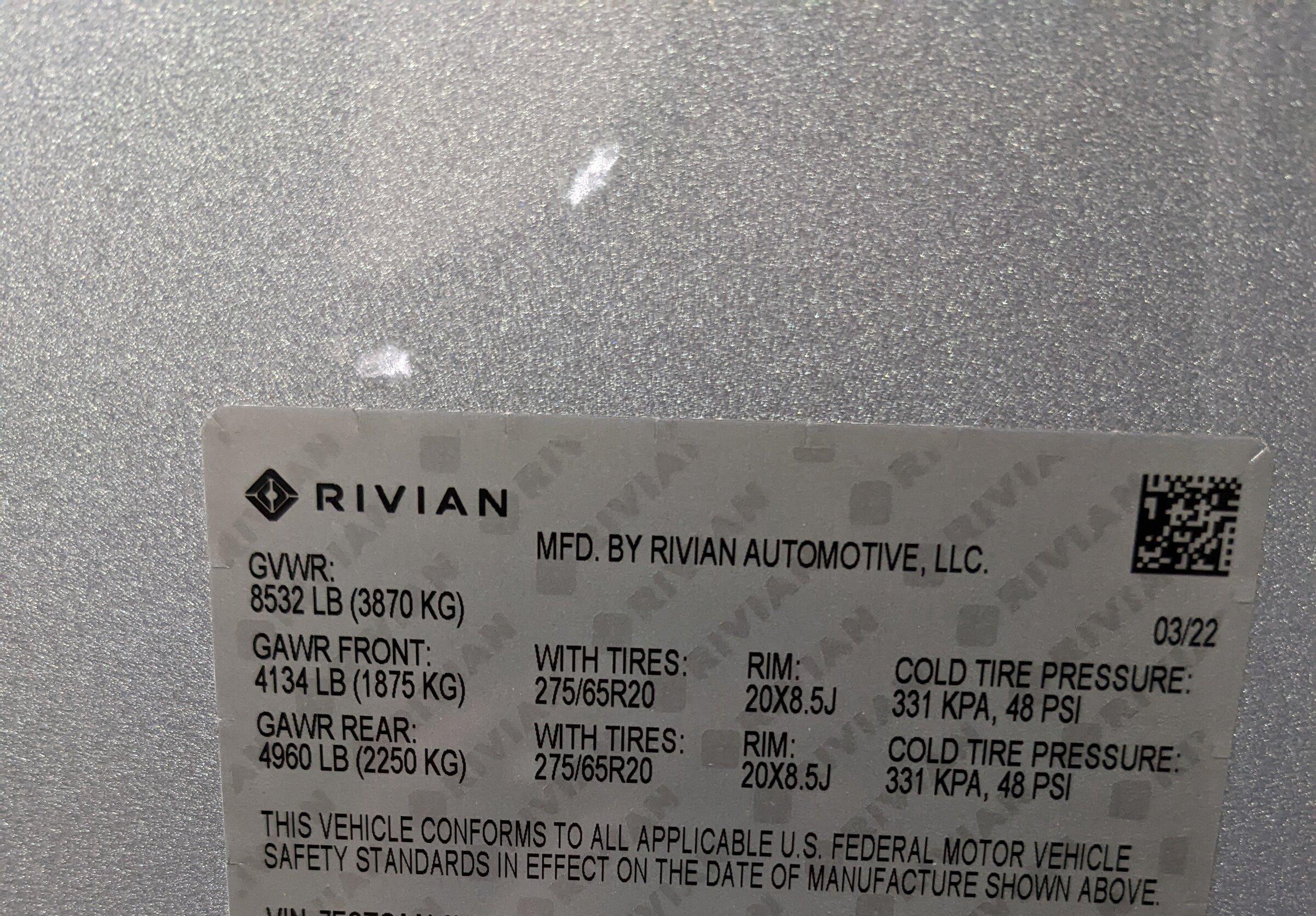

Just took delivery of my LE without the off-road upgrade (looks like Rivian calls the underbody "On-Road" for my R1T) and according to the payload sticker my truck is 45 lbs. lighter without the extra protection. Payload limit is 1464 for me. I do have the spare 20" AT tire so not sure if that extra 80 lbs. is figured in. Pics of the door stickers attached.

Thank you so much! It’s only taken over three years to get this number from someone greatly appreciate it! Amazing, only 45 lbs of added weight.
Seriously. I was thinking about dropping the shield to save weight but at 45 lbs, I'll probably keep it.
