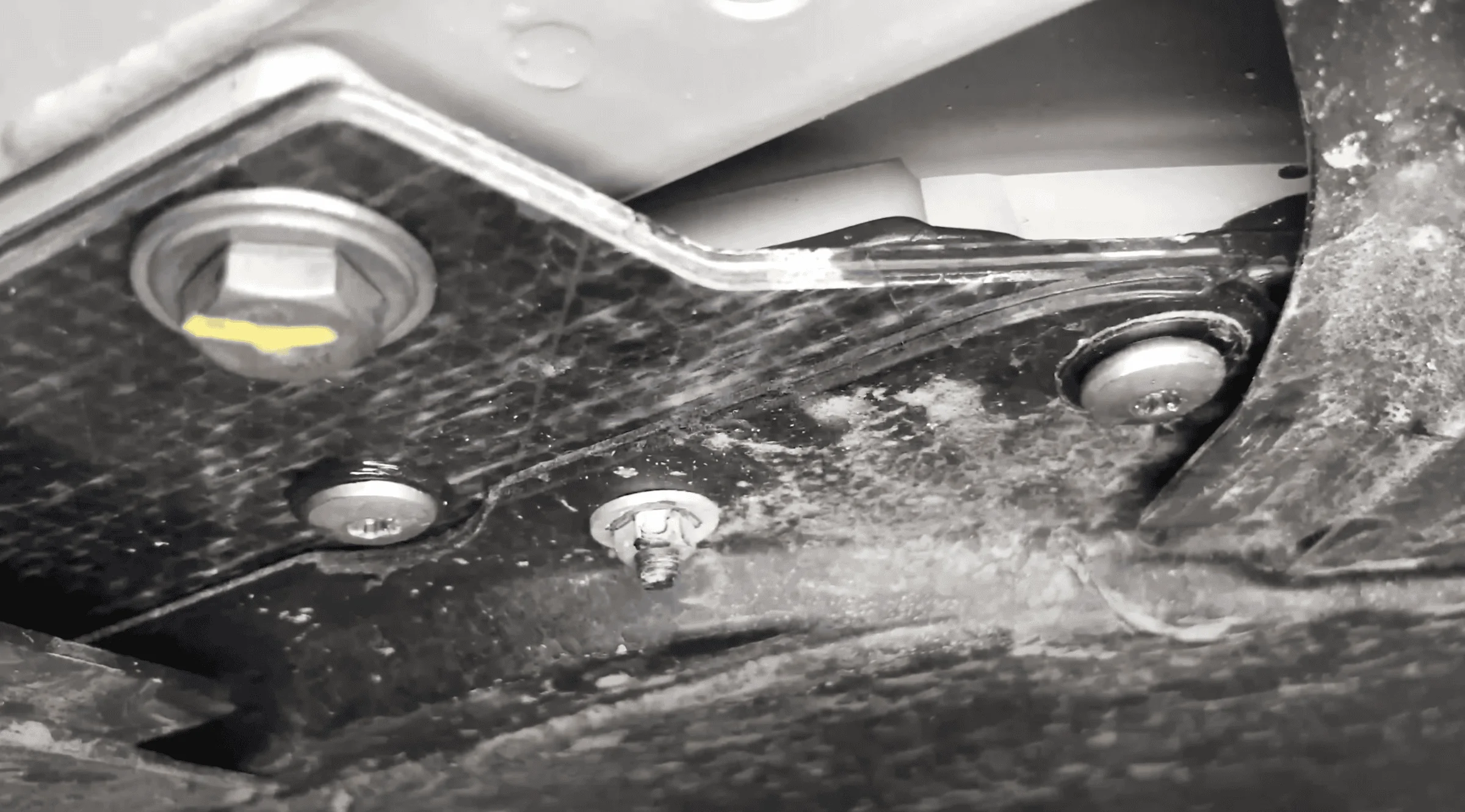

The plastic aero shield in the munroe video definitely looked different than the bottom of @jjswan33's truck that I was looking at yesterday. His has a smooth steel plate exposed under the battery area, which is what you would want if you are going to potentially contact the ground. If there is a plastic cover between the steel protection and an obstacle then the plastic will just get chewed up.
Mine has the same steel plate for the entire underbody as you describe.
I am talking about this sandwich layer between the steel plate and the pack, which my non-armor truck also has.

Currently not configured because of this.
If Rivian offered full undercarriage protection similar to the battery tray I would purchase it.
Rivian R1T R1S Underbody Shield - Worth it ? 1651268684164
So the plastic "sides" in this picture is on both the standard and the reinforced underbody? If that is the case I'm not upgrading.

Rivian made the parts out of plastic to be sacrificial. Aftermarket to the rescue?

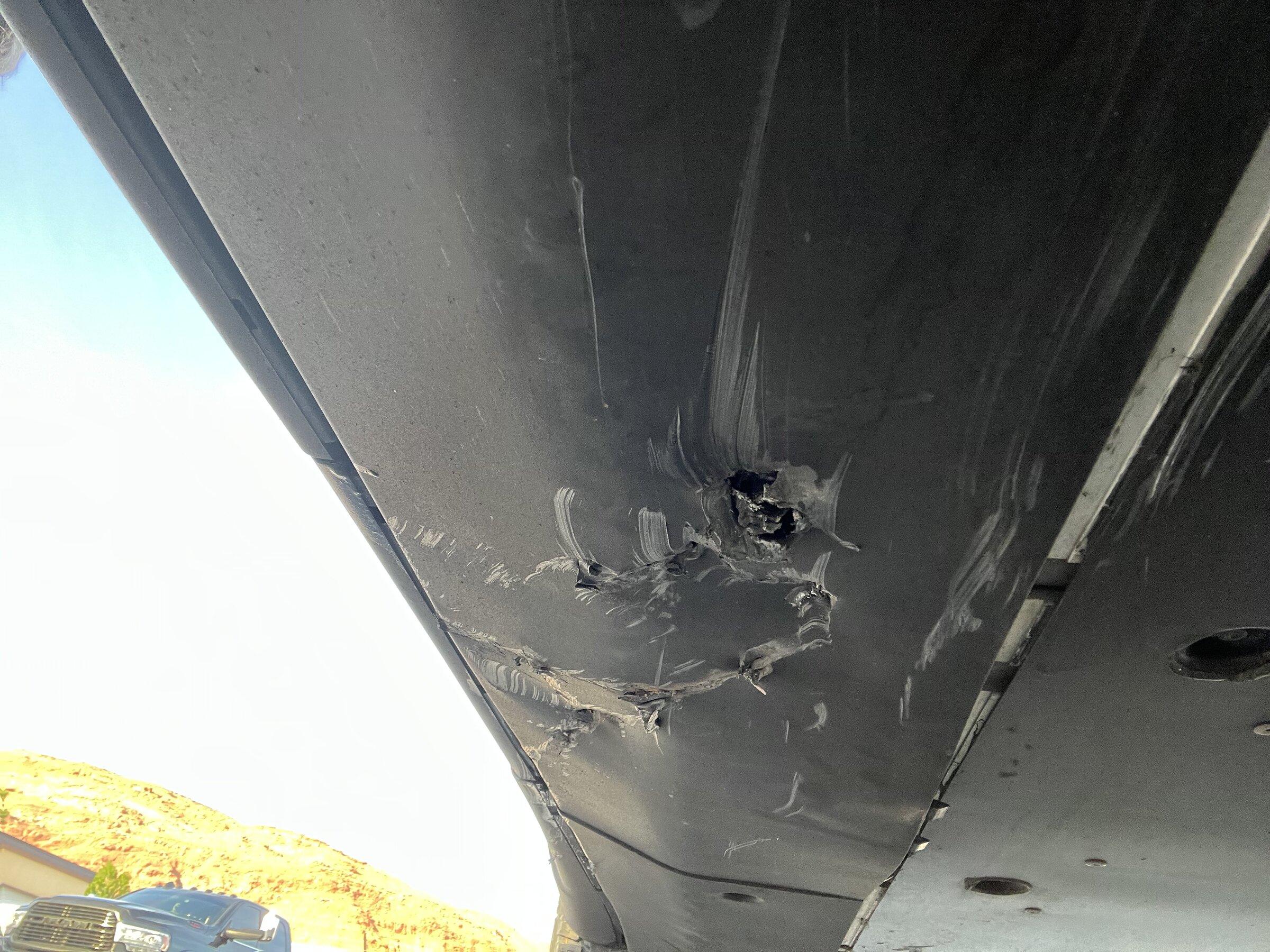

So for those who have said no on the underbody shield you may want to rethink if you do any trail riding. I was at Rivian having my R1T looked at for a small trim repair and I heard tech say he had 3 R1T in for underbody repairs and one of which was big damage that the owner would need to pay for. He told me if they had had the extra shield all three would not have any damage as it appears the plastic shield is not very strong even though it looks very similar. Note my truck does not have the extra shield but the R1S I ordered does. Glad I order it. Here is 1 of 3 stories I found where the lack of extra protection hurt.
Another Rivian Damaged After Driving Through a Puddle, Is the Underbody ...
Mar 6, 2023In the case of Rivian, owners are actively talking about fitting the optional $2,000 reinforced underbody shield the EV maker offers. The problem is that the protective shield is not..
https://www.autoevolution.com/news/...-is-the-underbody-shield-worth-it-211394.html
