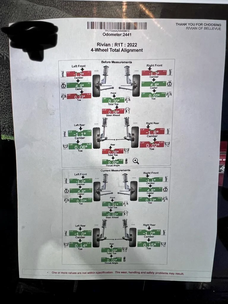

Bellevue did mine last week and got it right the first time - both the droop and alignment.
Oh man I didn’t get that nice readout from them! Got an alignment about 1000 miles ago and now it’s back to being terrible again (aim left drift right like everyone else here). They said they can’t get me in until JUNE now! ?
Did you ever investigate having a local shop perform the alignment? I'm far from a service center and don't see it feasible to tow the vehicle for alignments.
After looking into this issue it seems like Rivian had trouble getting alignments correct requred them creating software to tell the vehicle its being aligned. This in result tells the air suspension to not change heights during alignment.
The other potential issue I see with having alignment done locally is the driver+ and how that is recalibrated.
Any thoughts?

They told me it may be better to get an external shop to do it faster but didn’t mention it being under warranty and don’t have any in our area to list where I could go. Anyone get their truck aligned in the Seattle area not at the Bellevue SC? I should note that on the work order for my first alignment a few months ago, they quoted two hours. Then when I took it in, they told me it can actually take the entire day. If a lot of people are coming in for alignments, you can see how that would back them up.
Did they say an external shop could do it? Every time I call the service call center they say it has to be done at the rivian service center which makes no sense to me.
I was just on the phone with the Brooklyn service center and they said alignments can only be done at rivian locations due to the hardware needed for the sensor calibration post alignment.
Person I talked to did. Literally said “I know this absurd but the earliest I can get you in is June. You may want to try another shop in the area.”
I'm confused since they are telling you can get alignment done from local shop and don't need to do the sensor calibrations. It makes sense to me but not sure why they are telling me it has to be done.
