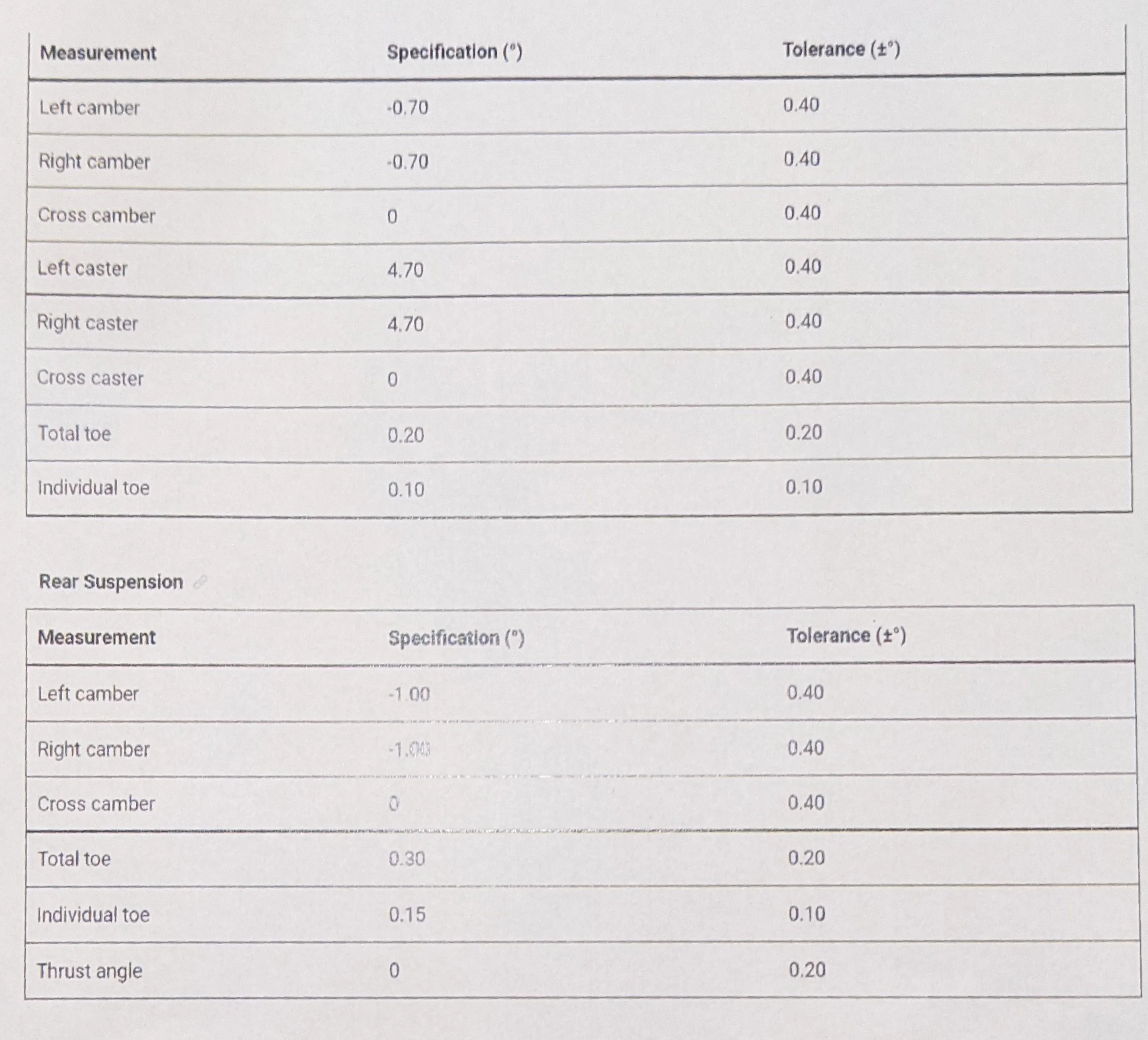

I found this on another thread, but I don't know if this is what you recall seeing as well?
thanks for those numbers. I was just looking for these.
three day weekend coming up. time for some home alignment tinkering.
I noticed someone posted about loose bolts holding the steering box, so I'm going to check mine.
those specs suggest there's nothing unusual about this suspension geometry
if you want a little more lively steering a tad less drag, get zero toe front and rear
if you want the truck to be quick "pointy" and responsive and active, err on a little toe out
if you want stability keep the front toe in
if you want responsive steering, zero toe in front, keep the smidge of rear toe-in
set ride height low for hard surfaces and handling
set ride height middle for soft surfaces and cornering grip
there's not a lot of caster, so it doesn't have any bad habits they're suppressing
I'd leave that exactly where they want it (if it's even adjustable)
disclaimer: of course my opinion is from the perspective of someone that wants to drive the vehicle
as far as I know, the R1 doesn't have any bad habits (it's not prone to lift-off oversteer into over-rotation, it's not prone to terminal understeer, it doesn't have torque steer and it tend to slice or hook at 100% power.) I assume if you're not familiar with suspension setup and don't have an interest in handling and performance, you won't want to tinker with these numbers … "that's how accidents happen."

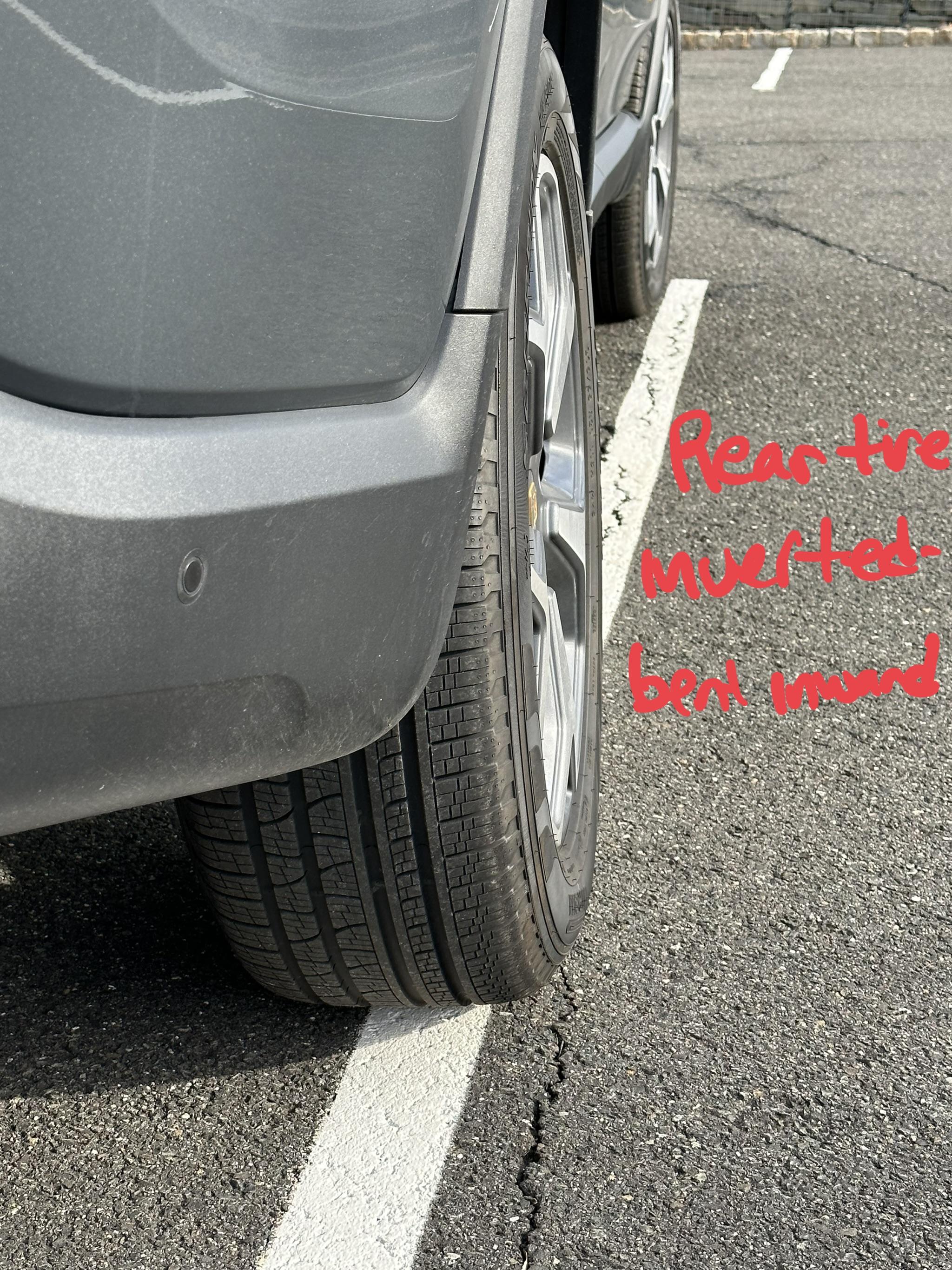

just had my car aligned at the Brooklyn SC - no difference - car still pulls to the right - seems like every time I back into a parking space the car is always on an angle - I can't explain it. I will sending the car back to service center as soon as they reach back out to me. Rear passenger tire is inverted ( bent inward)

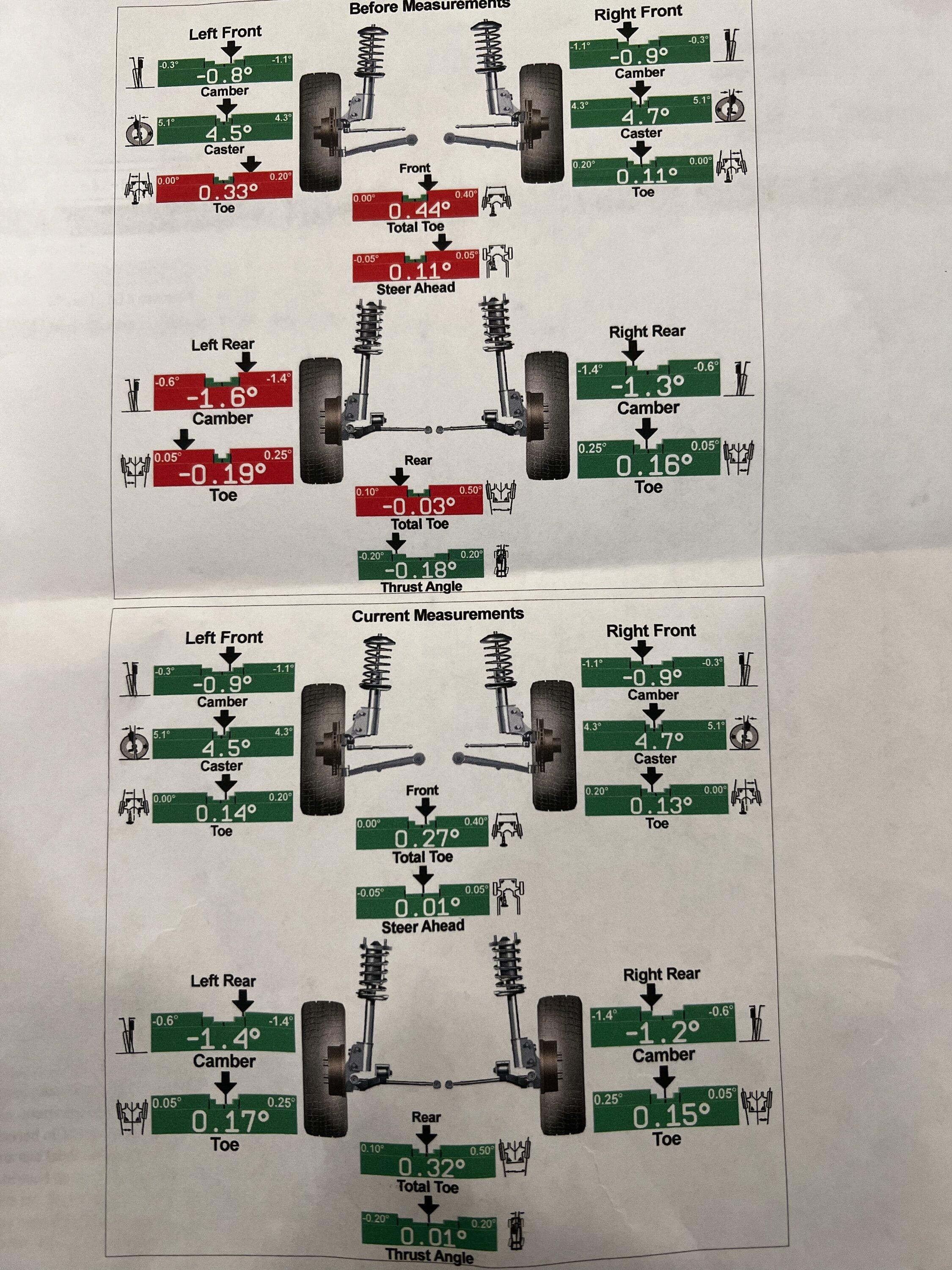

Just had mine aligned by local shop that’s very good. They didn’t indicate anything drastic just had to update most of the rear spec settings.
As for the tracking, the wheel is a little straighter when driving straight (it was cocked 8 degrees left) but still wants to dive right when I let go.
Here are my alignment results
Rivian R1T R1S Alignment woes BE85D72B-3C42-463E-B9D6-D441C0426C32
