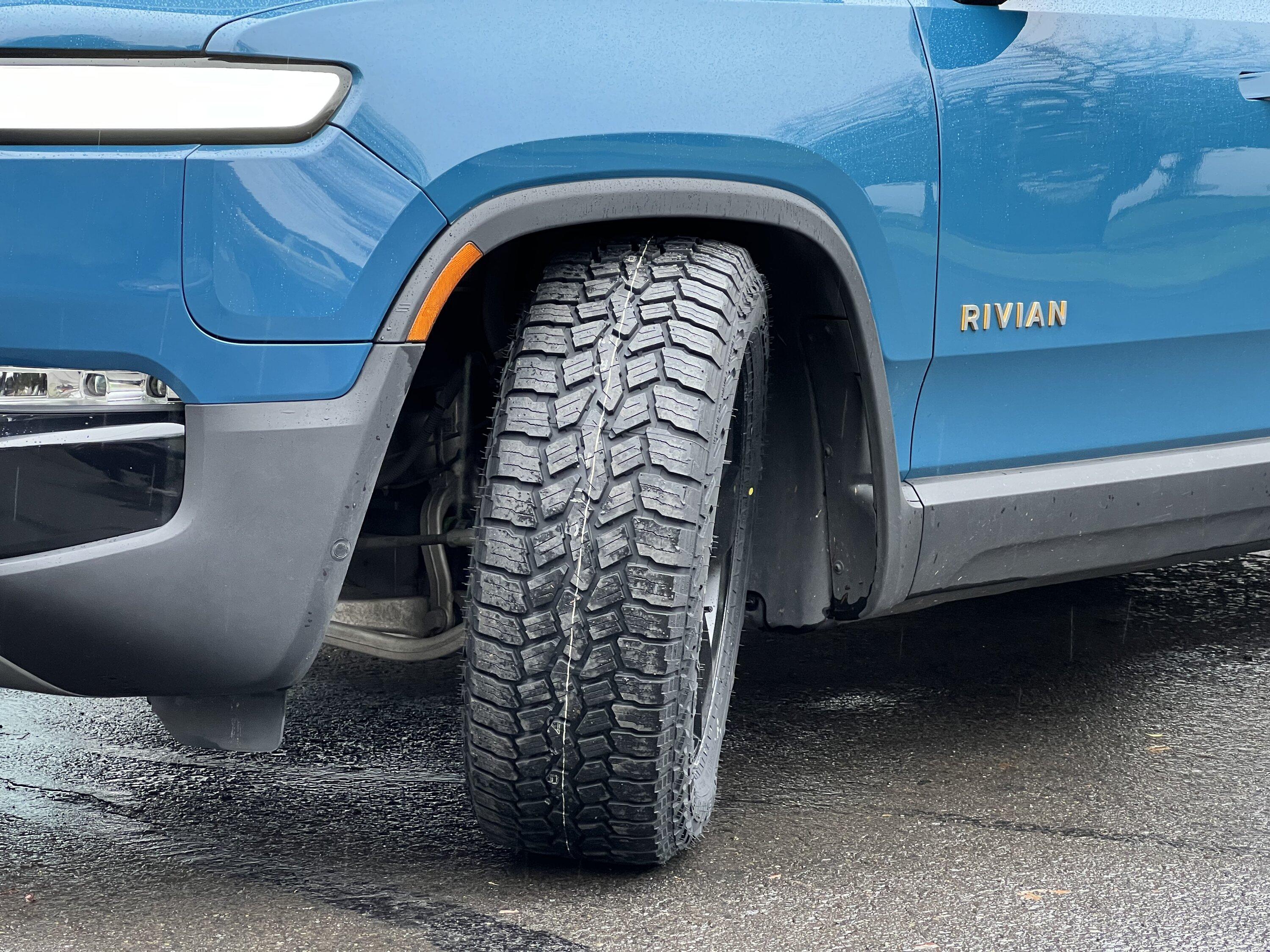

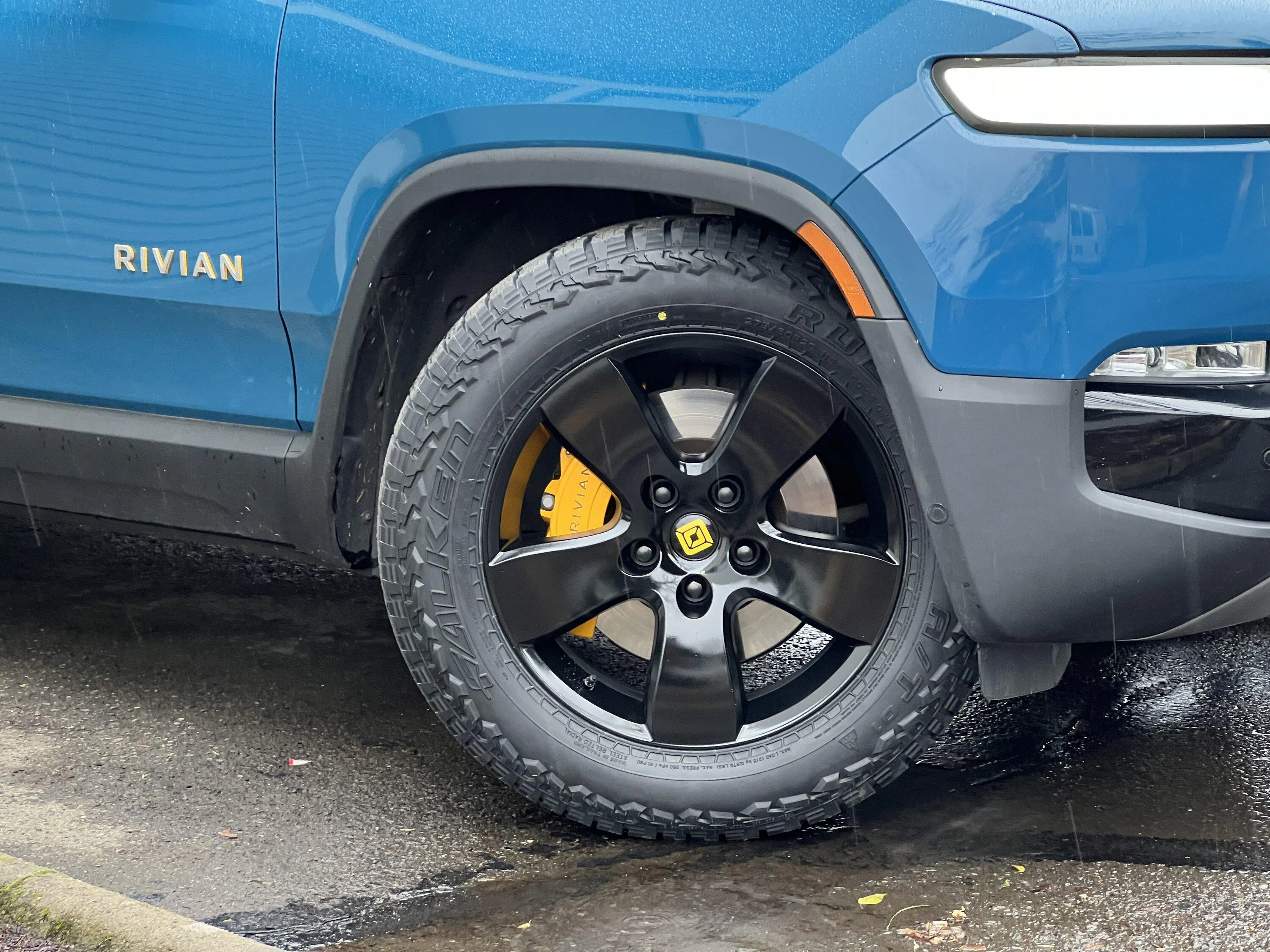

Whelp, my R1T turned 1 year old (yesterday) … and cold weather is FINALLY in the forecast here in the PNW, so it was time to wrap up my 2363 project and get them installed.
I chose Falken Rubitrek Tires (275/60R20 115T) to put on my 2363s. They are an AT tire similar to the Wildpeak A/T3W, but have more road bias stability/efficiency with the longer center block, and are also 3PMSF rated for when that is needed in the mountains. Anyways, they fit the bill for how I drive, and on they went!
My R1T came with the 22” tires/wheels, so I chose this diameter to be just a hair larger than the 22s, but don’t have to get the vehicle recalibrated. Spray enameled the wheels glossy black, got out the family Cricut and made yellow Rivian logos for the center caps.

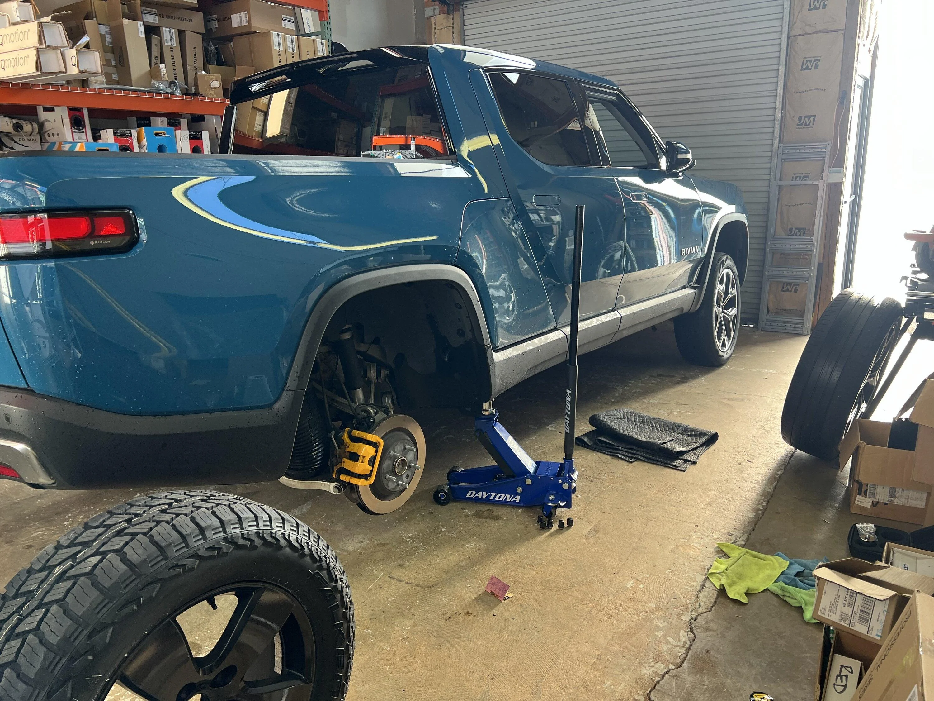

When swapping the wheels at my business’s warehouse, I did a once over on the drivetrain/suspension/etc and all looked in good order. Gave the calipers a good cleaning and made the swap.

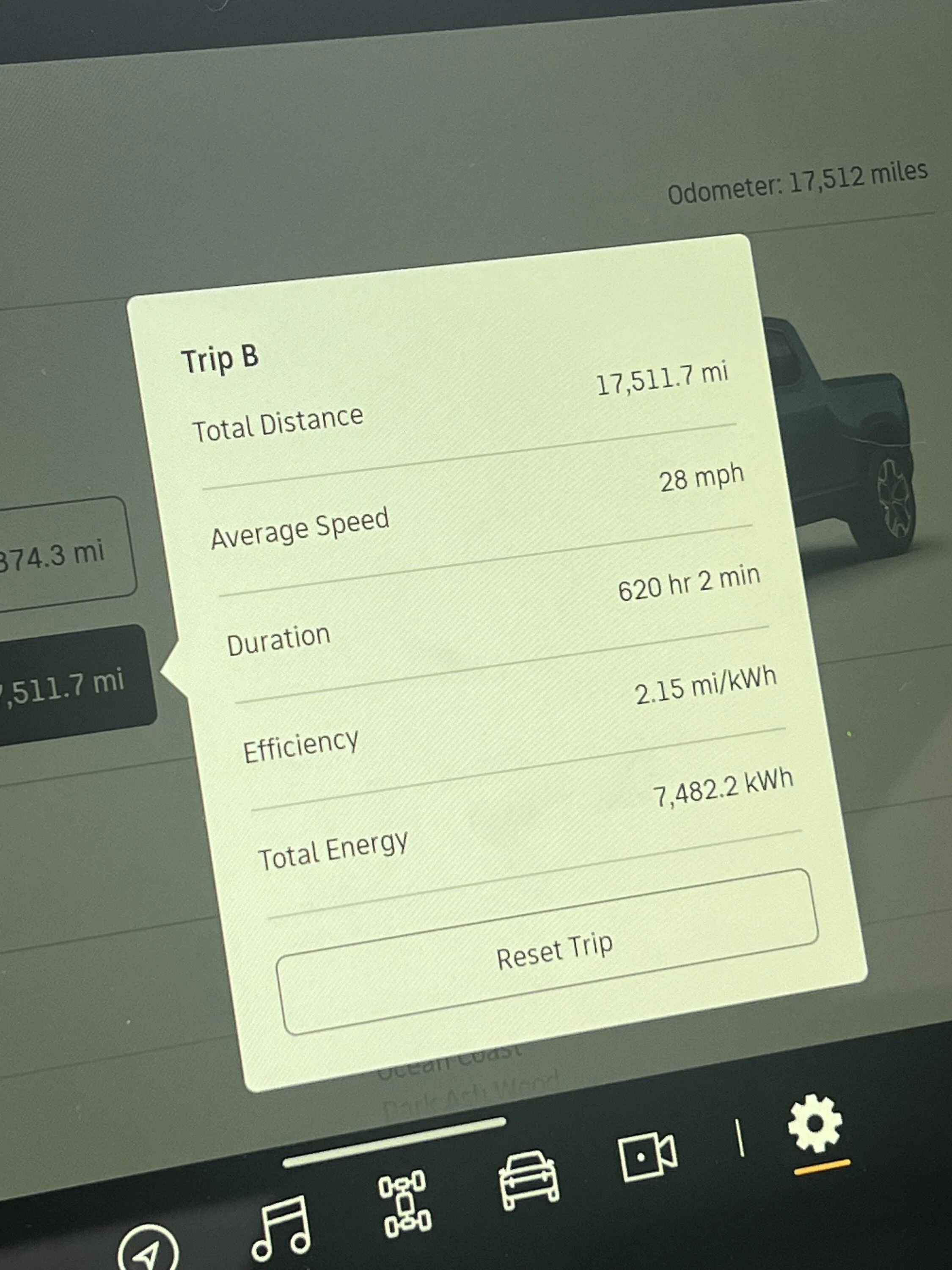

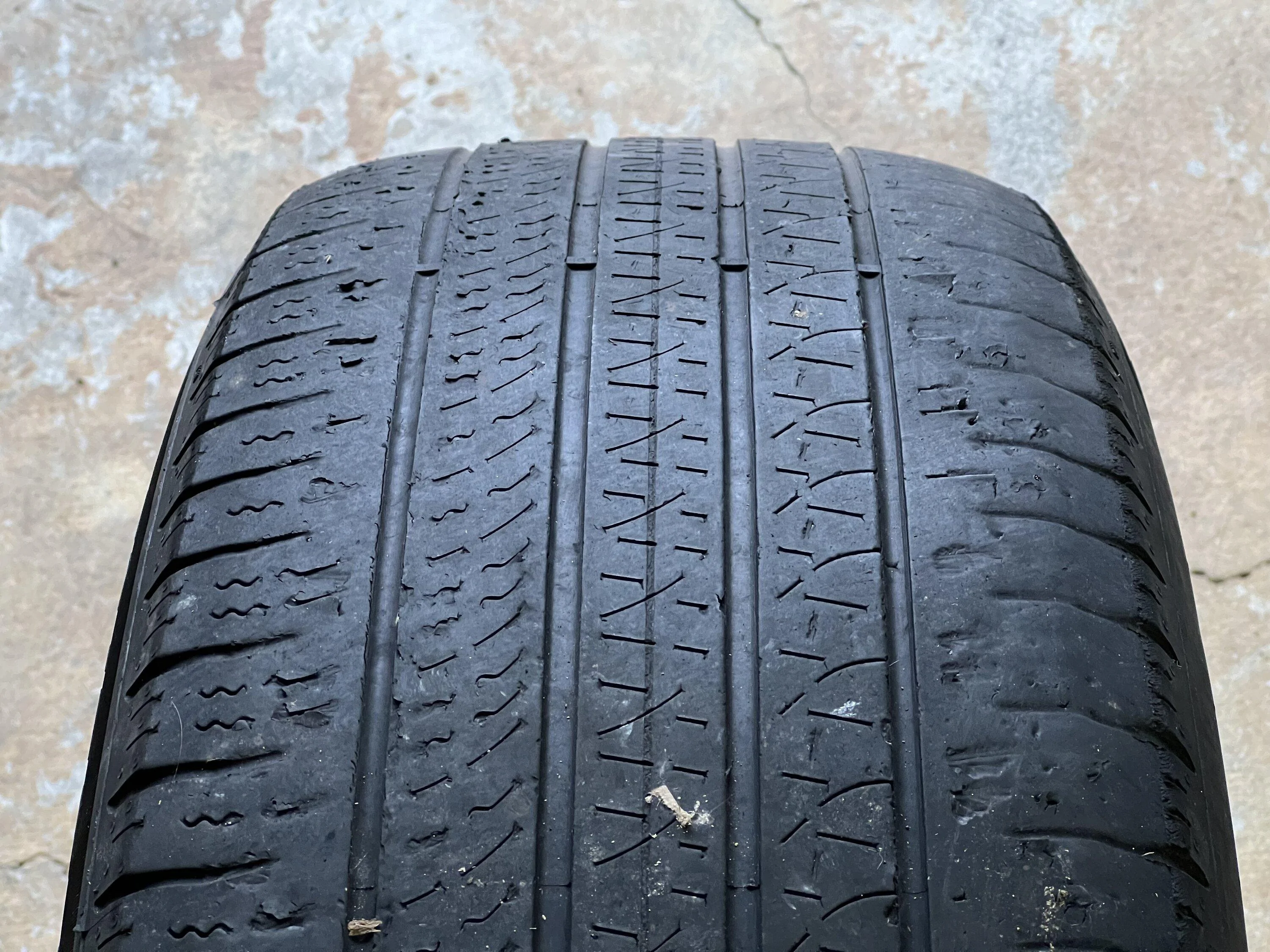

Odometer is about 17.5k miles, rotated my 22s three times at 5k intervals… they are TOAST! ?. Was wearing through the wear marks…. Oops! ?

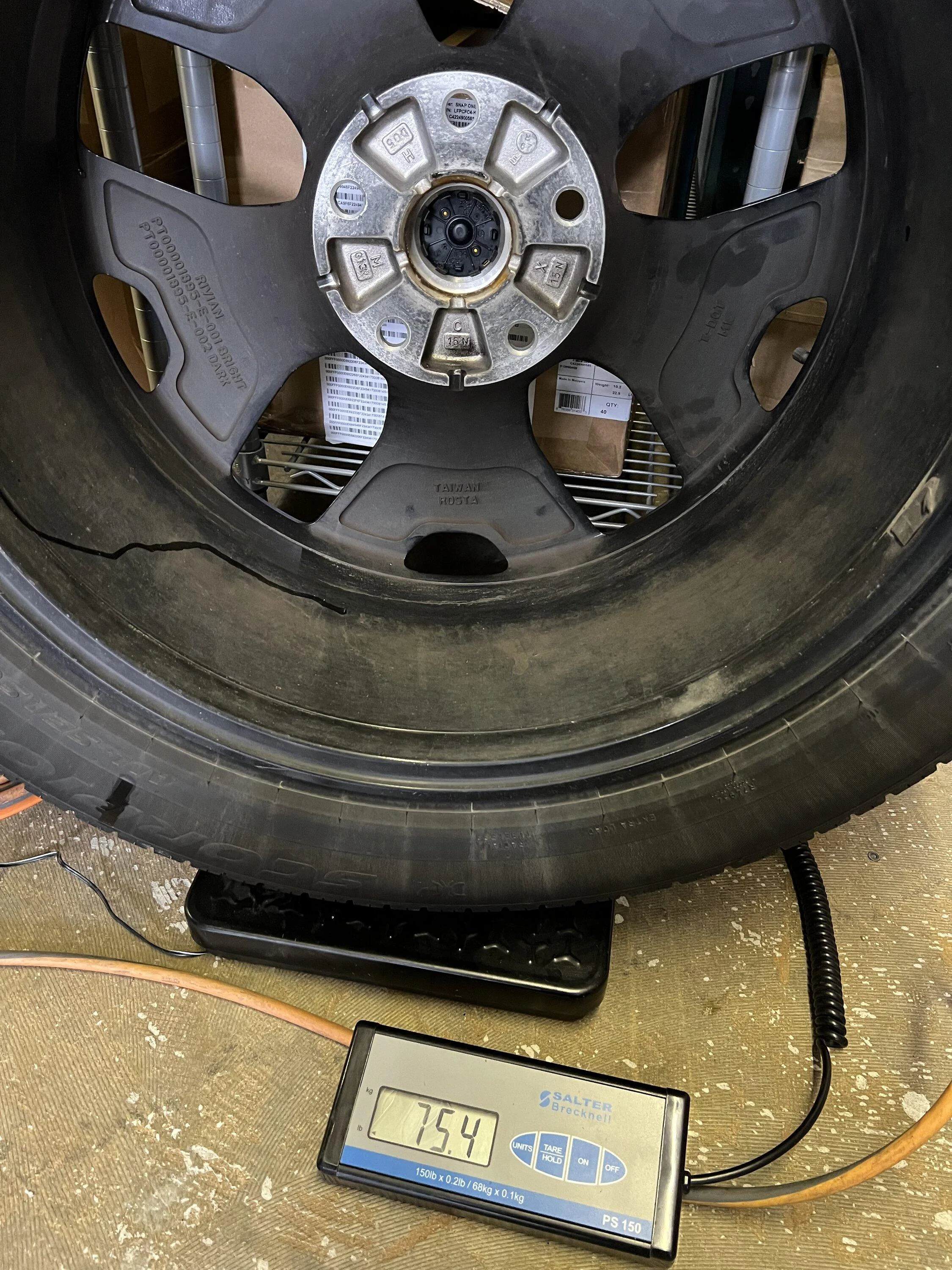

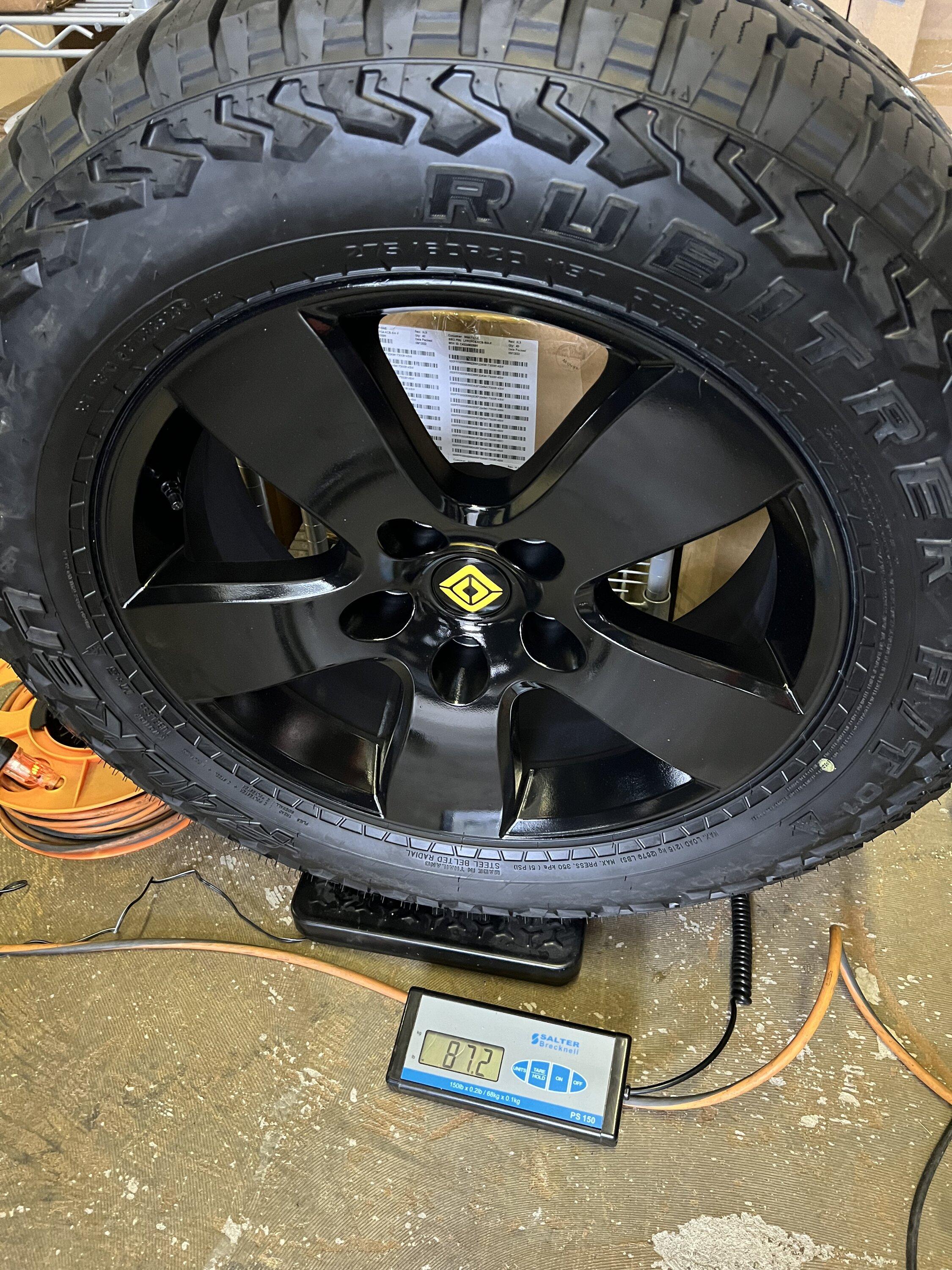

I also weighed the 22” wheel/tire combo vs the 2363/Rubitrek combo and came up with these results;
22” pirelli/wheels: 75.4 lbs (likely a bit light as there wasn’t much tread left)
20” 2363/Rubitrek: 87.2lbs

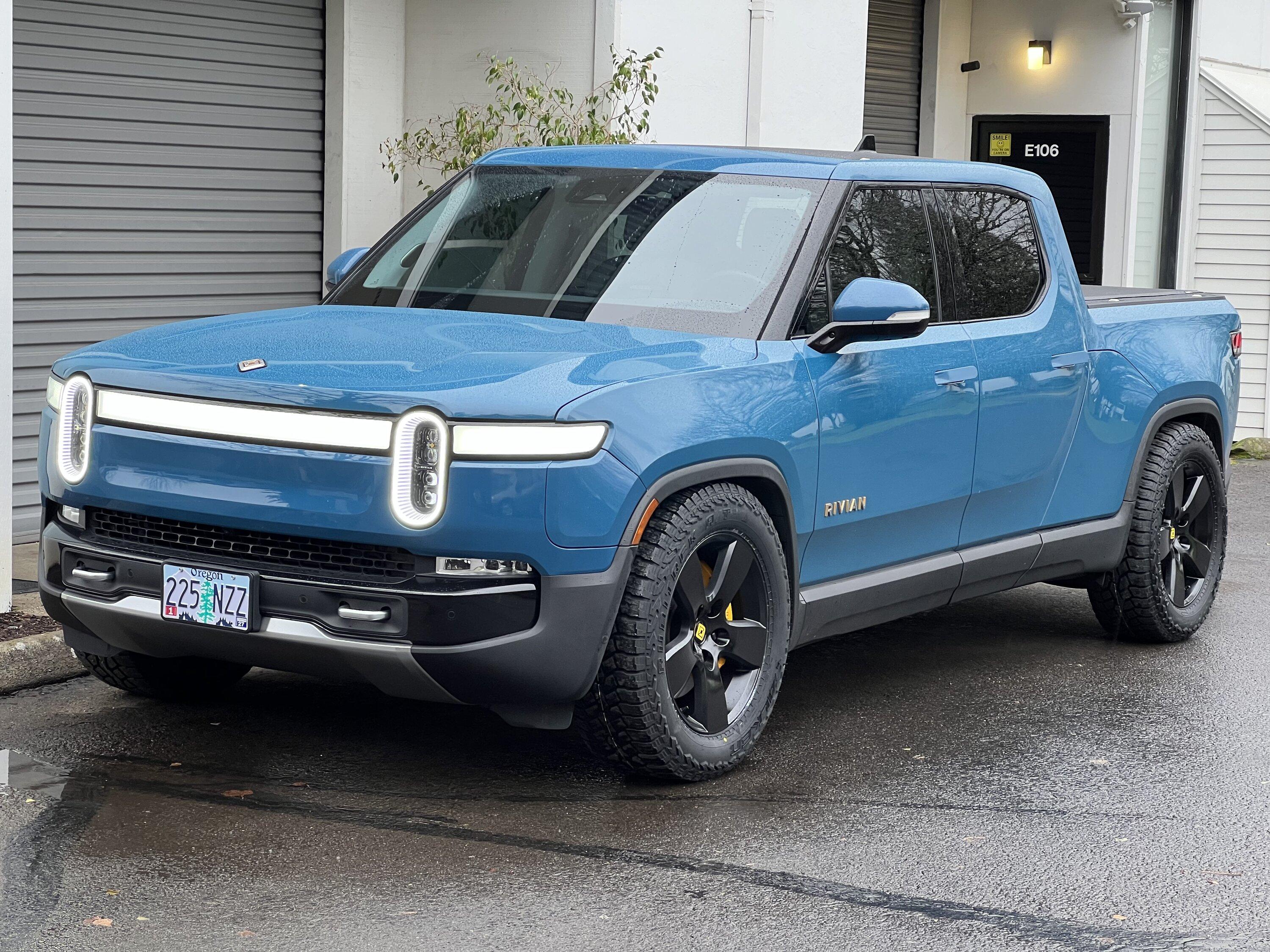

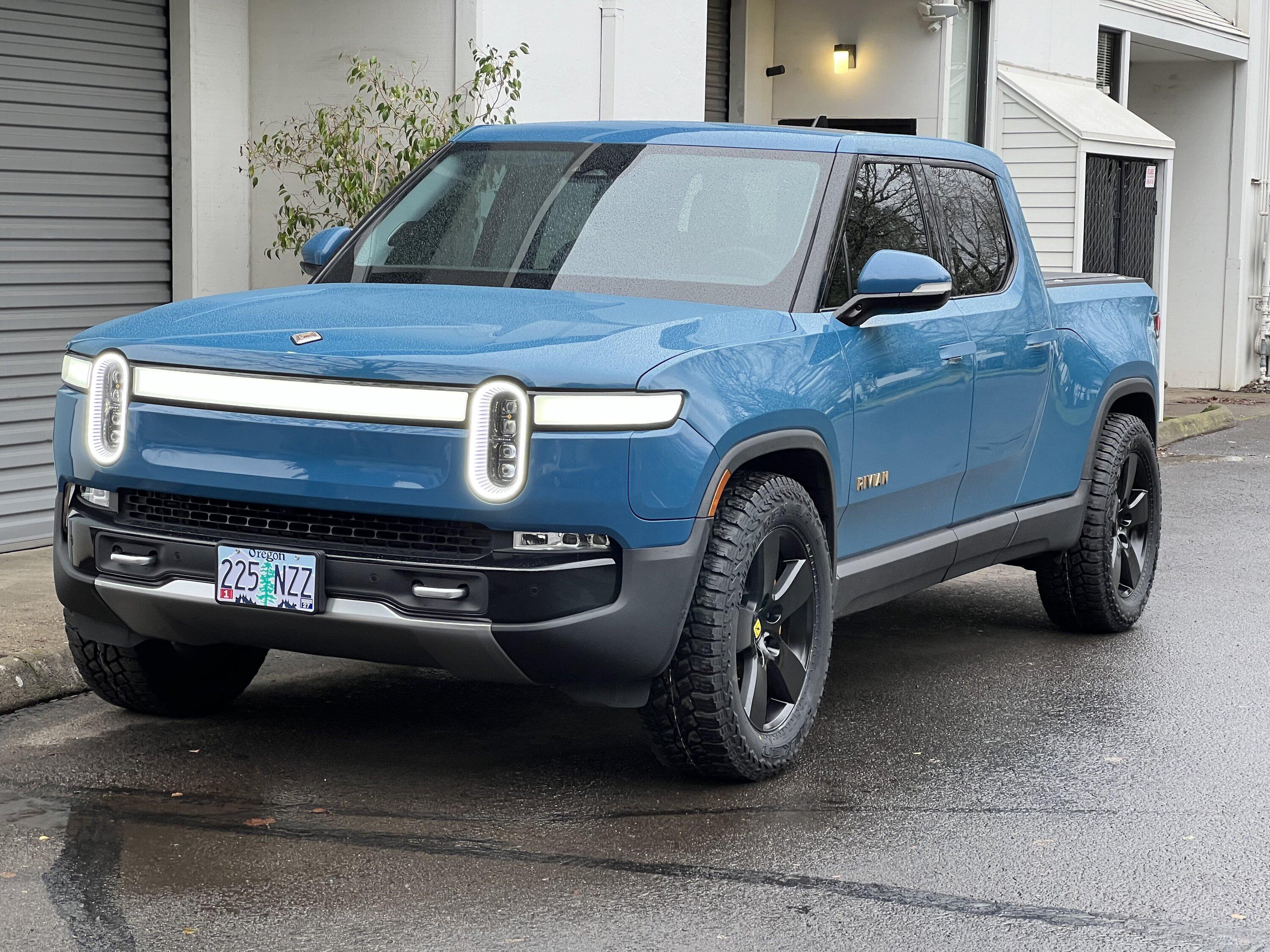

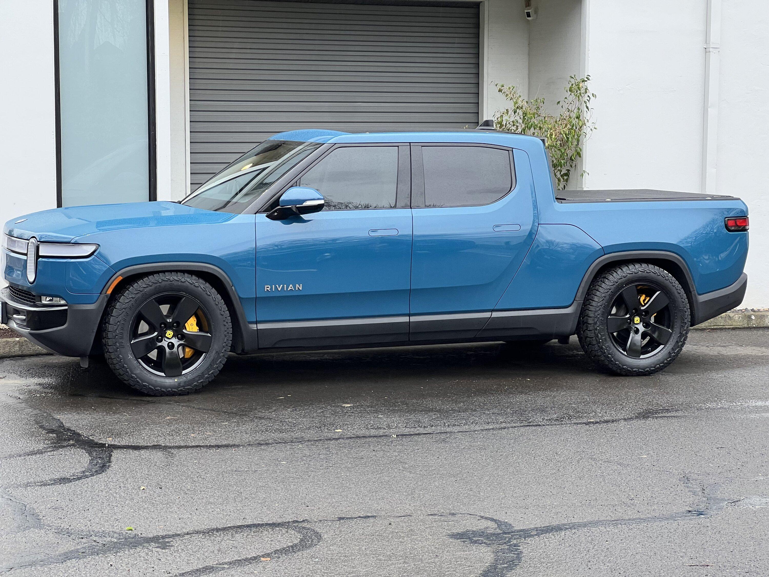

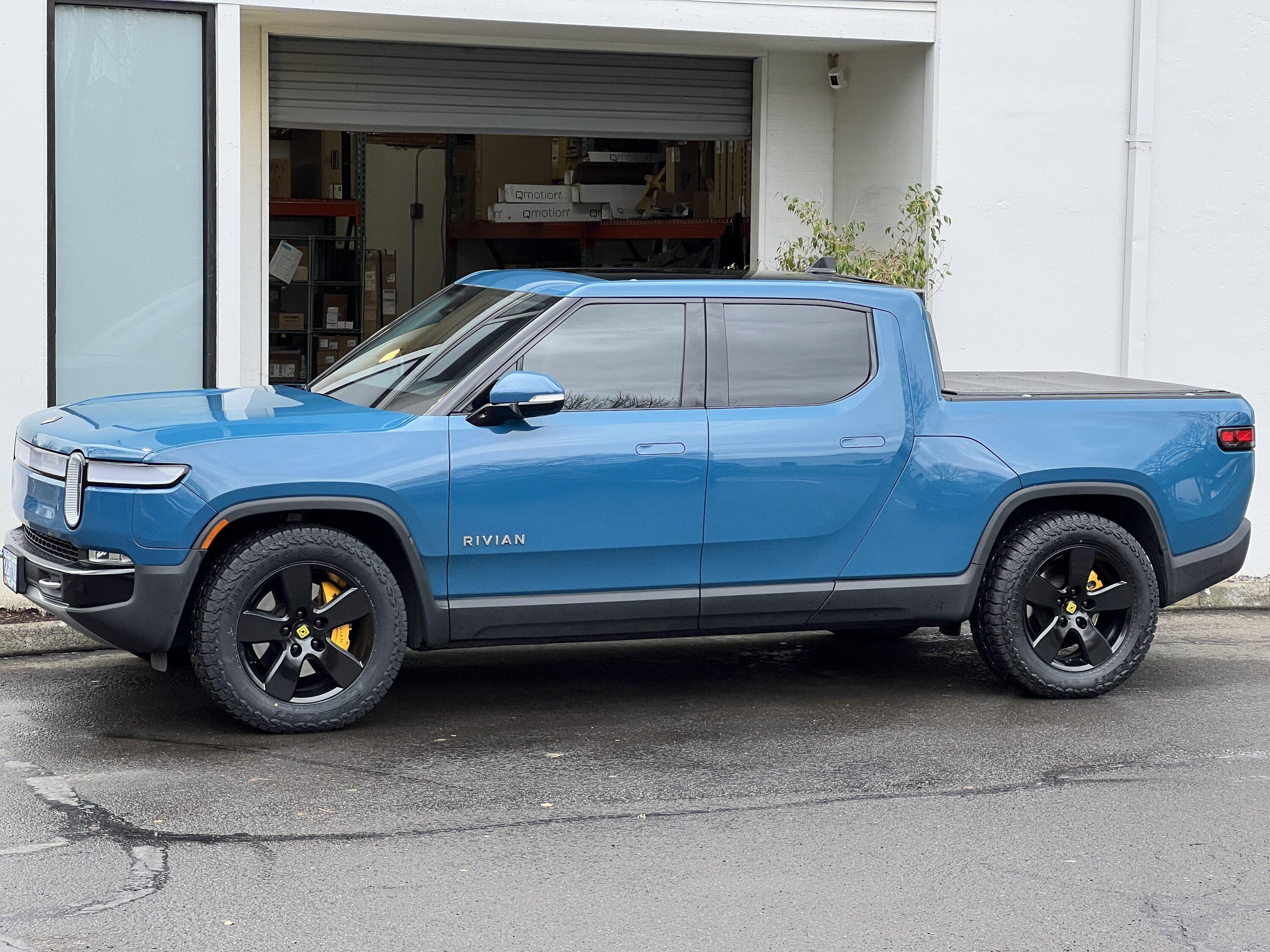

The new setup pokes out a little bit, but it actually looks WAY better than I thought some old Ram wheels would look. In person is better than photos. Drives great, and significantly lower road noise than the 22” tires. I realize they are still new, so time will tell.
Added some photos for those that are curious.
- Standard height, lowest height, lowest height full steering lock. No issue with any rubbing as it’s about the same diameter as I had!
- Lifetime Odo with efficiency data on the now toast 22”
- bald 22’s - lol
- couple random photos.

Reasons for my change;
- cost (because not all of us have disposable incomes) :) Hence the use of some 2363 wheels vs getting something ‘nice’ or forged.
- not having to recalibrate the vehicle as I change them myself
- keeping most of my efficiency that I have on my 22s. I drive a fair amount, and I will commonly get close to my range in regional daily driving. Adding a charging stop between client appointments (I’m a contractor) would disrupt my schedule.
- keeping the sidewall shorter to have similar responsiveness that I enjoy on the 22’ wheels
- more aggressive tread for the driving conditions I sometimes encounter, but I’m typically 95% road with occasional rougher terrain. These are also winter tires for me and fit the bill for most PNW conditions I may encounter, but also remain a small enough diameter to use Z-chains if/when we get an ice storm, but don’t chew up the pavement when I don’t need studs.
- these also may be used for light trail conditions, but my vehicle doesn’t have the underbody shield, so I’m not likely to abuse it. A/S tires could suffer a bit in muddy or soft sand conditions, but I considered them.
- Keeping all of my ride height capabilities intact without any rubbing, especially as the 2363 wheels have significantly less offset.
- bigger tires add weight, and if I were in a location that I would really be using the capability that a larger tire can provide, I wouldn’t have had 22s in the first place.
That pretty much sums up the main points. I throughly enjoy NOT spending $400-$500/mo on fuel anymore (‘08 Tundra previously) … and the range I currently get in the R1T is actually MORE than my Tundra ever got on a tank of gas. ??‍♂
