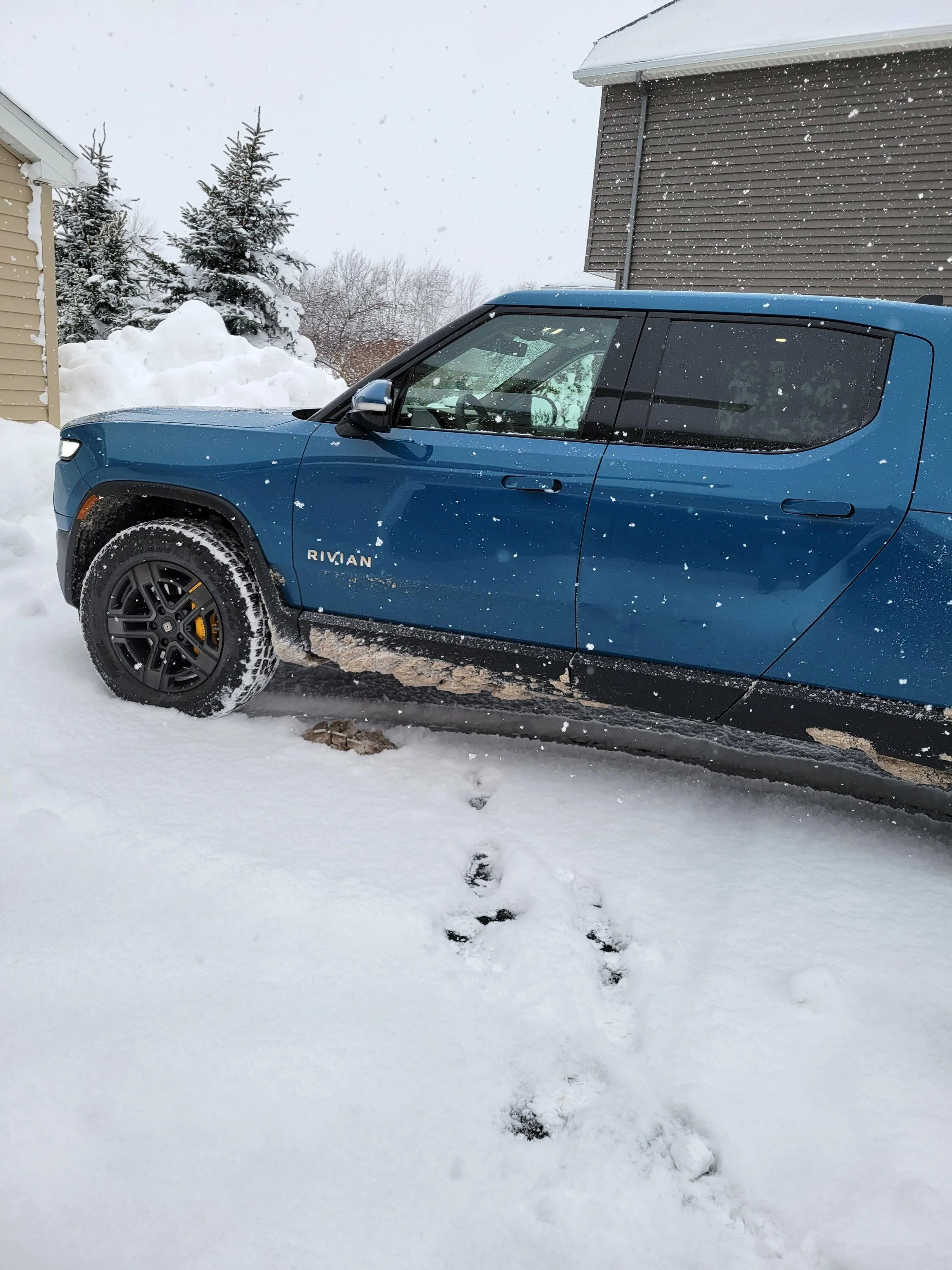

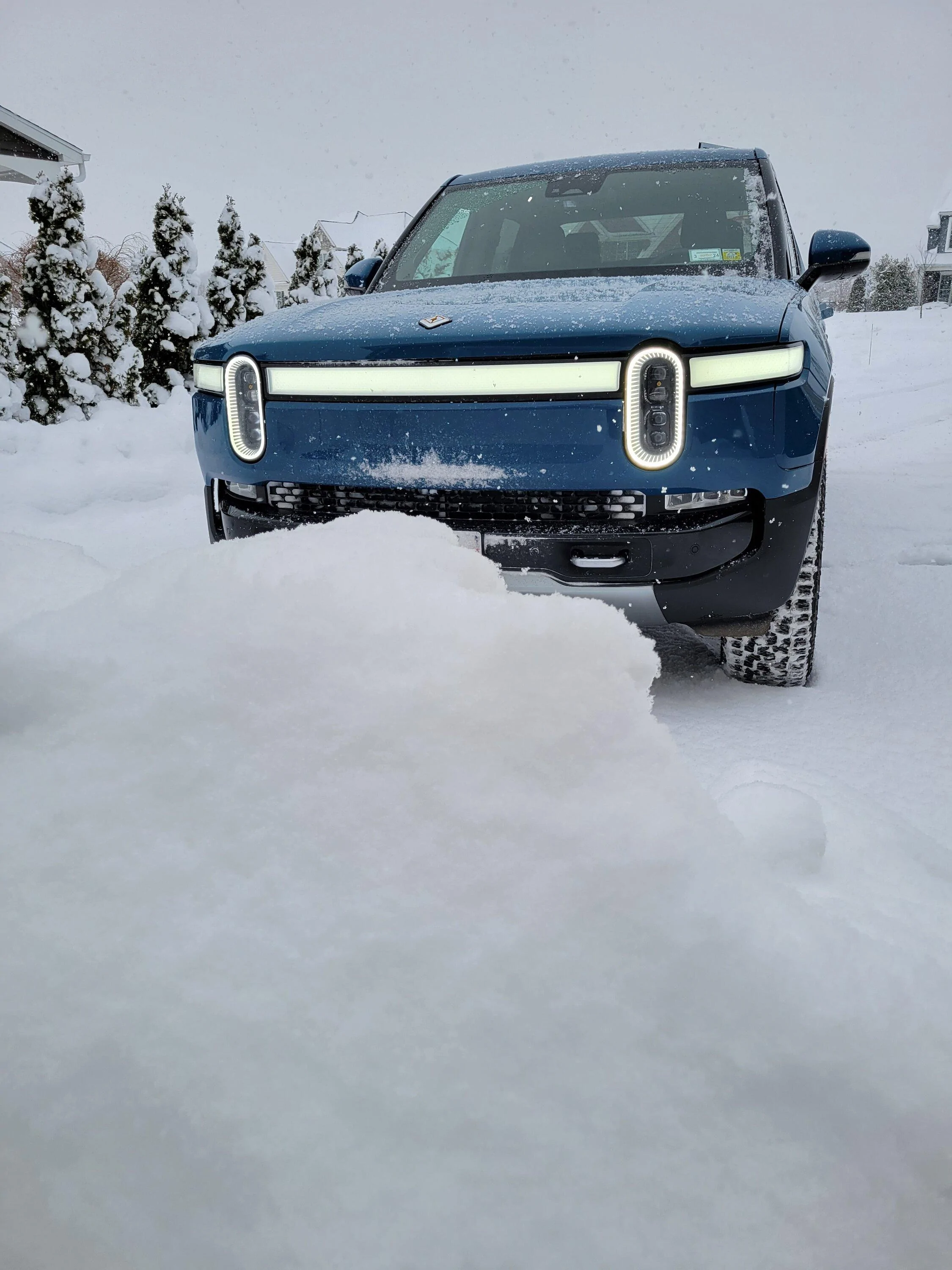

Snow mode arrived just in time for the Christmas upper Midwest blizzard. Snow mode works great, predicting same milage range as All Purpose. One thing no one has commented on is that the ride height becomes "standard" in snow mode, but after about four minutes at highway speed, the truck automatically lowers itself to "low", then back up when you slow down. Well done Rivian.
Ran into a new owner in Madison WI while charging who had only 300 miles on his, but had already switched out his 20s for Bridgestone Blizzaks. He was an autocross type car guy specializing in ice racing and had worked in a tire shop so knew his traction. I'm having no trouble with anything getting around safely with my 40% worn out 21s.
Next day in Milwaukee, met another car guy type wearing Elkhart Lake Road America race track plates. The driving experience is well worth the wait.
450 miles traveled, left home at 100 per cent charge and arrived home with 100 miles of range left after spending 28.50 at retail Electrify America chargers.
