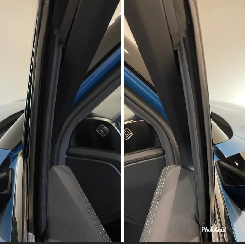

I'm in the wind noise club as well. You can see the defects in the seals easily.
It's both the vertical strip and the little expanded foam bit at the base. The passenger side looks tight and flush and filled.
Sad. ... Funny, you be the judge: that shiny black vertical trim piece is held in place by double sided tape.

I get wind noise on left side…I know it looks minor but you can tell the left side isn’t as tight as the right passenger side. Mobile service is gonna come fix it next month.
The service guy 100% fixed my issue by applying what looked like electrical tape to the inside of the plastic support piece the trim adheres to. Basically this made it expand outwards and the seal could do its job.

Do you have pics of the tape and placement?

Alas, I do not! I should have taken some. He basically made the plastic piece wider using this method.
My tech replaced the entire weather stripping and didn't help...not sure why he didn't try that. The weatherstripping on that black trim piece still isn't hitting the window snugly.
