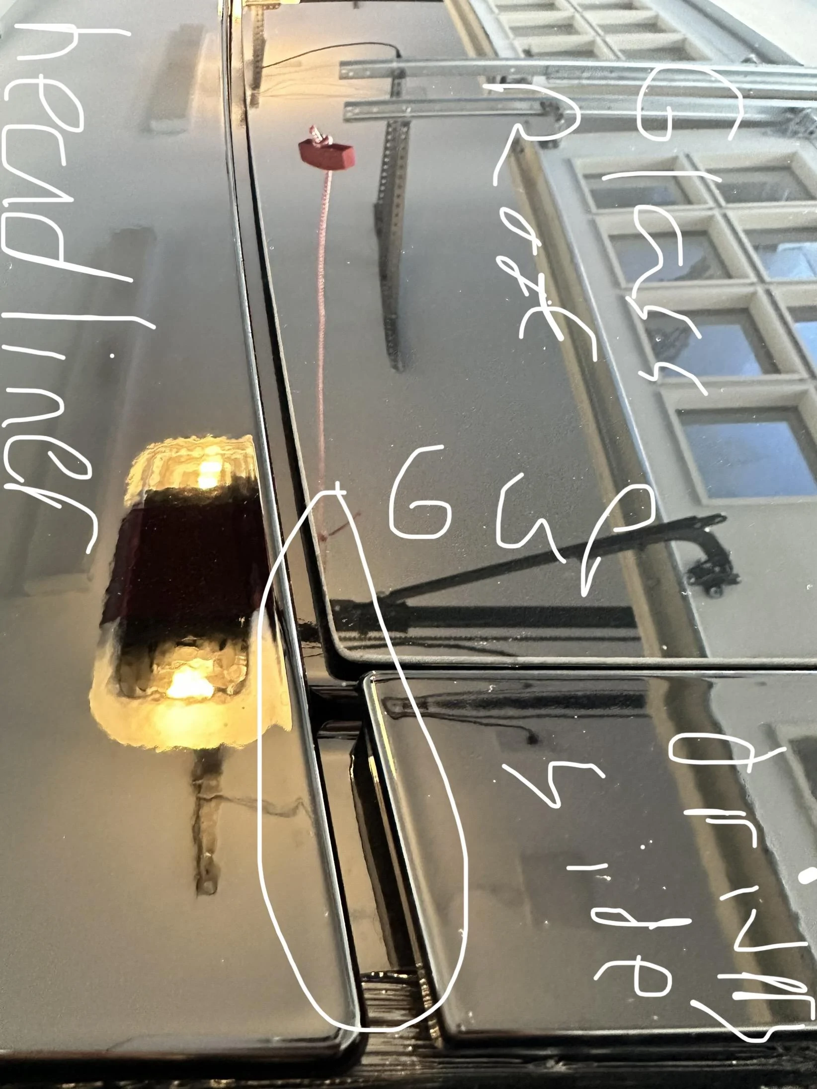

Yeah I’m in Southern California, I agree hard for them to address unless I go in with specific issue, so far I did notice the headliner and roof are not entirely even from passenger side to drivers side, Imma to cover it with tape and see if that improves the wind noise. If it does I can at least go in to the service center and let them know exactly where I think the problem is.

Install some painters tape over that gap and go for a spin. If the wind noise is eliminated you found the root cause.
