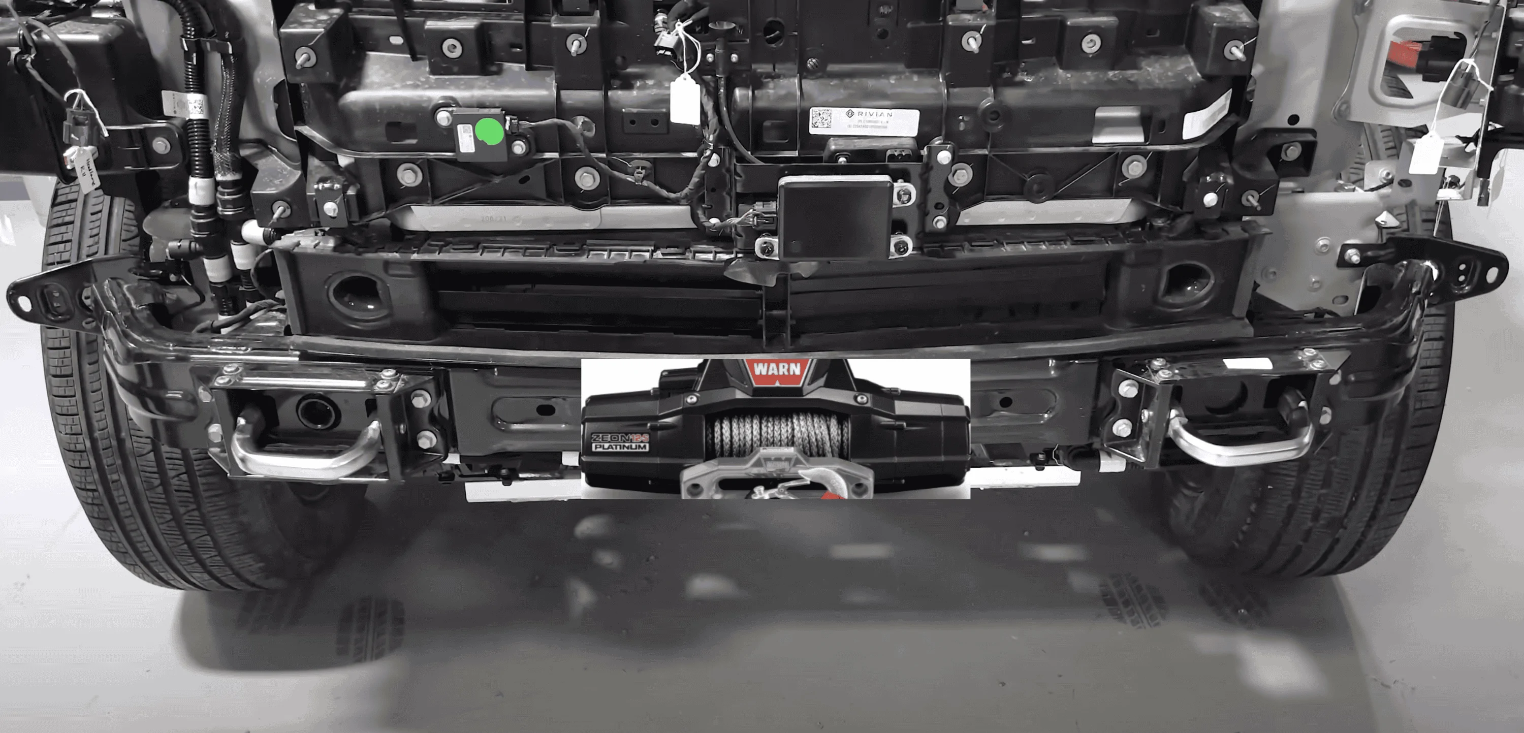

I'm also seriously concerned about the lack of winch mount options on the Rivian. Any serious off-roader knows a winch is required. Right now as people have said; the only option is a rear receiver tray winch mount that ruins departure angle and some Frankenstein power system.
If you look at the various Munro teardown videos, there's simply nowhere for a winch to be mounted in any conventional manner. It would have be behind the cross member that is under the radiator. The cable could then run forward through the crossmember … leaving no direct access to untangle or spool rope onto the winch … no thanks.
For the Rivian seen with a winch, I assume that was a "pre-frunk-shrunk" vehicle with a different radiator placement, perhaps far wider and shorter, not canted, using two fans instead of one. The current system is a mess. Airflow into the frunk compartment has to make 90 degree turns, etc.
I assume all this goes away when the Max Pack arrives, bringing with it a heat pump, fewer components, a wider radiator leaving room below for a winch attached to the front of the cross member, the upper front (between the headlights) being open and the systems being placed on the frunk (e.g. radar) like the Lightning.

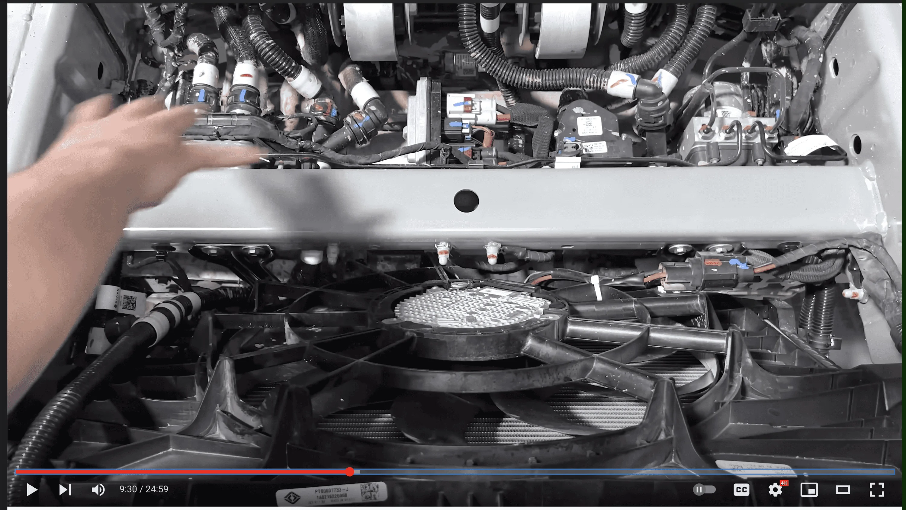

The bottom of the radiator is perched on the forward cross member, leaving seemingly nowhere for a winch.
Rivian R1T R1S Which Winch? 1666638623811
The stamped and welded crossmember between the recovery hooks must be about as stout as the recovery hooks and looks like it was "born" to be a winch location.
I think the frunk-shrunk shifting of the radiator intruded on that space and probably means the winch will require a different (wider, shorter) radiator to accommodate the drum body of the winch. It doesn't look all that difficult, just complicated and involving the radiator, which looks to be a last minute kludge anyway.
So I'm optimistic we see a winch/radiator/pump/max pack in an R1.1 early '23 with an eventual retrofit kit for the R1.0 : )
