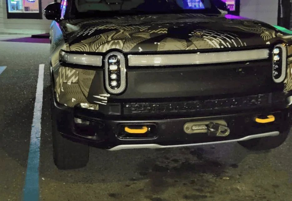

Behind this apparent factory location is a conspicuously "born for this" cross bracket.
Rivian R1T R1S No winch (yet?) what is the alternative 1666825303567

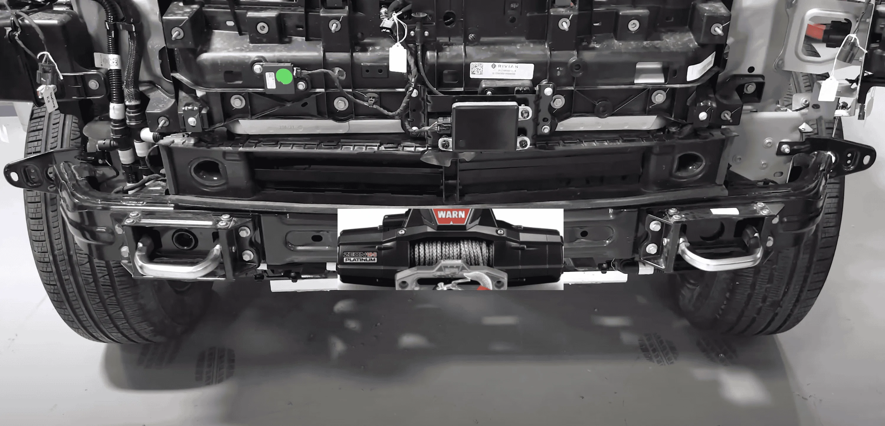

You can see the winch drum right behind the fairlead. It's a pretty stout location between the recovery points. I assume this development mule had a different radiator mount and location than the production arrangement (shown below with a winch pasted in, not to scale, but probably about what's involved. WARN might even have some ideas on how to saddle the winch with two 12V batteries to either side of it (charging off the vehicle 12V batteries, but not attempting to put them all in parallel, I think that's asking for trouble, but again, I'd look at options to get the kind of current the winch wants to draw
 no use putting it in there for show and have it too weak to work when called upon.)
There's two problems:
The dinky little 12V twin batteries don't look like they would ever work a cold cranking day in their life.
Adding a serious 12V battery would be heavy, bulky and, I dunno, maybe there's an underbody cavity somewhere to snug it away and feed some power cables forward.
Winches put a phenomenal load on front suspension if you're not careful. Even lowering the air struts to their minimum height might not be enough to protect them from the forces dragging the nose down to the bump stops. Overloading the bump stops could be
 tricky for warranty coverage.
I'm guessing the whole chassis of the R1T is heavily over-engineered and designed to take the 8000lbs of it hitting things at 80 mph and bottoming out. But again, the way a winch loads up can be a serious amount of leveraged force.

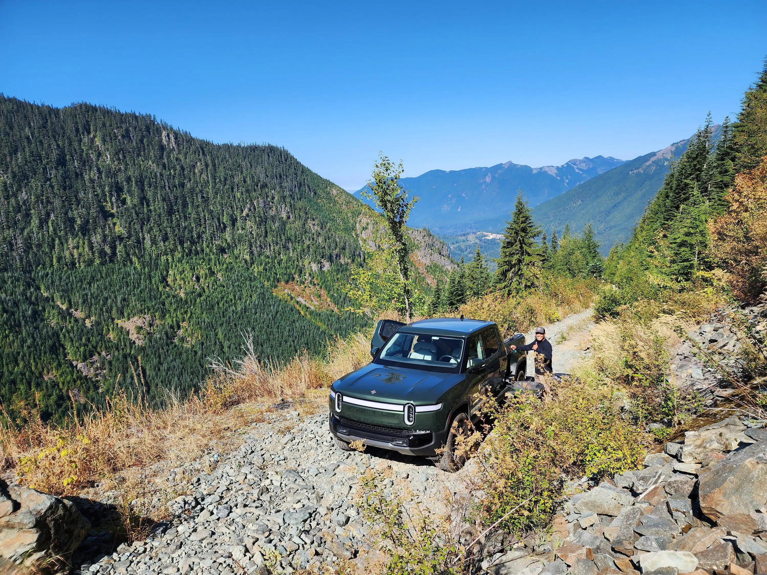

Actually I've done this already that's the service truck delivering my spare, they did say home visits right.
Rivian R1T R1S No winch (yet?) what is the alternative 20220919_122314
