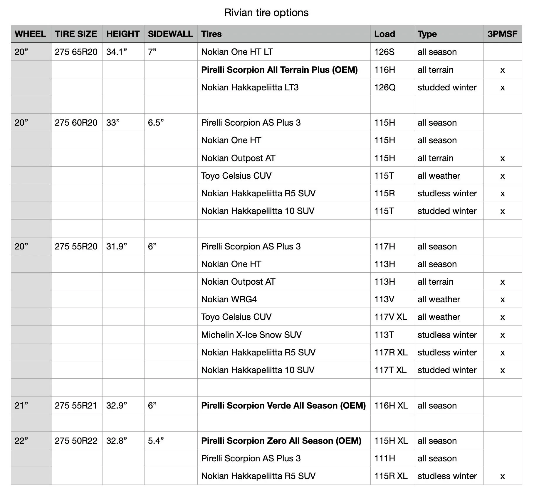

I've compiled a (non-exhaustive) list of tires that would fit on the 20", 21", and 22" wheels. Mostly from Pirelli and Nokian.

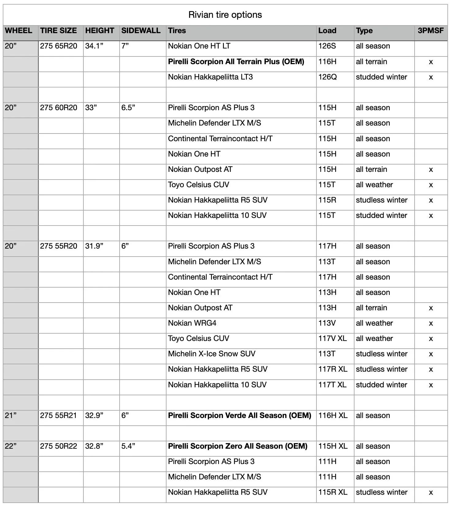

Added Michelin Defender LTX M/S and Continental Terraincontact H/T.
Unfortunately, there's no easy way to compare rolling resistance between all these tires.
Any chance you could add tire weights to this as well? This could affect efficiency as much or more than tread pattern.
