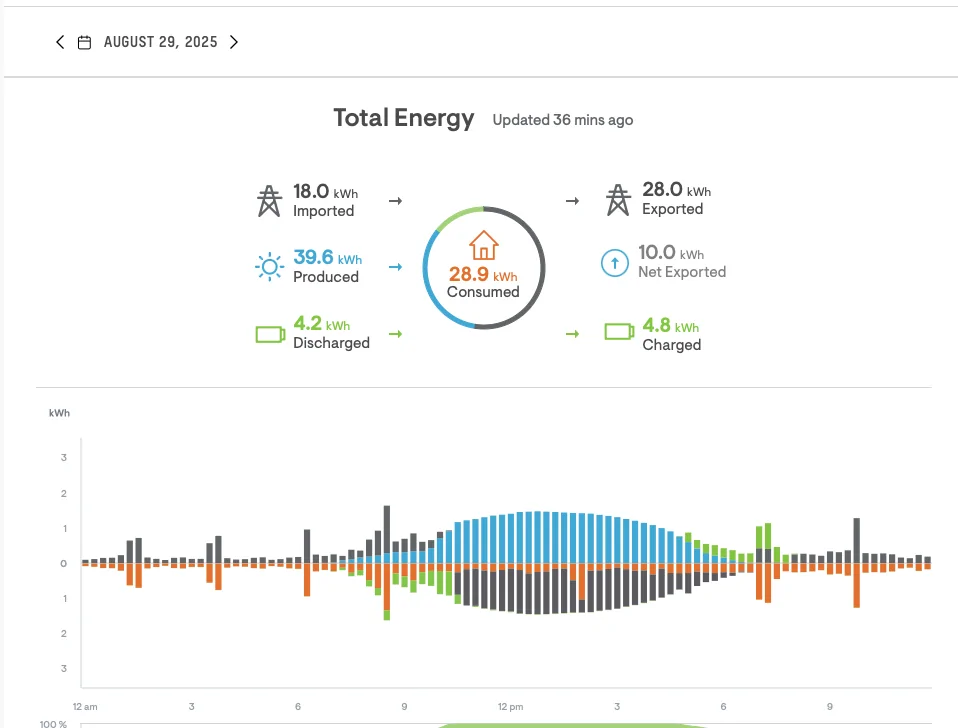

If you're going to use your truck for backup power in an emergency, beware that you likely use MORE electricity per day than you think. Below is a screenshot of the last day we didn't have AC running or charged one of the EVs. There's a lot of vampire drain in a house and if using V2H, you'll need to turn off some of the breakers. Note that in the screen shot below, we do have a jacuzzi and swim spa that accounts for some of this energy usage.
Rivian R1T R1S V2H crickets Screenshot 2025-09-04 at 10.30.36 AM
