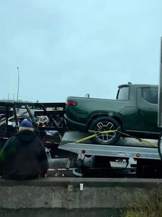

At least this didn't happen for your delivery day! My brother law sent me this picture after a scrap truck hit the tow truck. The Rivian crushed the scrap truck!
Rivian R1T R1S UPDATED 6/2 - Delivery day (Hello!) and Return day (Goodbye)  ... argh! "Ride height change not possible due to overheated air compressor" 281146555_10166047975845244_4263382152268970371_n
