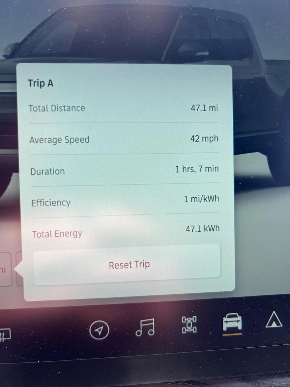

Pretty consistent results of 1mi/kWh towing a 7000lb travel trailer. Started at 82%, arrived at 43%.
That seems like a good benchmark. I'm at about 5300-5000 lbs with my loaded horse trailer and get maybe 1-1.3 mi/kWh depending on the drive. I just use 1 mi per kWh as my basis when planing a tow for now.

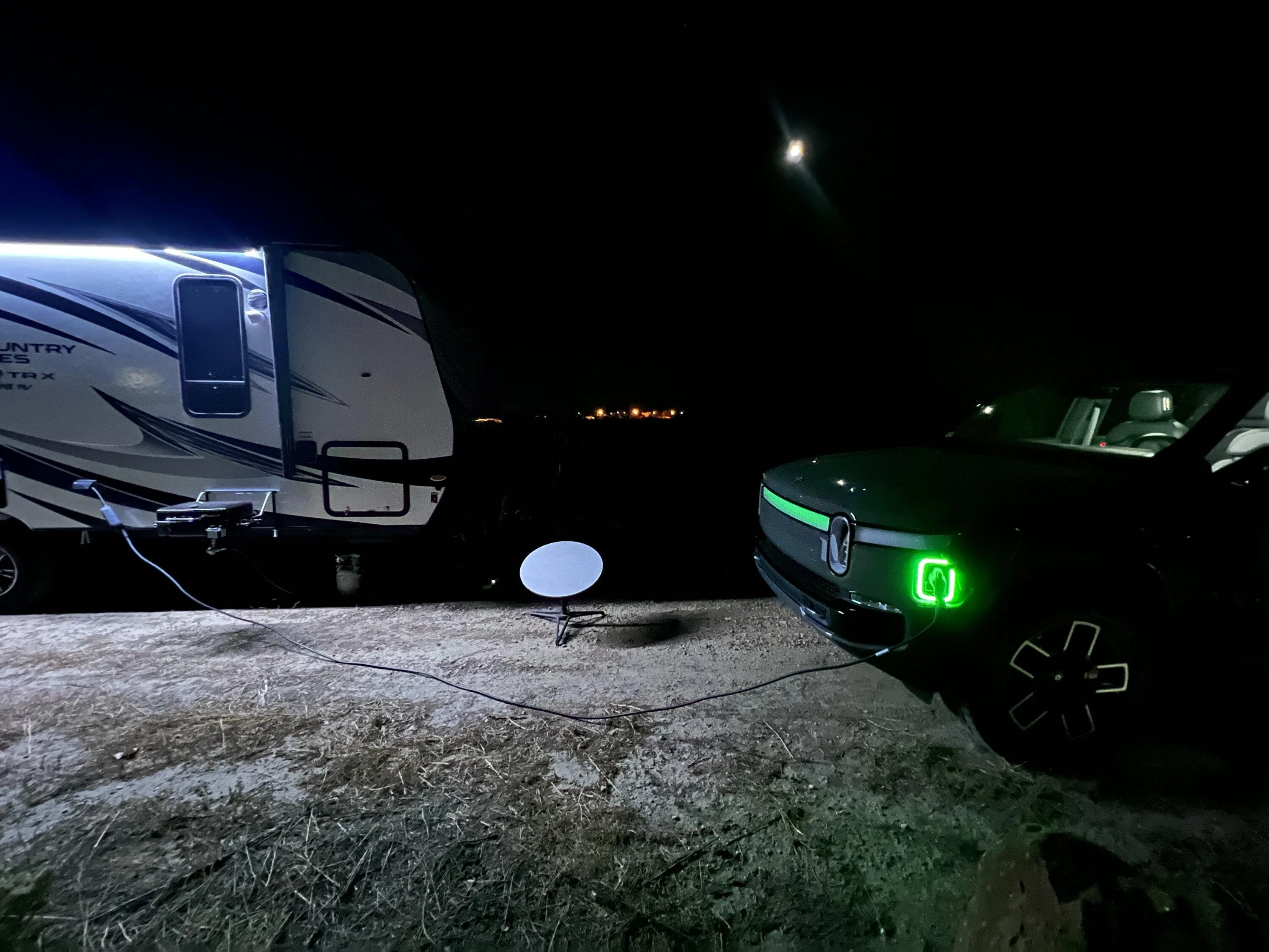

Does it count as increasing towing efficiency if I charge the truck using the towed trailer’s built in generator? Doing the math says a full propane tank would charge about 26kw charge over 18hrs.
Depending on the Onan, it might be possible to rewire for a 240 output. Still will be 4000 watt limited, so it might not matter much.
I haven’t looked into a 240 output but have thought about wiring in a separate 30 amp breaker and outlet to use for charging if needed. That would provide about double the charge rate even staying on 120v.
Good point, some of them don't have a tt-30 service plug. You'll need to find a EVSE that can do 24 amp 120 volt on amazon, but they exist. I believe someone said the Rivian will take 24A @ Level 1/120v
It will. I have a TT-30 to 14-50 adapter I’ve used with the included EVSE and it will charge up to at least 26amps, the highest I was able to go on my 3500 watt portable generator before it started stumbling.

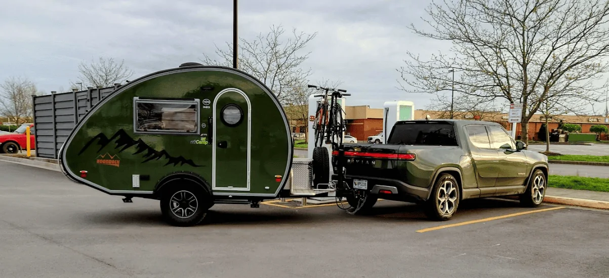

Awesome. I was wondering how these did. Seems like it's about on par with our "Teardrop" despite being much larger.

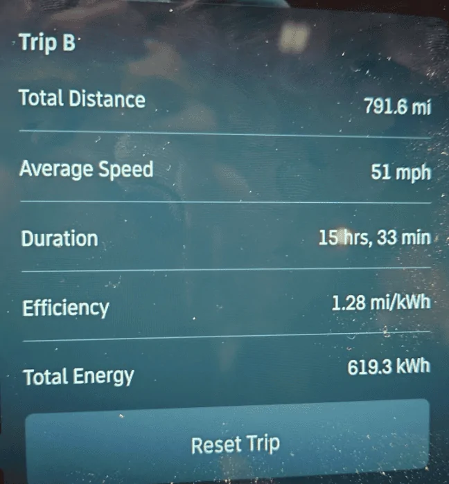

Last week we got back from a long (almost 800mi) trip. in decent weather (upper 50s)
Overall 1.28mi/kWh.
Tended to do about 68-70mph on the interstate(650mi), ~62 on the state highways (100mi)
Had some park driving at ~30mph (~20mi)
I think running with the bikes on the front + no aero covers combined to give about a 5% hit vs. what we previously experienced.
Southbound we had a very slight 3-5mph tail wind and did about 1.35-1.4 mi/kWh
Northbound we had a 10mph head/side wind and typically saw 1.05-1.25mi/kWh.
For 2 of our legs, we used about 80% of the total battery capacity (~90% ->~10%) to travel 110mi, which forced our speeds and strategy. For those legs, I was constantly using battery % and last 15min consumption to re-calculate our remaining range and adjusting speed up/down 1-2mph to ensure we had 10-12% upon arrival.
Is there room inside the teardrop for them? I guess that would complicate using the trailer while you're at a charging stop though.
