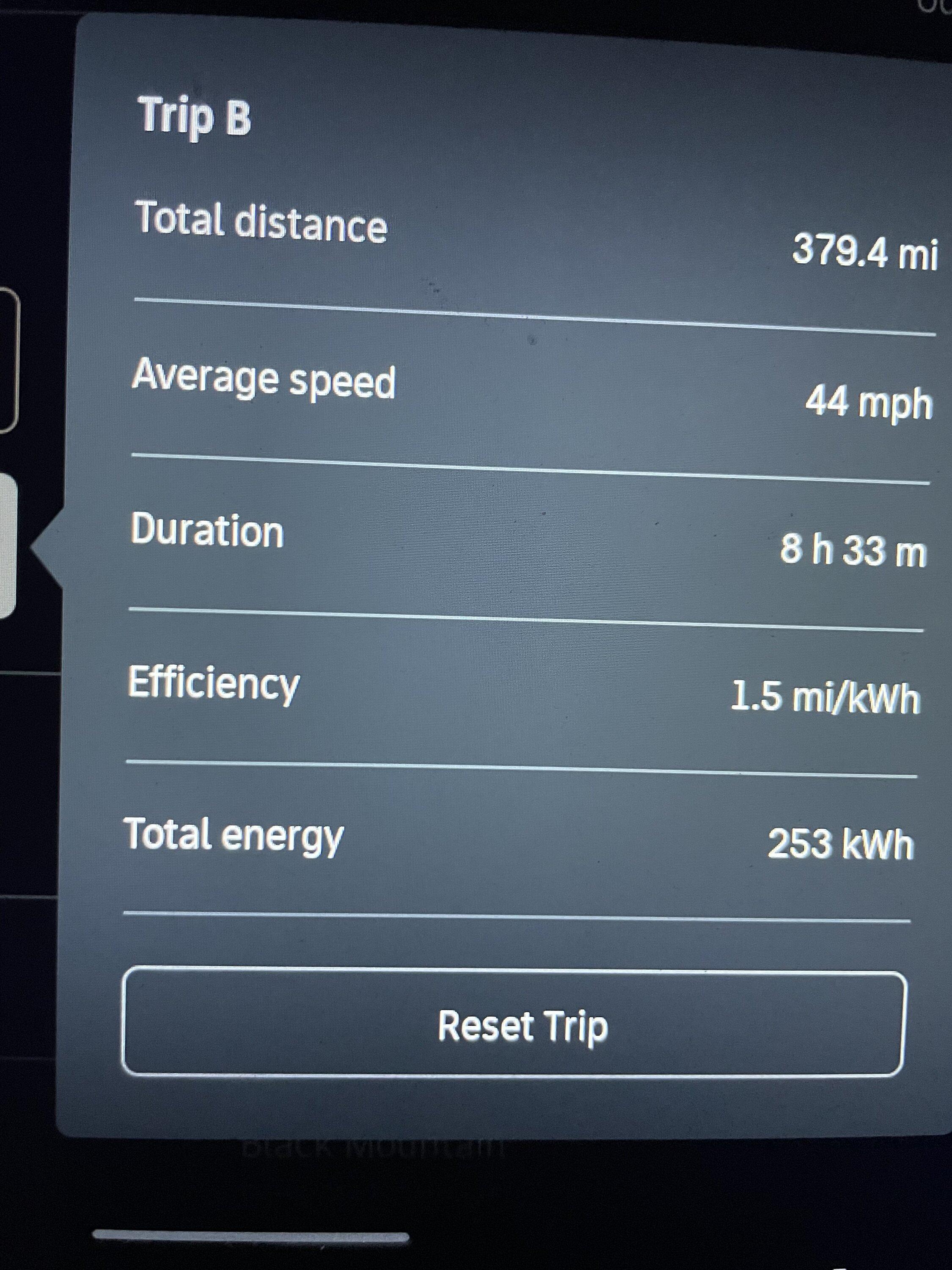

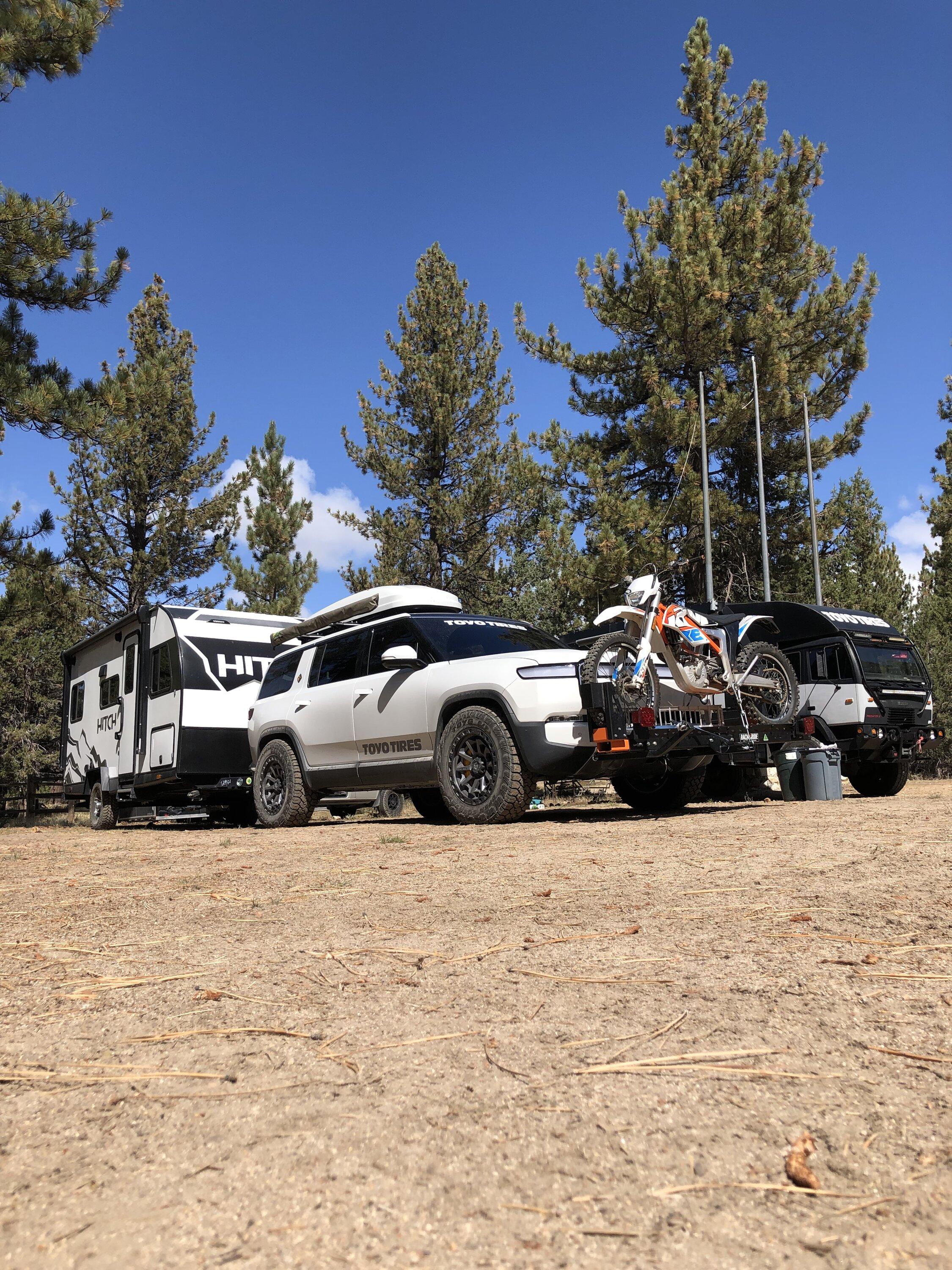

1.2mi/kWh - 850mi, mostly on RAN. Aligned at 11.5” drive height.
Used cat scale for trailer weight 5480lbs, weighsafe hitch for tongue weight. ~500lbs.
Roof box is rather large, but KTM EV hanging off the front is likely the largest range hit.
Yep. The KTM was the “issue”. 1.8mi/kWh without it.

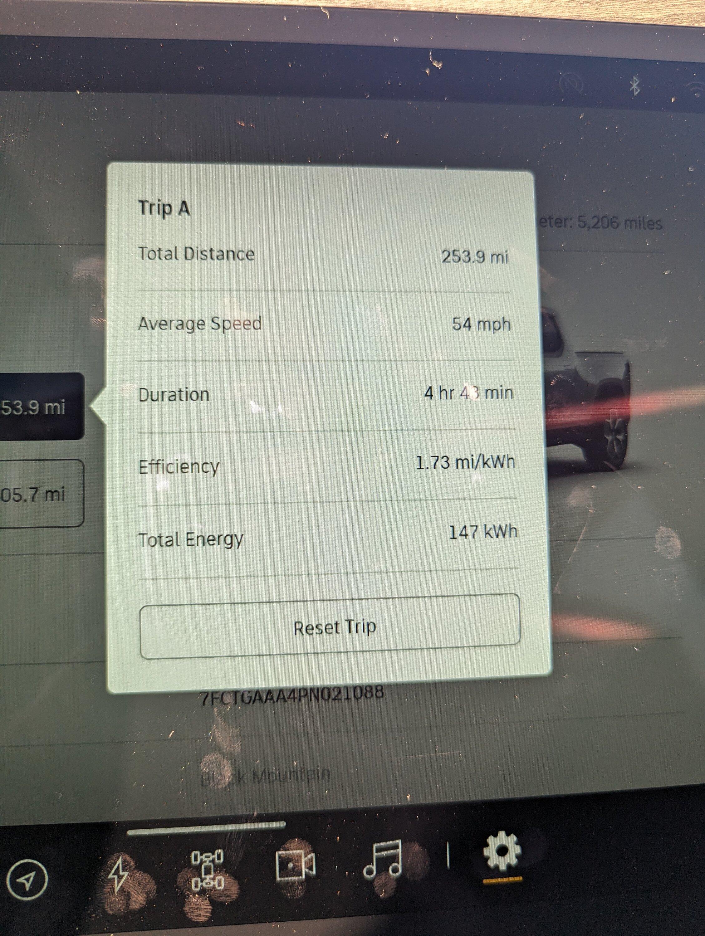

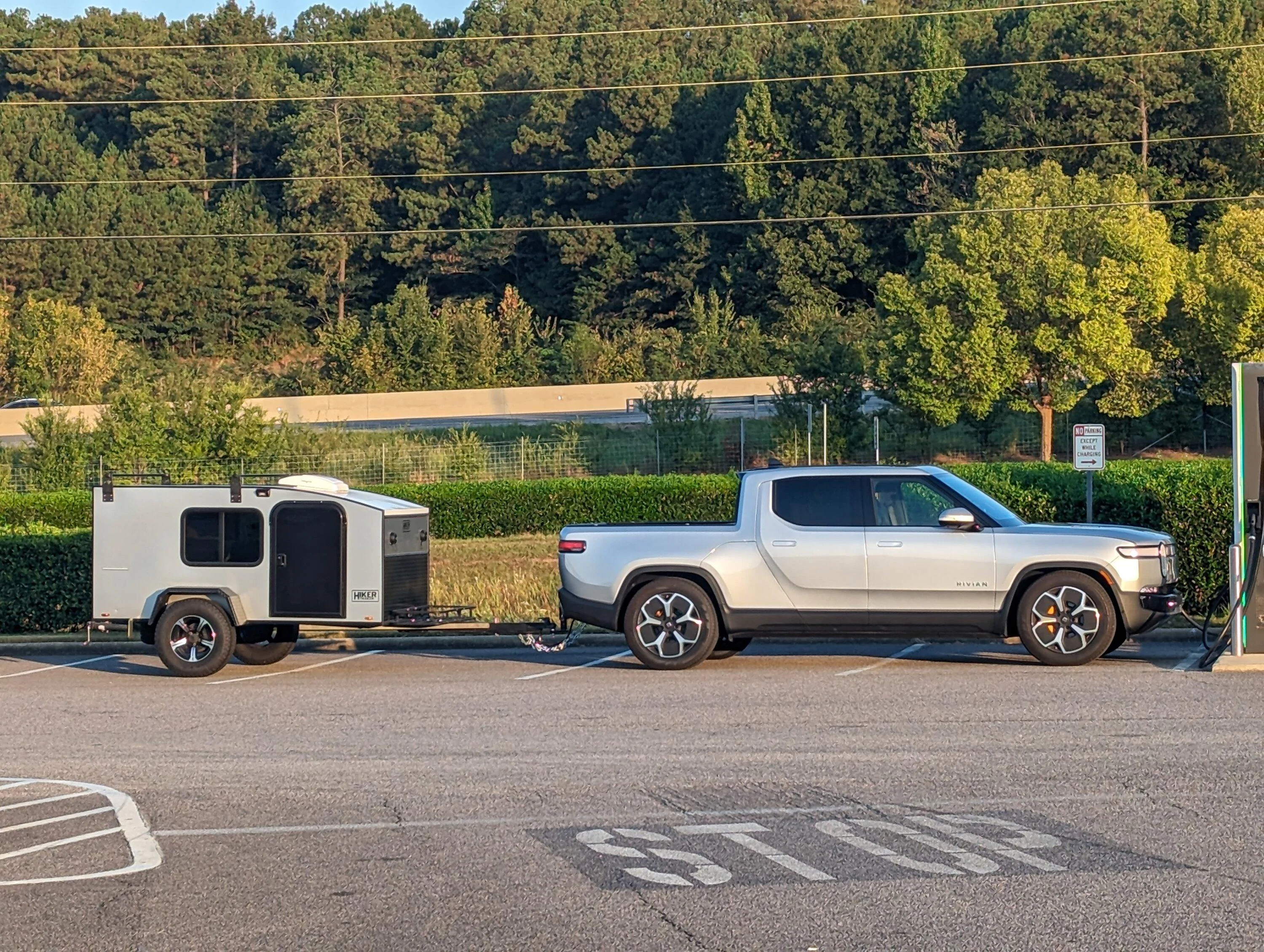

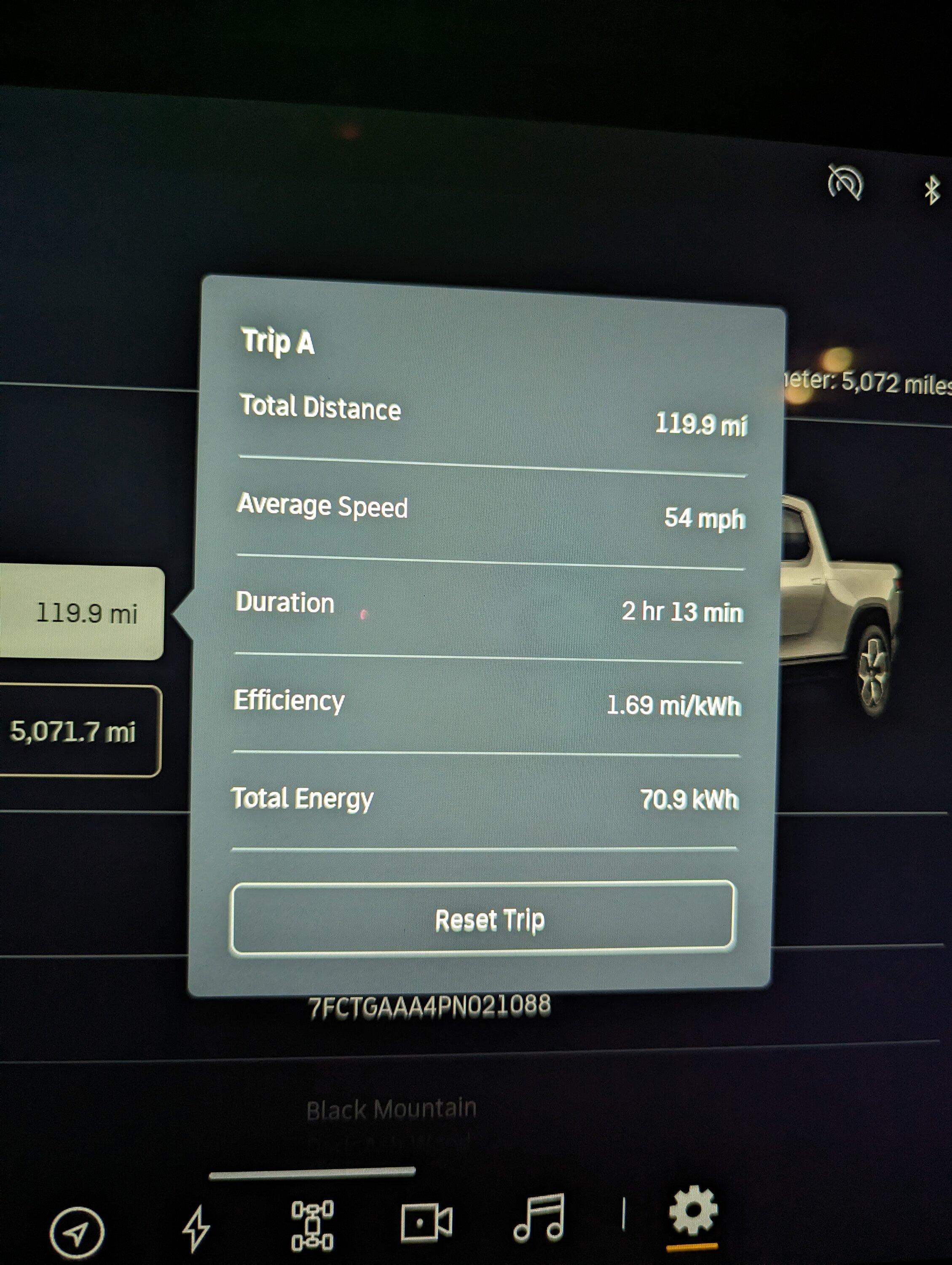

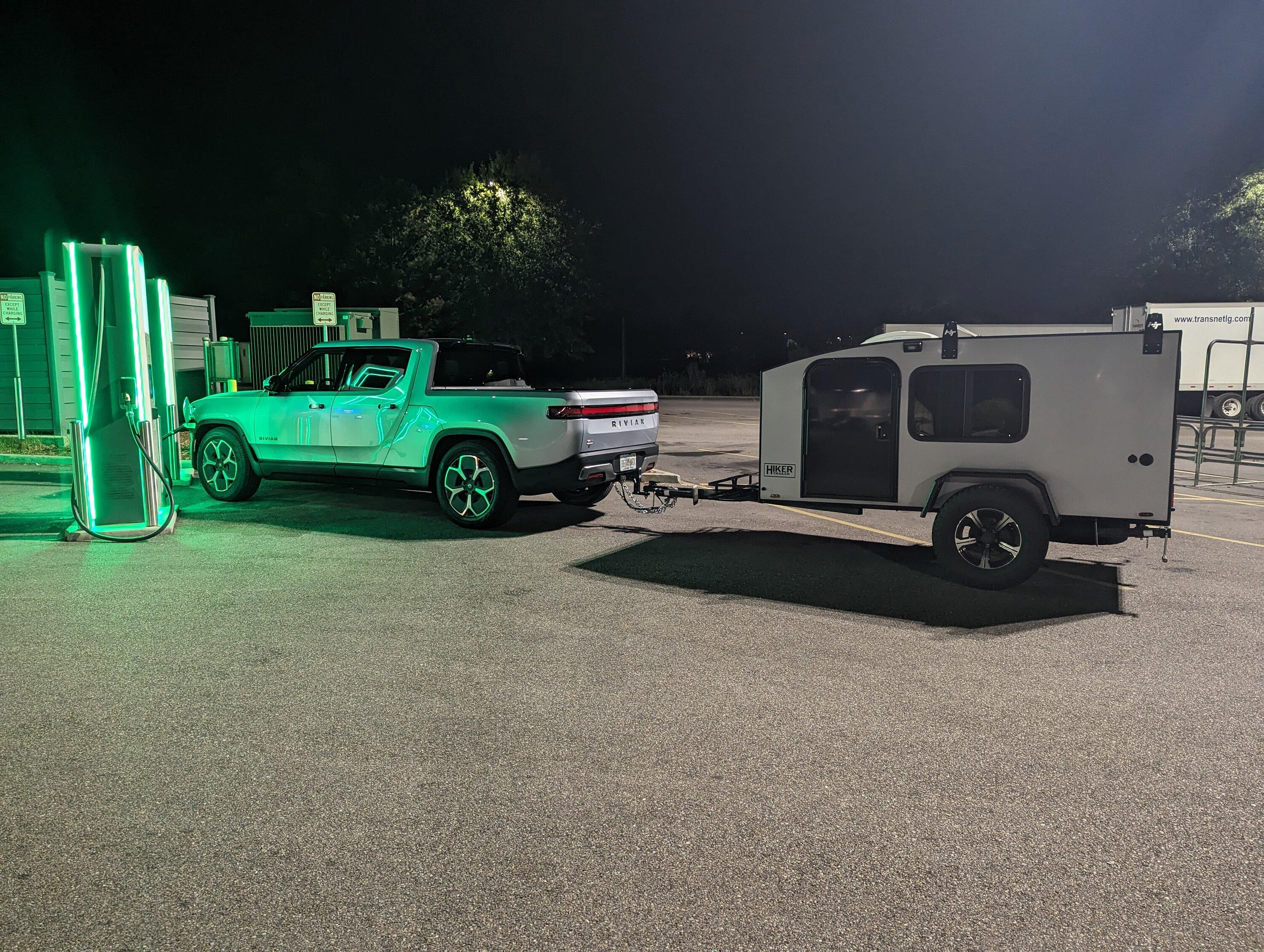

Completed my first trip towing small camper trailer. Hiker trailer is the company and it's their 5x9 box and 13’frame. Weight of the trailer is approximately 1600 lbs with our camp gear in it.
Towing conditions were temps in 60s on the way up and 80s on the return and wind generally light all day. The trip was from NW Florida to Birmingham, AL all on one day. Attached are two pictures showing the efficiency at the first stop and then again after reaching the destination. I did stop a little south of Birmingham for 8 min charge as insurance to make it from the drive electric Alabama car show and then back but didn't actually need it. Speeds on the highway at or slightly above 60mph.
Don't have pictures of return efficiency because it got ruined by the interstate south getting closed for a bit and I had to go around with a bunch of other cars causing additional traffic. I did see slightly better efficiency though due to the slight decline. Averaged out to around 1.7 m/kwh. When charging I used the planning factor of getting 2 miles of range per displayed % level to know when to leave.
I used electrify America all day and had no issues and got the max charging level requested by vehicle. The second two pictures show how the trailer looked behind the truck at the stations. Never had to drop. Ride height was set to low in tow mode and seemed pretty level.

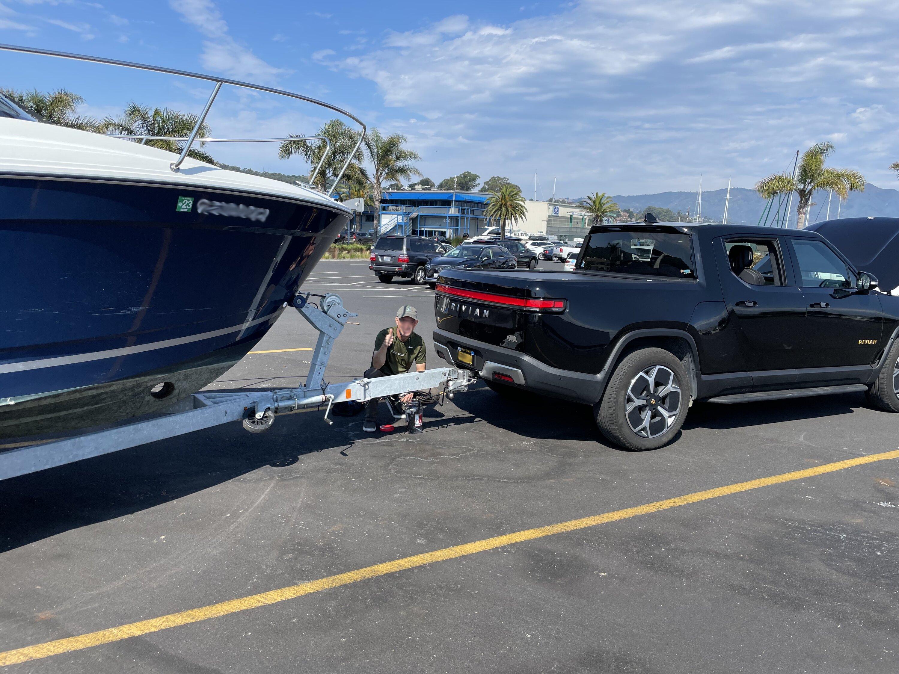

Just finished my first long towing trip. It was a 454 mile round trip with my R1T towing a 4,750lb (boat + dual axel trailer) load. For the entire trip roundtrip, I averaged about 1.1 miles/kWh.
R1T with 16k miles on the odometer
21" wheels
Almost all 454 miles were highway miles at 55mph.
Weather was clear and mild with no significant wind
For planning purposes, I used ABRP app configured for 1.1 miles/kWh. Given all the highway miles were at 55mph, I expected better than 1.1 miles/kWh but that's what I ended up getting.

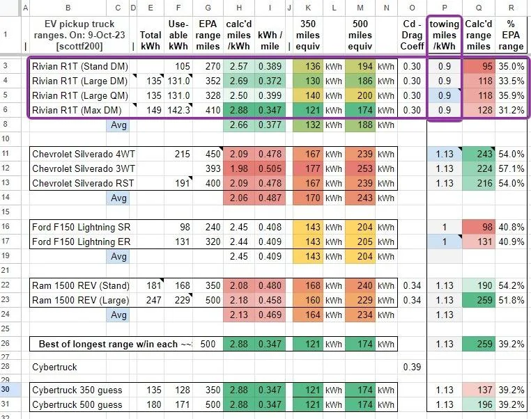

Been looking over this thread and trying to decide what a good representative 'common' number would be for column P in my spreadsheet below for mi/kWh?
1.1? or 45% of "calc'd miles/kWh"
I got the 0.9 from this video:
7420 lbs dual axle trailer​
Edmunds Cars - Electric Truck Tow Test: 2022 Rivian R1T vs. 2022 Ford F-150 Lightning | Towing with Electric Trucks​
Rivian R1T R1S Towing + Efficiency: Please post your experience! gcs8bZM

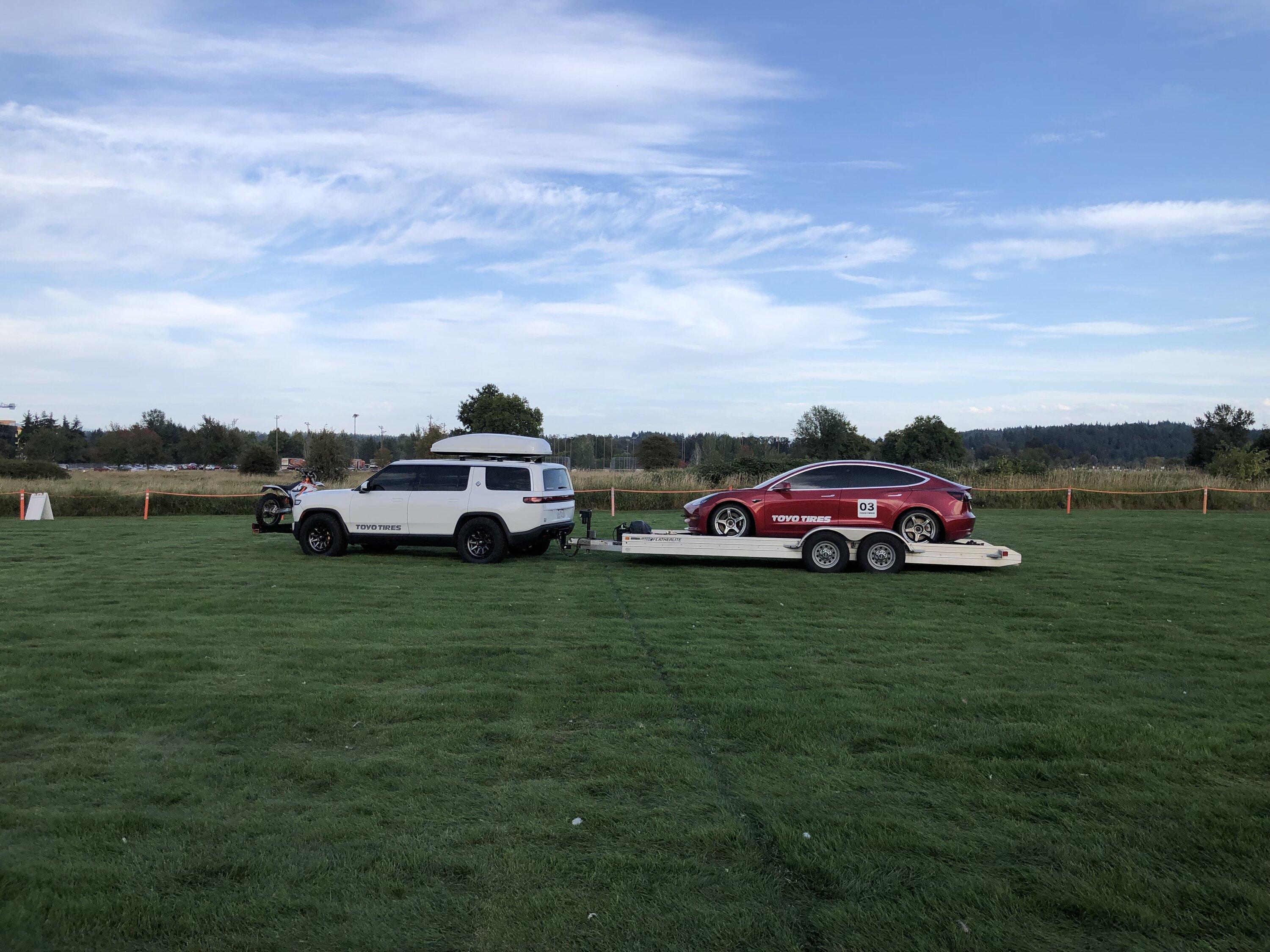

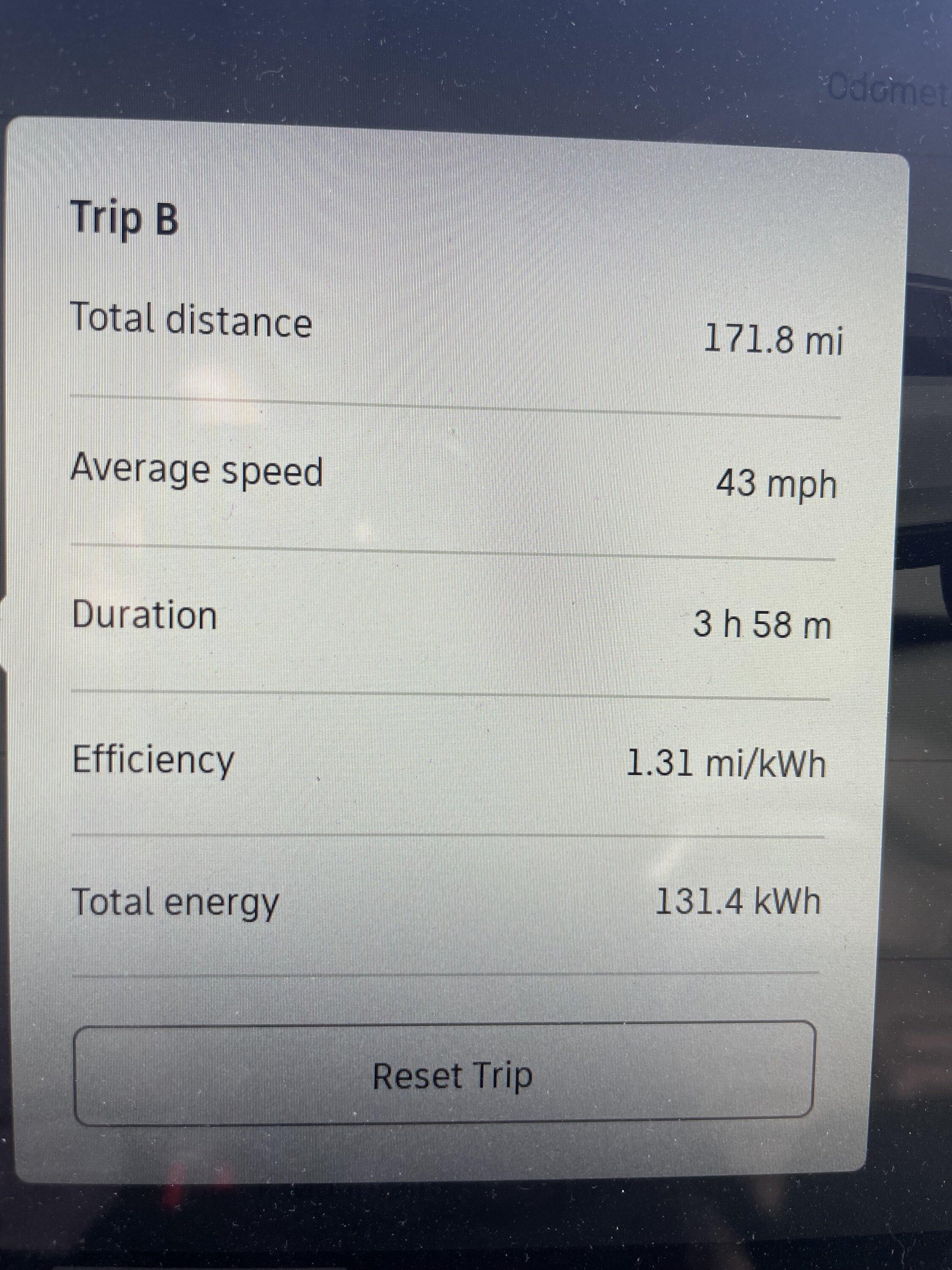

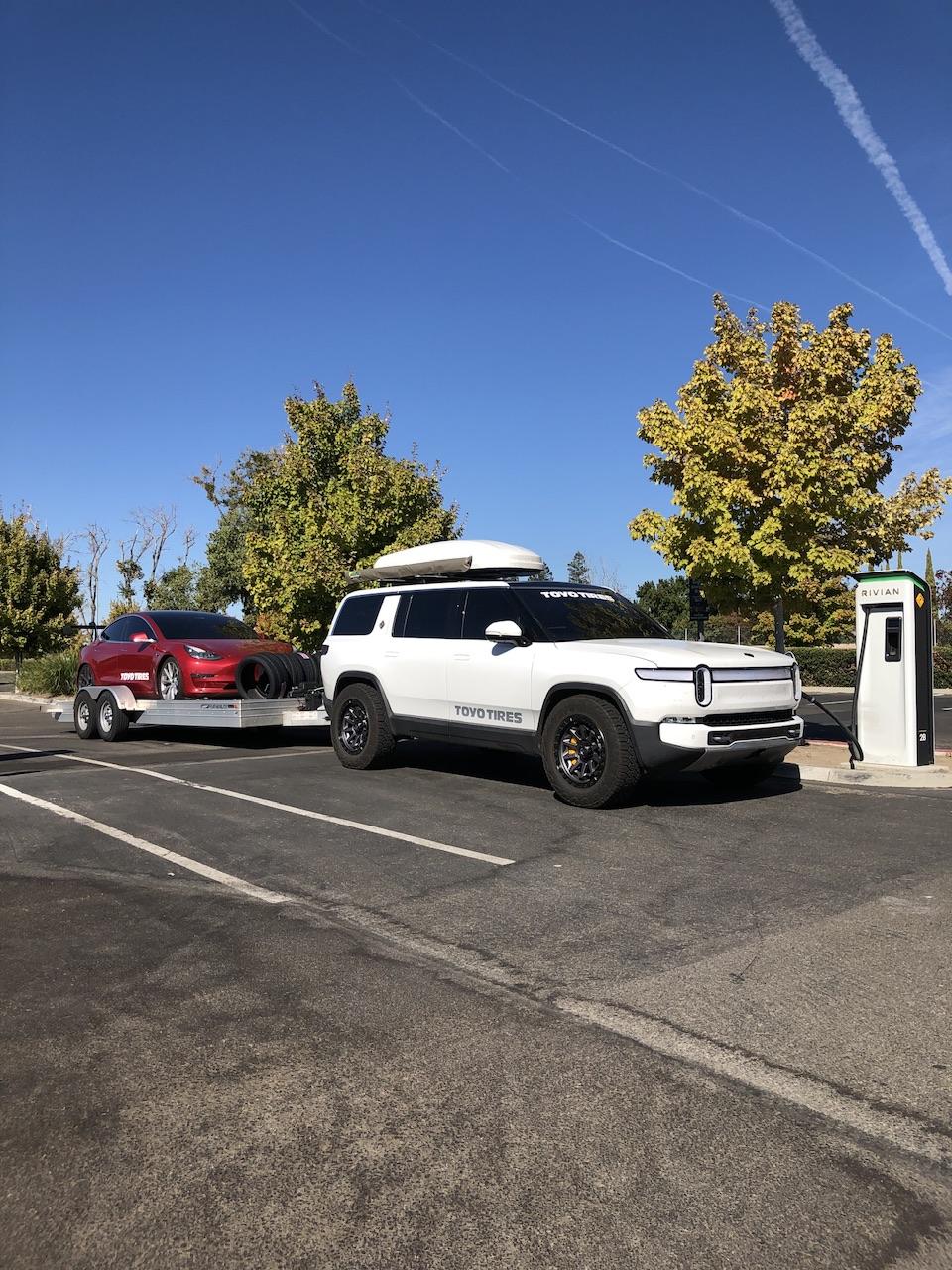

Another 1k miles down. 1.4mi/kWh.
~5800lbs. 20ft featherlite, Model 3 time attack car, gear spread out throughout the combo.
1.4! There's way too much aero going on there! I'm just picturing our box shaped trailer back there instead?

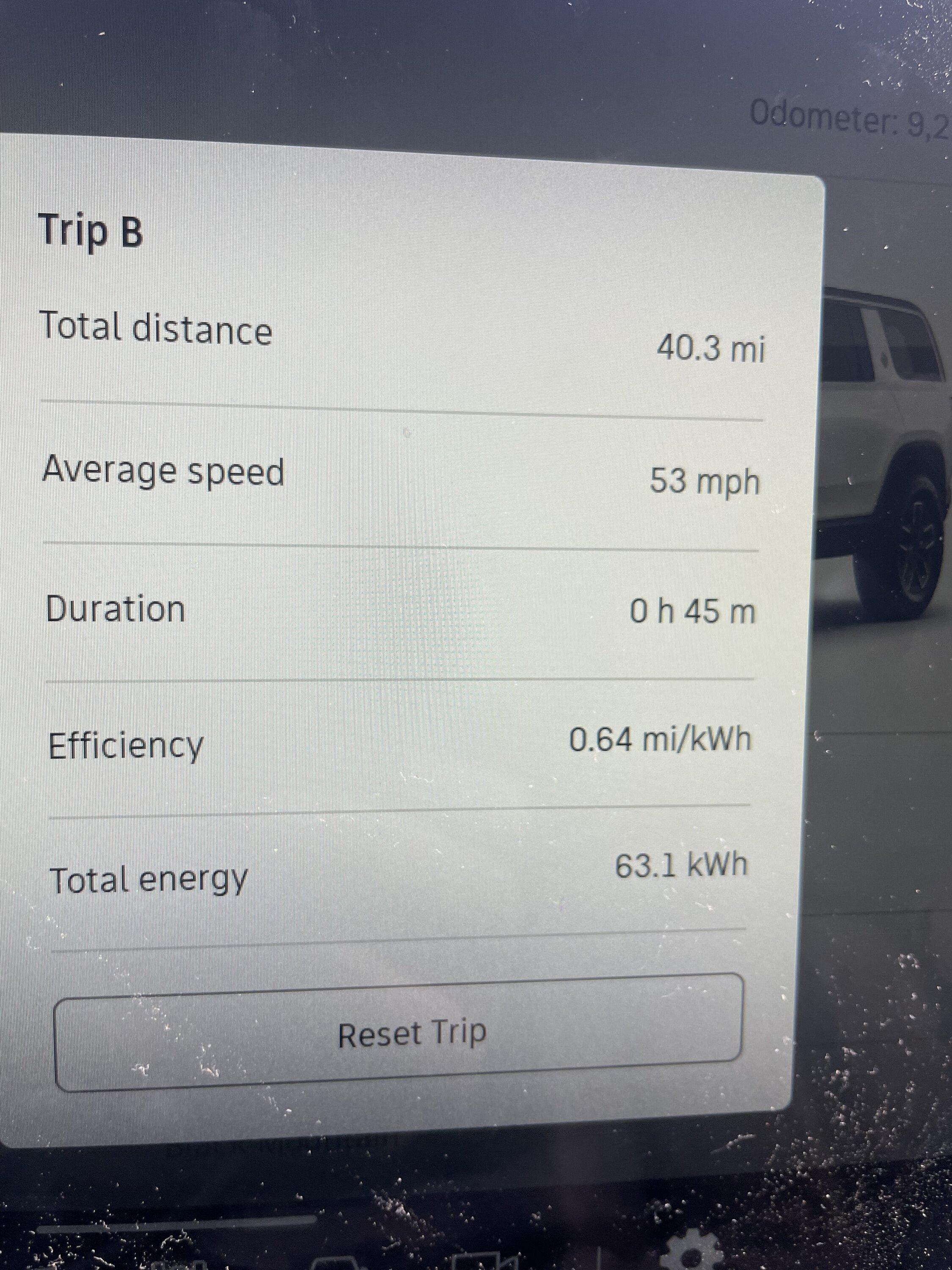

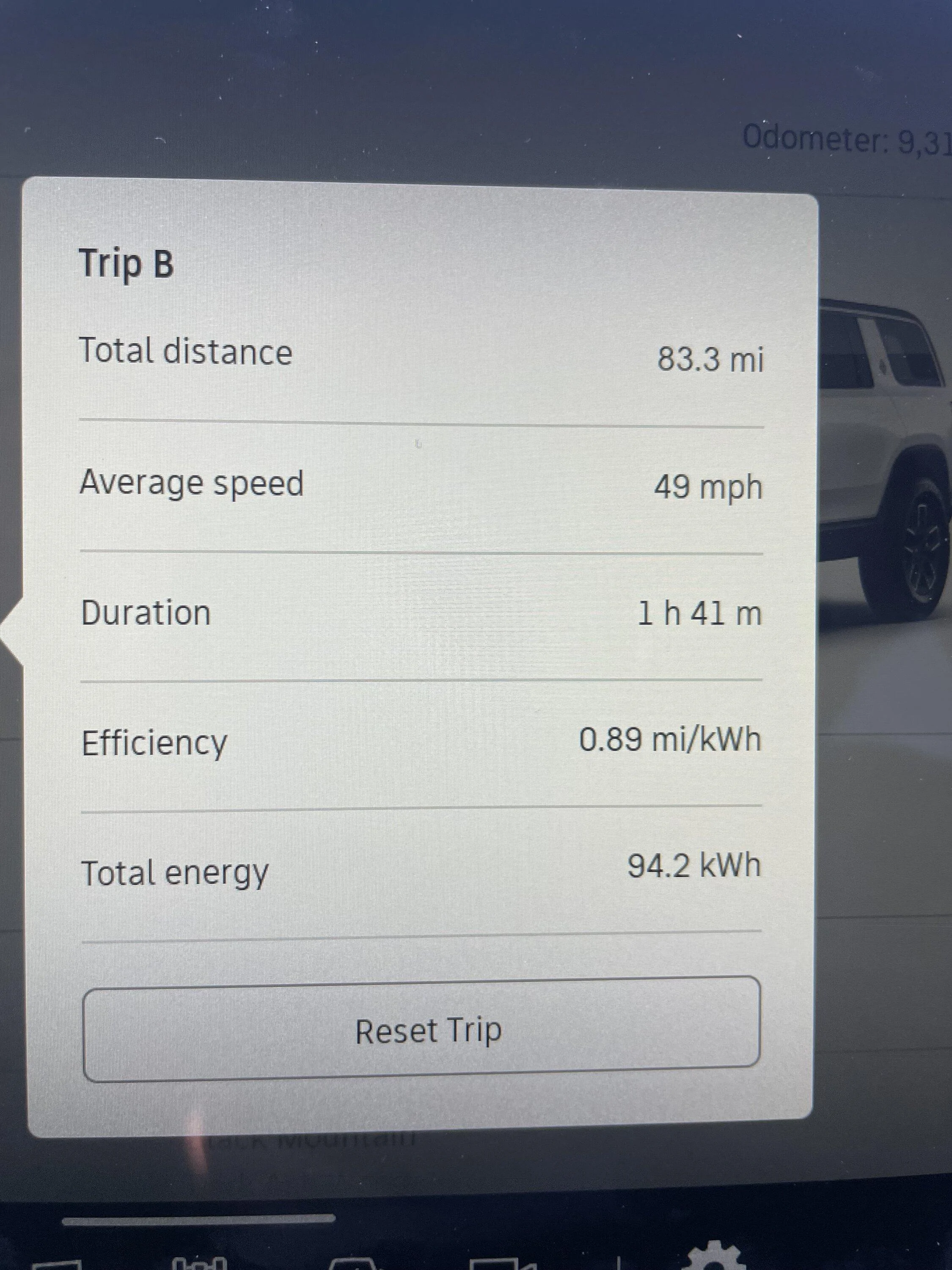

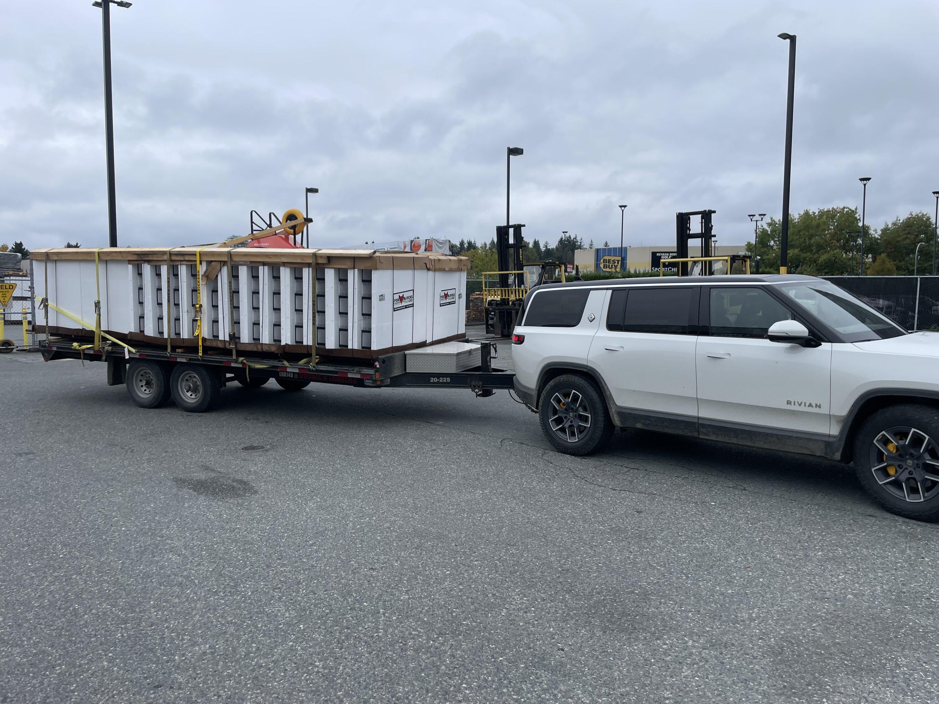

QM, 20"AT towing Foxblocks, treated 2x12's & rebar, likely about 5000lbs.
The first leg was an essentially flat 50 miles using 40% SOC.
The 2nd leg as per 3rd image was climbing 4400' in 40miles which netted the very poor .64m/kw.
The 2nd image included the 2nd leg & down the pass losing 2200' from the summit yielding an average of .89m/kw over the mtn pass.
Towing back home empty (3750lbs) yielded 1.6m/kw over 150 miles with a net loss of 3600'
Aero is certainty a huge factor in efficiency, huge consideration on future cargo/rv trailer purchase.

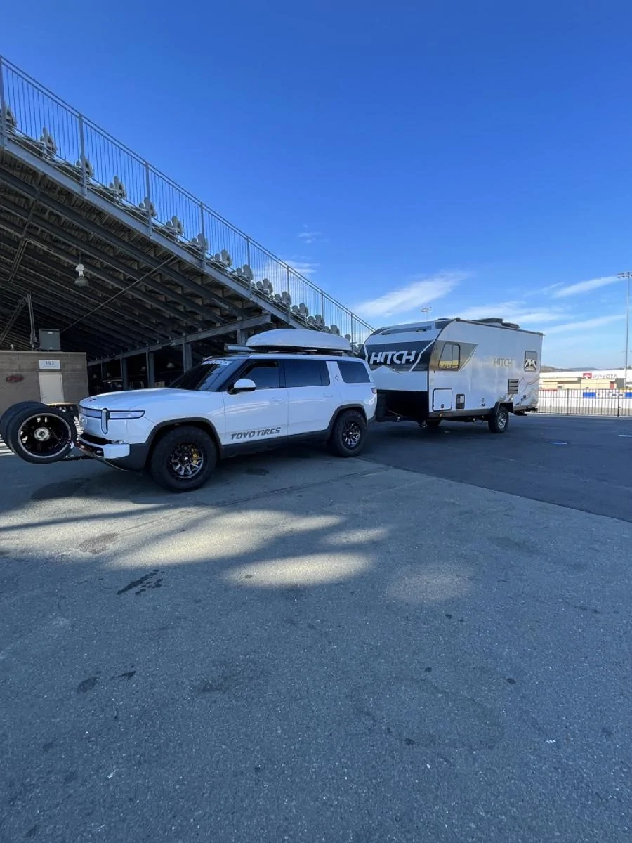

Can you tell us more about what I'm assuming is a front receiver hitch?
We built a front receiver for the vehicle in order to best utilize the SUV for our (needs) / adventures.
Have considered selling them, but decided that I’m not willing to take on the liability. Despite beating the snot out of it off-roading with the camper.
