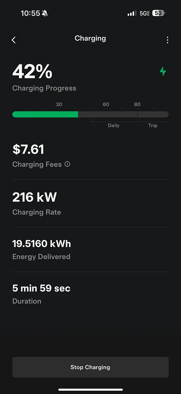

Not my experience. Screenshot taken during a Tesla SC session today.

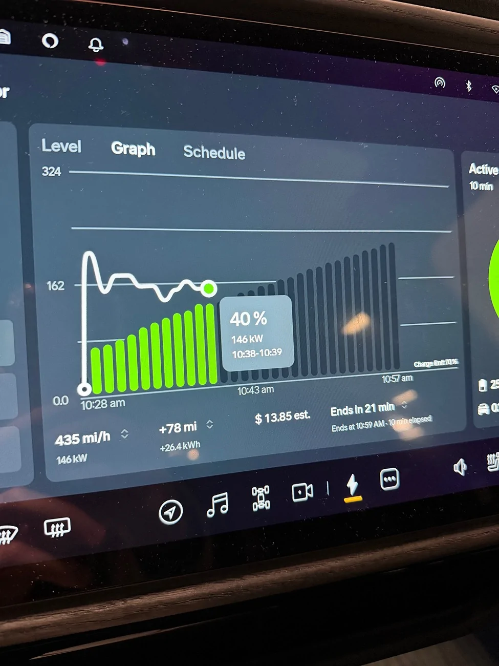

So I just tried using my wife’s official Rivian supplied adapter and I’m getting better speeds at the same Tesla charger I tried last week.
Not blazing speeds, but better than the 60-70 kWh I was getting last time. I’m going to try my adapter again at this same charger showing up with similar battery level and see what I get.
Stay tuned šŸ˜‚.

Wow! That's good! I've hit around there once or twice when my battery was (well) below 15%. Usually pegs in the 140-150kW range until it hits 70%.
We're planning a road trip for the week after Christmas (weather permitting). Will see what we get when we are on the road.
