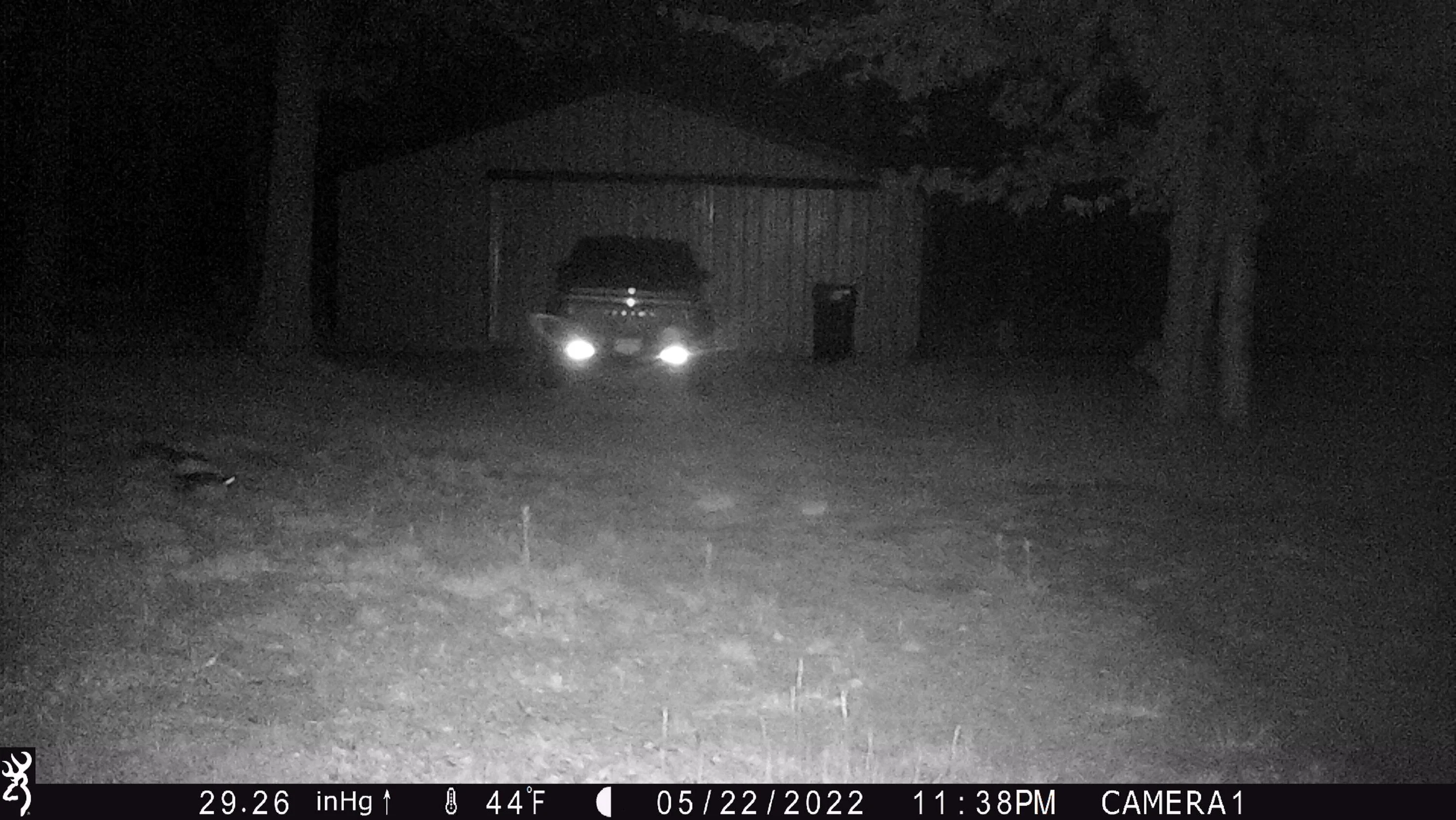

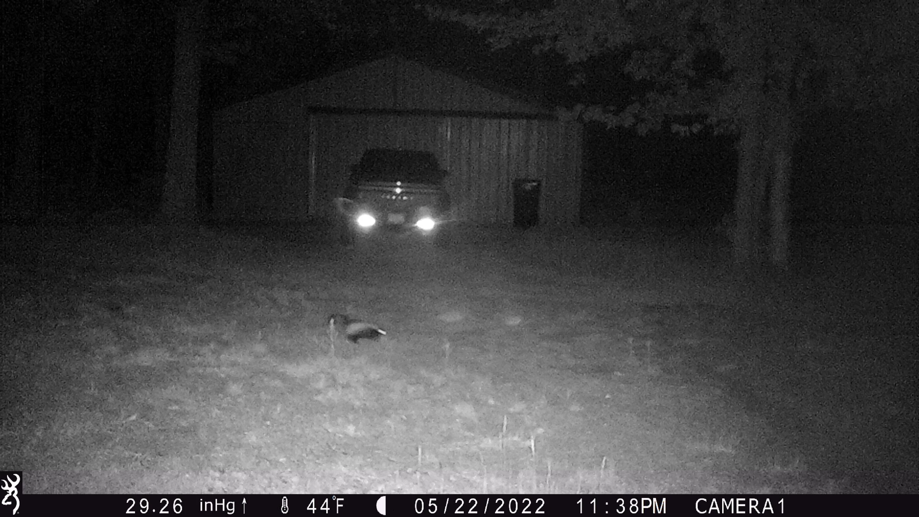

I wonder if it isn't something triggering the security system. Truck was parked up on my camping property which happens to have a trail cam aimed at the general area. Phone/NFC card no where near the truck. At 11:38 p.m. trail cam is triggered and you can see taillights appear to be on (first pic). If you look closely, you'll see Pepe Le Pew on the left side of the frame. Pic 2 shows him in the middle of the frame and pic three shows him to the right. It could be total coincidence that the skunk triggered the trail cam which then happened to pick up the tail lights or it could be the skunk also triggered something on the truck.
Rivian R1T R1S Taillights blinking randomly while truck is locked and off IMG_0189
Rivian R1T R1S Taillights blinking randomly while truck is locked and off IMG_0190
Rivian R1T R1S Taillights blinking randomly while truck is locked and off IMG_0191

Those aren't the tail lights, they are the reflectors which are reflecting the infrared light the camera is using to see at night.
Ok, that makes sense. Glad to know a skunk wasn’t setting off the security system.
