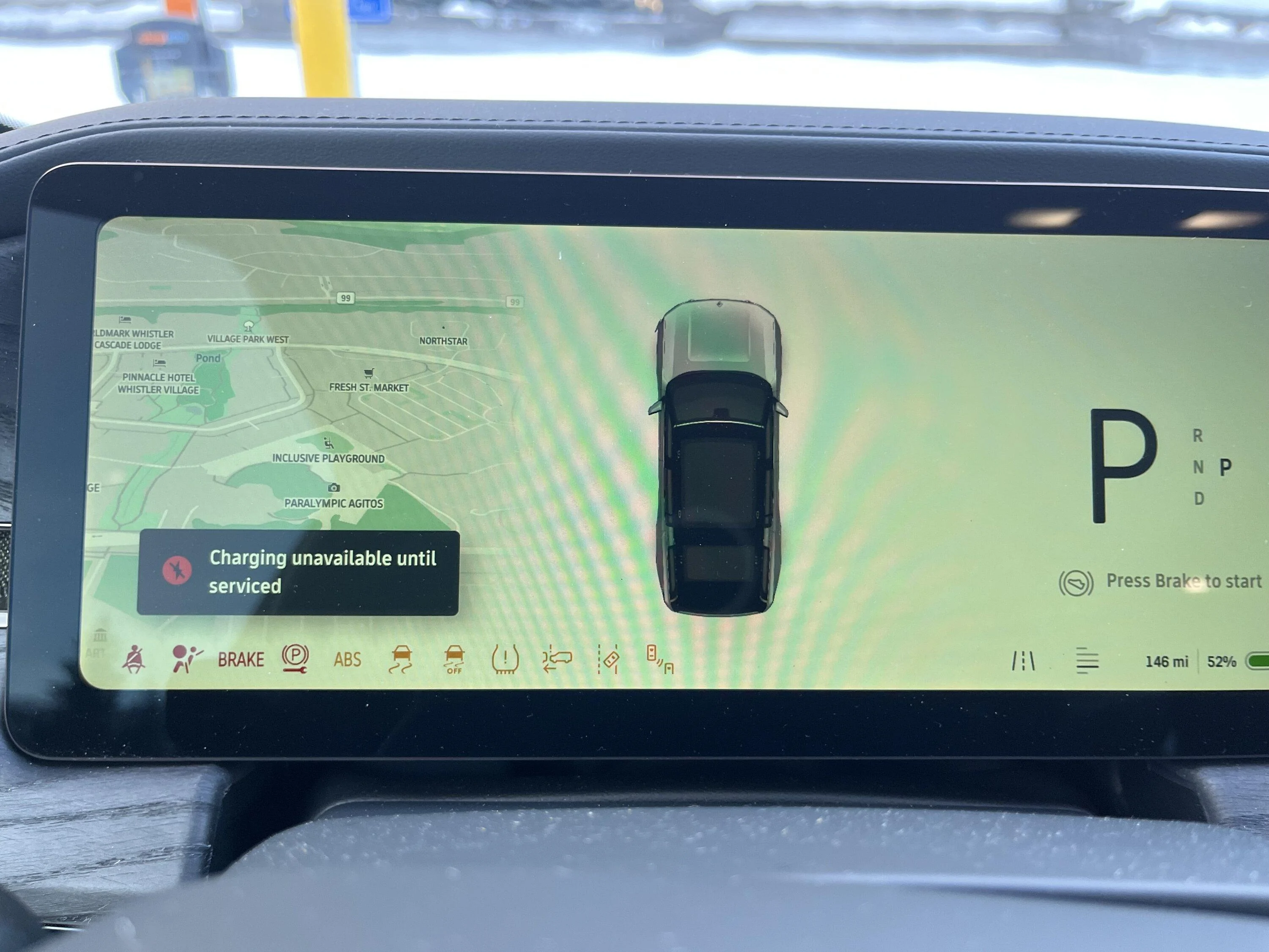

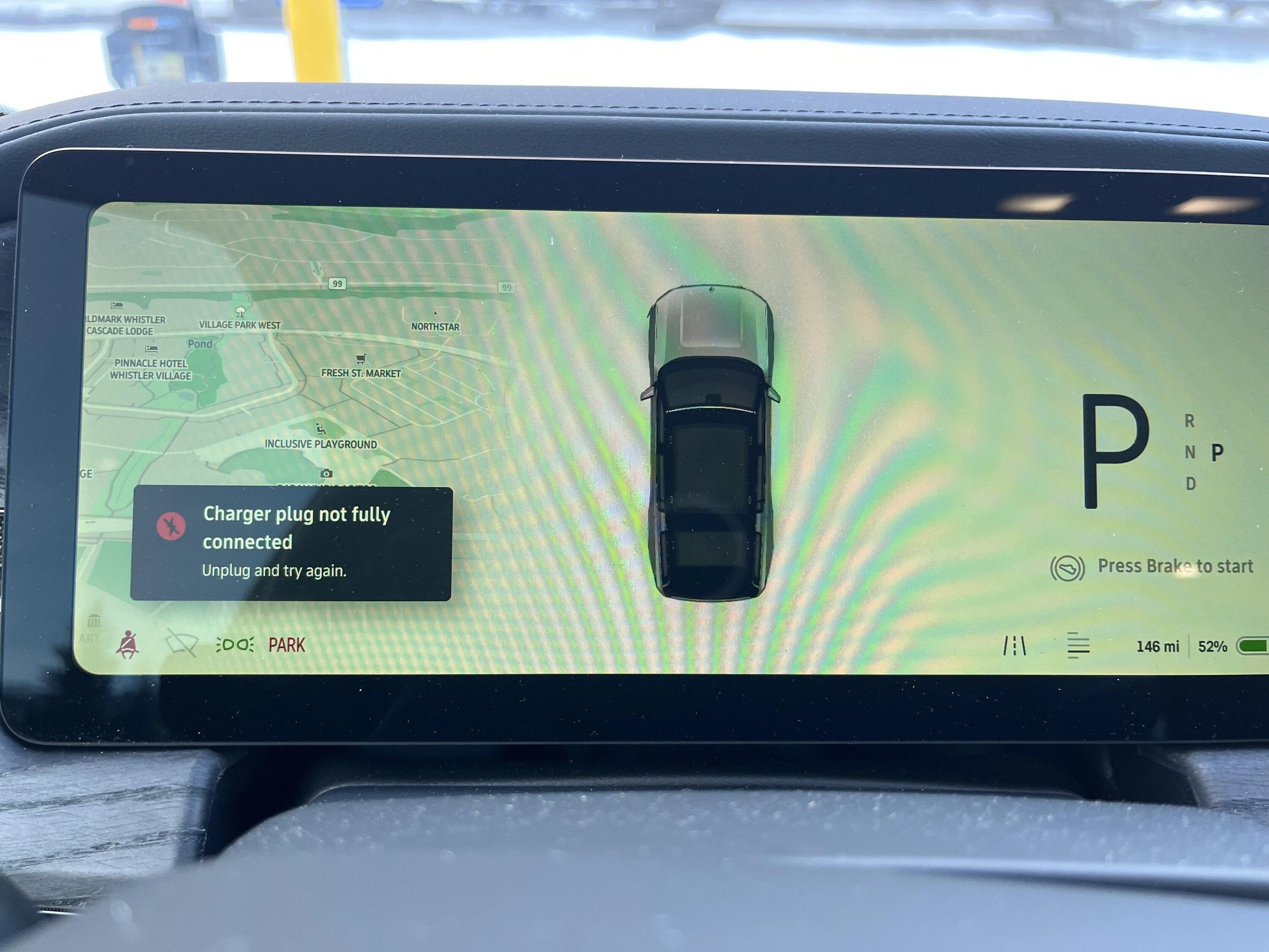

As a no-overnight lot I had to take the S back to the condo parking at 3am to avoid a possible ticket. After I stopped the charging the charge door would not close when activating outside. I got in the car and tried to close the door from the center screen. It did not close still and the icon greyed out. I then noticed that there were messages on the driver's screen:
- On getting in the car it said "Charging unavailable until serviced"
- It switched to "Charger plug not fully connected - Unplug and try again" after about 5 seconds
I did a software reset and a vehicle reset. Afterwards the same messages popped up.

Rivian R1T R1S Stranded After Charging - Towed and Repaired IMG_2804
Rivian R1T R1S Stranded After Charging - Towed and Repaired IMG_2805
