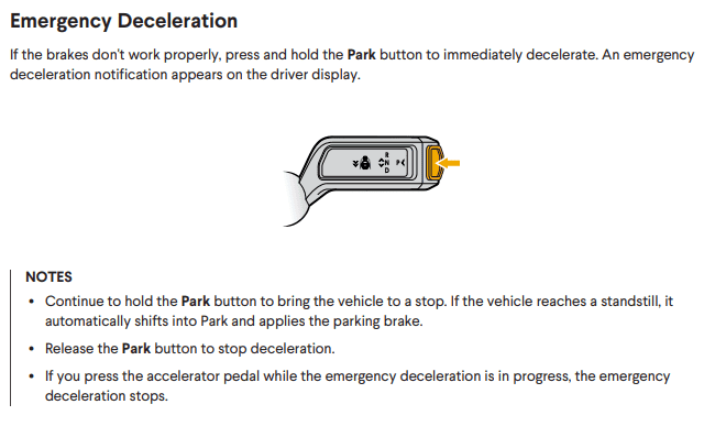

Don't forget that you also have the option of holding down the parking button for an emergency stop. I know it's hard to remember it when you've never had to use it before.
Will that even work if the brake fluid is drained?
It does say "if the brakes don't work properly". I think it will engage the parking brake on the rear axle but I have yet to do this at all. If I were asked to implement it, it would be an all-hands-on-deck situation where every system is activated at once.

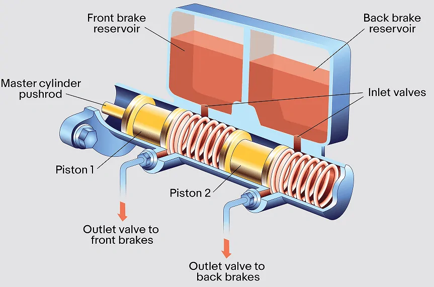

I haven't looked at the master cylinder of my R1T, but since the 1960's or earlier most automobile brake (not break) systems have employed dual reservoir master cylinders to prevent a rupture on any on brake line emptying the system of fluid thus still providing brakes to at least two wheels. In theory, if the left front brake hose ruptured, the right front and left rear brakes will still function in a "cross" style brake system.
Interesting. Guess I never paid that much attention when handling them. Rivian looks to be no different. An example can be looked at here https://www.ebay.com/itm/285773437334?chn=ps&mkevt=1&mkcid=28. I can only assume there is a separator in the middle. I am guessing that the rear brakes were functioning then. But with the smaller calipers and such a heavy vehicle they probably have pretty limited stopping potential. Thank you for the correction.
I used to build demolition derby cars and always removed the front calipers and cut the lines. The rear drums still worked fine. It was too easy to get the front wheels locked up by the calipers after all the side impacts.
Usually its one diagonal pair - aka one front and the diagnonal opposite rear. So if one line was leaking, you would still get one front and one rear brake functional, just on opposite sides to minimize pulling to one side.
