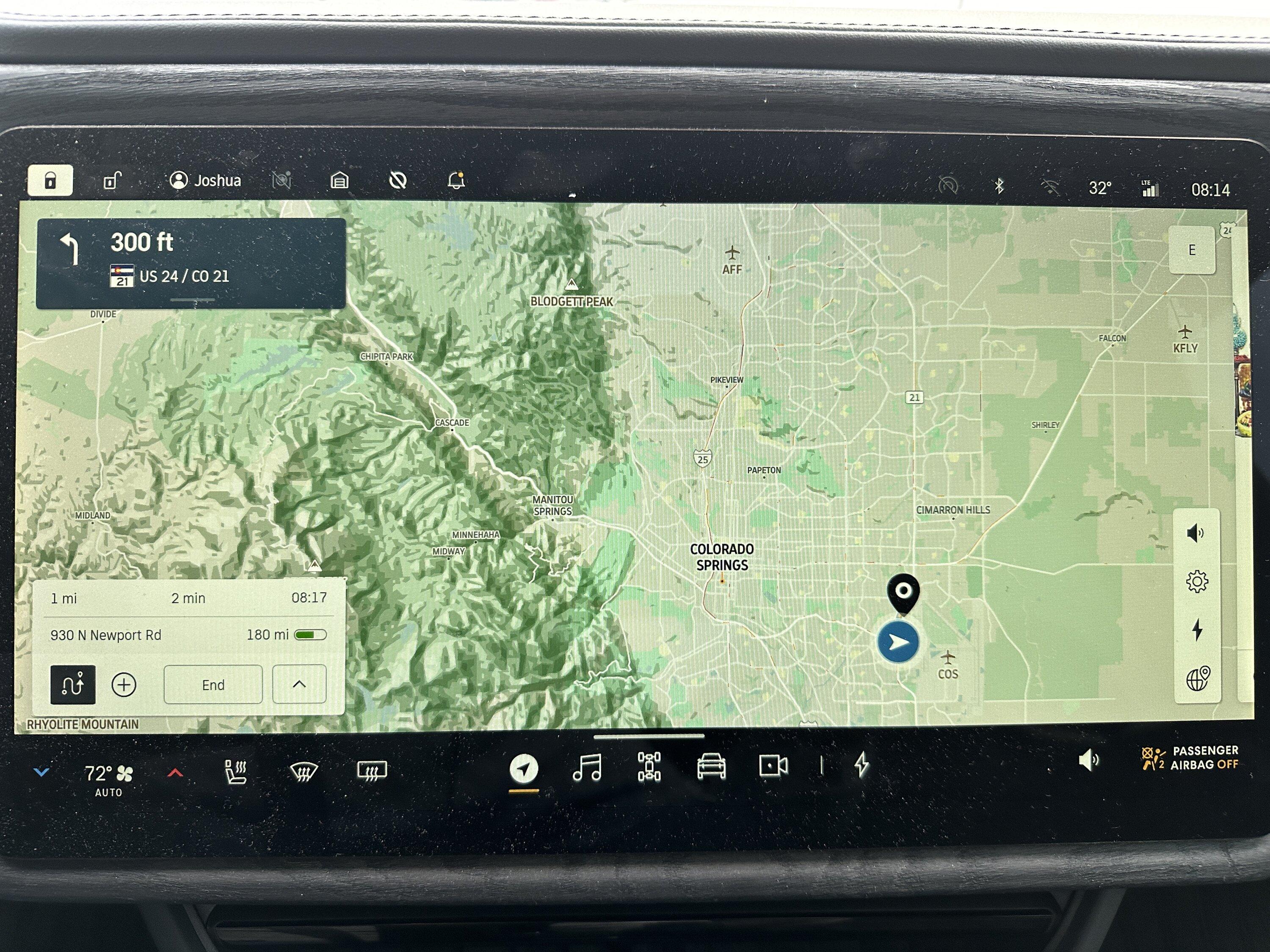

So got the update last night, today on route view (show current location and blue line to end location) it seems to be SUPER zoomed out right now.
Rivian R1T R1S Software Update 2023.46.0 is rolling out IMG_0784
This is just 1mile from end location.

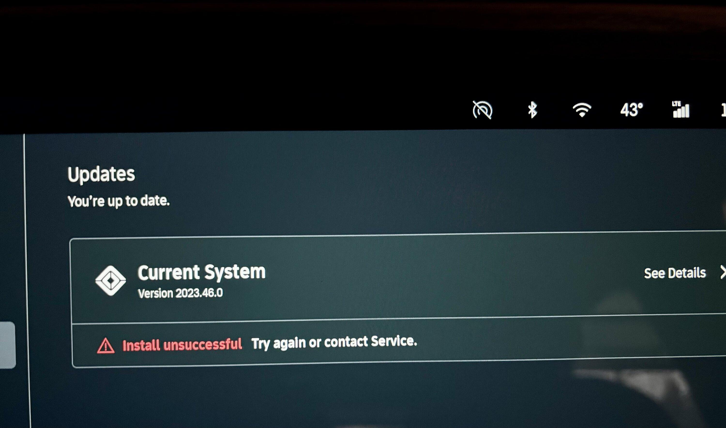

I started the update to 2023.46.0 last night and went to bed (plugged into Level 2 charger). I had a message this morning saying that the update failed and that I should try again or contact customer service. My R1s seems to still work and it appears it is on 2023.46.0. The warning disappeared from the app after I started the car this morning, but I still have the message on my screen.
I'm not sure how I would try again if I wanted to so I contacted Customer Service.
Do NOT have it plugged in (plenty of charge). Their notes say "do not be connected to a SC" ... but that appears to be incorrect. It simply will fail immediately if you are plugged in at all (L1/2/or 3).
I’ve wondered about that. I think they say no DC connection, but I thought I may have seen that warning somewhere else.
I got the update notice late and was already plugged in so I left it. I will unplug in the future. Thanks.

? we’ve done all our updates since purchase while plugged in… no problems so far. ~13 updates and counting.
I've done a grand total of 2, this one would not update (repeatedly), until I disconnected the charger. Then it worked immediately. This is Tesla wall charger with a Tesla -> J1772 adapter.
I feel like one previous time, I attempted the update while plugged in at home. The update stalled, I unplugged, and then it finished the install.
It may be this time that it errored, restarted, and then successfully completely the update. Because it looks like I’m on 2023.46.0 and maybe the error message on the screen just didn’t clear.
in any case, I will probably always unplug in the future.

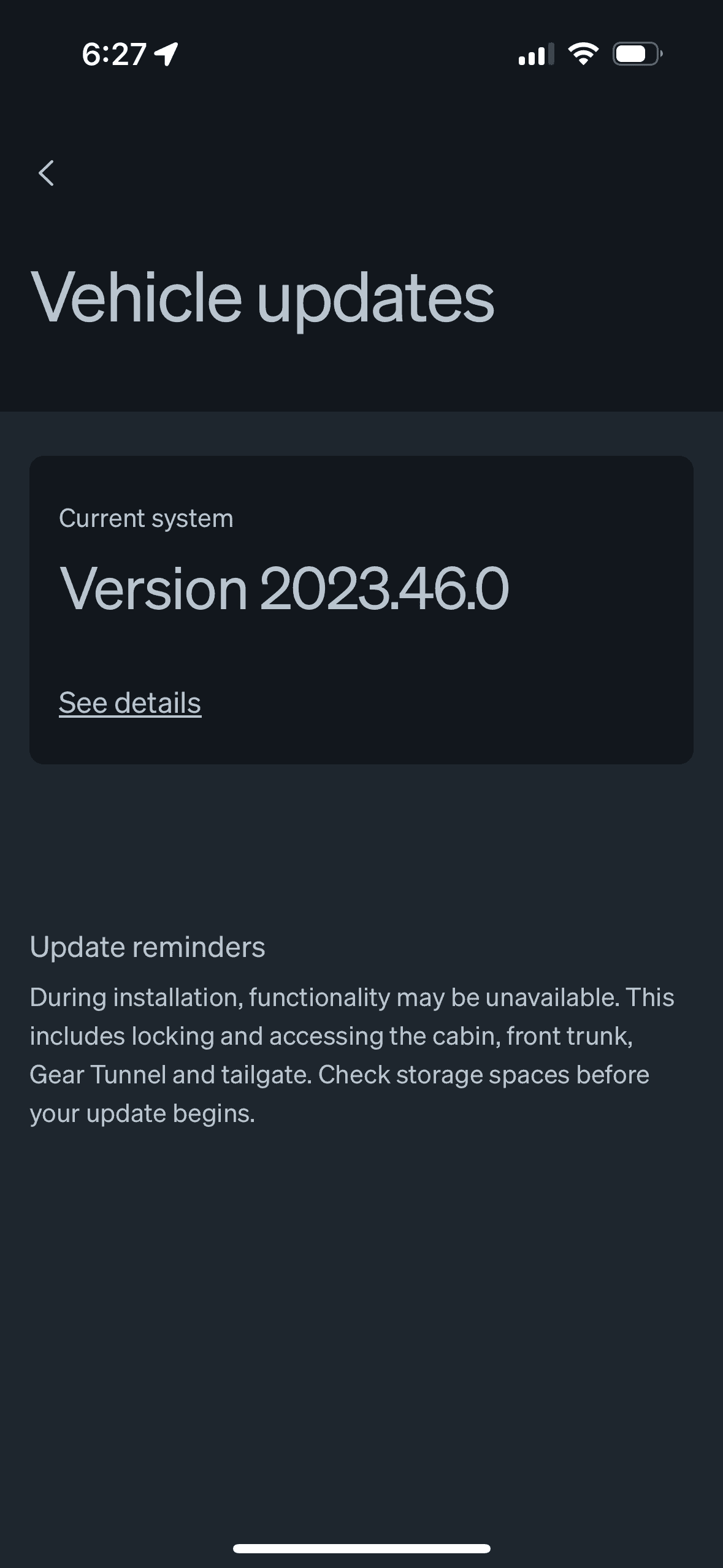

This what my phone shows. However, I quickly looked for the new Service Mode that was added with the update and couldn’t find it.
Waiting to hear from service…
