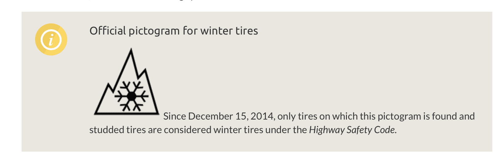

Or just buying the stock 20s... Does the 3PMS not make it qualify as a winter tire?
The 3PMS does not qualify it as a true winter tire. That’s not to say it isn’t good and it may work for many/most - I’m going to give them a go this winter on my R1T and see how they do. We get a ton of snow but not a lot of ice so I think they will be fine. I believe the 3PMS is rated for performance on medium packed snow but not ice or anything else. A true winter tire is made from a softer compound and will have better performance than the best 3PMS A/T tire.

the severe service rating absolutely does qualify a tire as a winter tire in every single winter tire regulation.
From Quebec, where winter tires are mandatory from December to March:
Sorry, poor choice of words on my part. I was just trying to make a point about the tire compound - a tire that is only meant to be used in winter vs. a tire that can be used all year including winter. They would both have the 3PMS but the winter-only tire might perform better.
