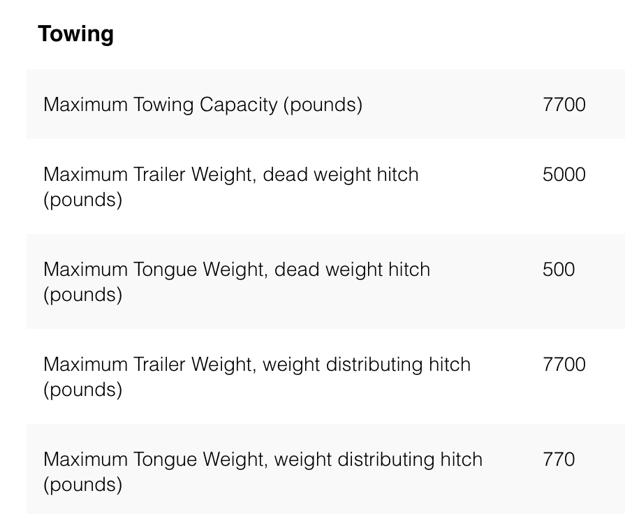

Never towed before. Trying to understand this. R1S has 1800 Ib payload. Assuming each axel can handle 900 Ib, does that mean with no weight distribution hitch, I can have 500 Ib tongue weight and 400Ib junk in the second half of the SUV?
