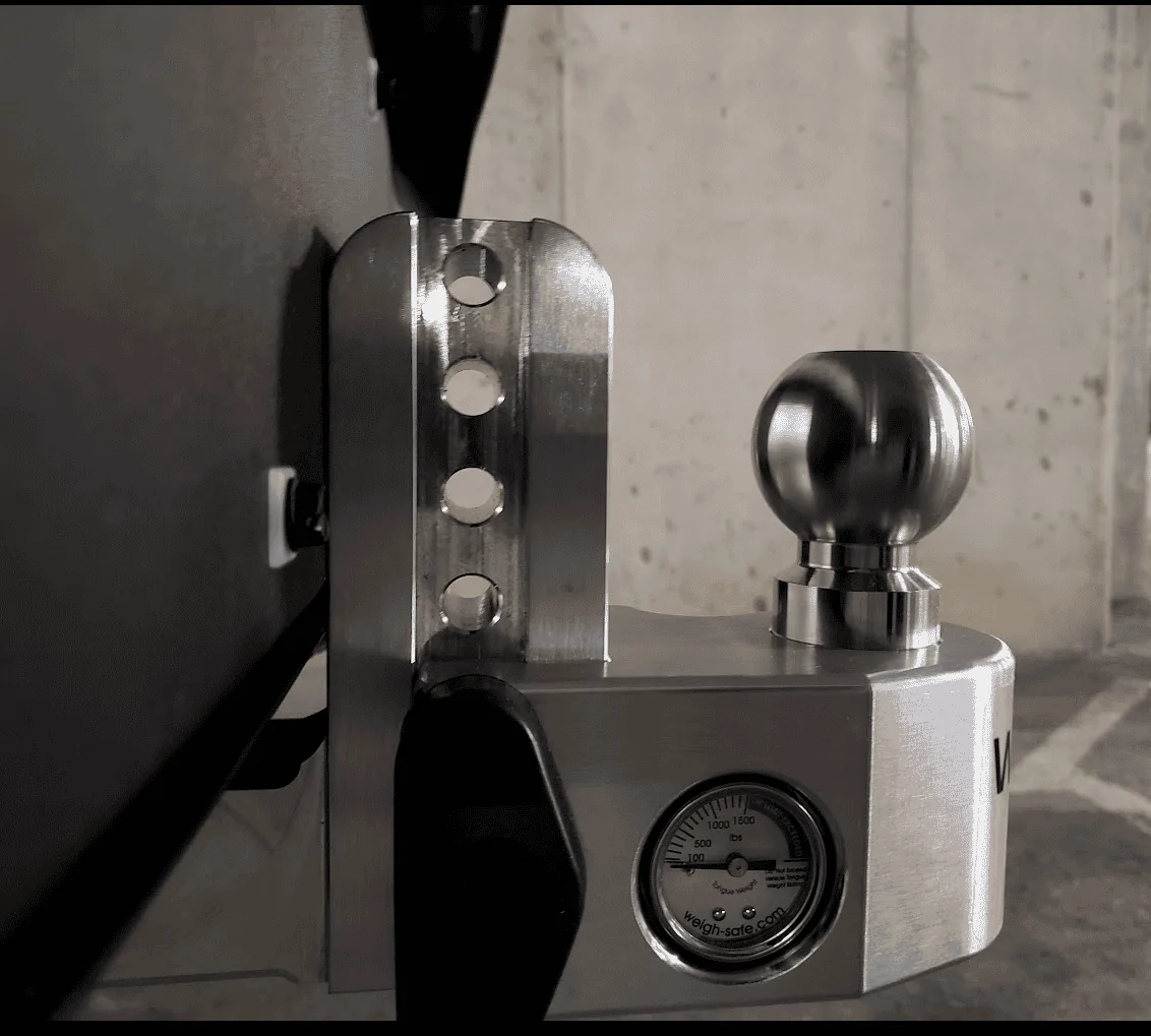

weigh-safe.com fits perfectly
I happened to have this for an F-150. It fits the R1T precisely. I chose a very short hitch to minimize leverage. I tow a variety of cars on trailers, so the hitch scale makes it easy to roll the vehicle to position optimal tongue weight. Expensive, but I admire well-made equipment. I have it as a "riser" hitch, not a drop hitch and leave it in as a bumper protector.

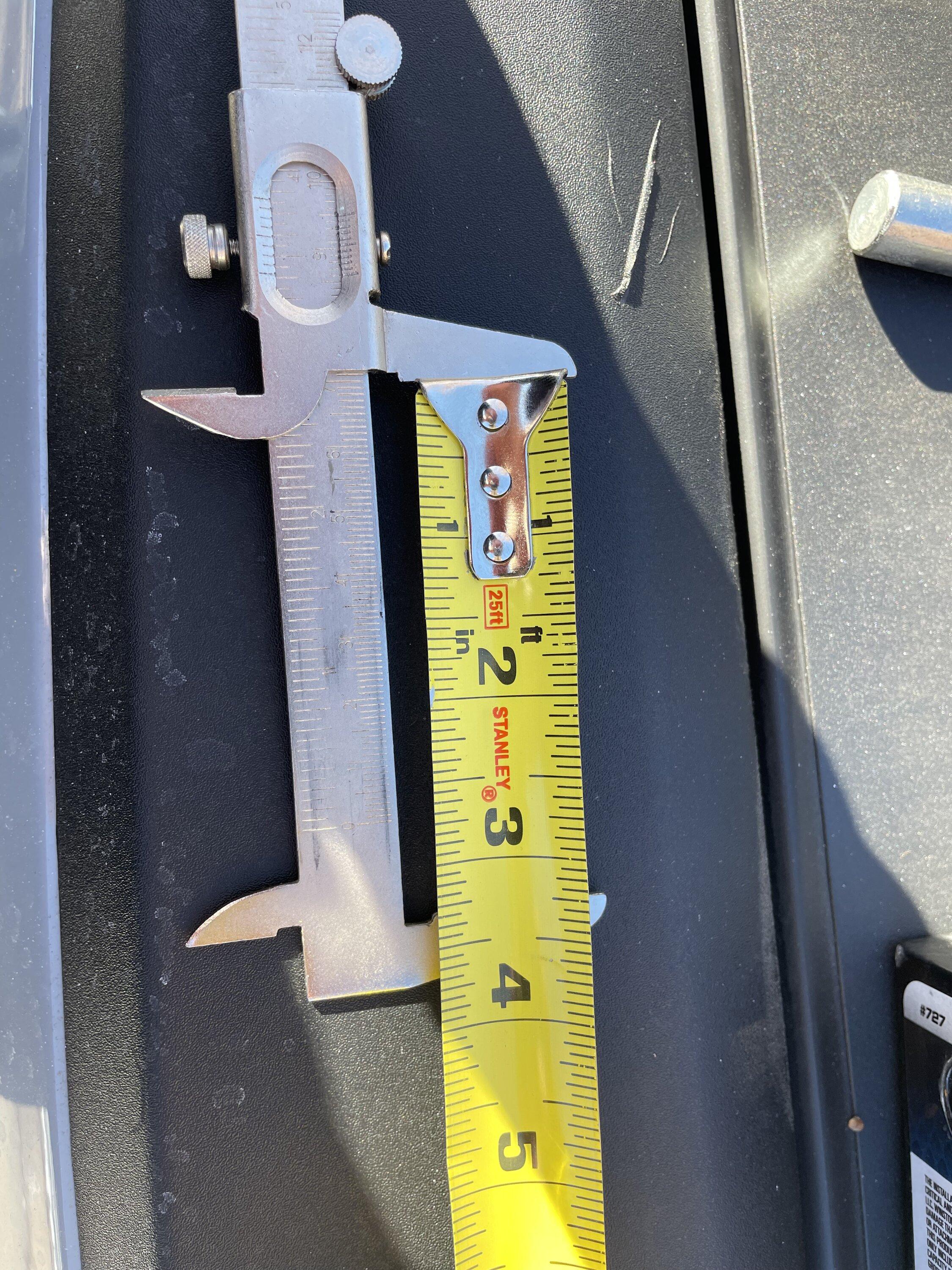

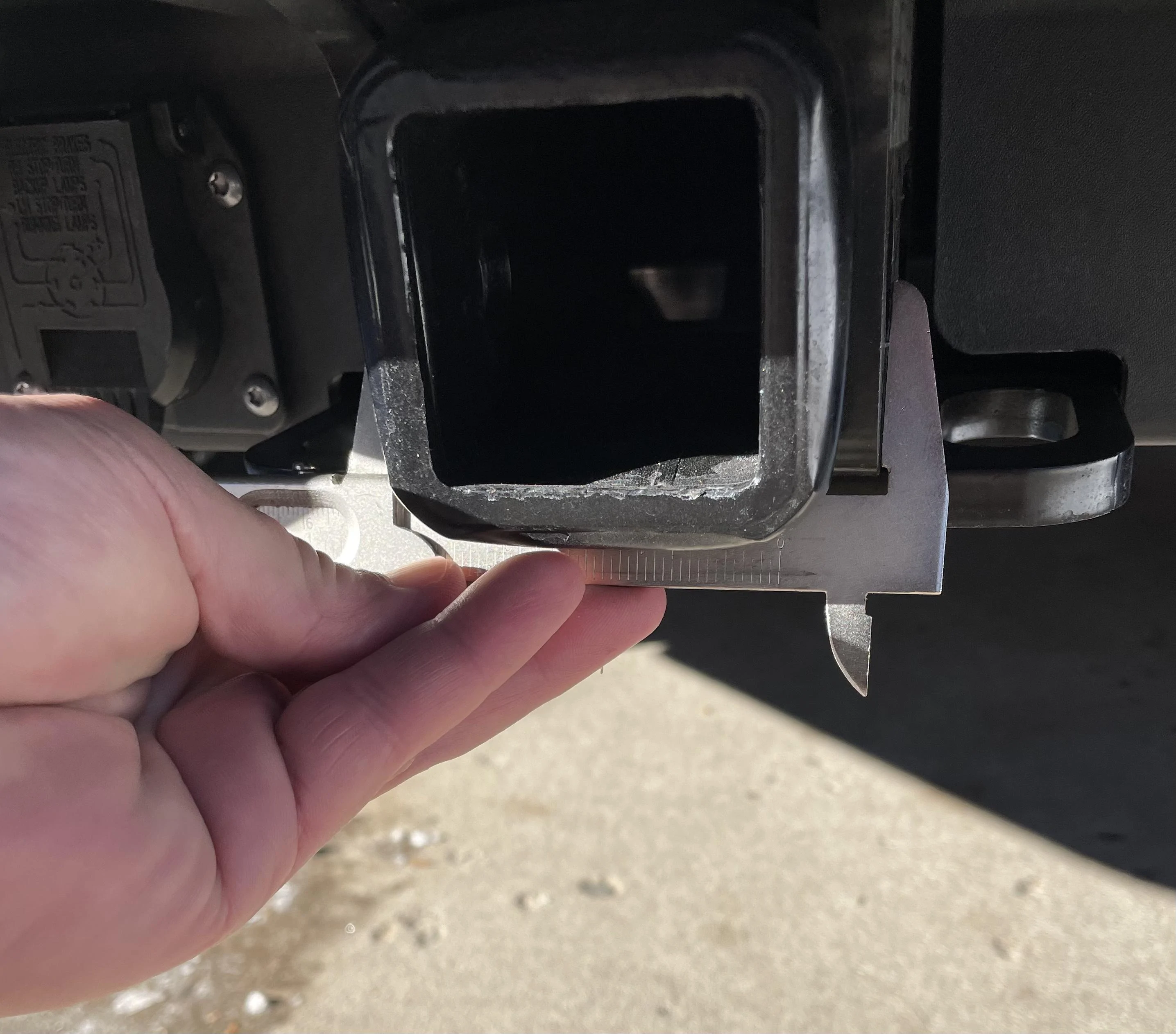

What is the minimum required length of the hitch pin?

3 3/16” outside hitch dimension. She’s beefy.

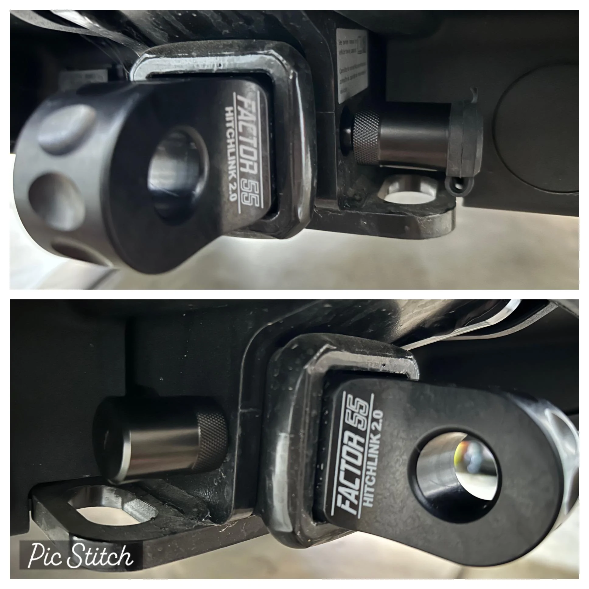

Just bought this one and it fits well with little gap, the TAL003. It has a span of 3.5" where someone measured around 3.4" on the receiver itself. The locking mechanism itself seems to just be a bit of plate metal that slides in around the pin, so I'm sure it could be pried off if someone really wanted to. But better than nothing.
https://smile.amazon.com/gp/product/B08P2CGBJV
It looks like you have the 4" version, how's that suiting you? Their page says to measure from the ground to the top of your receiver (which for me is almost 20" when the R1T is kneeling) and subtract 14" for the right drop size. That tells me I should probably look at the 6" version of this (especially since the suspension was at its lowest), but I'm curious what your experience has been.

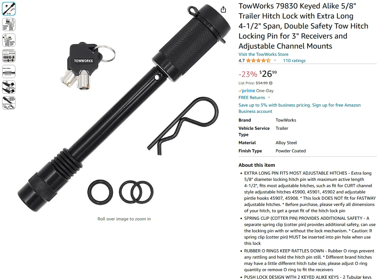

I bought the 4.5" version hitch pin that adds a locking spring clip in case the primary lock fails.
I originally tried their 3.25" span unit and it was too short to use the spring clip, so I went with the 4.5" version which allows the use of the spring clip. Yes, it sticks out on the right side of the receiver a bit.. but there's nothing on the right of the receiver to interfere with, so the extra length doesn't cause any problems and I like having the extra safety feature of the spring clip on the hitch pin.
https://www.amazon.com/dp/B09PN9WKLK
Does the cotter pin fit in the shaft? I don't see it in your pics.
Two different people posting about two different versions of it. The quoted post was the shorter one without the extra cotter pin.
There is no cotter pin here. The left side of the pin is larger than the hole and the right side is the locking portion that locks onto the pin.
