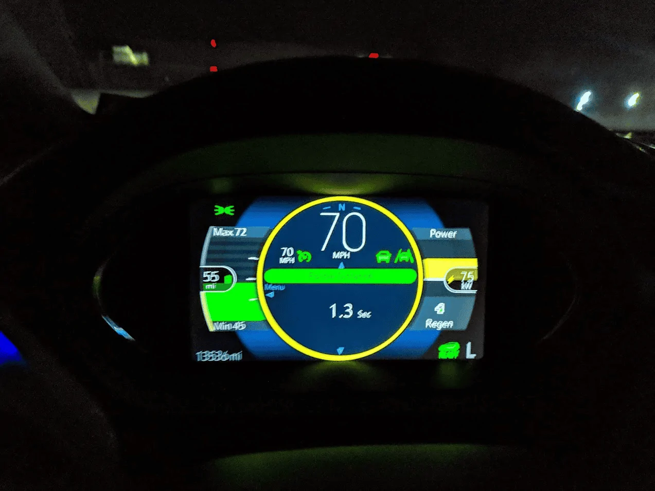

Forgive the shitty photo, but towing a 2000 lbs trailer in my Bolt is comparable in the amount of energy expended per mile at highway speeds.
Rivian R1T R1S R1T Towing Range Sneak Peek — 44 Miles of Predicted Range with 37% Battery Remaining 1638290652238
Keeping it 55 or under halves the power consumed.
