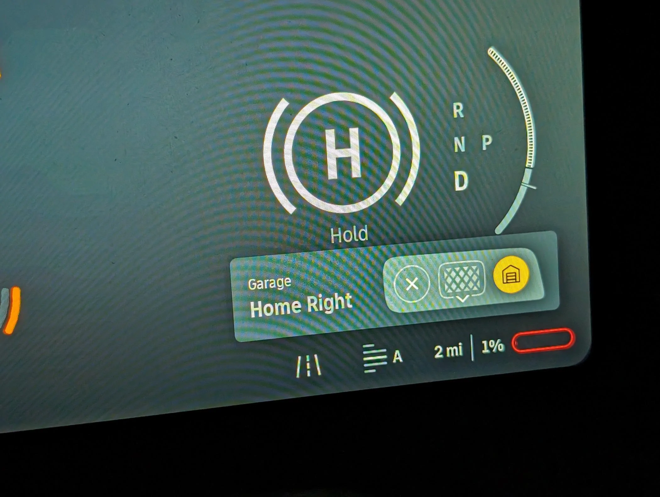

Rivian R1T R1S How low can you go (remaining range)? 1000001424
My record. In the picture you can see the severe power limitation at this range, I saw the power meter start to have a limitation at about 5%, limitation wasn't severe, you would barely hit it under most circumstances. At 2 or 3% it started to get impactful and then was getting noticeably more draconian. I live up a steep hill and the last mile (2% to 1%) was at max available power going up the hill, truck was barely holding 25 mph on the steep grade.
I had left a hockey game 40 miles from home (almost all highway) with 50 miles of range, but nav estimated 3 miles when I got home. I decided to push it, just to see... Lots of exits along the way with chargers if I needed to bail. As others have stated, it's pretty easy to adjust speed to get more efficient, I was watching the 'range at destination' calculation the whole drive and when it dropped to 0 mi estimated I went to conserve mode and slowed down. Pro-tip: don't try and come out of conserve at 2% battery. Clearly caused an undervoltage and threw all the errors (but somehow didn't actually impact drivability and it did go back to all purpose). In the morning all the errors were gone like nothing happened.

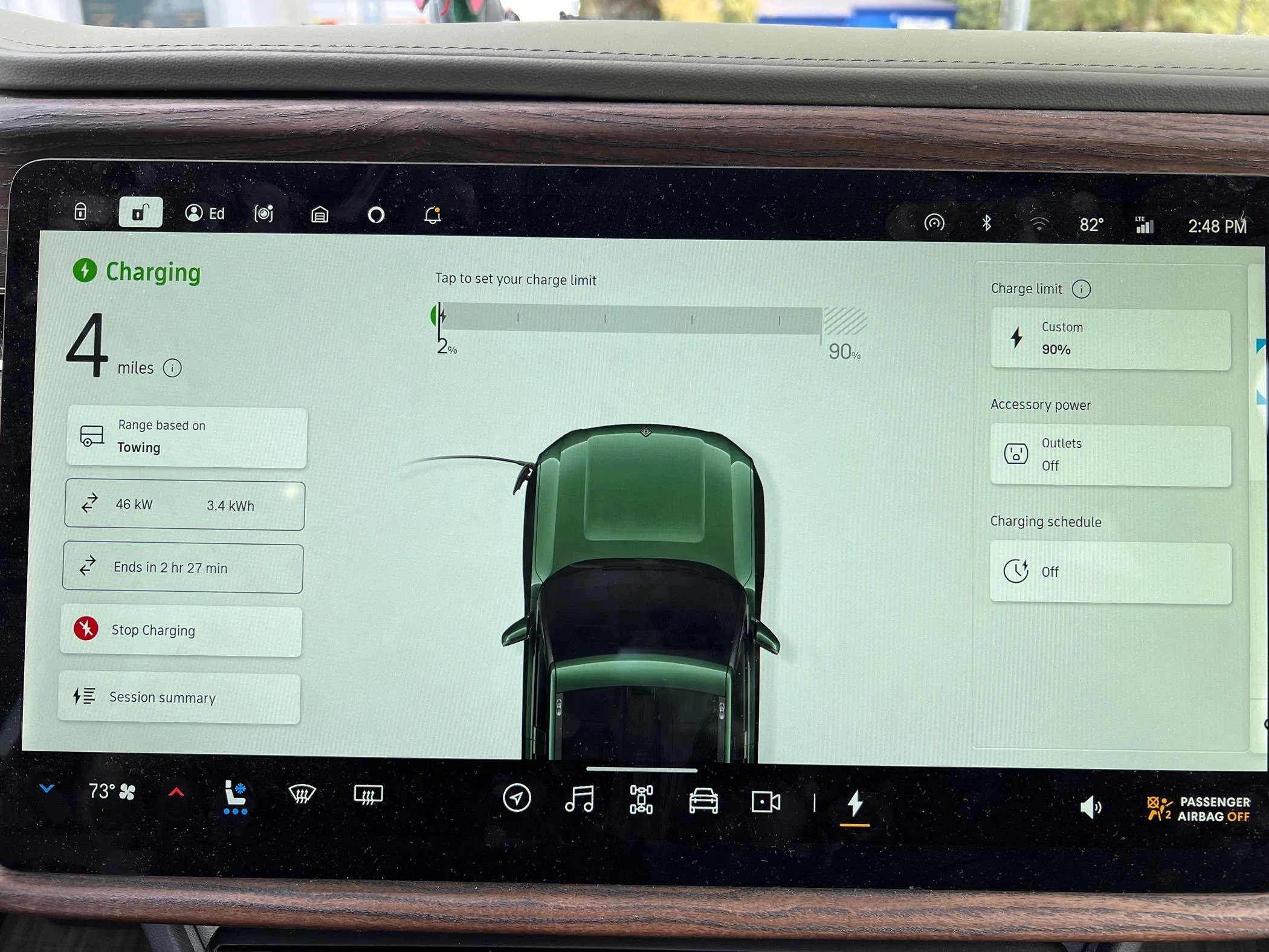

While it's still drivable under 5%, as others have said, it will have problems maintaining high freeway speeds.
Note that when towing, it's way way worse. When towing a moderate trailer (3500lb teardrop) power starts to disappear at ~10%, and at 5%, maintaining even 45 MPH becomes impossible. And the BMS seems to be far less accurate at the bottom of the pack.
After multiple "nearly stranding" incidents while towing, I won't plan a charge stop to arrive at less than 10% any more. It hasn't stranded me yet, but I've now had three times that I was at 15% with less than 15 miles to go - and pulled in to a charger turtle moded to less than 20 MPH.
Rivian R1T R1S How low can you go (remaining range)? IMG_8473
My wife screenshot this while I was existing the freeway.
Rivian R1T R1S How low can you go (remaining range)? IMG_4798
After plugging in and calming down from the near-disaster (In the parking lot, I floored it, and only got up to 4 MPH,) I took this. It says I'm at 2%. Yet have added 3.4kWh - which should be 3% *ADDED*.
So… Don't expect to be able to use the last 10 miles of range.
