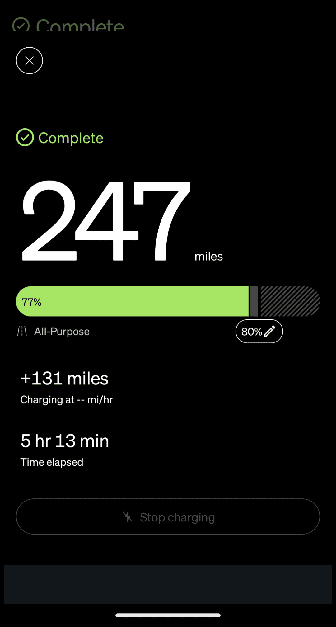

Any updates on this? Mine still stops 1% short of the target. No big deal, I just set the target 1% higher than I want it. On a couple of recent trips using DCFC, it went to the full target, so looks like it only has this behavior when using lvl 2 charging.
On the plus side, while keeping it plugged in vampire drain is so minimal now it can go 2 to 3 days without losing enough to initiate a (near) top off charge.

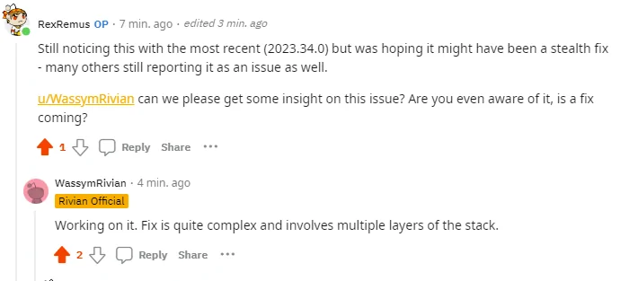

Finally got WassymRivian to reply to my Reddit thread - at least they are aware of it and a fix is coming. But sounds like it might take a little bit.

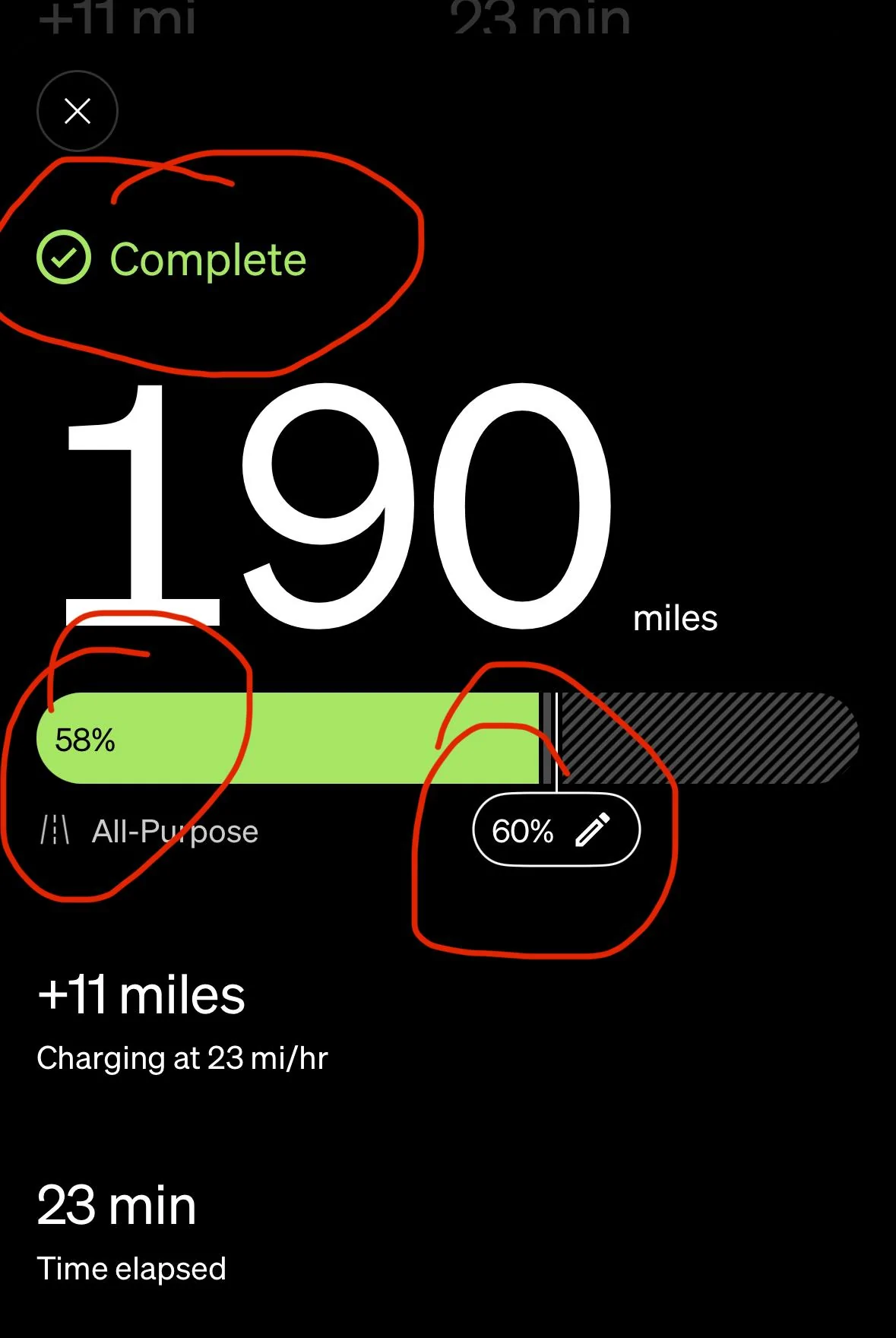

I posted separately and was sent to this thread. I am experiencing the same thing on my R1S. My R1T is fine on the same chargers and the same exact setup. No schedules and no charging limit. I have a case with Rivian and crickets at this point.

They're aware of it and working on it but probably have nothing to report just yet. I am hoping for it to be addressed by the next release (not the one coming this week, but the next)

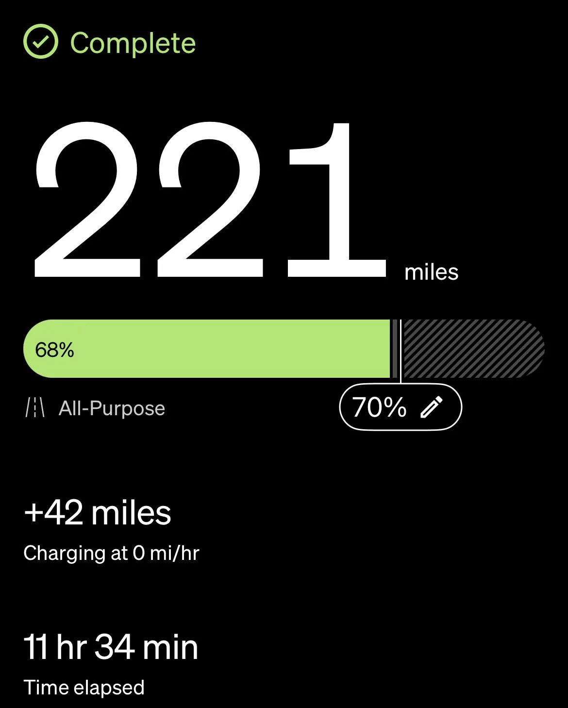

R1S still has issues. R1T still fine.
