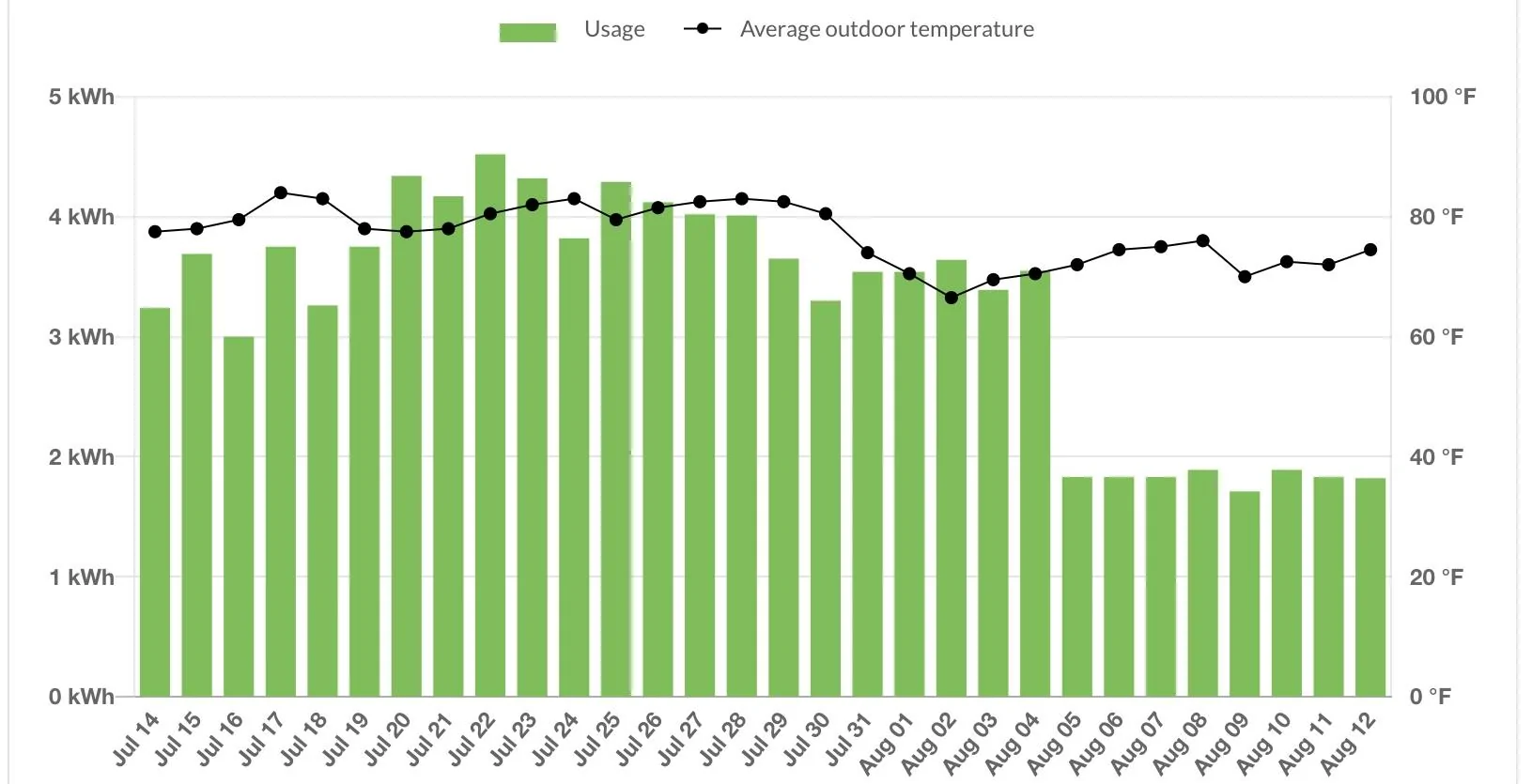

Thank you Rivian engineering for working on the phantom drain. We have been away from our plugged in truck since the beginning of June and nice to see the latest update has resulted in a significant decrease in home electrical usage.
Rivian R1T R1S Positive Phantom Drain update : 0% range lost after 5 days unplugged IMG_0536
Interesting...I'm back to 2-3% drain overnight after the last update. I was at 1%.
