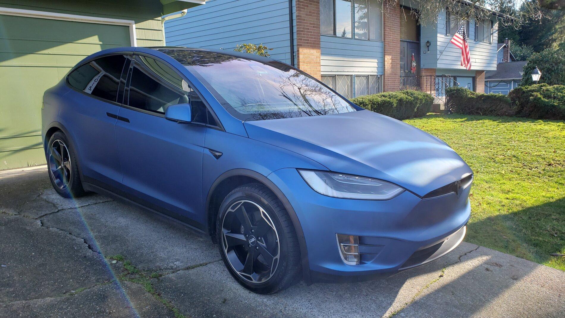

Wraps, I think are a little higher on the maintenance scale, depending on the finish, there are specific things you need to watch out for/not do. For example, my Tesla X has a matte blue metallic finish, the worst thing I could ever do is buff it (would make it shiny). In general, you should keep it garaged if you can and out of long exposures of direct sunlight and extreme temps. I would strongly advise having a coating done on it as well (helps reduce the amount of UV hitting the wrap and helps keep it cleaner easier. Depending on where you live, a wrap can last a couple years, or several years with proper care and maintenance.
For those curious... this is a white car... (and makes for lots of fun going into the Service Center... when the tech spends 15 minutes roaming the parking lot looking for my White Tesla X...)
