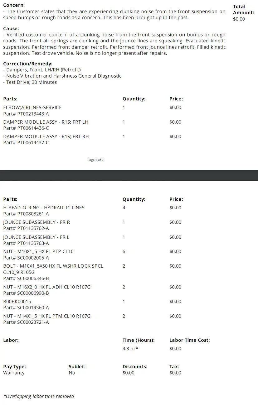

I would do what I did which is work politely with Rivian and my local service center to address my suspension N/V/H concerns. I got a lot of parts replaced / retrofitted to resolve my concerns under warranty plus a Jeep Wagoneer loaner with 1 tank of gas on Rivian.
I had all sorts of N/V/H that were normal / not normal from the suspension. Rivian took care of everything for me and explained to me what was normal and what needed to be addressed under warranty.
I am pretty sure I got a faster resolution working with Rivian directly versus going with NHTSA for noise / vibration / harshness issues that I had.
The only safety concern I had and was glad Rivian fixed ASAP on their own was the knuckle fastener / clunk from it not being torqued correctly.
I am super happy Rivian fixed the AC noise at no cost to me even after they had already moved on to heat pump designs. That was one of the first N/V/H items I noticed / noted / documented back in June 2023. Rivian came out with a resolution for N/V/H without me having to make any NHTSA complaints.

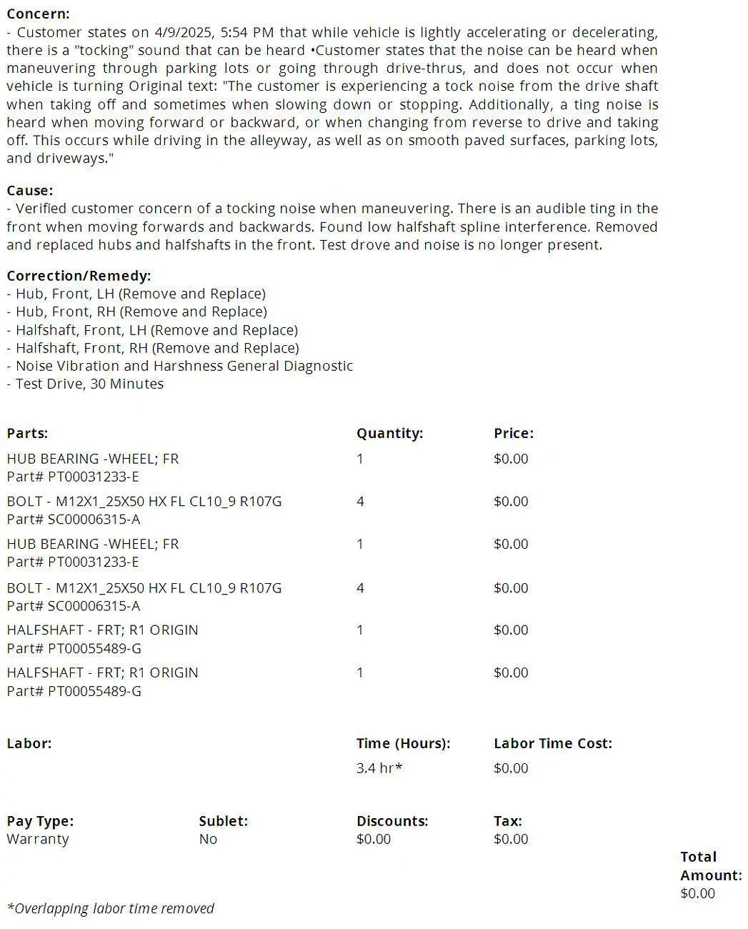

I just took mine in for the second time. I feel like when I bought it was quiet (other than the sounds of the compressor kicking on and the sound of lowering and raising on occasion). then it got noisy, they replaced the jounce lines and tightened something and it was good, and now its noisy again. The tech said he heard it but I also felt like moving from drive to regen and vice versa had a bit of a clunk too but he couldn't detect anything there so who knows.
Half-shafts and hubs might be the fix for tick / tock / ting from regen or moving from drive to reverse.
You can see my service ticket here and this resolved my issue with the tick / tock / ting at low speeds when driving or stopping / regen / change from Reverse to Drive to Reverse to Drive. Very easy to replicate. Think of doing a three point turn in a tight alleyway from your garage.
