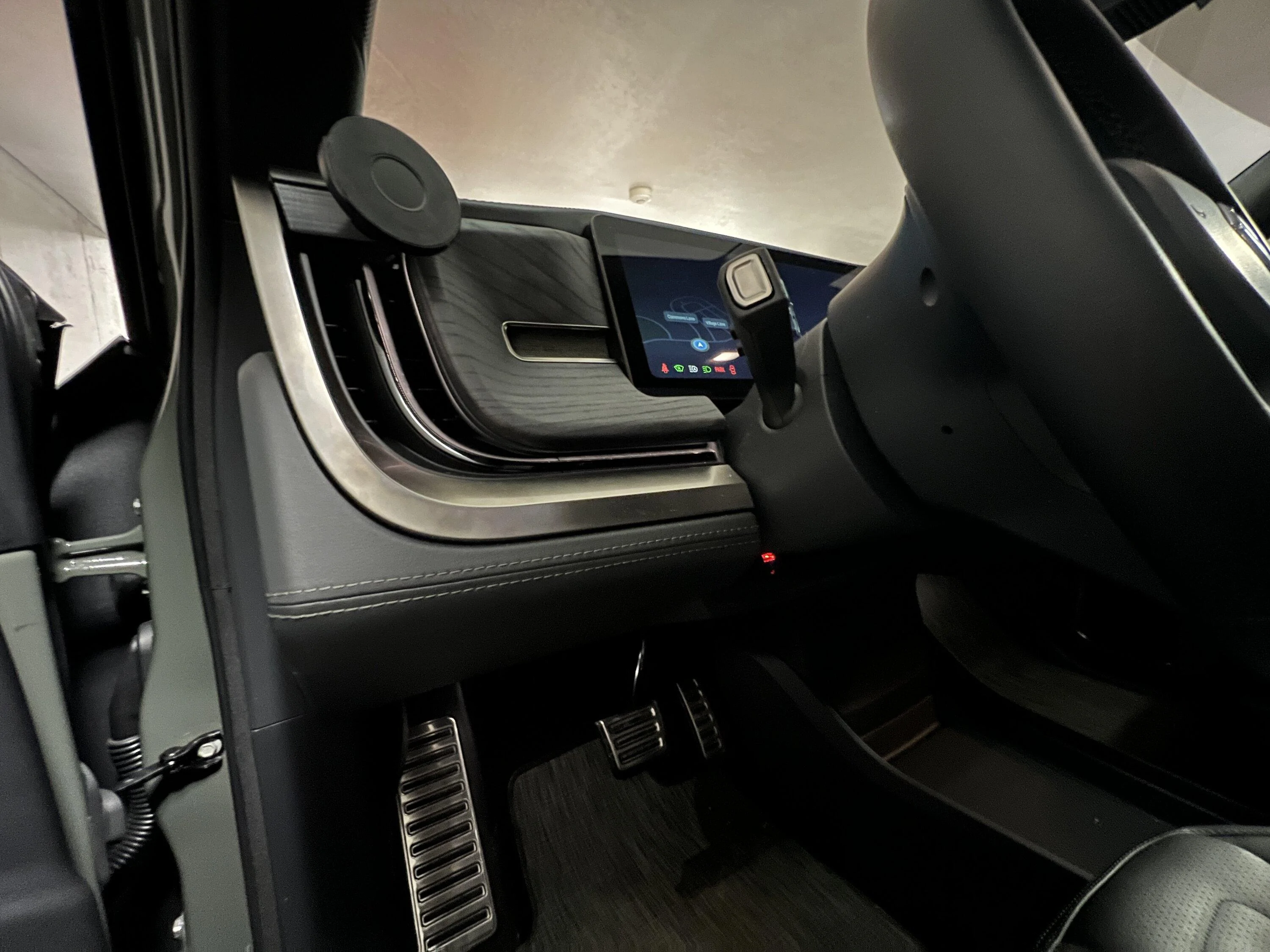

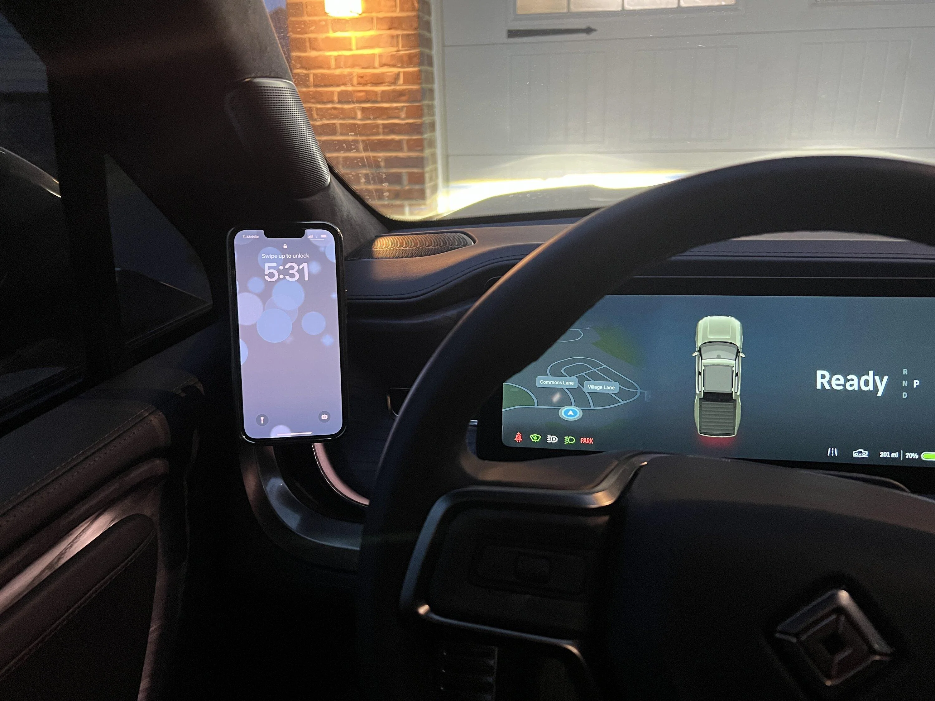

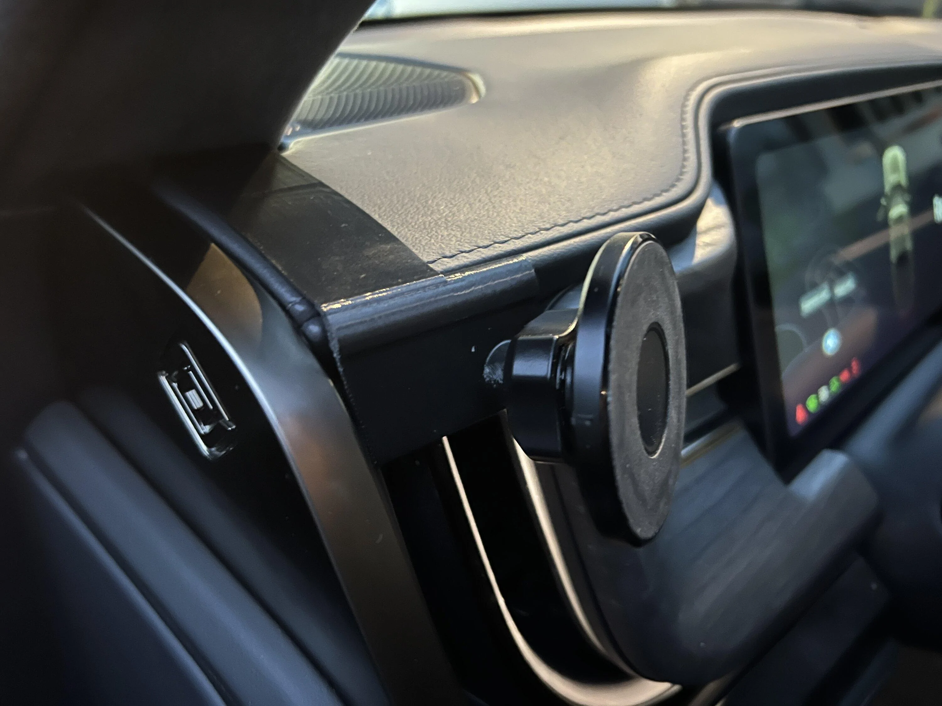

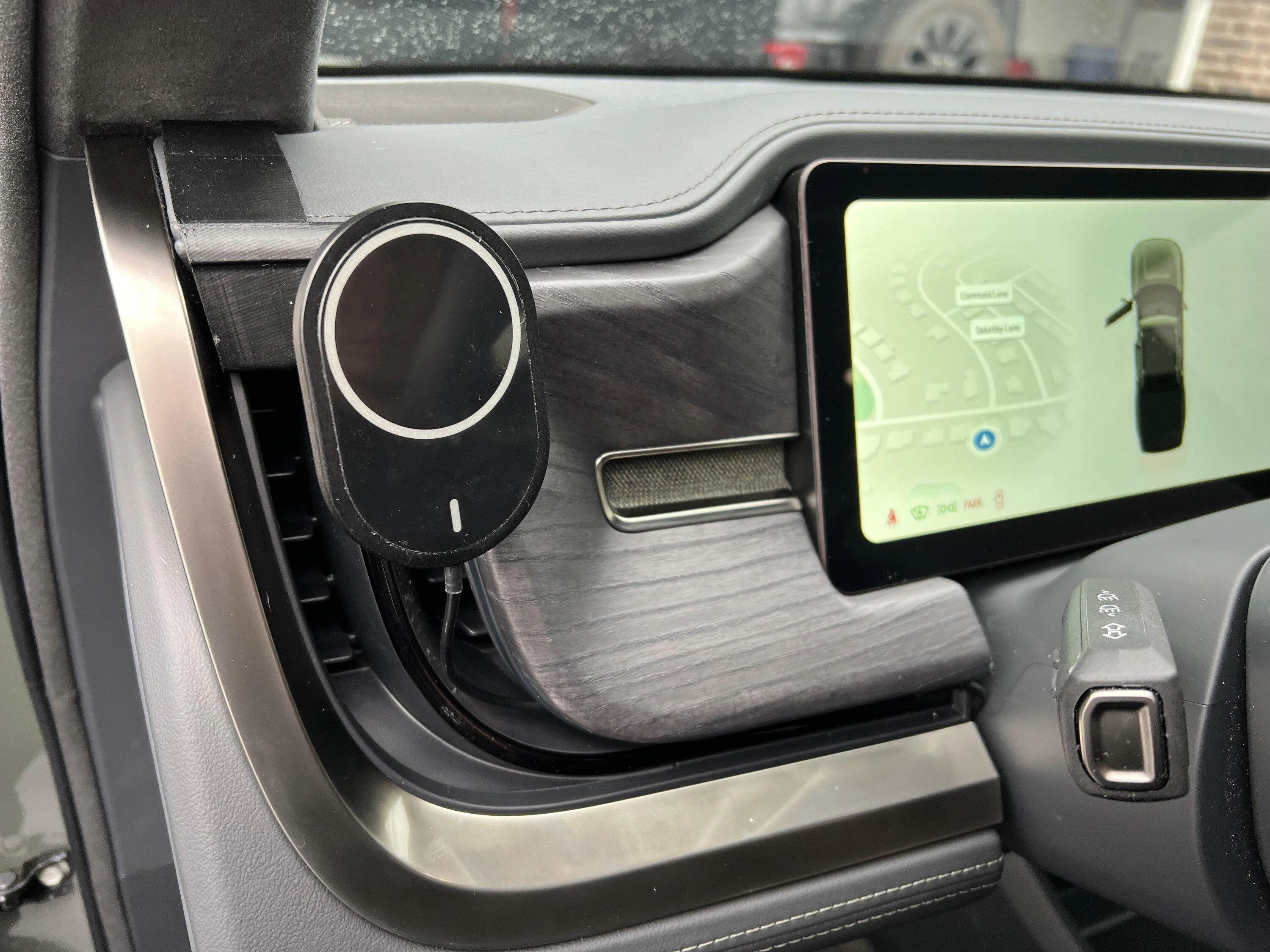

Today I'd like to officially announce the RIVIPARTS Left Side Phone Ball Mount. This is a new version of, "The Best Rivian Phone Mount Available Today" that attempts to solve the steering wheel obscuration problem by mounting on the left side of the wheel. Initially, this will only be available in 17MM size.
This new mount installs at the very top of the driver side air vent, just outside of where the steering wheel blocks the view, but still within reach when you need it. It's made of two parts - a mounting plate that is wiggled just in front of the motorized fins (never touching them) and ball mount portion that has a flexible, unobtrusive L which rides on surface of the dash pad and is inserted between the pad and the A pillar trim. These two bits are then bolted together via an M5 bolt and nut and are remarkably stable with fewer vibrations than even my PRO mount.
Photos of the prototype installed along with an inexpensive LISEN MagSafe phone holder + an iPhone 13 Pro with an Otterbox Lumen case:
Additionally, when this is pared with the Scoche OBD II to Quickcharge 3.0 USB plug, you are able to install charging mounts in a completely inconspicuous way:
(Scoshe mount is the glowing red bit under the steering wheel)

Very cool concept, but since you asked for feedback... is there any way to tweak this design to move the phone up a tad higher and to the right to not block the air vent?
For a while I was using the Peak Design magnetic charger attached via VHB on the dash in this area: https://www.rivianforums.com/forum/threads/mounting-a-cell-phone-has-anyone-done-it.4636/post-206520.
Unfortunately it fell off in the cold weather. I think a solution like yours which clips into the dash but places the phone in this same location would be excellent.

When I was initially looking at this, I wanted to move it higher as well. A combination of factures such as the angle of the A pillar, and the top of the 'vent' being a solid piece (not an opening) influenced me to place it where it is. I think that you'll see is that I did pull the ball mount away from the dash however. Doing so ensured that it didn't impact airflow as much as being closer in, and it provided more flexibility as to the mount one could use.
Because this is a standard 17MM mount, you have loads of options as to the phone holder you can attach to it. There are three specifically that I recommend if you are concerned about airflow. Each allows for additional offset in mounting location. (and they work with the 17MM Pro mount as well!)
https://www.amazon.com/gp/product/B09R1G19K5?th=1
https://www.amazon.com/dp/B08Y2CXKG5?th=1
https://www.amazon.com/dp/B08Y2N3P55

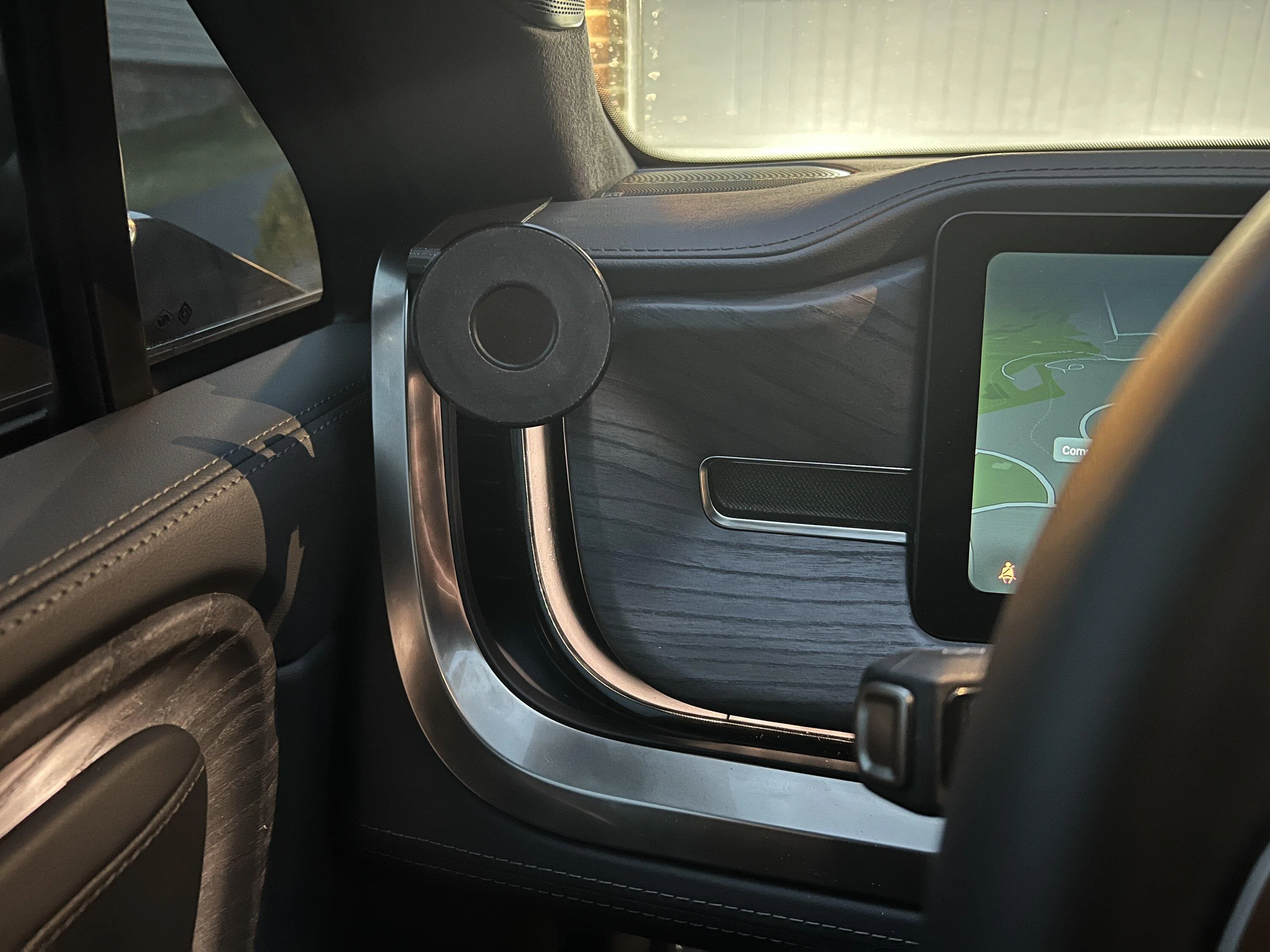

Looks like a nice alternative to my left side window suction mount I currently use in my company provided '21 Hybrid minivan.

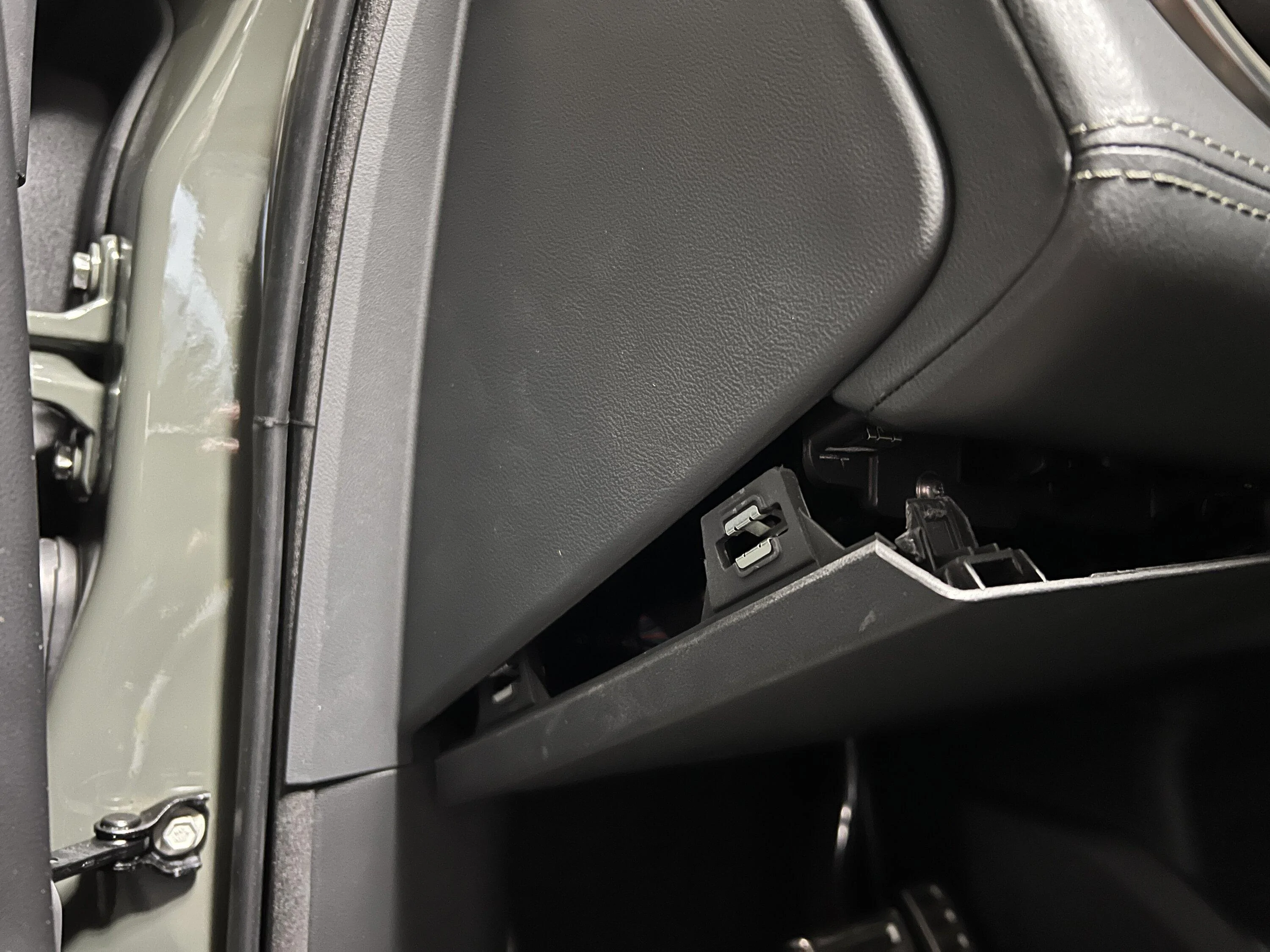

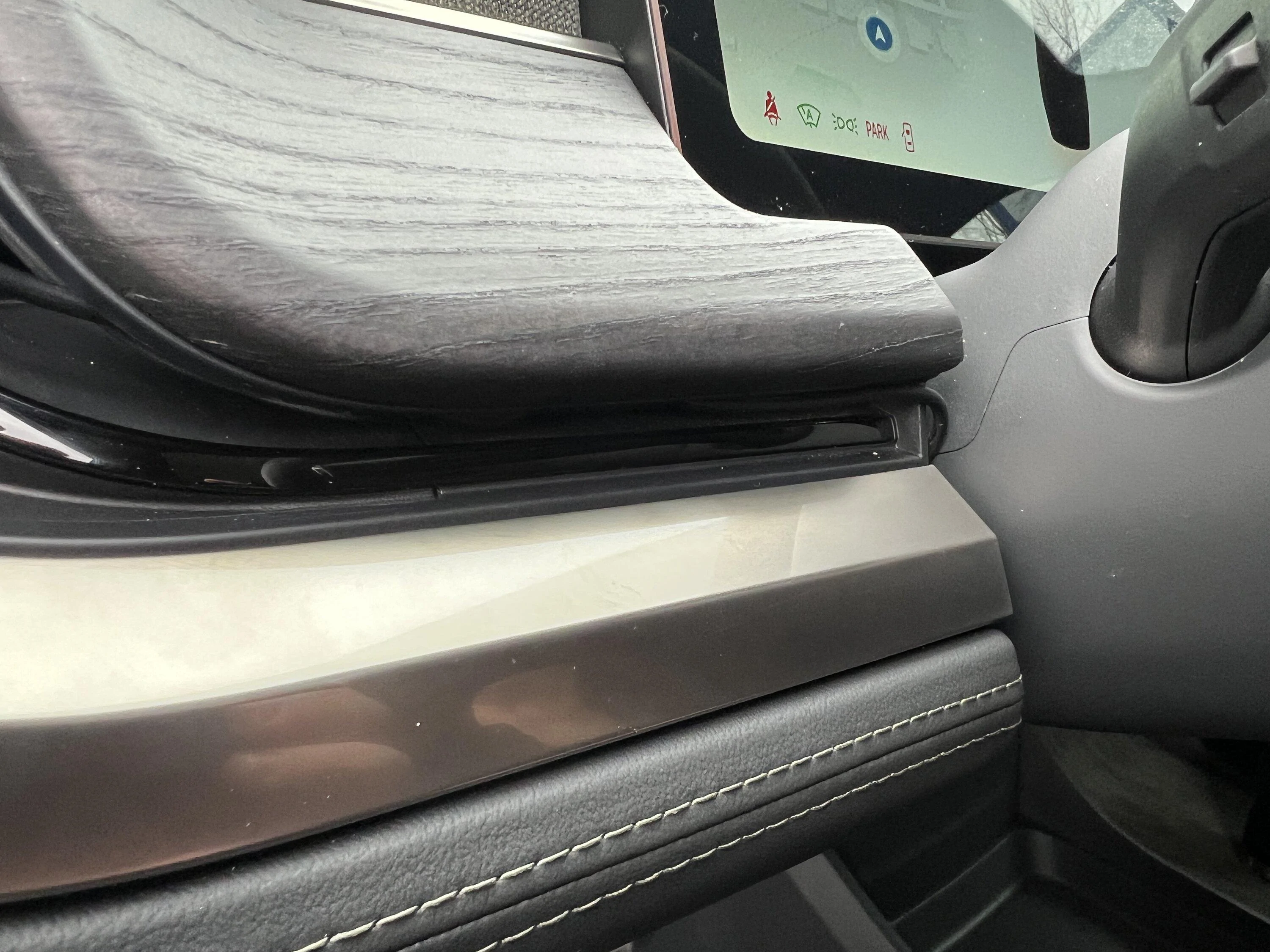

Install is super easy and it has a pass-though so it can remain installed. The OBD port is pretty high up in the drivers footwell, so unless you're rocking Ronald McDonald shoes you won't even be close to bumping into it.
I popped off the side panel and the left bit of the lower dash panel. From there, it's easy to feed the cable and wedge it under the steering wheel. There is foam there which holds it in place.
You can see the panel clips to the left and up from the bottom in this photo. The Scosche cable is in red:

Any tips on how to pop open the bottom panel?
RWerksman
RWerksman
Nov 13, 2020
58
1,415
3,168
Pittsburgh
Jeep & R1T
I guess the power to the OBDII port shuts off eventually once the truck goes to sleep?
I believe it's governed under the same power down setup as everything else inside. Even if it isn't, as long as you're not actively charging anything from it, you'll be A-OK.
Yep - you need to pop off the side panel and pop-off the bottom two clips connecting it to the bottom panel first then you can tug the bottom panel downward. You don't need to remove all of the bottom panel, just the few that clips to the left of the steering wheel as shown in the picture above. I also removed the side panel from behind the weatherstripping to make it a bit easier.
Here is another photo showing the two clips that connect the side panel to the bottom one:
