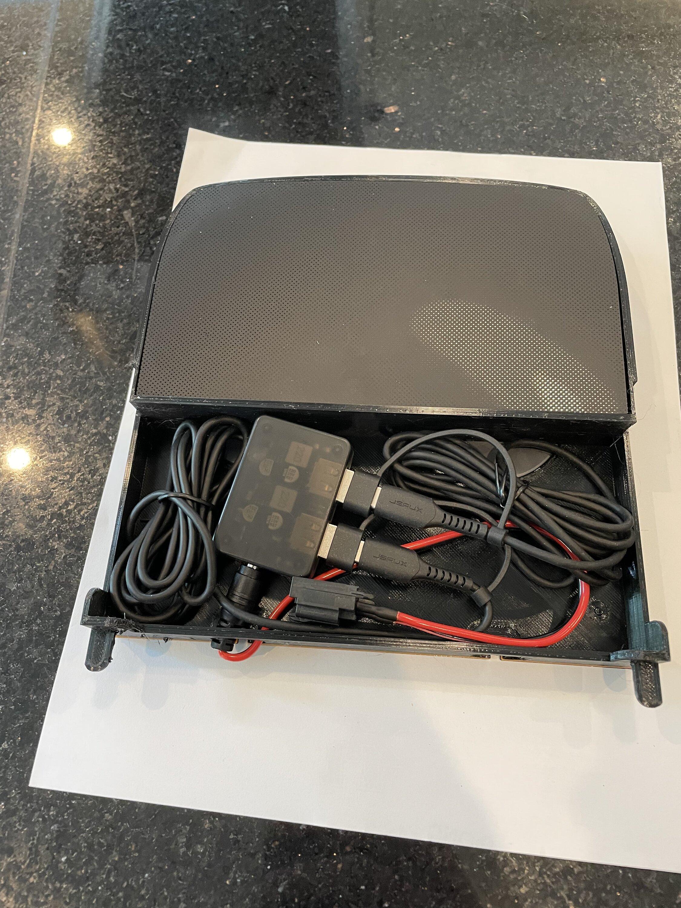

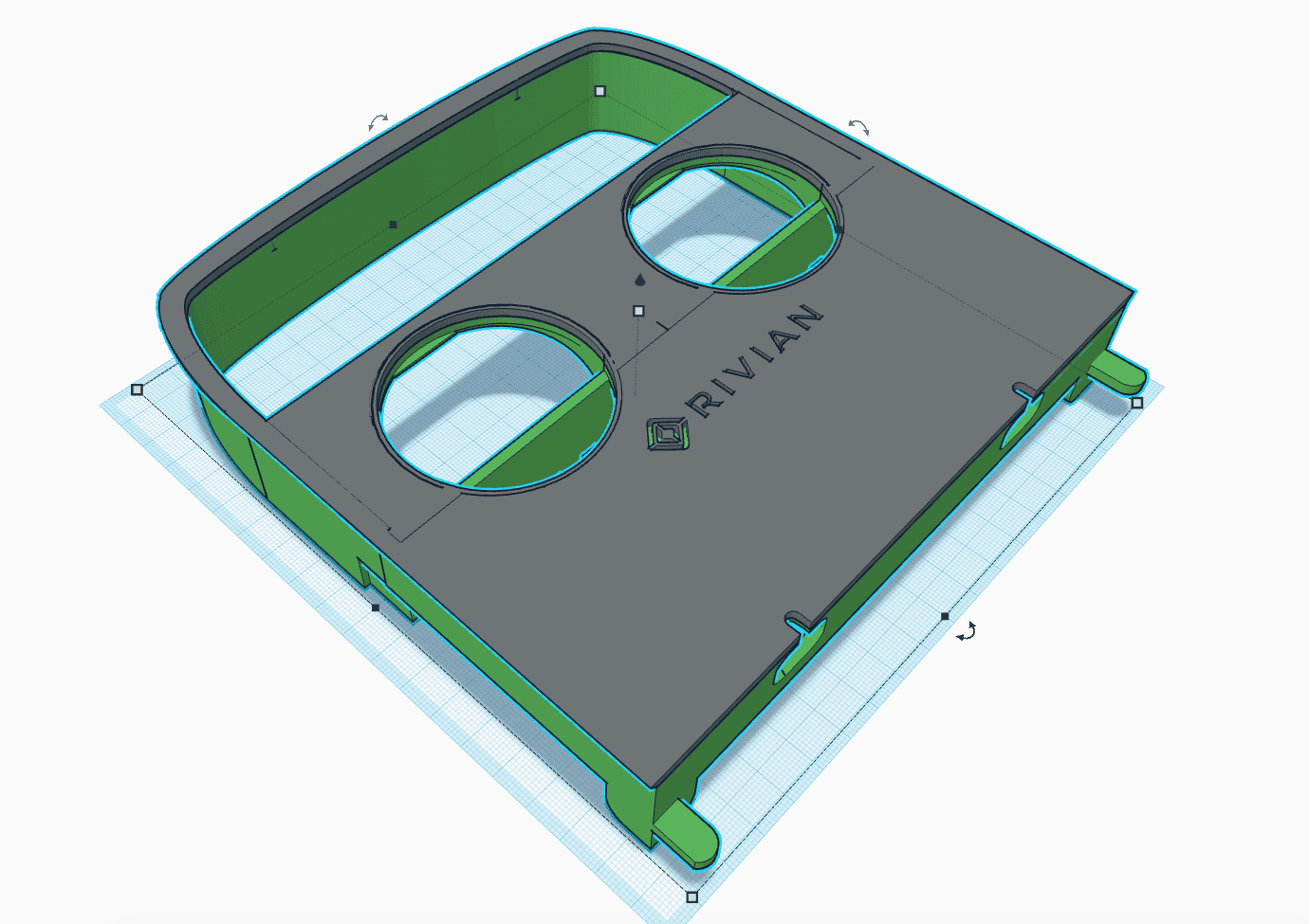

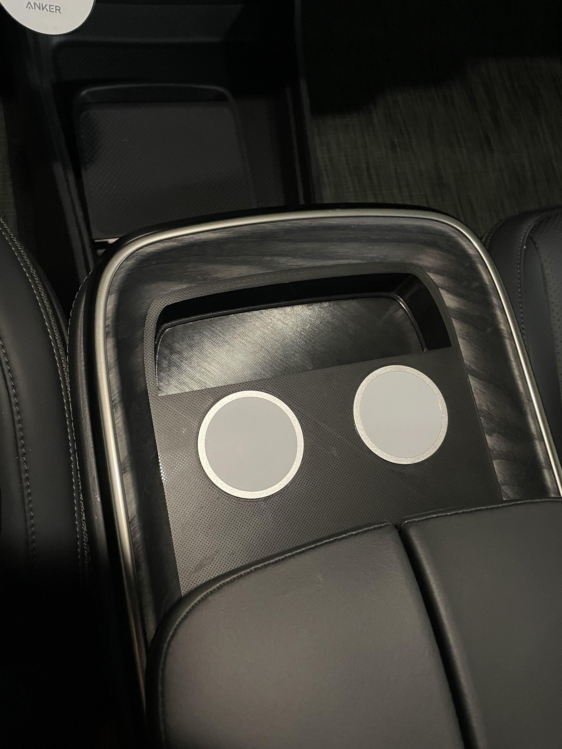

Thanks so much for making the STLs public. I can't quit modifying it for my needs. I wanted a little more 'finished' look so this is what's in my car now...
Rivian R1T R1S NEW - RIVIPARTS Ultimate MagSafe Charging Pad Kit tempImage9kIaz7

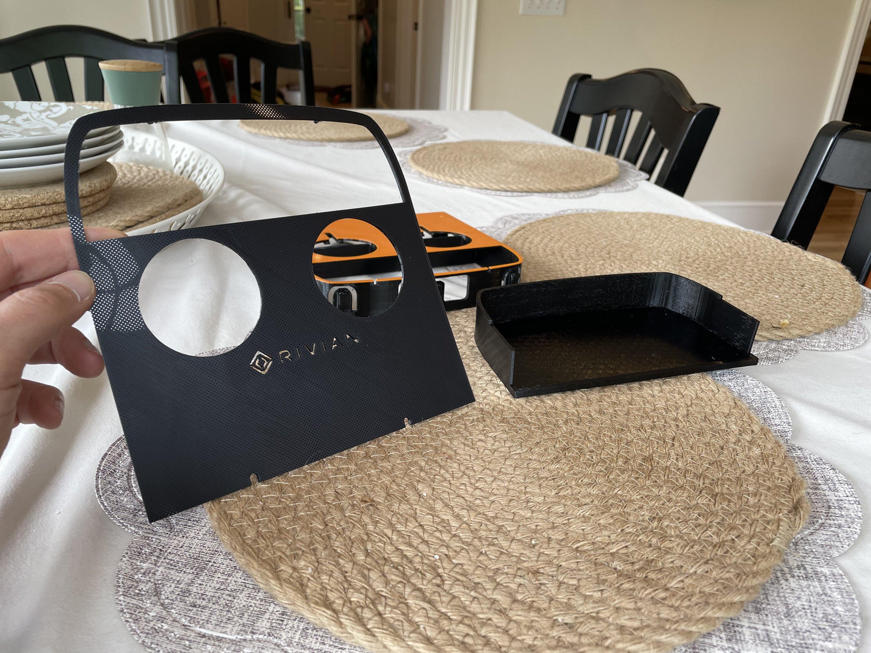

Still not completely satisfied though. Here's a sneak peak at a mod with a TPU (rubbery) top layer ...
Rivian R1T R1S NEW - RIVIPARTS Ultimate MagSafe Charging Pad Kit Screenshot 2023-04-29 at 12.42.03 PM

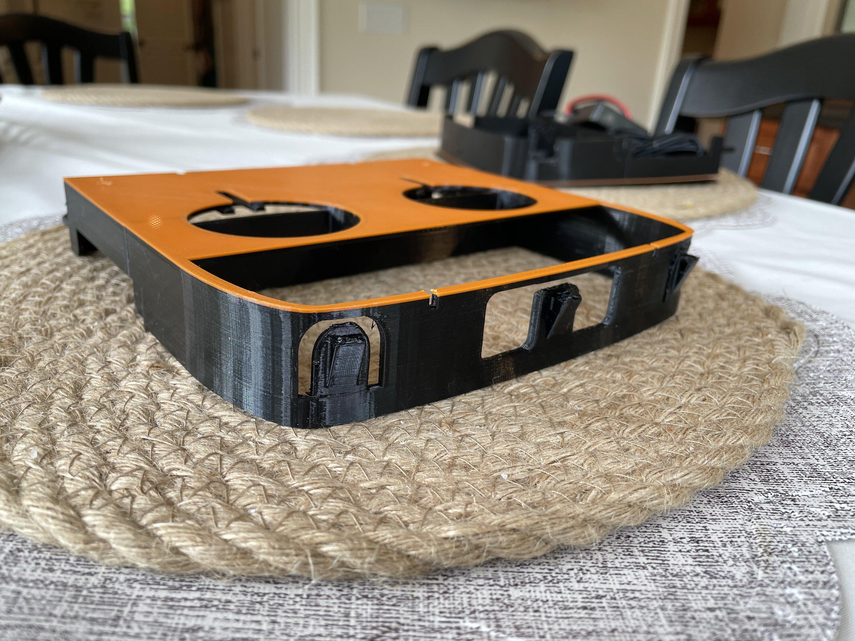

Hey @RWerksman , I’m having issues keeping the model down, seated properly in its place. It’s always pushing up some. I really can’t figure out why this is happening. Any ideas how i can modify it to better click into place or stay down?
What material did you print it out of?
Also - you might want to expand the small triangle at the front if that is where it's pulling from.

yes i was thinking that triangle might click in better if bigger. I did use PLA+ since that’s what I have on hand and know how to print with. Would it really help much to use PETG? does PETG warp as much as PLA? I had to print with a brim to keep it from warping.
PLA (any form) should not be used inside of a vehicle. The temperature that it starts to deform is too low. That's likely what happened here, already.
You'll need to a do a high-quality PETG.

Possible but hasn’t been exposed to high temps and PLA+ shouldnt be much more susceptible to heat than PETG. I don’t see signs of deformity. Comparing to original rivian module i think maybe if I make the front triangle a little more pronounced and the front side under the triangle a little more recessed, it should stay down better. I’ll let you know.

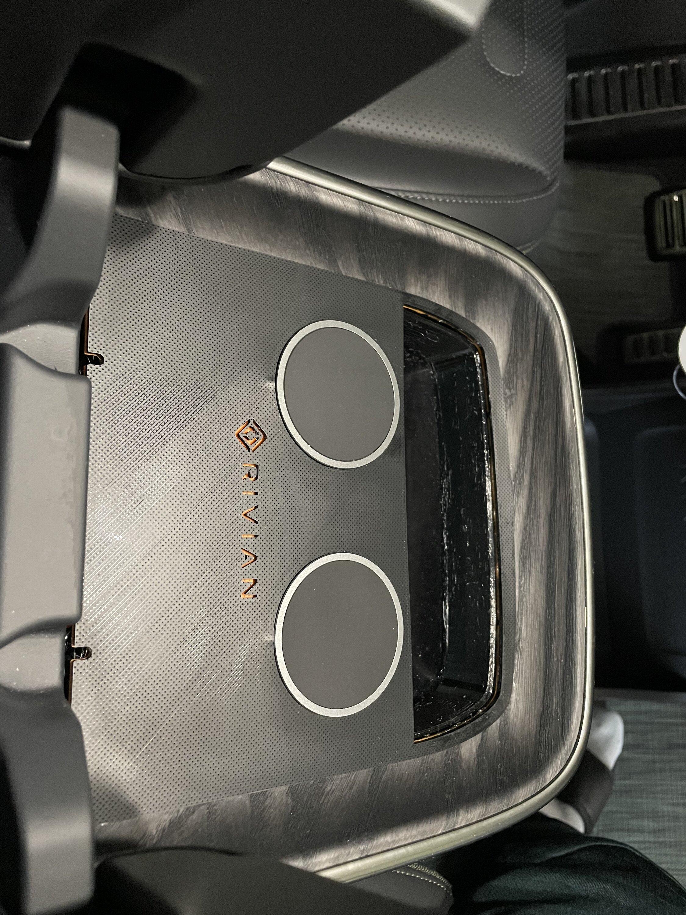

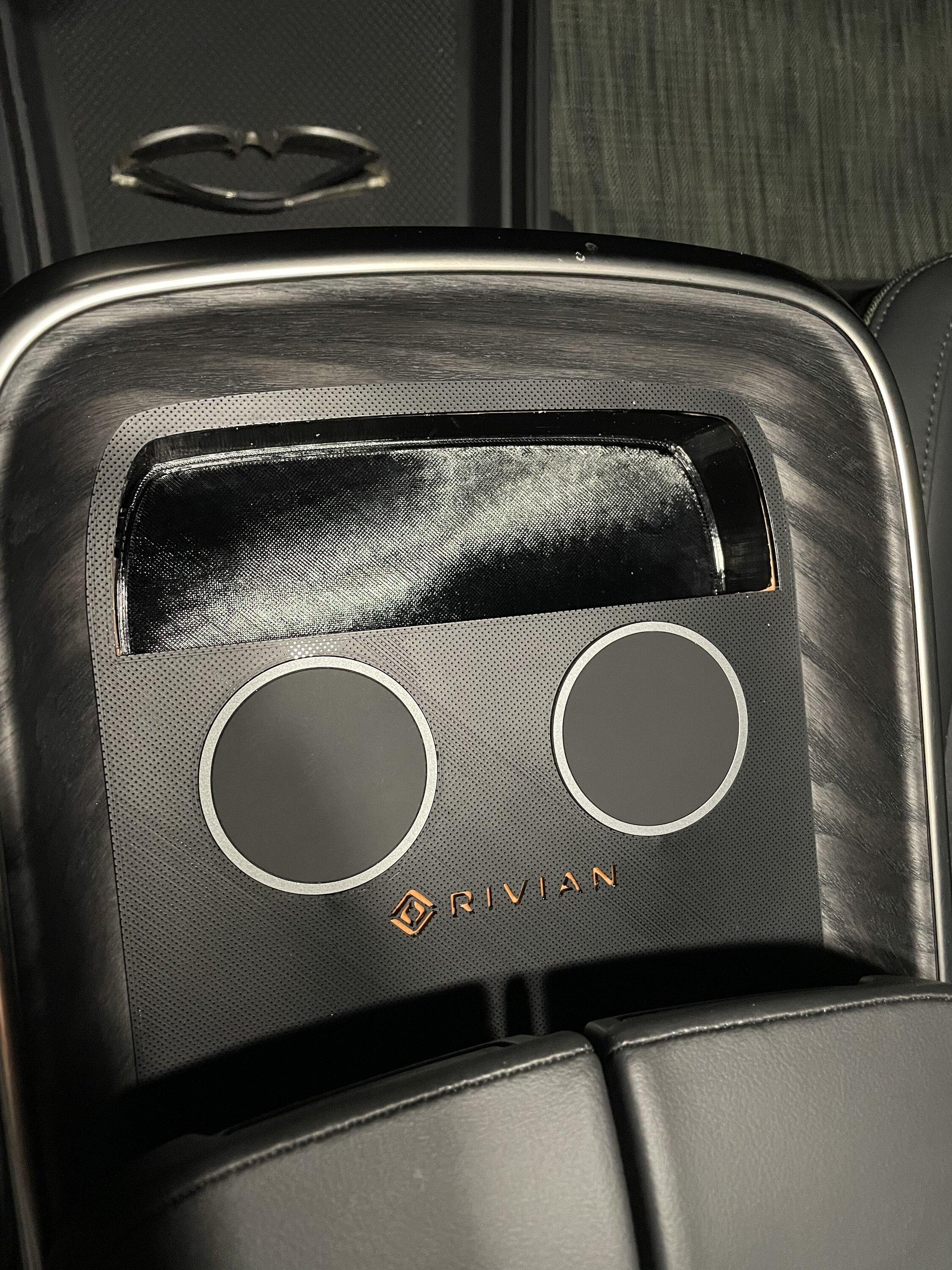

Still a very tight fit, but now clicks into place satisfyingly. I did take your recommendation and use PETG. (It took a few bad prints to get it dialed in)
Rivian R1T R1S NEW - RIVIPARTS Ultimate MagSafe Charging Pad Kit B0895F5B-DEF8-42EA-A77D-0175D16E4C35
Rivian R1T R1S NEW - RIVIPARTS Ultimate MagSafe Charging Pad Kit EE8CF1ED-40F5-4C88-B27F-136F33A84ADD
Rivian R1T R1S NEW - RIVIPARTS Ultimate MagSafe Charging Pad Kit F681ACCD-31AE-49BE-ADF2-205720720E5B
Rivian R1T R1S NEW - RIVIPARTS Ultimate MagSafe Charging Pad Kit E81FCF02-B1CD-4EBD-8728-CB0FC3C2F9AB
