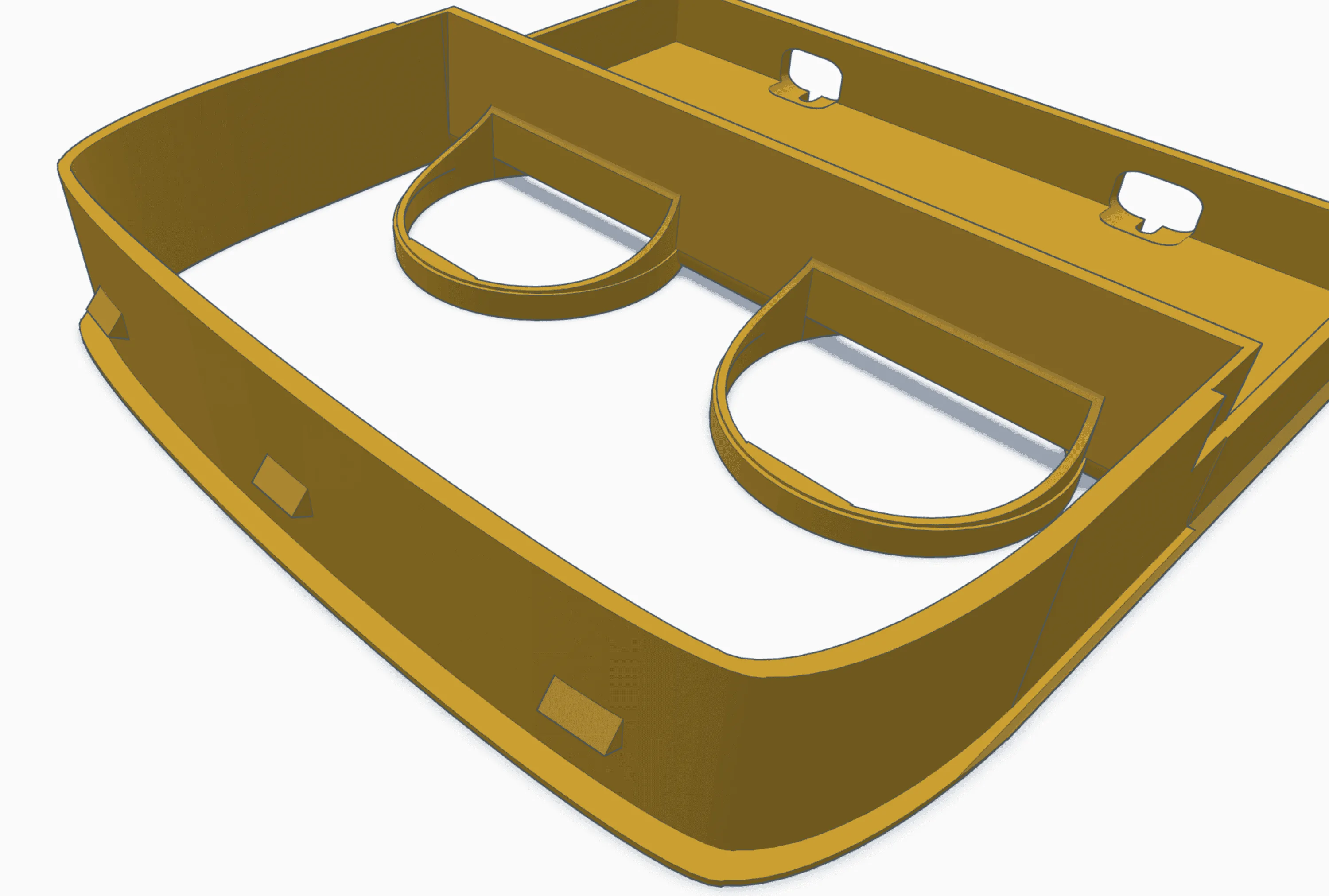

Hi Rob, the plastic cage that holds the phone charger in place has bumpouts (not exactly sure what to call them) that the original charger will clip into. The v1 charger does not have clips and I see that it uses friction against the bumpouts to hold itself in place. I am now noticing that there does not seem to be enough friction to hold the the v1 charger in place and the front end keeps popping up. Maybe the change in season is affecting the fit for me? I believe adding clips (as in that photo above) would help greatly. That is why I am very interested in a v2 version with clips.
It has a nub that installs one of the clip locations. This is likely the biggest change to the upcoming version - making it more robust. When it's realeased, anyone who is having issues should reach out to me so I can assist. There are a few factors in play that can result in this.

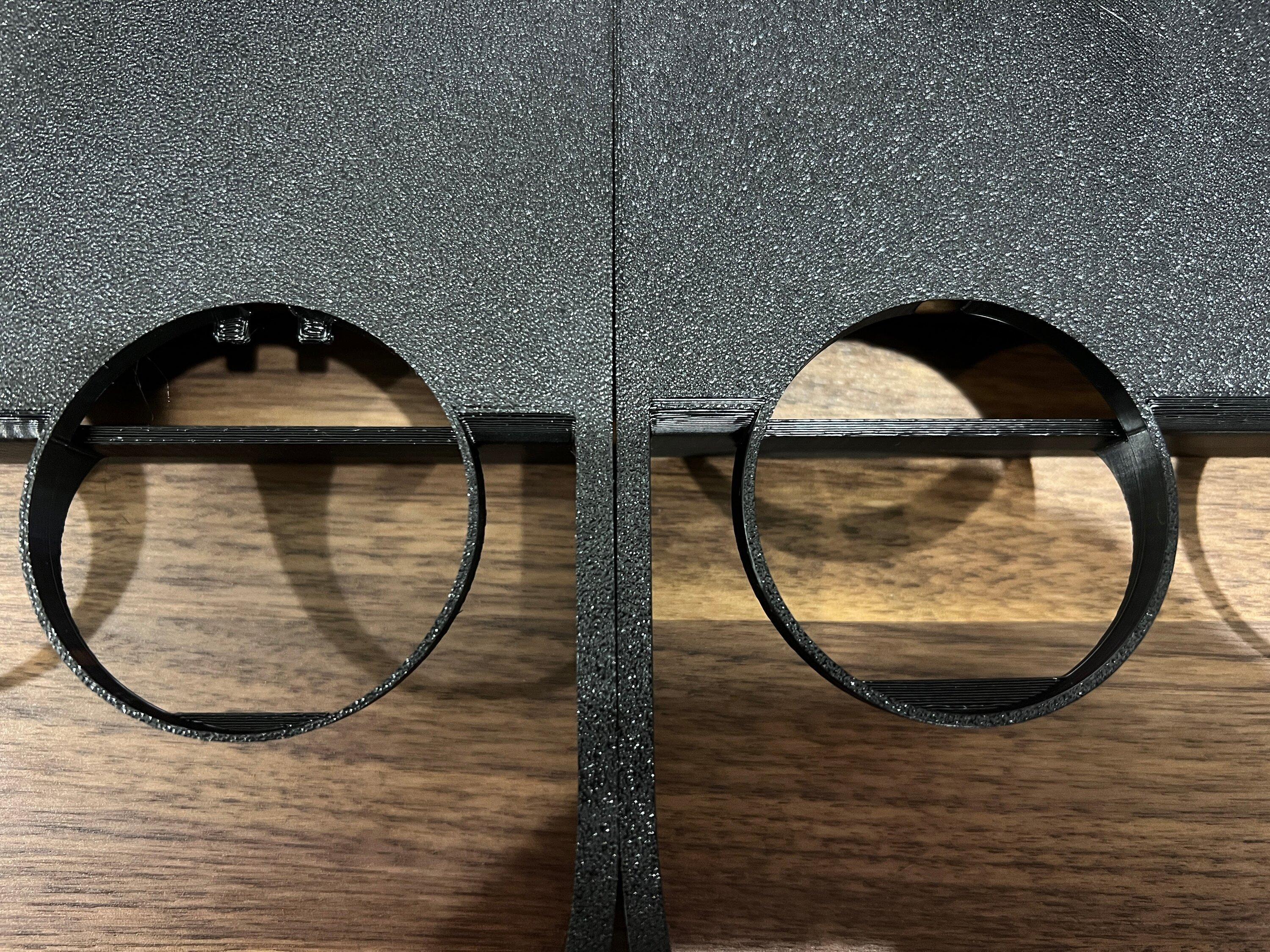

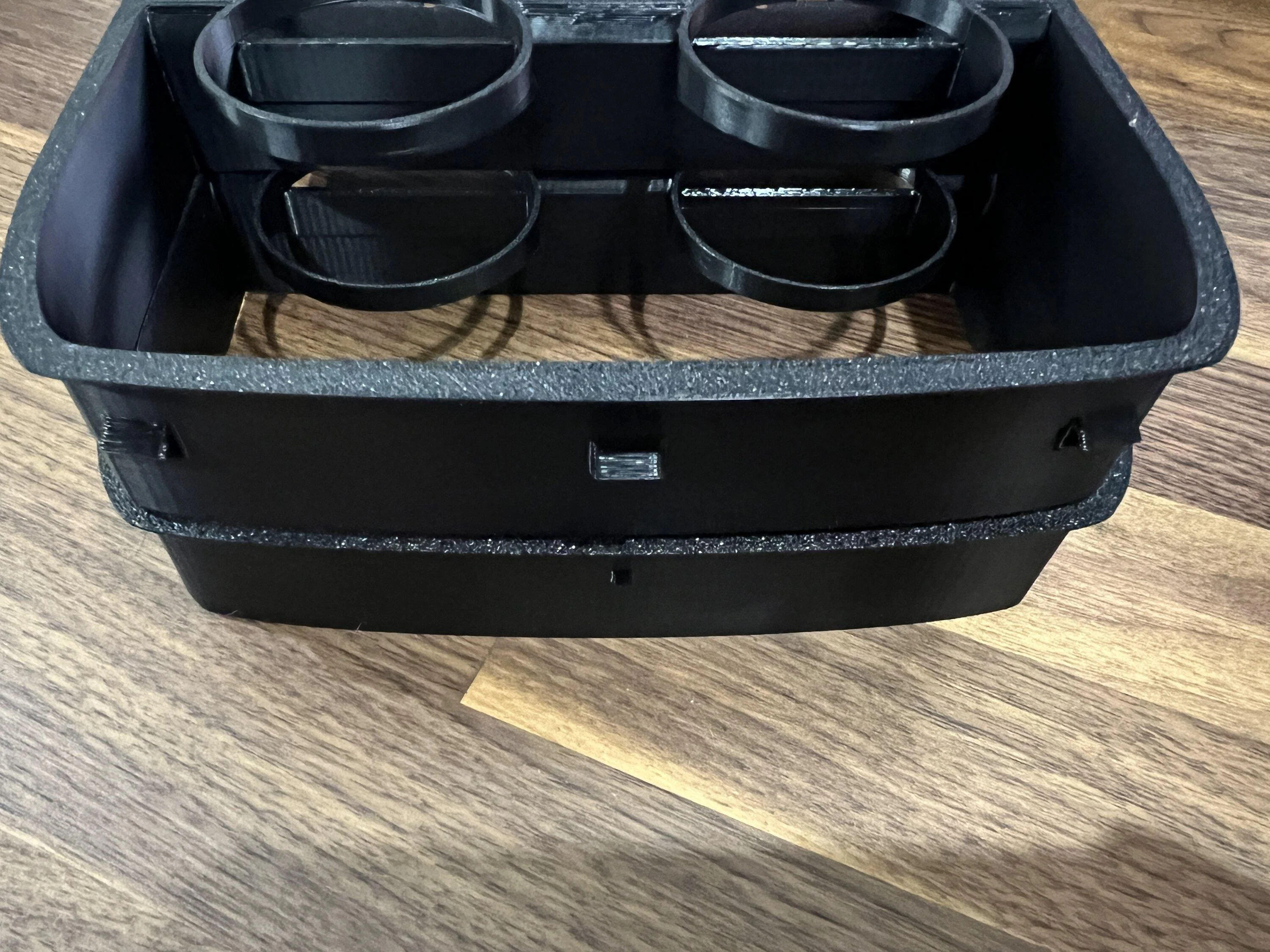

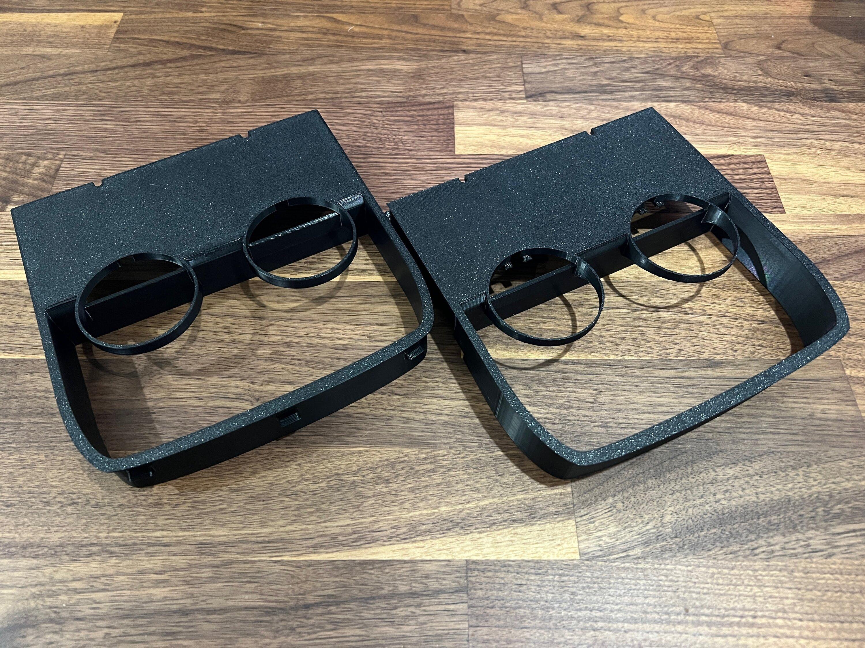

As far as differences, here are some shots of the old model compared to the new one:
Updated design on the right:
Rivian R1T R1S NEW - RIVIPARTS Ultimate MagSafe Charging Pad Kit IMG_1571
Updated design on top:
Rivian R1T R1S NEW - RIVIPARTS Ultimate MagSafe Charging Pad Kit IMG_1573
Updated design on left:
Rivian R1T R1S NEW - RIVIPARTS Ultimate MagSafe Charging Pad Kit IMG_1567 Copy
