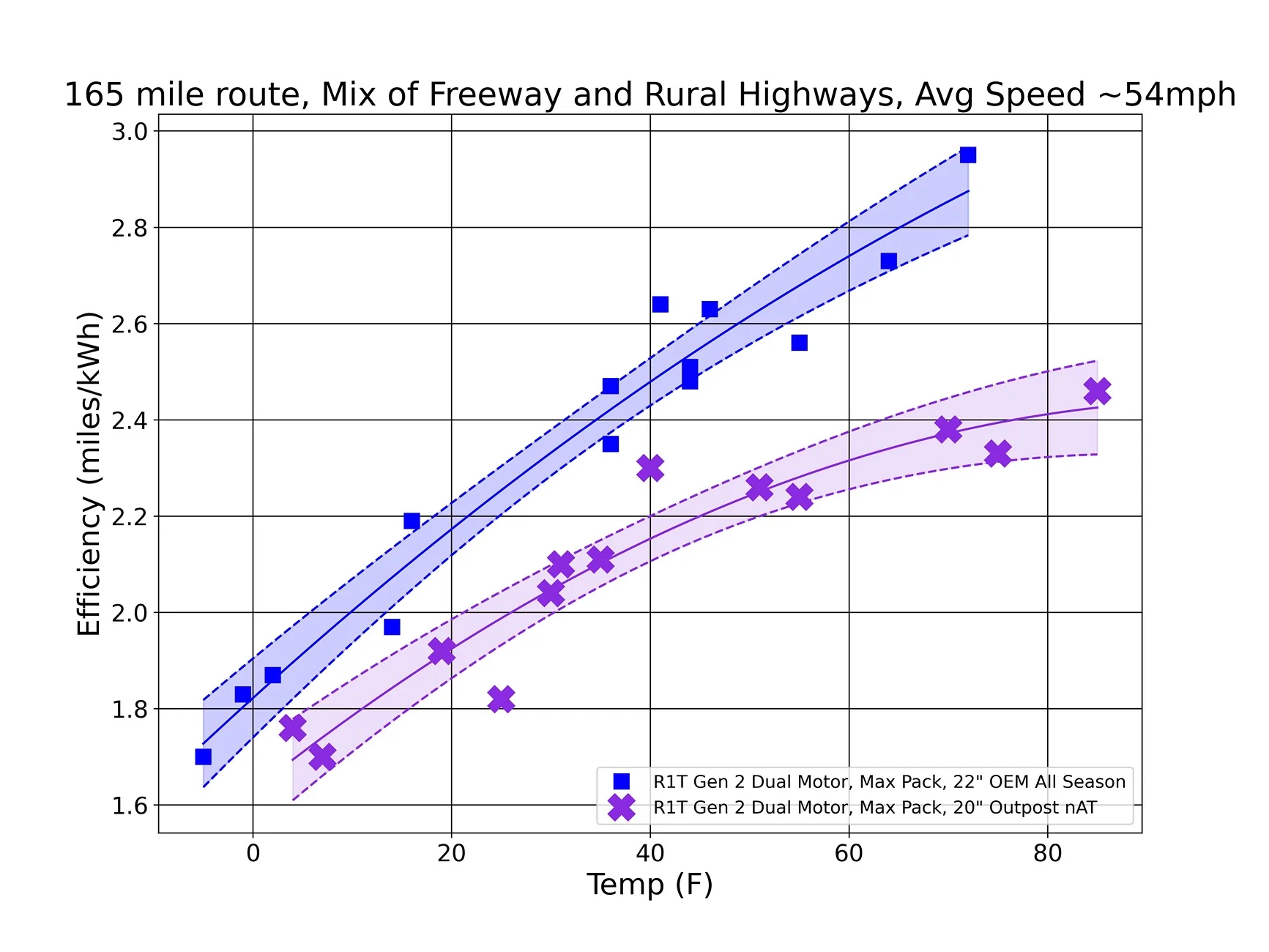

If you can swing it, having separate all season tires for highway driving and all terrain tires for special occasions is the way to go. The range hit with all terrain tires is pretty massive, more than I care to tolerate day to day. (data attached showing Nokian Outpost nAT's vs Perrelli All Seasons.
I've personally found the Perrelli all seasons to be a good tires. I've gotten 35,000 miles out of three different sets. I'm not sure why so many people are having such a different experience....
