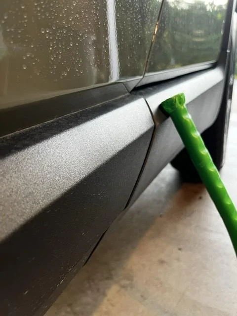

Like many of you my lower door fenders were not aligned. The service center fixed most of them but one persisted and was bothering me.
Rivian R1T R1S Door Fenders Misaligned? Quick easy fix. BFD9D8C1-7B46-4DE7-8D13-AE61023927D7

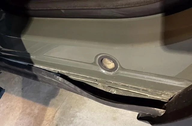

You can peel open the rubber weather stripping on the body of the truck.
Rivian R1T R1S Door Fenders Misaligned? Quick easy fix. CC60BA0F-042E-4138-A9F4-73EF03A811F6

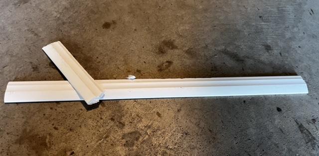

These are PVC corner drywall protectors I had laying around. They are cheap, snap easily but crush resistant. Cut to size and tuck them down in that little rubber taco. The bottom is sealed.
Rivian R1T R1S Door Fenders Misaligned? Quick easy fix. 9815C966-5874-4054-9377-D4928FDFAD4F

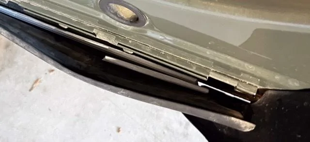

Rivian R1T R1S Door Fenders Misaligned? Quick easy fix. 4E96CDD4-1650-4BBC-8A1E-AED175817CE4
Pop the rubber weather strip back into the channel and adjust PVC spacers as needed.

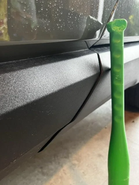

After:
Rivian R1T R1S Door Fenders Misaligned? Quick easy fix. FEE18F38-D21A-47CB-B0DB-C827D2841778
