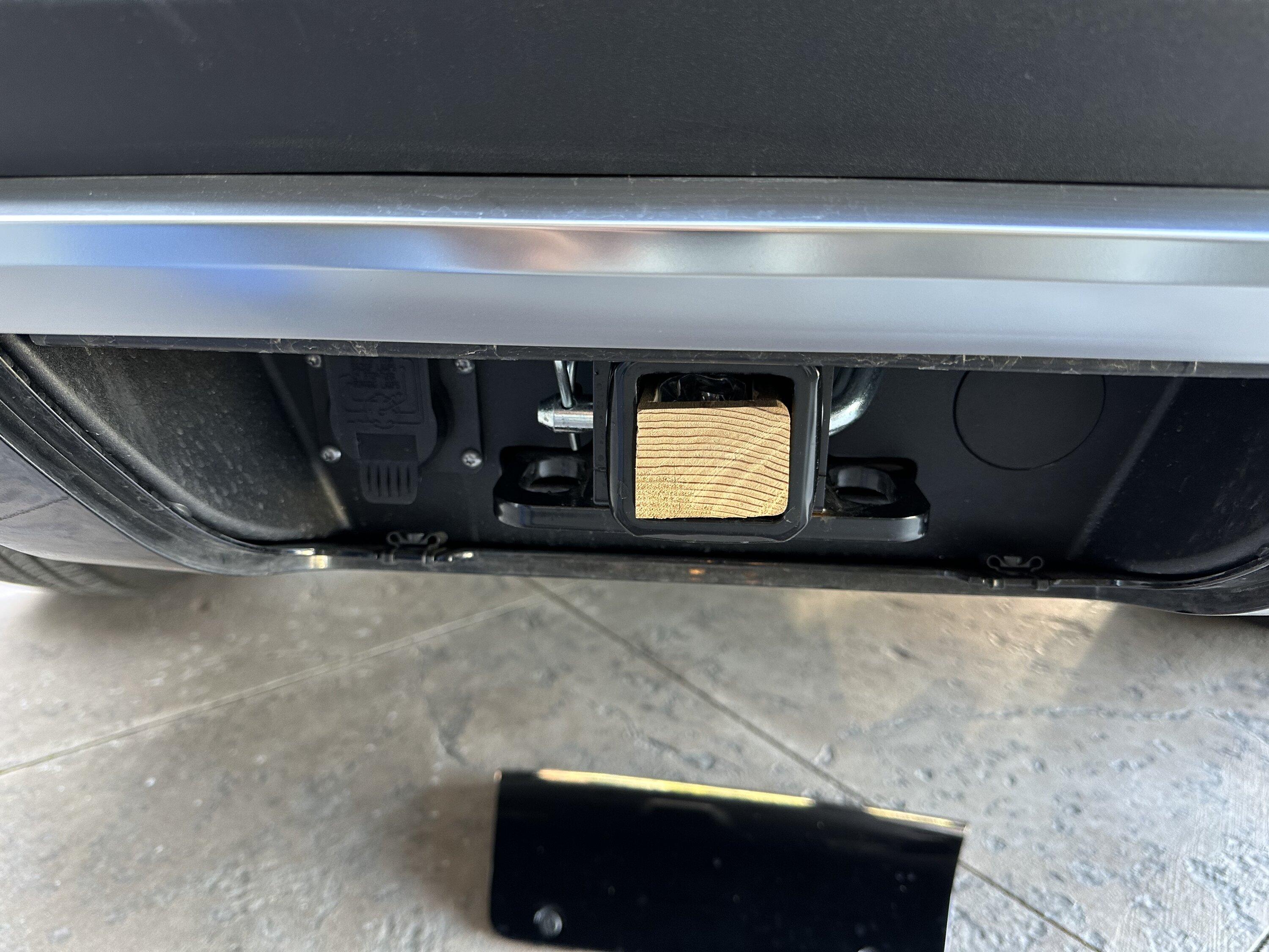

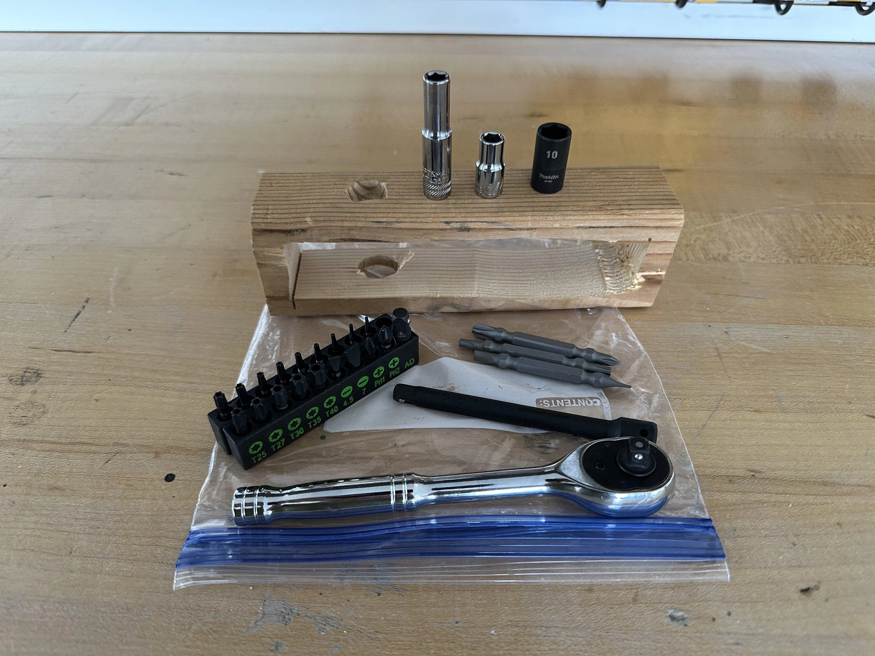

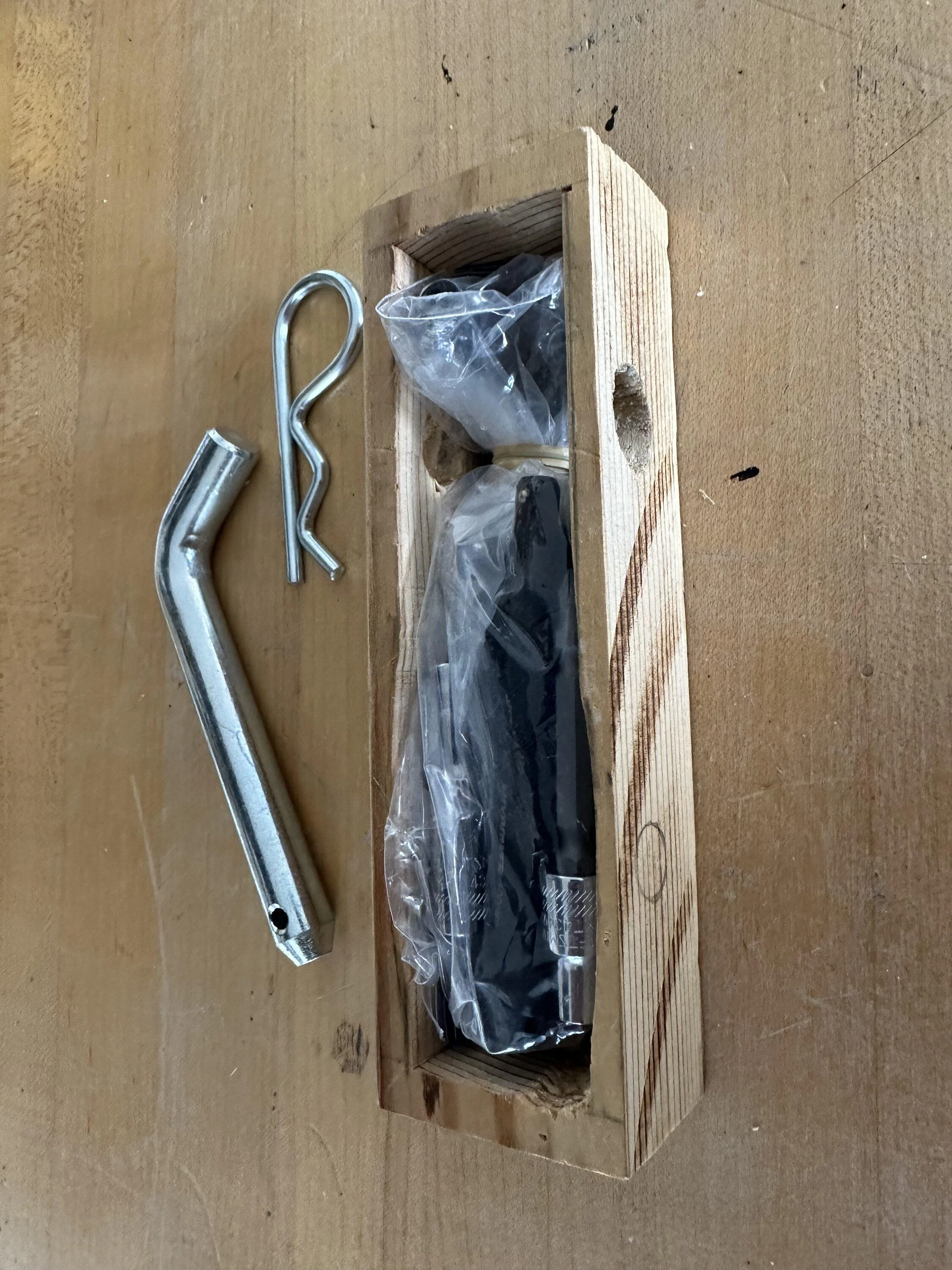

Just thought I would share. With all of the posts about dead batteries I was thinking I do not normally carry a Torx 20/25 in my pocket and having it inside the vehicle would not make it accessible.
My crude solution, I took a piece of 2x4, cut it 7” long by 2 inches wide. Picked up a multi bit driver that had the prober bits, needed to be max 6 inches long, I used this one. Hollowed out the middle of the 2x4 so the bits and driver in a ziplock bag fit inside. Fits snuggly in the receiver for the hitch, used a zip tie for extra security. I added the blade and Phillips bit into the bag as well.
Like insurance I hope to never need to use it but I thought better to have it and not need it than need it and not have it.
Edit, found I needed a 10 mm socket as well, took the opportunity to change the set, here are the newer pictures. Using a1/4 inch ratchet, extension, 1/4 inch sockets, 10 mm socket, various bits including the T20/T25 torx bits. All fit in the block and allows me to use the hitch pin to secure, easier to get in and out. Take note, the hitch pin for the R1S needs to be longer, I’m using one that is 5/8“ for a 2.5 inch receiver.

Brilliant. Sharing good ideas is what is great about this forum.

Great idea!

Brilliant!
