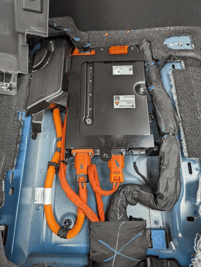

I think Rivian would have to move the inverter, I don't think there's enough room under the front passenger seats for anything with a higher capacity. Maybe if it were purpose built instead of being a purchased part.
I guess they are reducing the amount of computers in the vehicle overall though, so there's always a chance they made room somewhere for a larger one.

In the case of the outlets, I can see where Rivian might have found a new lower-cost supplier for the inverter, or even found a different inverter that was cheaper and/or more efficient. If that's the case, then it's possible Rivian will start shipping vehicles with this new inverter. I guess it's possible that the new inverter can support a higher current at 120V than the old, or that the new inverter also can supply 240V, but cost will be the primary factor - they are not going to switch the inverter just to provide 240V even if it costs the same, because there are other things like the wire size and outlet supplier that they would have to change to support 240V. The only way this is going to happen at this point in time is as a side-effect from a cost-saving change to the inverter.
