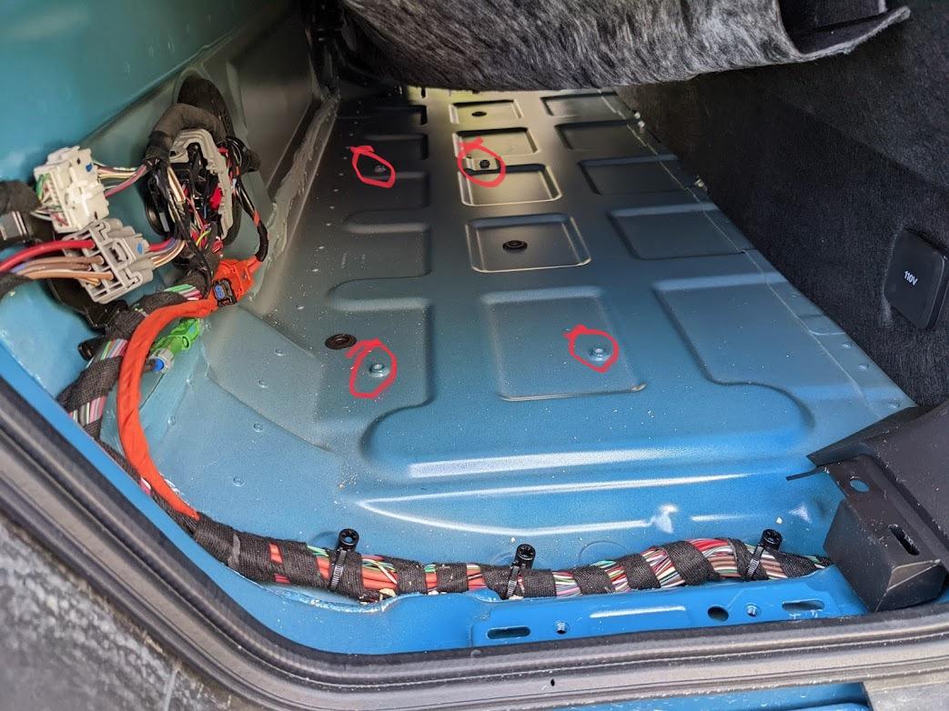

One of the biggest reasons I ordered the R1T was that Rivian was planning on actually having the camp kitchen produced. After basically being forced to remove it from my configuration under duress, I decided to try to build my own instead, using a lot of the equipment that Rivian is using. So if Rivian actually starts shipping the gear tunnel shuttle and kitchen before I finish with mine, you're welcome.
I ordered a Dometic CI21 induction stove, and it's currently sitting in my garage in a box. I was hoping to have it unboxed last night but I ran out of time to do it. On the Dometic webite, the CI20 is listed as being discontinued, and the CI21 stove doesn't exist. The retailer sent me an e-mail after I had already gotten a notification that it was shipped, to say that Dometic said it was backordered until mid June (perhaps that message was actually for Rivian?).
I also ordered a pair of 600 lbs 60" drawer slides from Accuride I am planning to mount much like Rivian has theirs, as well as the necessary cable track parts. Slides should come sometime next week. I'm hoping they are strong enough to forgo the foot stand, but it's possible that the attachment points in the truck are what won't cut it.
I'm not completely sure how Rivian has the gear tunnel shuttle mounted, but there are two unused threaded bolt holes on each end of the tunnel and no other threaded holes that I could find.

Subscribed. Those four threaded holes look spot on to mount the shuttle and will give you a ton of cantilevered foundation, especially with the 600 lb slider gear you are ordering. Feels like you may still want the fold down legs/foot stand as insurance against wobbling or damage?

these look like threaded bosses. Are they not?
They just look like donuts sitting on top of the sheet metal. No threads that I could feel and the holes don't go through the bottom sheet metal. I'm curious what the other side is. I'll likely try to pull the underside panels off the truck this weekend. It's possible Rivian uses them to help locate the gear shuttle when they are installing it.
I’d bet the gear tunnel shuttle keys in to those bosses, threaded or otherwise.
