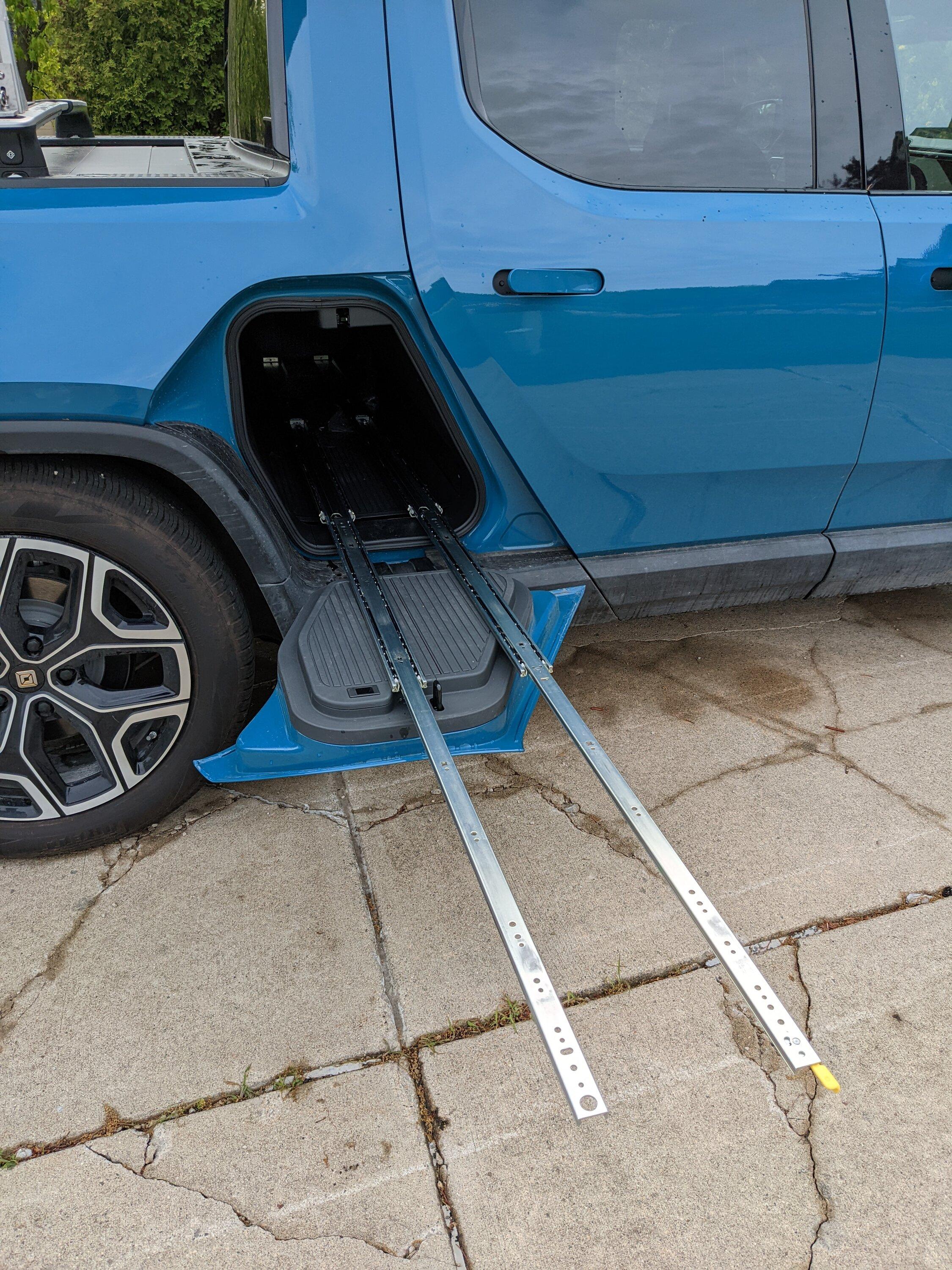

I'm hoping to forgo the kickstand by adding support rollers that rest on the gear tunnel door. It's there, it's in the way, may as well use it.

Slides came. Definitely can't put longer than 60" slides in here, they are just about perfect. Haven't done anything about designing the mounts for them yet but will work on that soon. Most likely going to do it in sheet metal and have the bending quoted since I don't have access to a press bigger than 48". Maybe aluminum to keep the weight down.

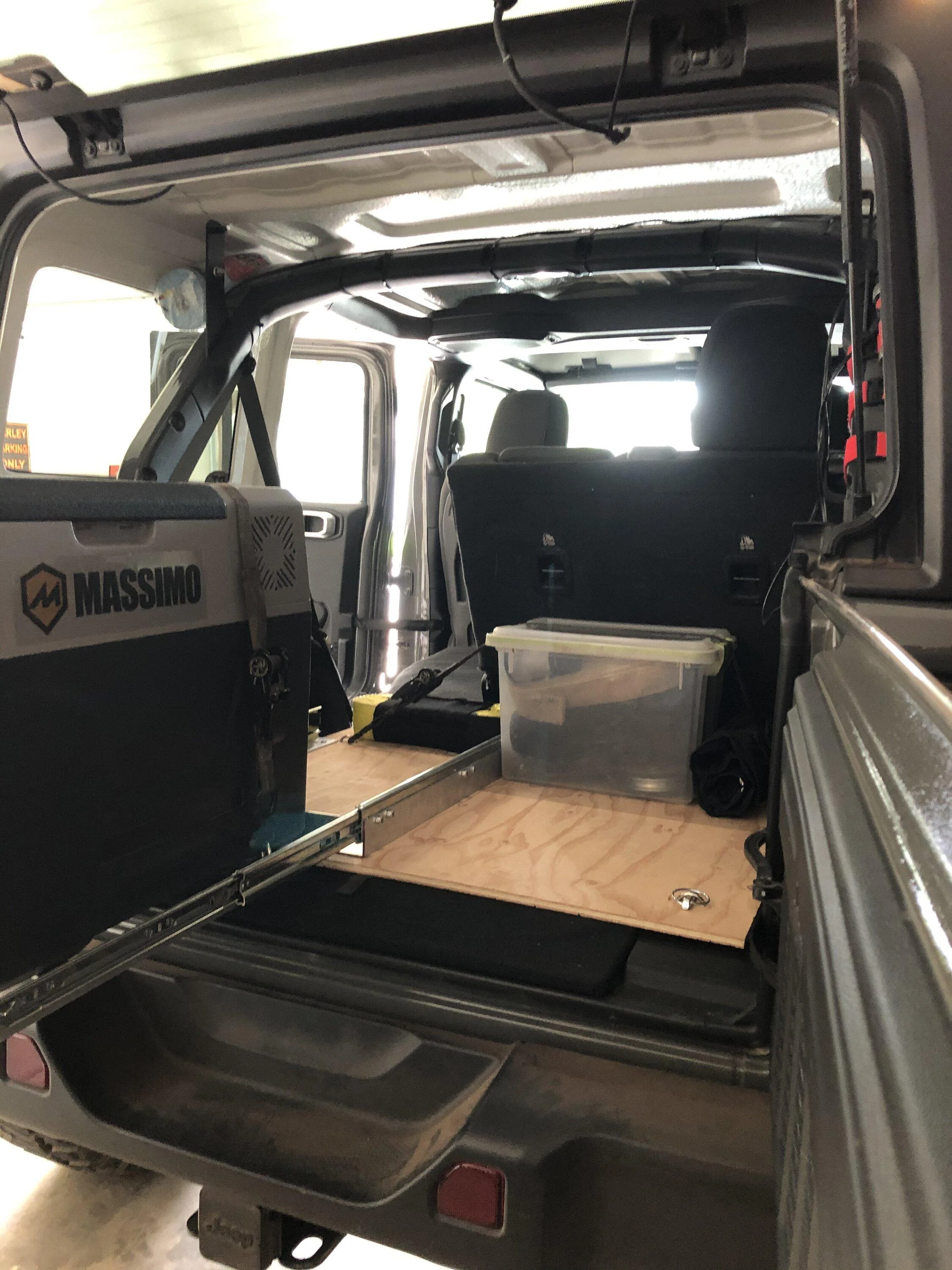

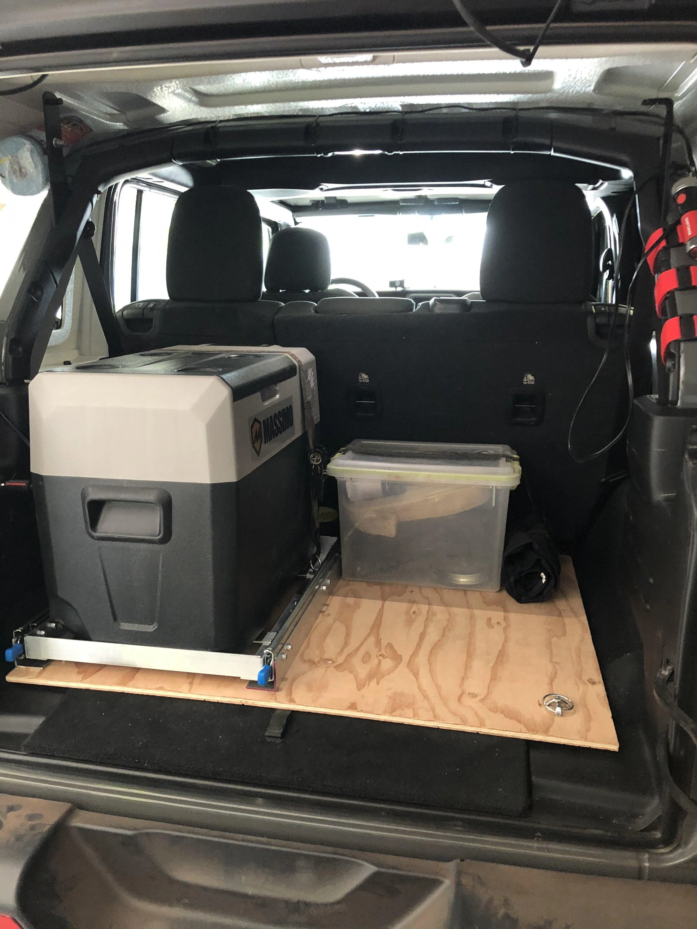

I did one for a fridge in my wrangler out of aluminum angle and drilled bolted it all together. Been going strong for 2 years and 50k in my Jeep. I doubt the picture will help, but there it is anyway.
